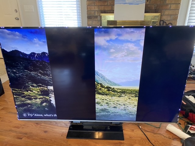

Hi there. I have a 70” Sharp Aquos that only shows 2 parts of the screen. I have attached a picture that shows the issue.

Look this https://www.badcaps.net/forum/showpo...4&postcount=12 -
Re: Sharp Aquos lc-70le64ou display issue
you need to do some testing and reading. The likely problem is with the bottom edge boards and smd components therein. IF you are "inclined" as other people that want to save the large screen, you may be able to replace the faulty component with some careful soldering work. It is likely that a smd capacitor has been shorted.Comment

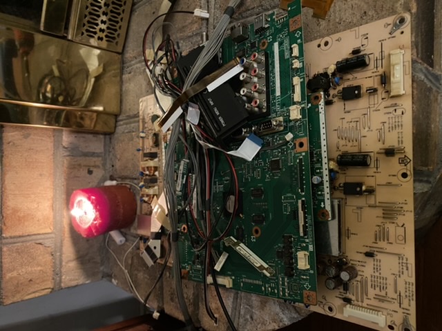

I have literally been all over this tv. I've replaced transistors, voltage regulators, capacitors and checked it over and over etc etc. It's now in parts and the boards are going up for sale, the rest to the metal recycler.Comment
