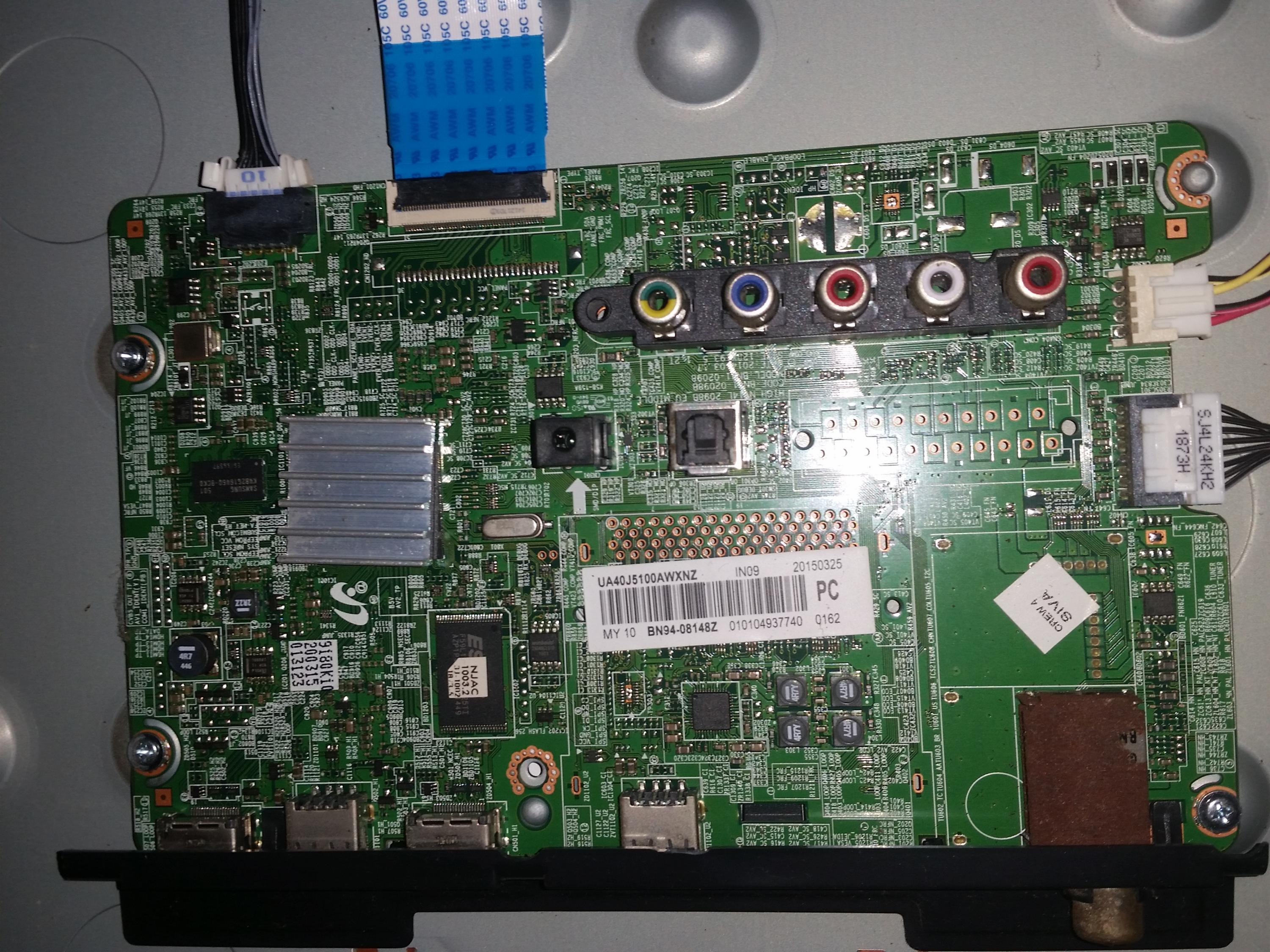

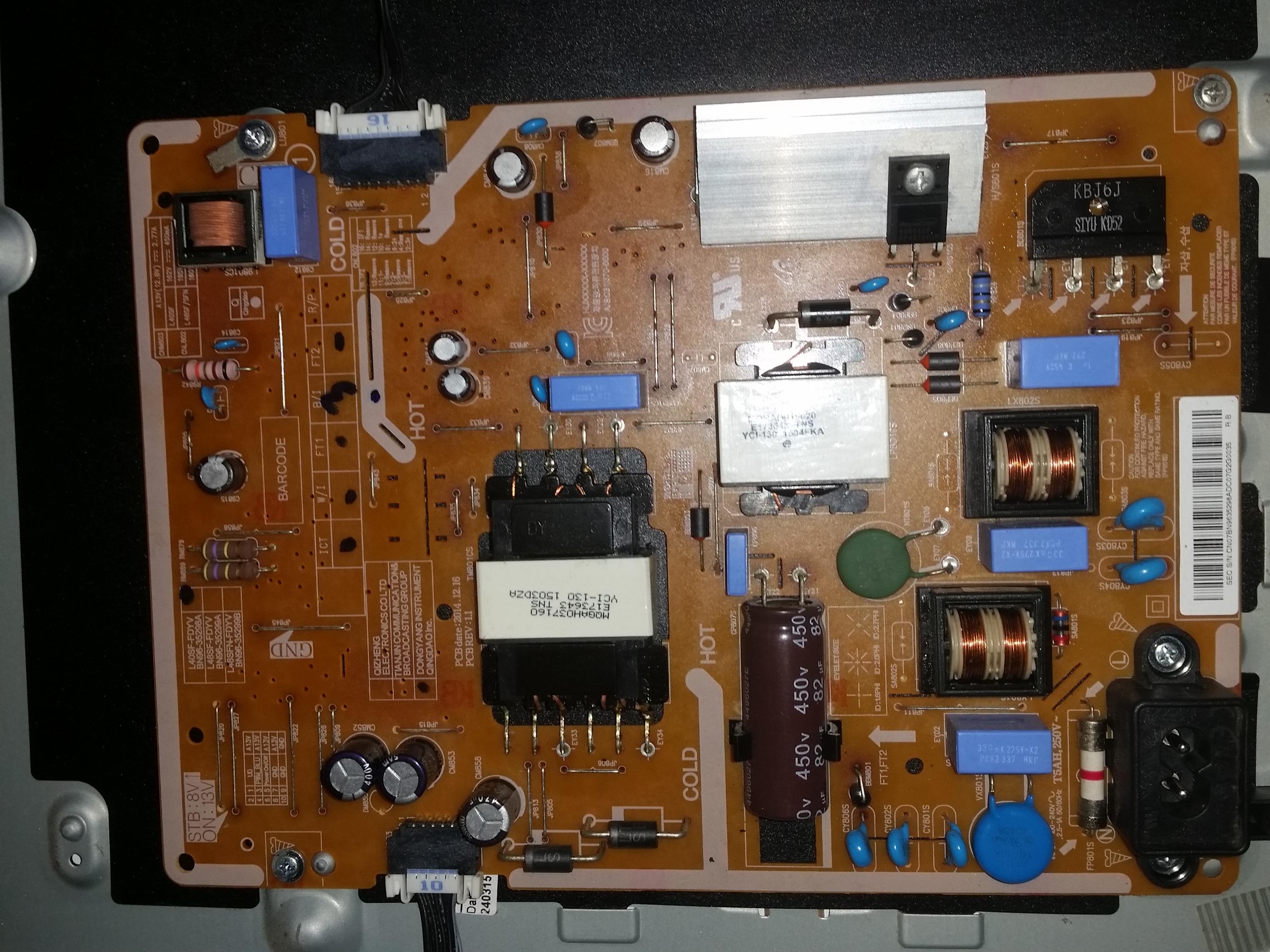

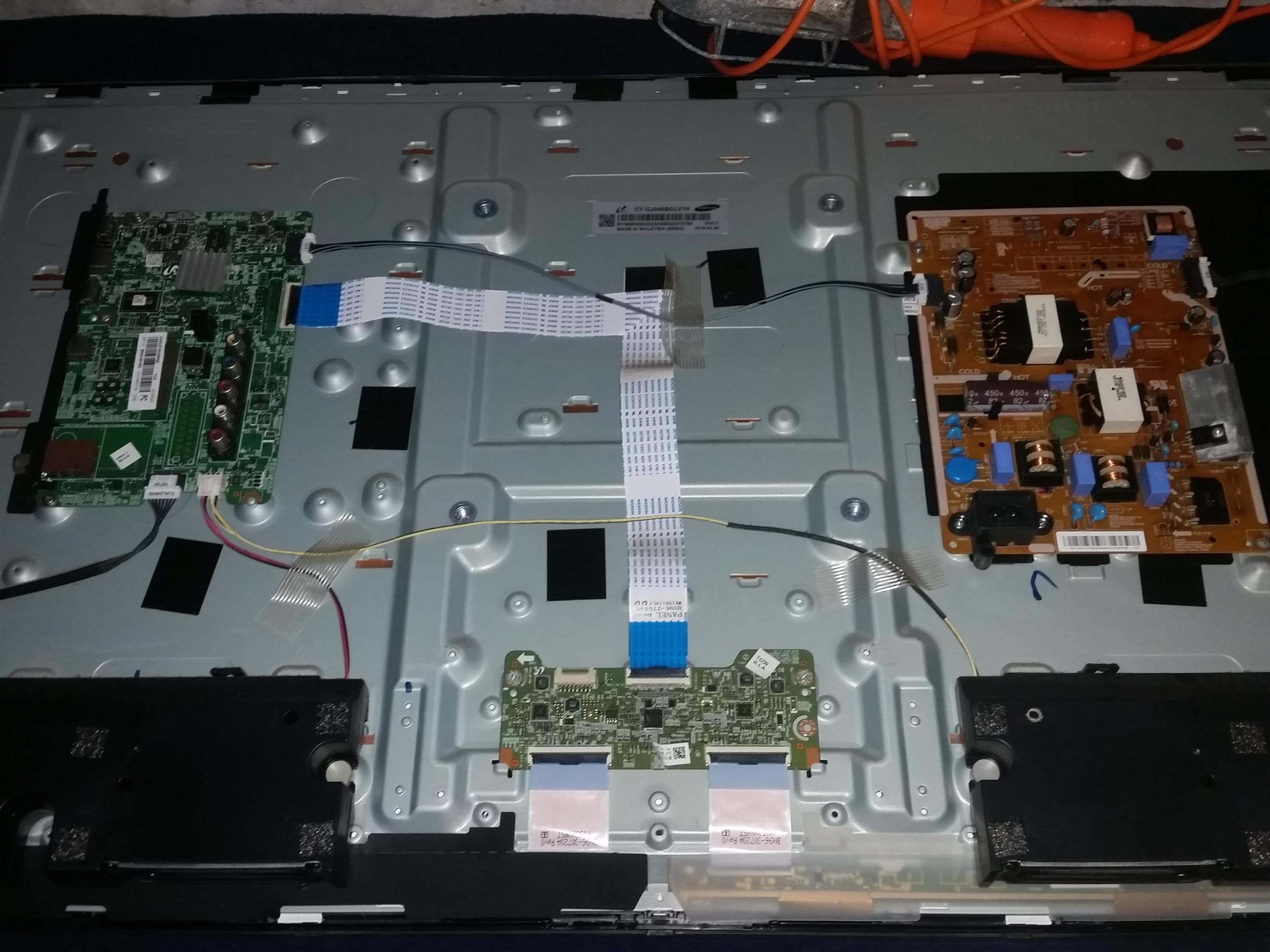

        Re: Samsung UA40J5100 LED SMPS voltage
        Thank you fro your fast response. I have attached images as instructed. I removed the ribbon cables coming out of the TCON one at a time. Neither made any difference. No picture on either side. Just backlighting only.
        I appreciate your continued assistance.
          I see a lot of rust and corrosion on the jumper wires etc. on the power supply board. I suspect this corrosion could be elsewhere on other boards, this could explain the intermitint nature of the problem. Check and clean all the flat cables, there are voltage test points on the t-con, check if you have the voltages (VCC_3.3V etc.)
          To determine if the fault is on the main or t-con, you need a scope to check for video signals on the lvds cable (from main to t-con)

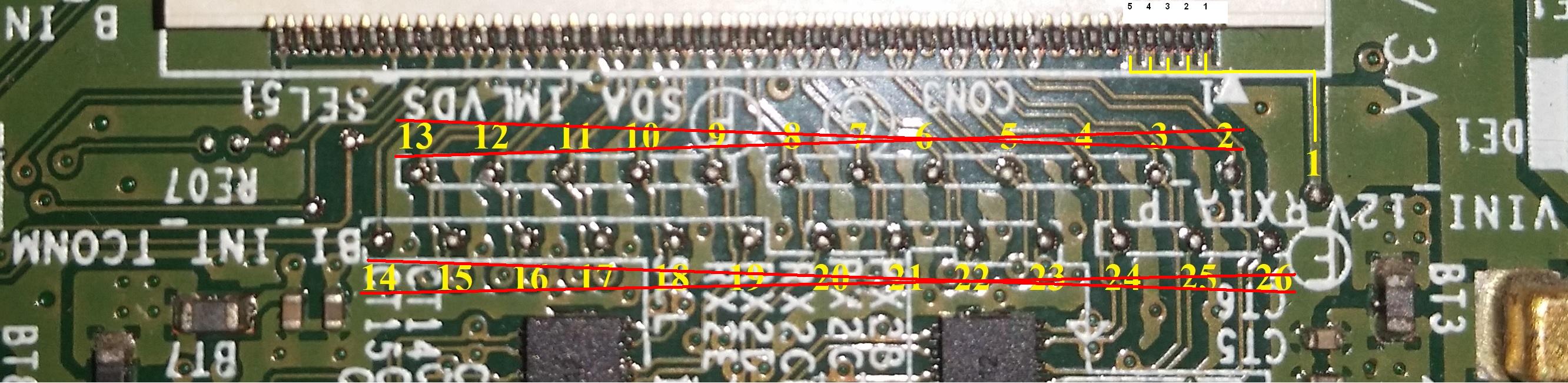

            Hi RJ,
            Thank you again for your kind and fast response. I did clean (with isopropyl) and re seat all three flat cables. I have tested:
            VCC 3.3V - nothing (1.1 to 1.3mV)
            VCC 1.8V - nothing (0.2mV)
            VCC 1.15V - nothing (0.1mV)

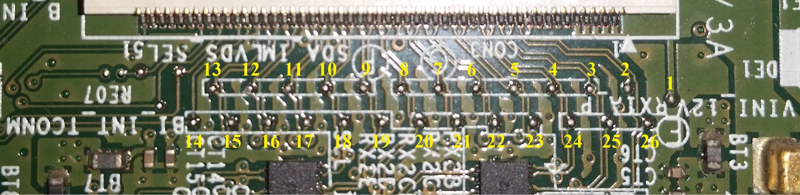

            Both sides of fuse on TCON are still 12.68V. I do not have an oscilliscope to check the LVDS cable sorry.
            Then I saw the test points for the LVDS input to the TCON so I tested those. As per picture:
            1: 12.7V
            2: 0.531V
            3: 0.718V
            4: 0.672V
            5: 0.667V
            6: 0.681V
            7: 0.486V
            8: 0.578V
            9: 0.787V
            10: 0.735V
            11: 0.867V
            12: 0.783V
            13: 0.369V
            14: 10.8mV
            15: 2.174V
            16: 0.708V
            17: 0.640V
            18: 0.754V
            19: 0.734V
            20: 0.867V
            21: 0.805V
            22: 0.627V
            23: 0.602V
            24: 0.692V
            25: 0.669V
            26: 0.797V
            All of these tests are via grounding to chassis with the TV on (backlghts going) and in the fault condition. I hope this is ok.
            Many thanks.

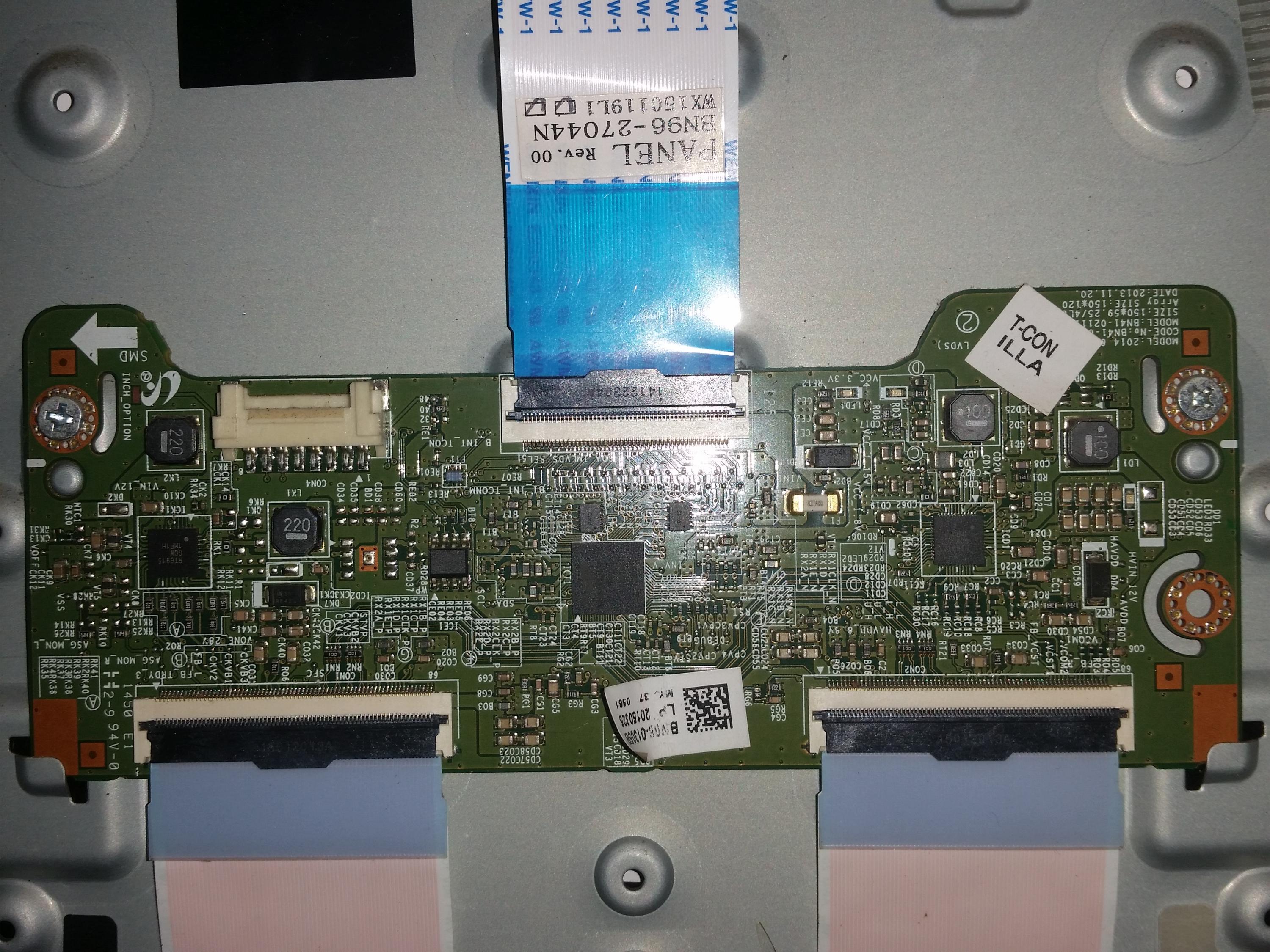

              It does look like it's the t-con at fault
              I suspect thet could be a shorted mlcc (ceramic cap) likely on vcc1.8v. These caps don't realy like high humidity conditions like you have. Sometimes the bad cap will get warm so you might be able to find it by tiuching them with a finger. It could also be a shorted ic.
              Just as a check, disconnect both flat cables going from the t-con to the panel and then recheck the 3.3VCC, if it comes up then it could be a fault on the panel.
                  Hi RJ and Robinsosa,
                  I disconnected both cables to panel and tested VCC 3.3V - no change.
                  As per document that Robinsosa posted, no LED's light up on TCON except sometimes a brief flash from one of them on startup.
                  But fuse on TCON is not open so does that mean it is the LVDS cable or the TCON? I don't know if this is a no-no, but I reversed the LVDS cable and it made no difference either.

                    The LVDS cable (cable between main board and t-con) can't be reversed, it should only have contacts on one side. If you have the +12 volts to the t-con, you should have the other voltages, unless there is a tcon board problem. On the lvds cable, pins 1~5 have the +12v, the other pins on the lvds cable are for the video signal.
                      Hi RJ, what I mean to say is that I took the end of the LVDS ribbon from the MAIN and plugged it into the TCON, then plugged the TCON end of the LVDS into the MAIN. So I didn't turn it upside down, I just reversed it. Contacts still all facing down onto the board contacts.
                      Likely a TCON fault then?

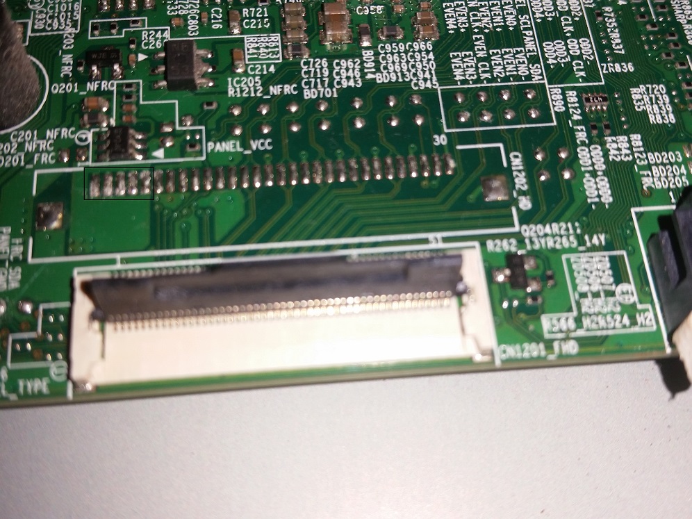

                        Looks like you have 12.7 on the first pin but the next 4 or so are too low, can you tell if you are getting those 12 volts from the mainboard, maybe carefully measure those pins with the connector unplugged.
                        • R_J
                          • Jun 2012
                          • 9625
                          Those first 5 pins should all be connected together, You could recheck them, but I suspect it was just a poor meter probe contact, as long as there is 12 volts on both sides of the fuse, and low 3.3 etc, it is likely the t-con at fault.
                          • rowage
                            • Sep 2013
                            • 22
                            • Cook Islands
                            Hi RJ and nomoresonys. I tested the output pins on the MAIN as pictured. The first five inside the square I have drawn all read 12.7v with the LVDS connected. They rise to around 13v with the LVDS disconnected.
                            All the other pins in that line are 1.something volts. Mostly 1.2v.
                            The first five pins that I numbered on the TCON in the last pic, they are all reading the same as I last stated. Only the first one reads 12.7v. I confirmed the ground point each time I tested a pin by going back to both sides of the TCON fuse and checking for 12.7. Same thing every time.
                            Cheers. Oh, and if I make it off this island for a holiday any time, I will be sure to buy all of you a beer :-)

                              Soooo, since the first five on the MAIN are all 12.7v, but only the first pin on the TCON is 12.7v, does that indicate a faulty LVDS cable? Or are we sticking with the TCON being faulty?
                                According to post #6 you are not checking the pins properly

                                    Don't worry about it. As long as you have the +12 volts on the T-con fuse, thats all that mattered. And you have that. They use 5 pins for the +12 volts to handle the current (2~3 amps) to supply the t-con AND panel. One small pin could not handle it.
