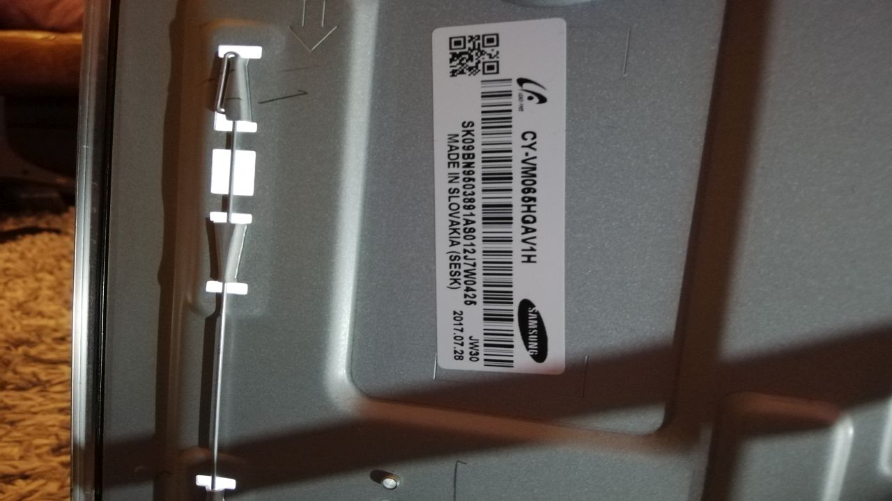

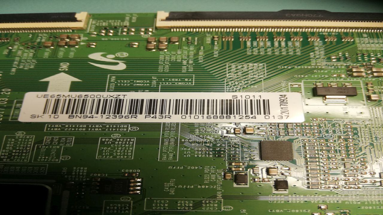

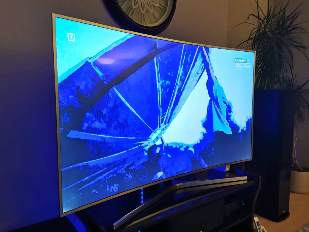

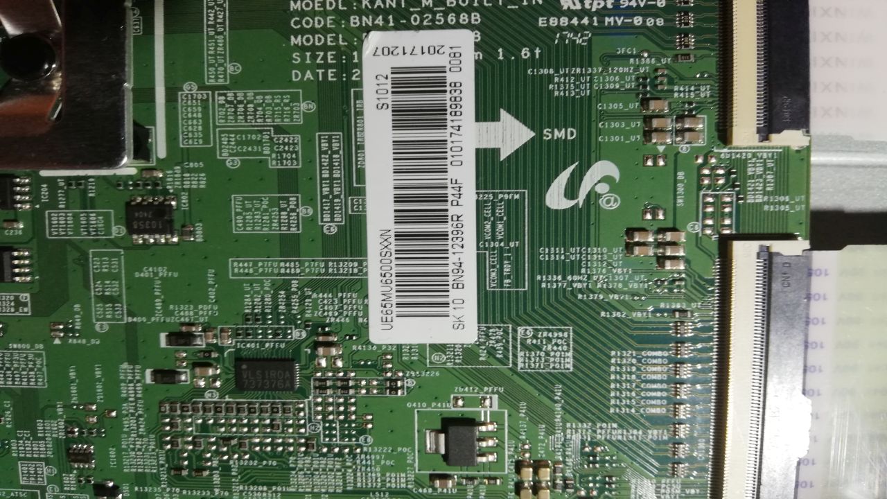

    Hi All
    I have a Samsung UE65MU6500UXZT TV. The original symptom it had was that the TV would not come on. After I removed the cable from the power board to the main board the TV backlighting came on so I ordered and replaced main board. Now tv turn on but picture is very bright and inverse picture. If I disconnect lvds ribbon no picture on screen. I suspect different firmware main board from 6500s series was only availed. Have you any advice what to do next.
    orginal board: BN94-12396R
    screen CY-VM065HQAV1H
    replacement board BN94-12396R From UE65MU6500Sxxn
