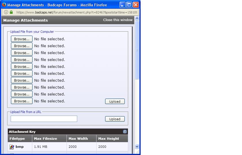

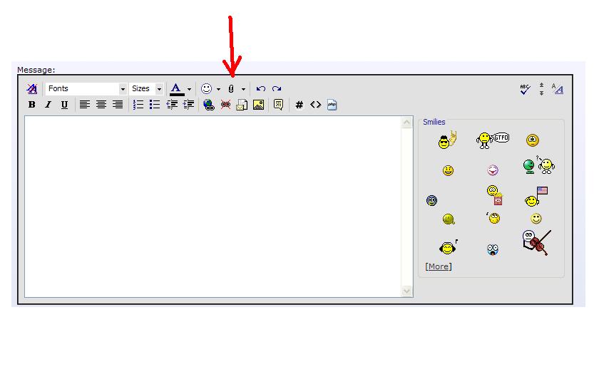

      Attach your pictures to your post.

          To attach a picture, click on the paperclip next to the then browse to your picture(s) then click upload
