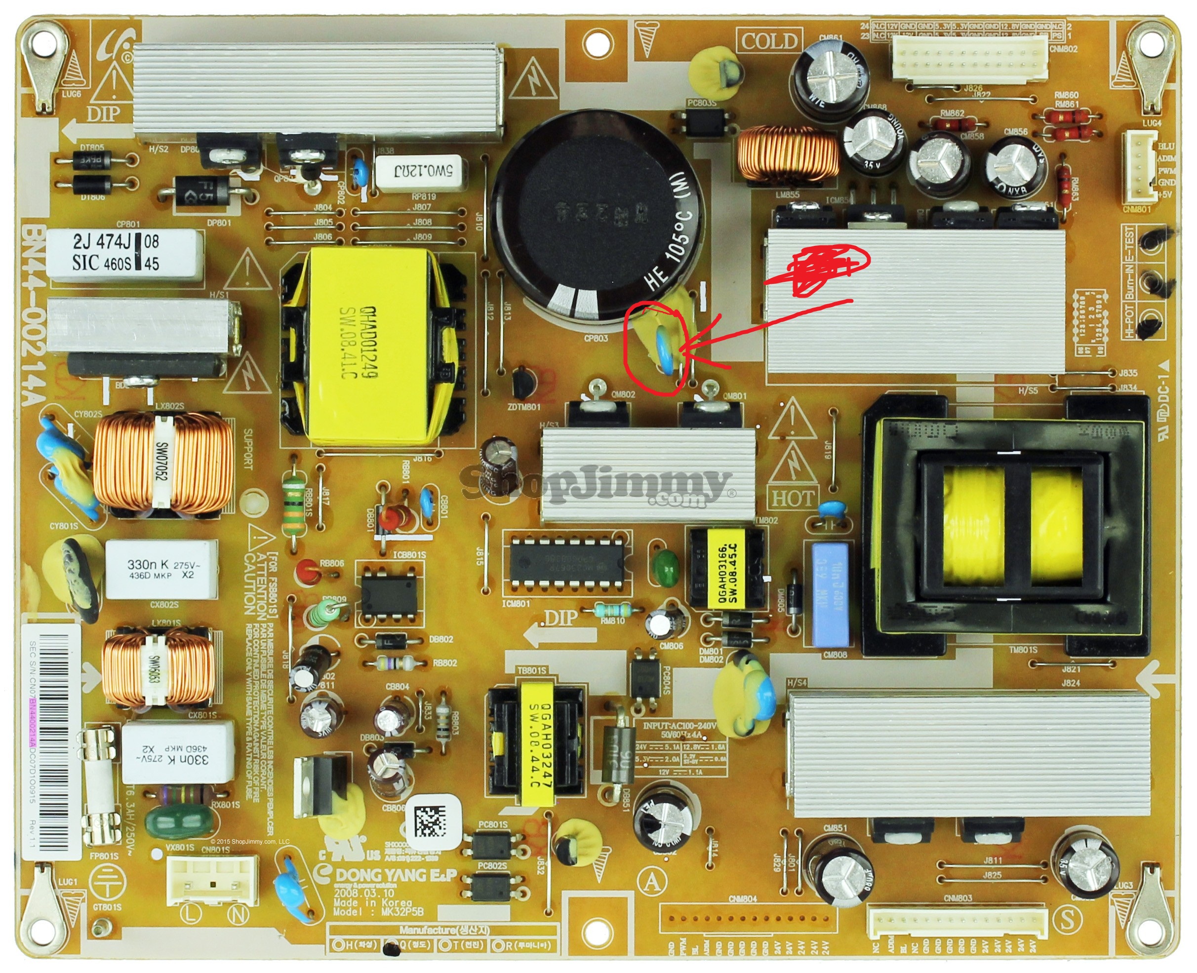

    hi
    my neighbor gave me this LCD tv...he said would not power on
    i plugged it in and immediatley heard a pop and smoke so i unplugged it
    took tv apart and saw visually that 1 blue cap was fried...see photo photo is stock photo from shop jimmy
    anyone know what would cause this and can i just use a standard capacitor as replacement?
    the part is circled in red..see stock photo
    i believe the initial no power on is due to a different bad cap that is bulged but not sure why the blue cap fried as soon as i plugged tv in...

    Identify the 2 caps Cxxx? pictures would be helpful.

      i posted photo with cap that fried circled in red and the bulged cap is at CM856( which i believe is the initial no power on issue)
      just yrying to find out why the blue cap fried as soon as i plugged tv in after tv was given to me due to no power on.

        That is commonly failed snubber cap, rated at 1KV, you should replace it with 2KV cap rating.

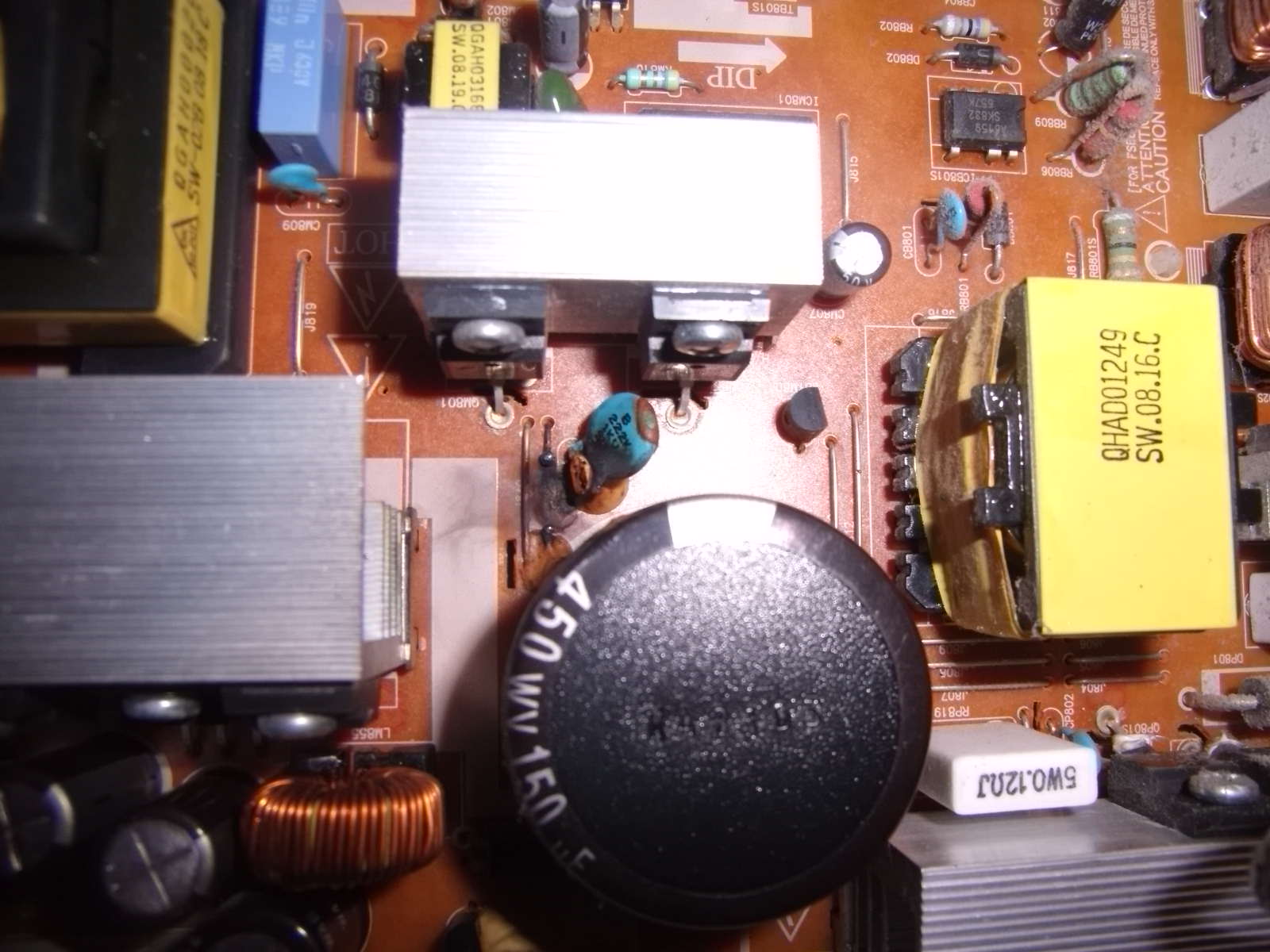

          here is actual pic of my board..the cap fried as well as the jumper next to it
            Re: Samsung LN32A450 LCD TV popped when plugged in
            You need to remove all those bad brown glues, they are conductive.

              hi bud...well i just find it odd why did it get fried as soon as i plgeed the tv in..it didnt fry for the guy who gave tv to me....initial issue was tv would not power on..which i believe has nothing to do with this blue cap issue ..im trying to find why?...

                  That is high Voltage section, so the glue finally conducts enough to cause problem, nothing new about those bad glues, it is also corrosive and it will eat component leads and copper traces.
                  See what kind of damages bad glue will cause: https://www.badcaps.net/forum/showth...ight=bad+glues

                      Replace those 2 caps, clean up the glue and give it a go.

                            Just check the resistance of the blue cap to see if it is actually shorted out or not, the failure mode of those ceramic caps are shorted circuit.
                            But you must remove all the glues first, replace the blown jumper wire, check the MOSFET's on that heatsink to make sure they are damaged.

                              ok thanks bud will check...the legs are fried but the body seems visually ok...test whil;e its on the board? i have the board out of tv now...is it safe to test?..seems to be no continuity between cap legs

                                thanks guys.....i removed the glue..replaced the blown jumper..resoldered in the original blue cap...replaced the bulged cap and now tv powers on fine...saved another tv from landfill
