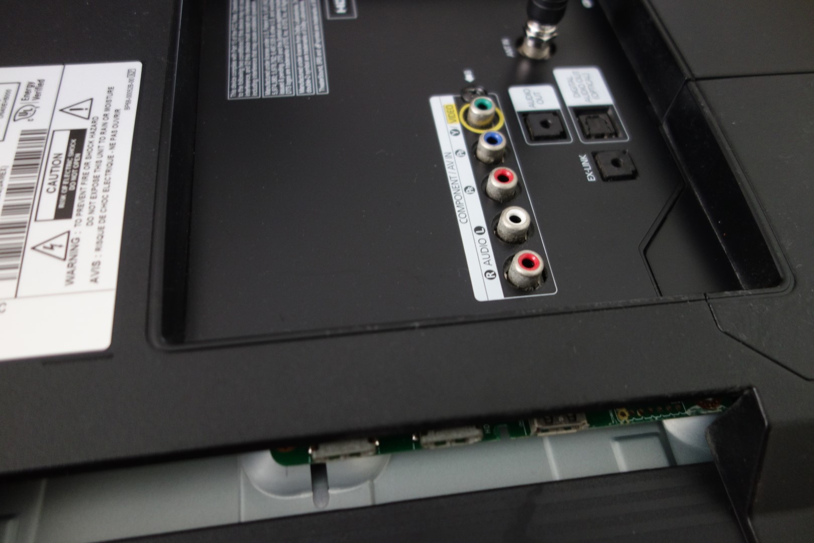

    Need UN40EH5000F Side Cover
    Got this TV for free since it was completely disassembled. Powered up with backlight and no video which typically means bad tcon but I had a compatible tcon which didn't fix it. Got a new main board that fixed it. First replacement didn't turn on at all but seller gave me a full refund.
    So missing the side cover for the ports. If you are scrapping this model or UN40EH5300F let me know. Should have 3 openings for 2 hdmi and 1 usb.
