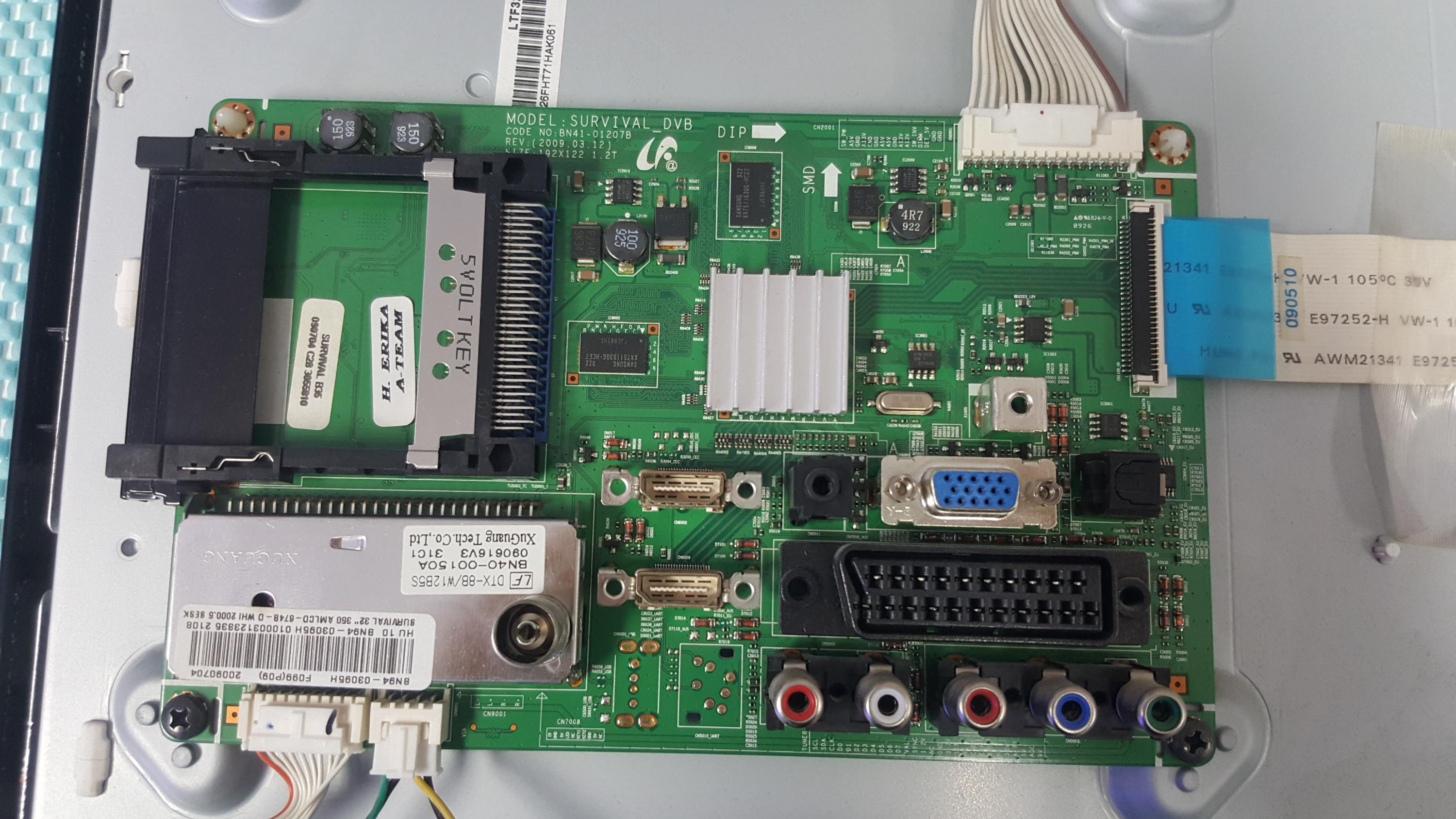

    Hello, the TV turns on with the Samsung sound effect but after 2-3 seconds it turns off and restarts. It's stuck in this bootloop.
    I sprayed the mainboard with freezing spray and the problem went away for about 5 minutes.
    Is this an eprom problem? Will it need to be flashed with a programmer?
    The mainboard is this:

    After solving for 5 minutes enter the service and give the factory reset. Then update to the latest software from the manufacturer. Cool only nand memory.

      I freeze sprayed it again, did the factory reset but the problem still occurs once the nand chip heats up.
      Cannot find the firmware on official site, and after online chatting with Samsung, they told me that they don't provide firmwares for old tvs because there is no point in updating firmware on these TVs. So what do I do now?

        The nand memory must be rewritten with the dedicated software.

            Hi, i don't think the NAND has a problem, i neither see a NAND flash in the picture, check first the PSU>Mainboard cable connectors, detach them and watch for burnt holes/terminals.

              Ok, I just repaired the TV. The bootloop problem was cold joints on the PSU.

                exactly on which type of component?

                  The big transformer and some components around it. Some transistors and their shields.
