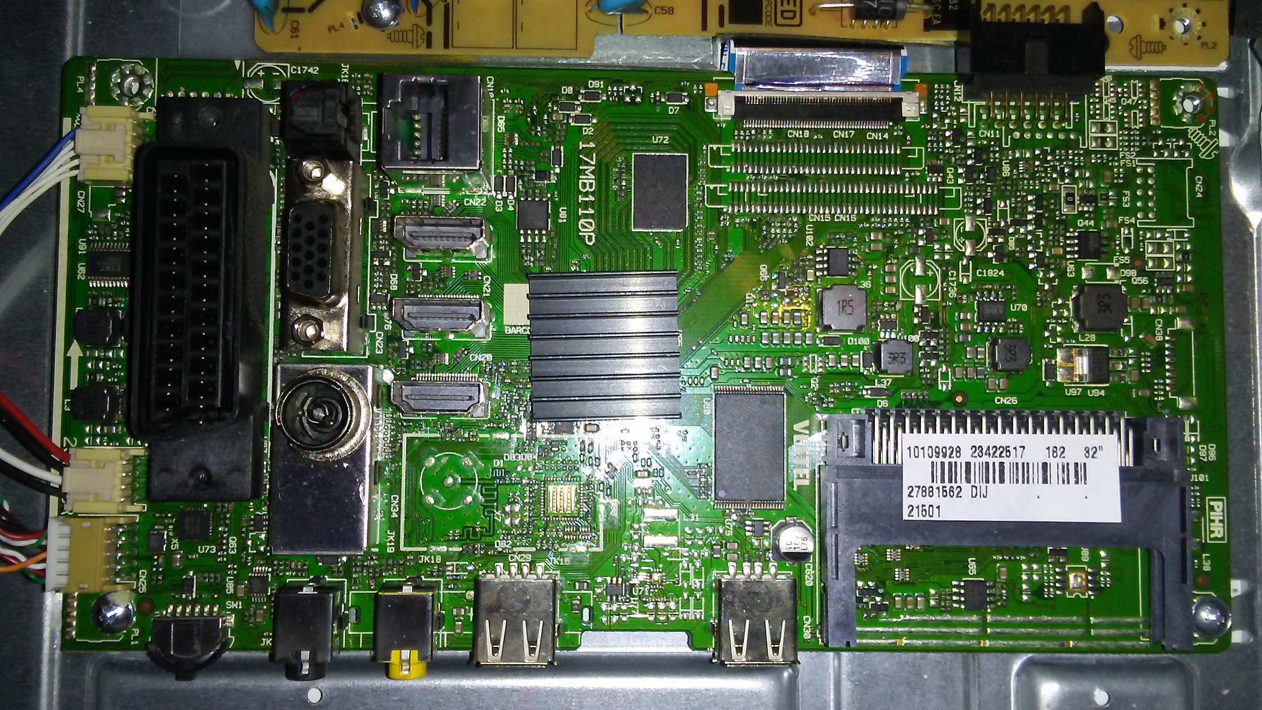

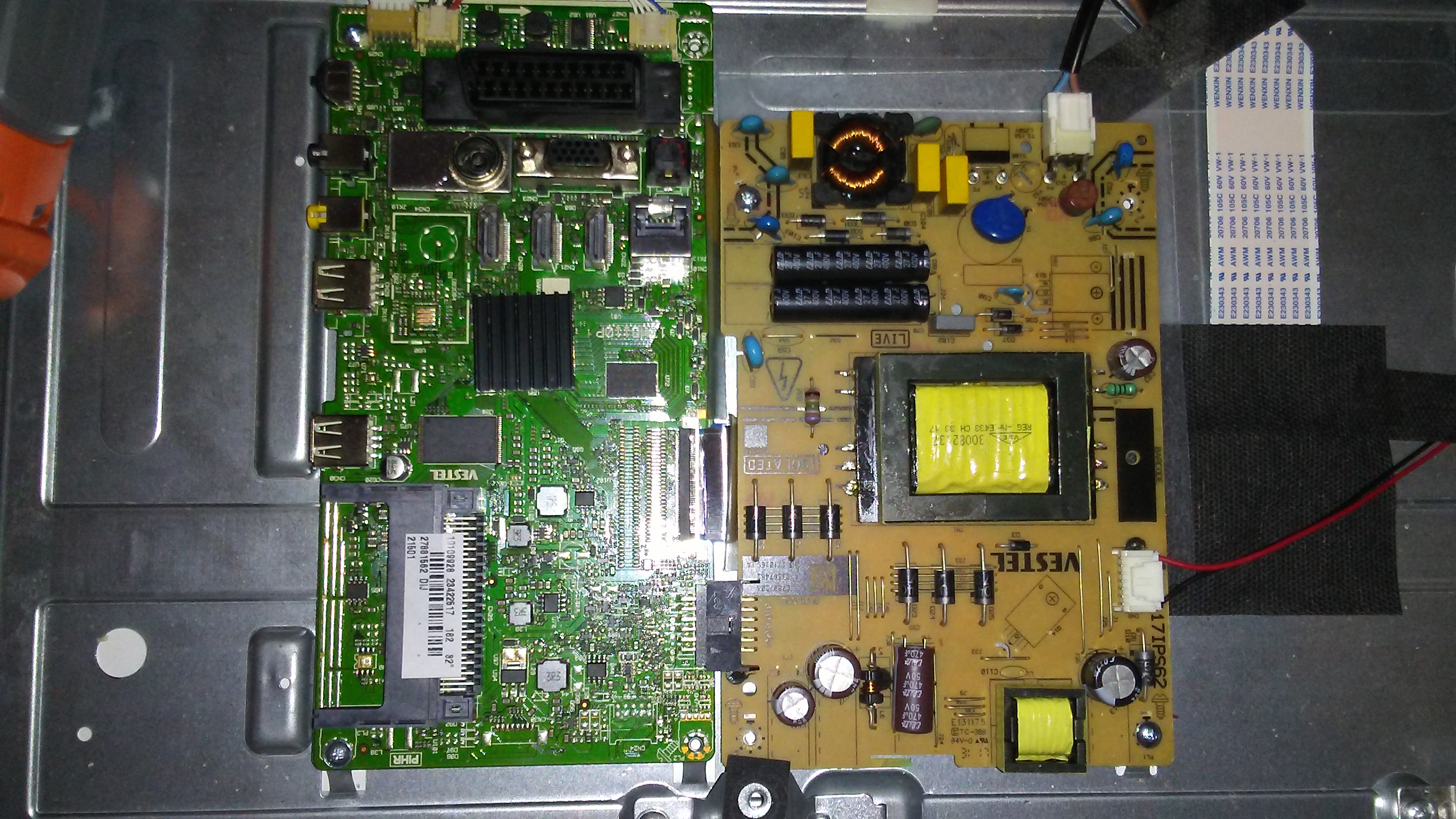

    I'm having a problem with this Toshiba TV. A friend asked me to take a look at it. She said it suddenly stopped working.

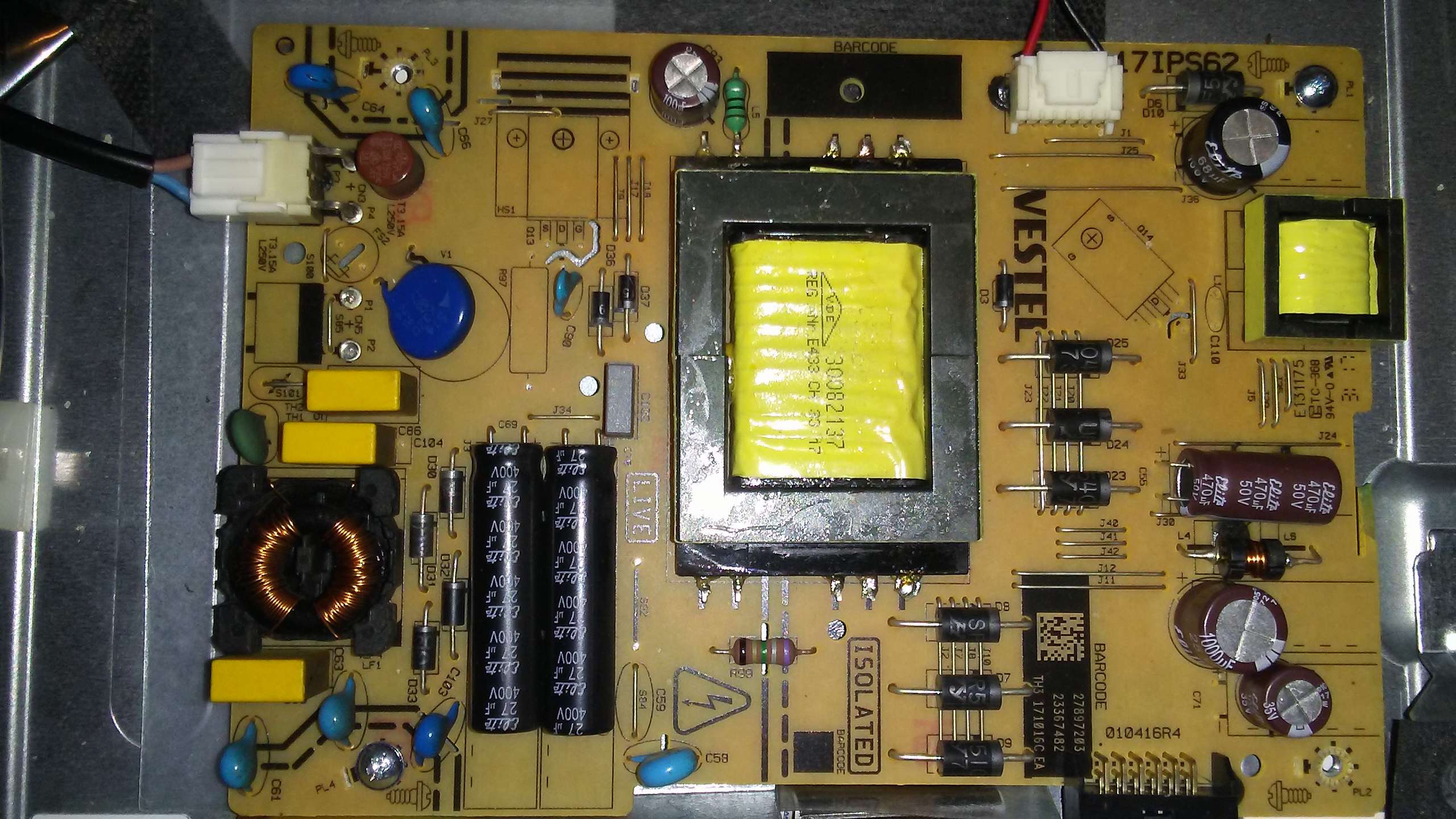

    As a replacement Vestel PSU was only £5 on ebay, I bought and fitted, but made no difference.
    - There is no standby light
    - It does not respond to power button on rear or remote
    - The optical port is lit on the rear, but that's the only sign of life.
    - I measured a 3.3v and 12v supply on the interconnect between psu and mainboard.
    I'm assuming that the PSU is OK, as it is a replacement. But without knowing exactly what to measure for, I'm not 100%
    I downloaded the datasheet for the Vestel 17ips62, and measured (I hope I got this right)
    pin3 - STBY_ON/OFF - 0v
    pin5 - BKL_ON/OFF - 0v
    pin7 - PWM_DIM - 3.36v
    pin11 - 12V - 12v
    I'm assuming the pins on the connector that are accessible are 1-3-5-7-9-11, with 11 (12v) closest to the top of the board.
    I don't really know where to go from here. If I knew it was definitely the mainboard, I'd replace it as they're really cheap. Any help would be greatly appreciated.
    Thanks,
    Will

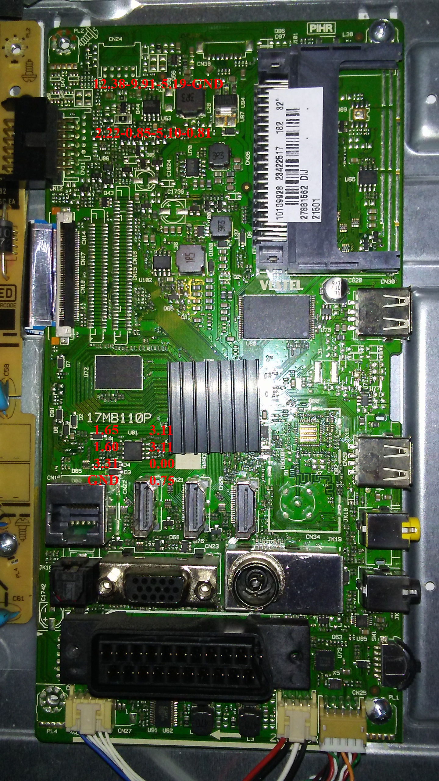

        check output of u63.
        if 5v missing check chassis for short circuit.
        if 5v is normal, check u81.
        if 3v3 is normal rewrite u81.

            Hi, thanks for the tips. I have done a good visual inspection and checked all the diodes and caps (except for 2 I couldn't test in-circuit) OK, and the power board is a new replacement, so I'm 95% sure it's OK, just wanted to confirm what the outputs should be. The Vestel schematic gives no voltages.
            I can access all the pins ok (I have an IC hook probe thingy), I just gave the ones that were not ground or unused.
            I think the problem is elsewhere, probably the mainboard. I just wanted someone to confirm that the outputs I was getting from my PSU were correct before I discounted it completely.
            I was thinking that the STBY_ON/OFF and BKL_ON/OFF were supposed to be at zero until turned on by the mainboard? And that the PWM_DIM was correct at 3.3v? Therefore my PSU was fine...
            That is about as advanced as I get though, so any other suggestions welcome.

              Thanks. I am pretty out of my depth when it comes to this sort of thing. I measured all the voltages of the pins, and have attached an updated image. Sorry if it's a bit hard to read.
              I checked for shorts to ground, but could not find any, but my experience in this is limited.
              What did you mean by "rewrite U81"?

                    i check photo and i think sda/scl signals not correct.
                    rewrite meaning is reinstall spi firmware via flash programmer. if you need dump file send me pm.

                                Your power supply is likely ok. It is common for the eeprom to be corrupt. if this happens the microprocessor does not know what to do, so when it sees the power buton being pushed, it does'nt know that it should issue a power on command to the power supply etc.
                                There is a trick that sometimes works using freeze spray (or an inverted canned air duster)
                                To do this, unplug the tv from the ac, freeze the U81 ic, wait 10~20 sec for the freeze to take, Plug in the tv and try to turn it on. If this works the fault is with the U81 ic.
                                If it does'nt work it could still be a corrupt U81 ic.
