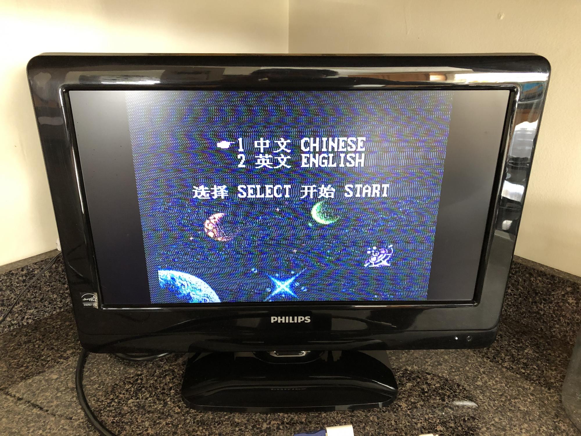

    Phillips LCD - Static on A/V source
    Hello I was wondering if there was a way to clear up the static picture when using a/v input on this tv. It's confirmed that it's the tv itself as testing on others results in a clear picture.
    I've tried cleaning the terminals with fine sandpaper but there's no difference at all. Would it be a circuit issue?

    Re: Phillips LCD - Static on A/V source
    That looks like a bad cap on one of the regulator ic's, likely on the main board. It their output cap. goes bad, as in open, the ic can oscillate causing this type of interferfnce.

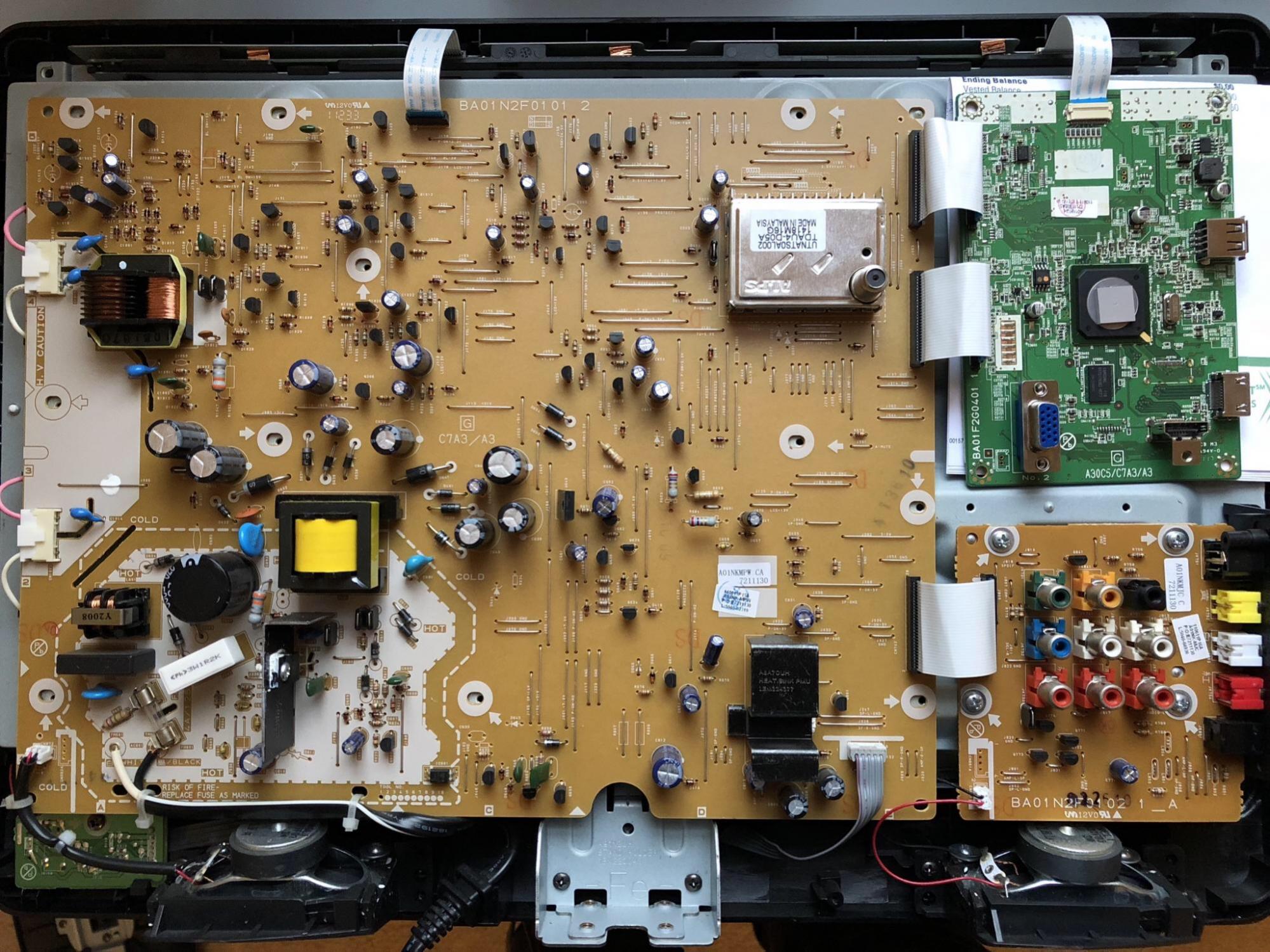

      I only see one cap part of the av board. Bottom right. Would it be that?
        There are a couple caps on the board, top right (Digital Main), I would suspect C3608, the one next to the black coil . I see there are no screws in the power supply/inverter board, was the interference there before the screws were removed?
                  By A/V I will assume composite input or S-Video, So if hdni is ok, then the fault is not likely on the digital board (top right board). I would start by checking if you are missing a ground between the a/v board and the main/power supply board
                  If the problem is with the VIDEO input, check the trace for in the signal path, maybe there is a poor connection on one of the ribbon cables between the boards
                  If there is a poor ground for the video board, you will be picking up noise from the ccfl high voltage circuit which will interfere with the video signal.
                    Visually checking all connections to the a/v board. Solder joints all look good too. I tried removing the ribbon cable and cleaning the contacts but that didn’t do anything.
                                      Don't you have the service manual for this tv? It sure looks like the video ground is not making contact, If you pull out the video plug so the rca ground is not connecting does it change the interference? I can't see why you can't get a video signal on the component input. that would also check a different input that comes from the a/v board
                                        If I pull out the video plug where the ground isn't connected the interference does change but still not clear. No video signal when I try on component input. Do you think it's related?
