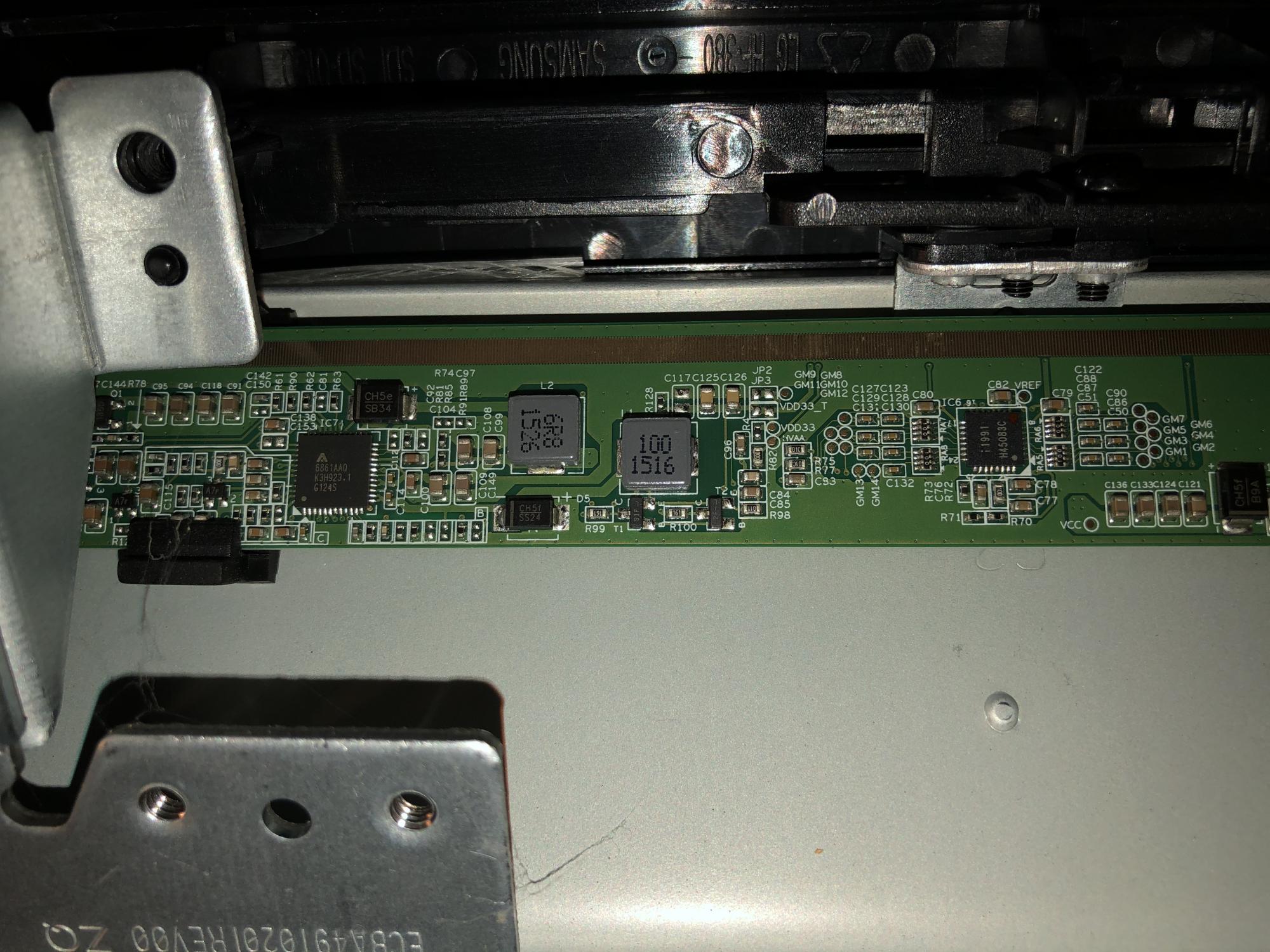

    Re: Toshiba 55L310U Rev. A No picture Good Backlight Replaced Main and Power boards.

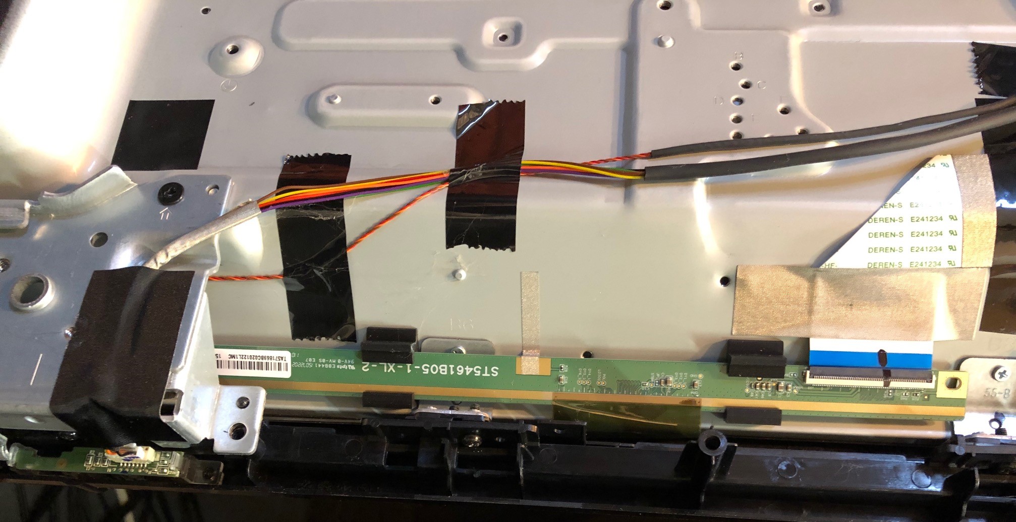

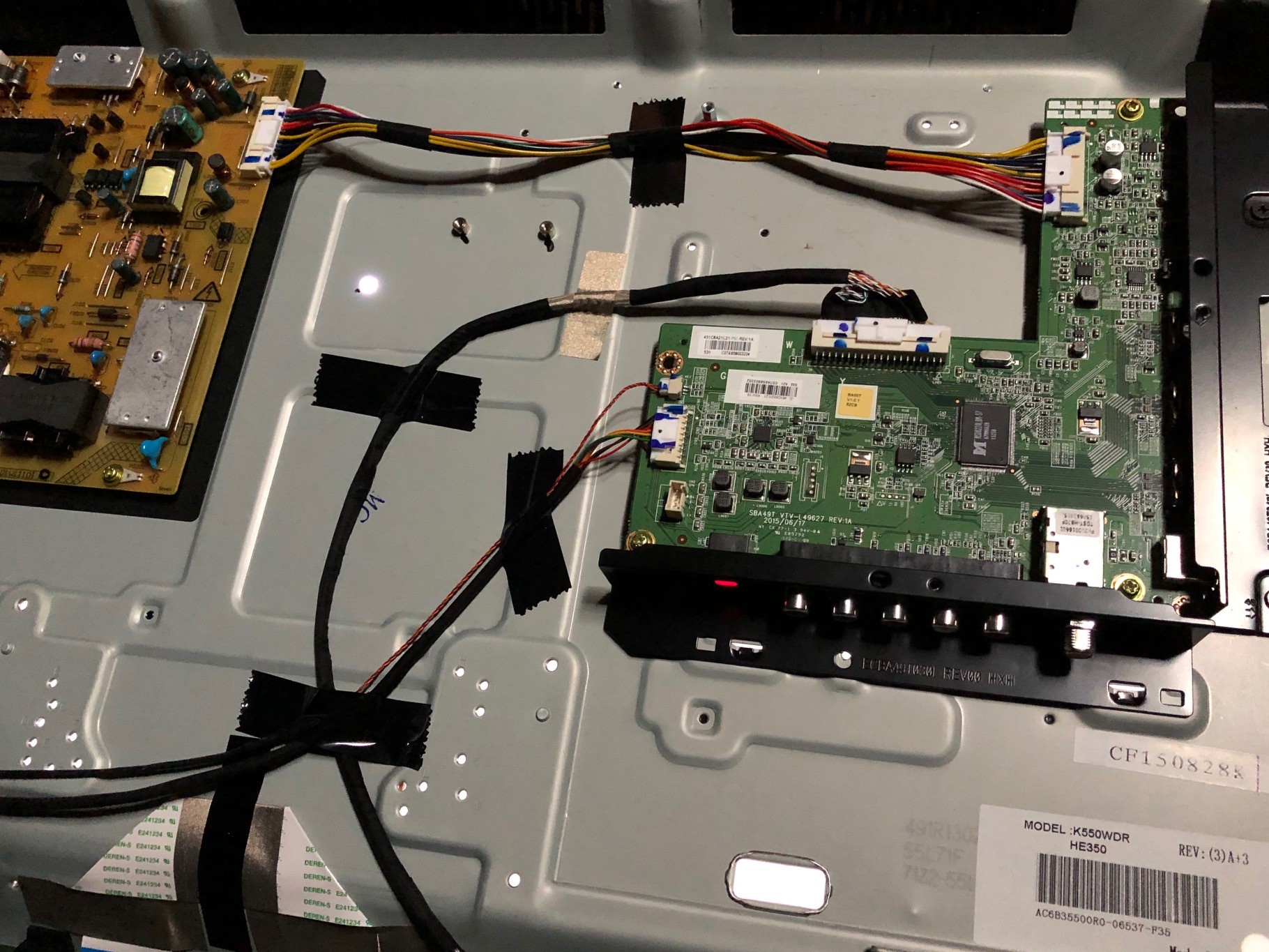

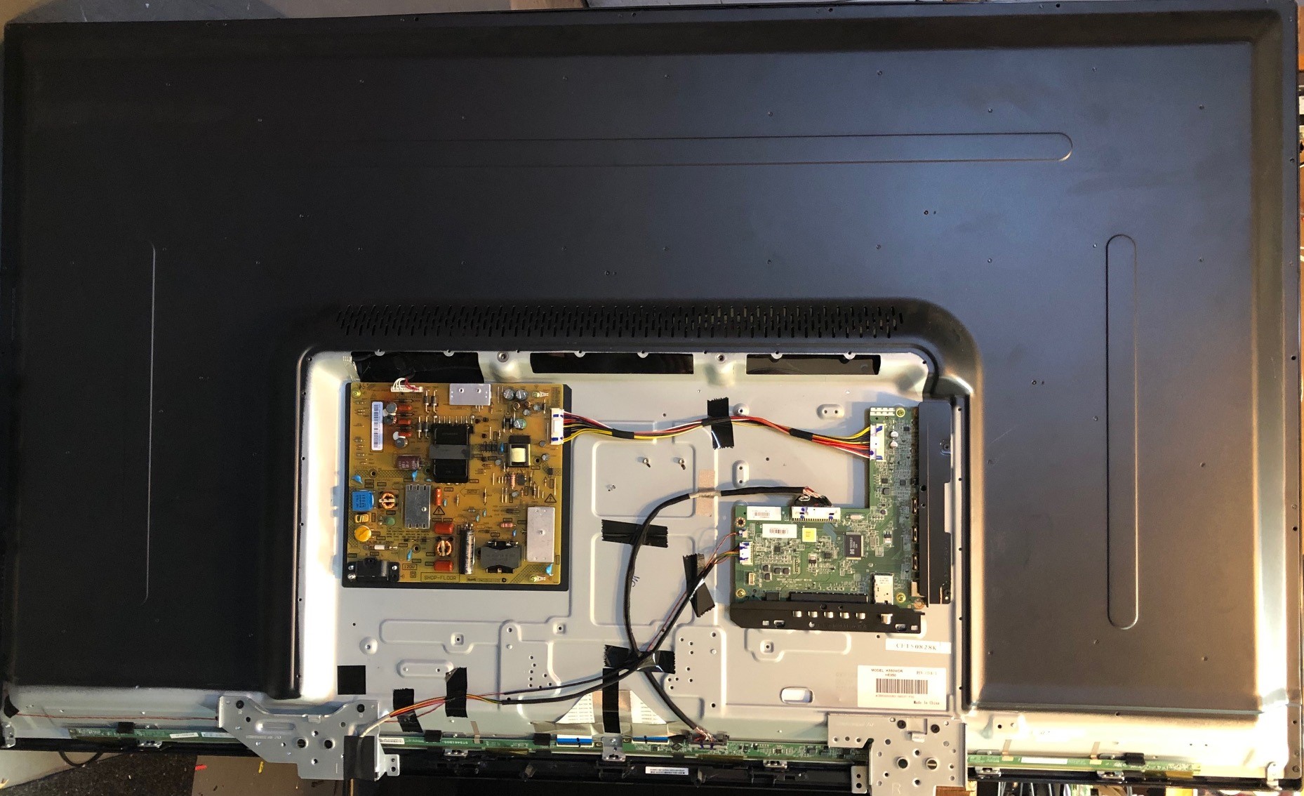

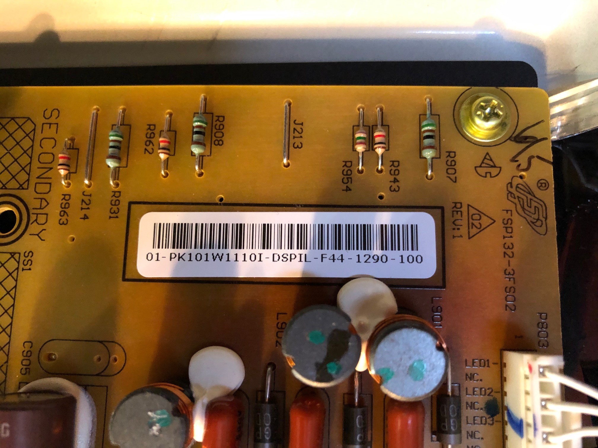

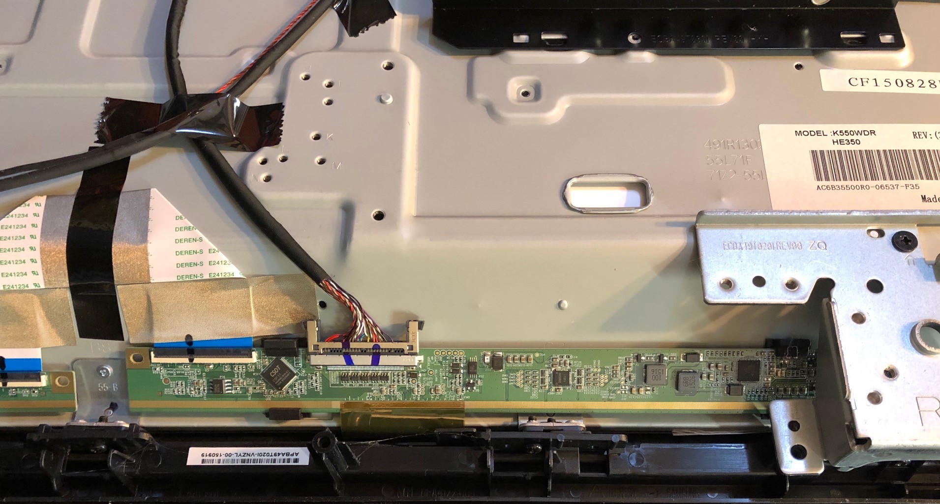

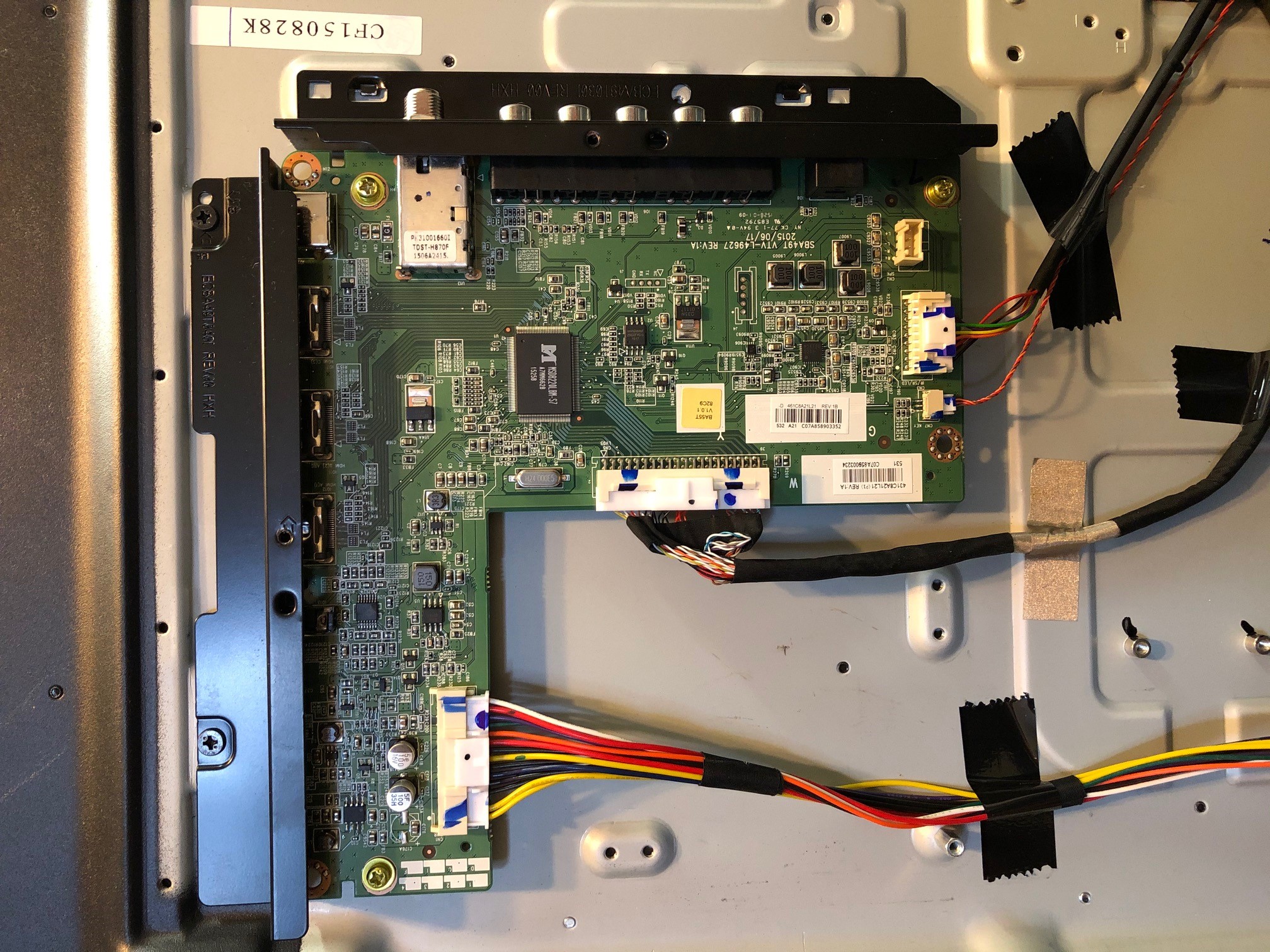

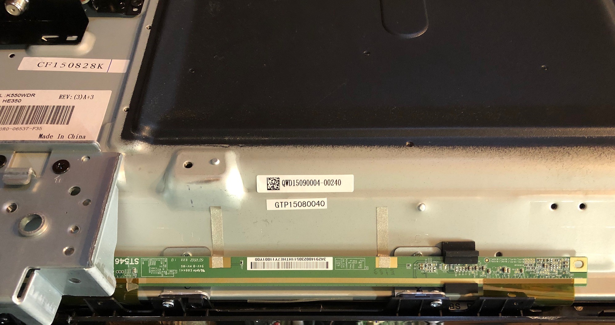

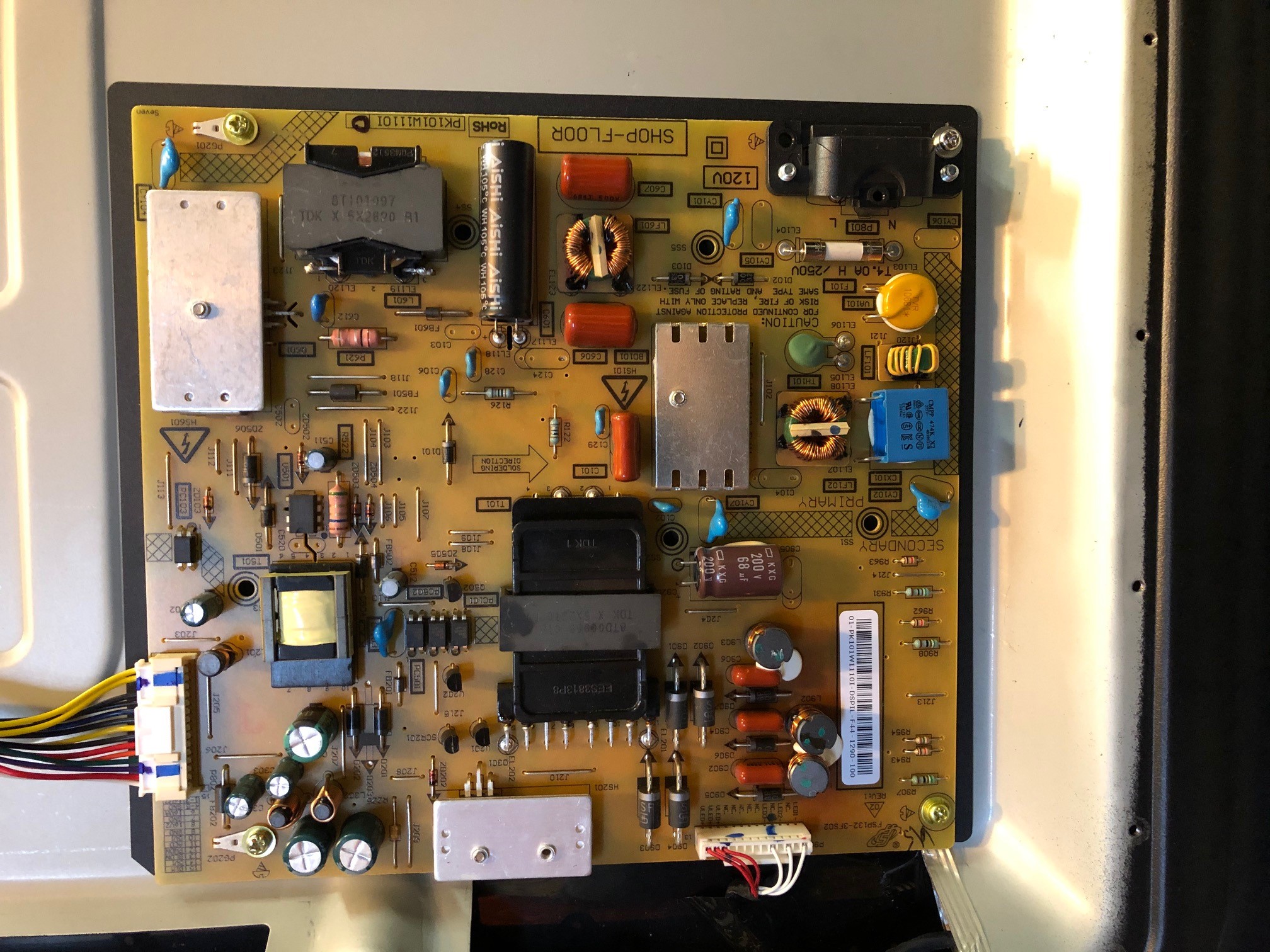

    We need good clear pictures of the whole backside of the TV showing all the boards so we can see what we are dealing with.

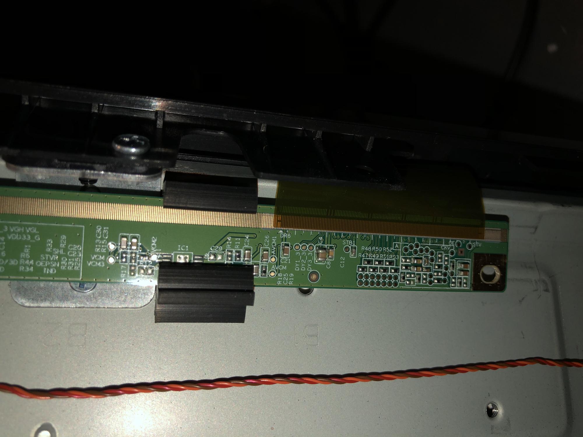

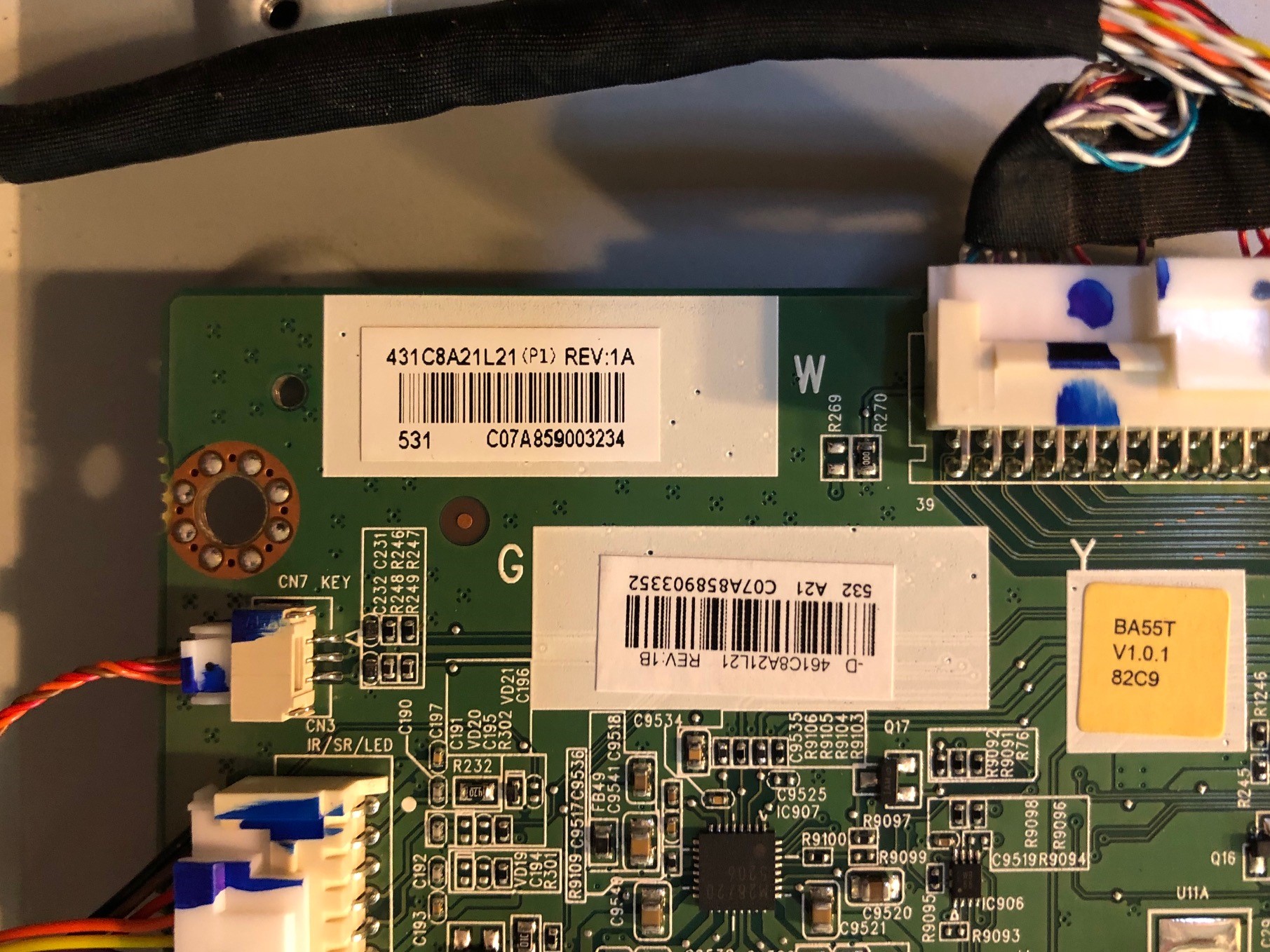

      Thank you for the reply. Here are some photos. Hope this will help you help me!
      Thank you!

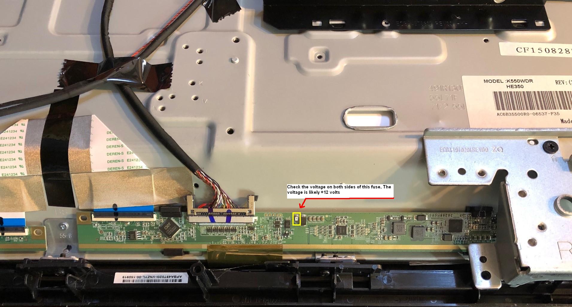

        Check the voltage on the fuse on the integrated t-con board, It is usually +12 volts, check for voltage on both sides of the fuse
          Yep. 12v on both sides...

              Try disconnecting that white flat ribbon between the two tab bonding/T-con boards to see what you will get on the screeen.
              You will also need to test Voltages at VGH, VGL, AVDD, ect. test points on that integrated T-CON board.

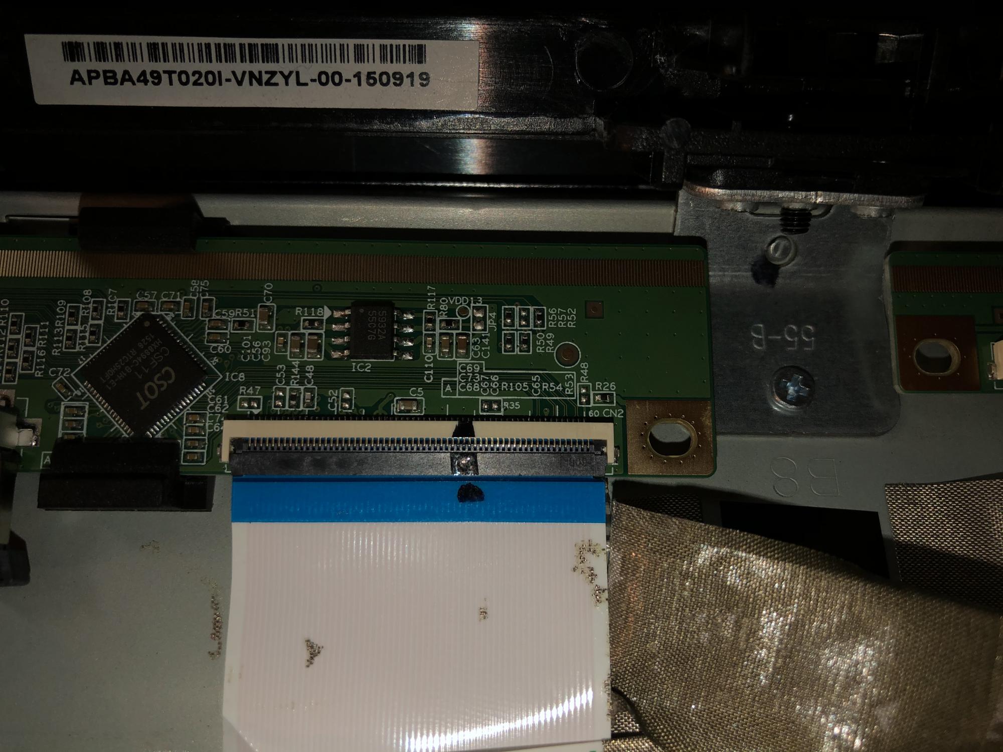

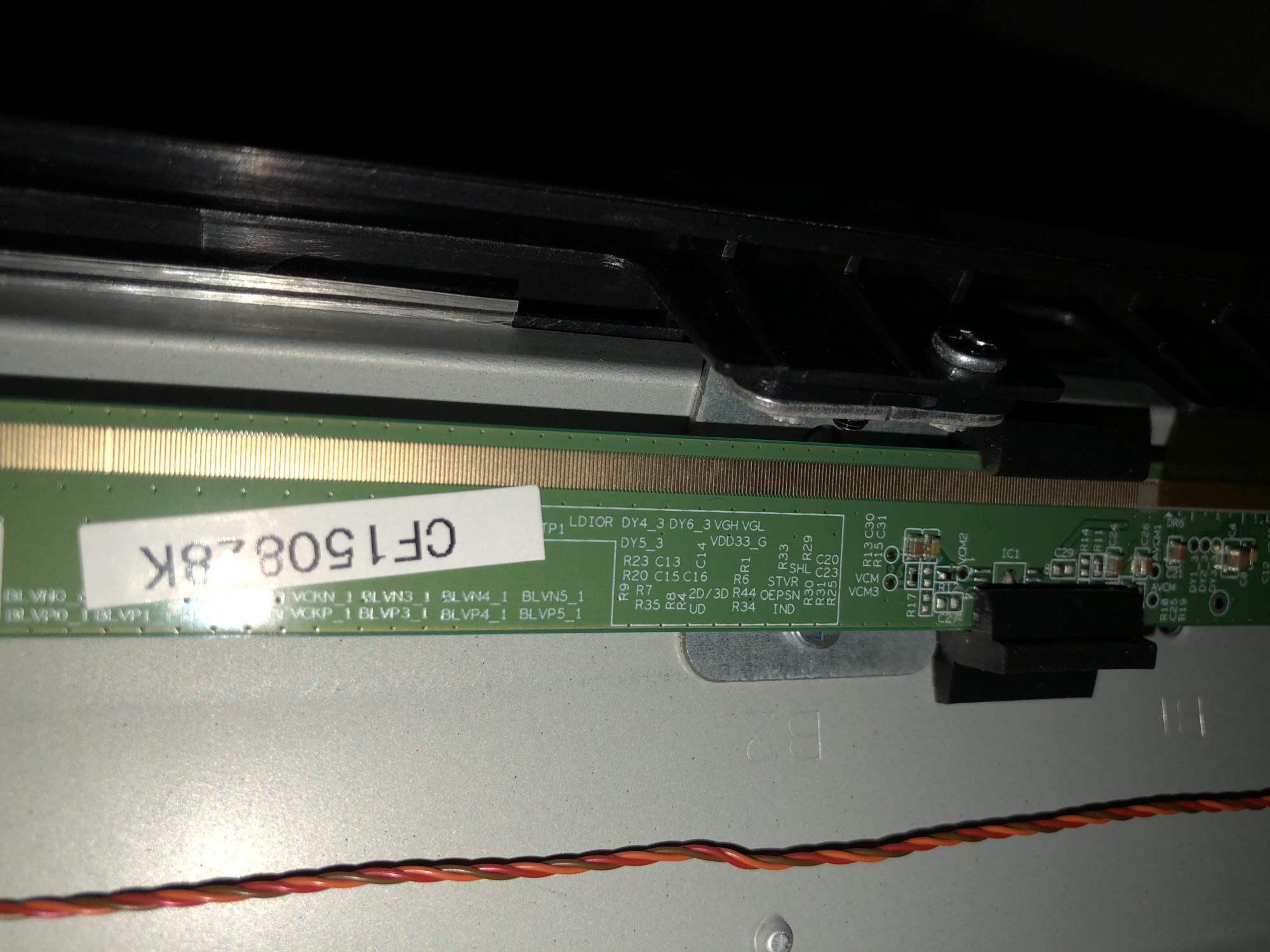

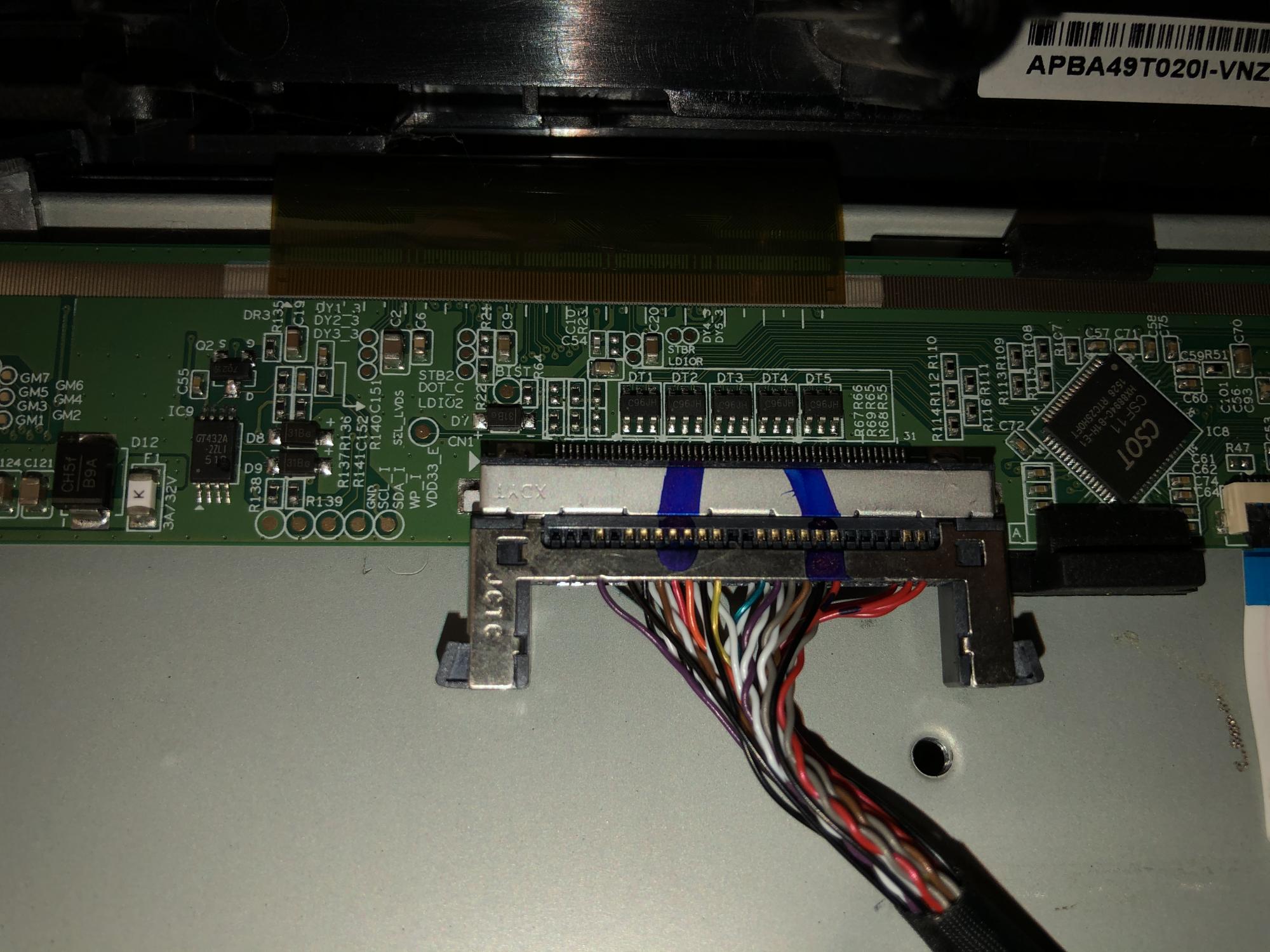

                  I am also not sure where to test voltages... I don't see any voltages printed on the board...

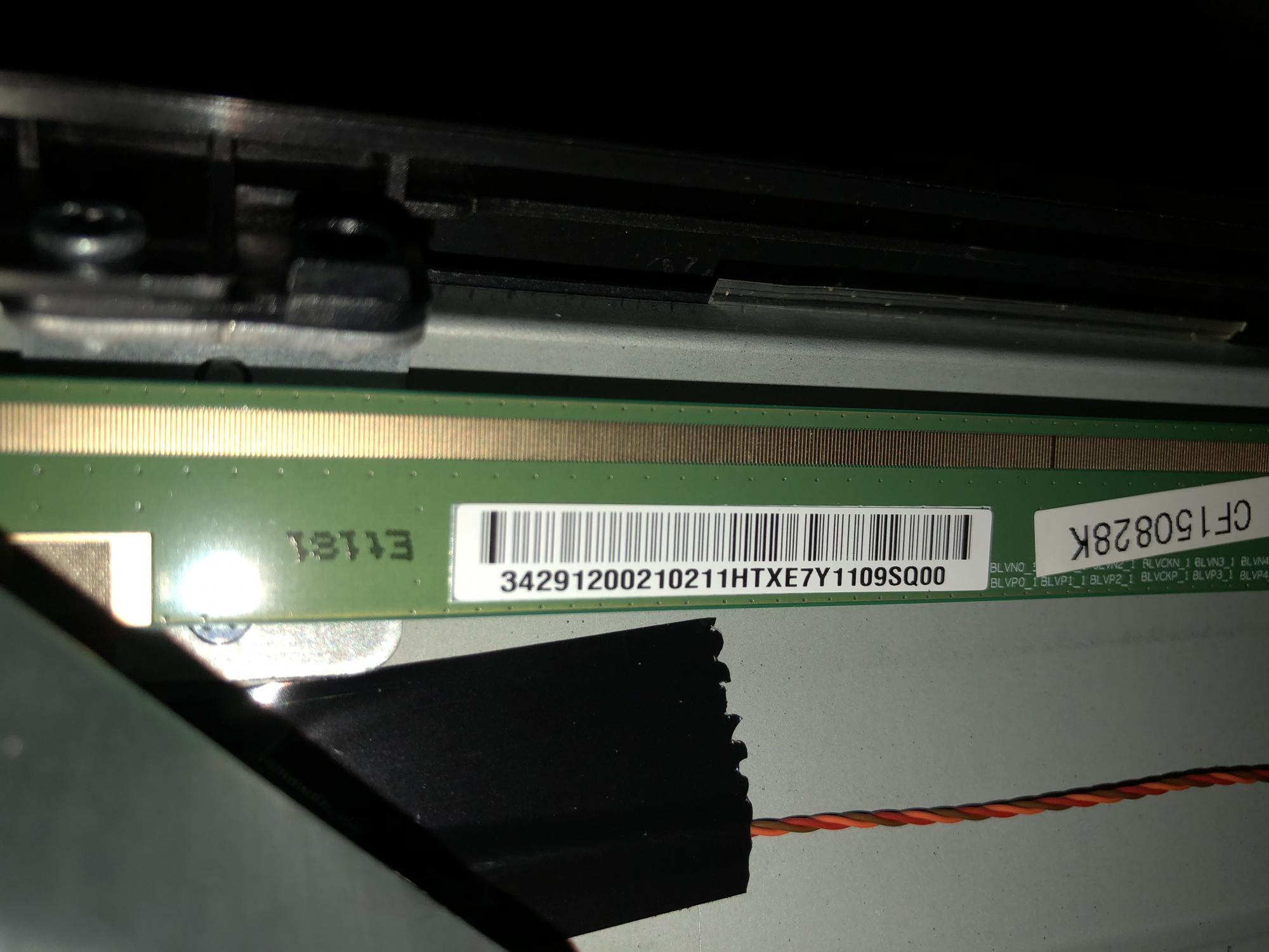

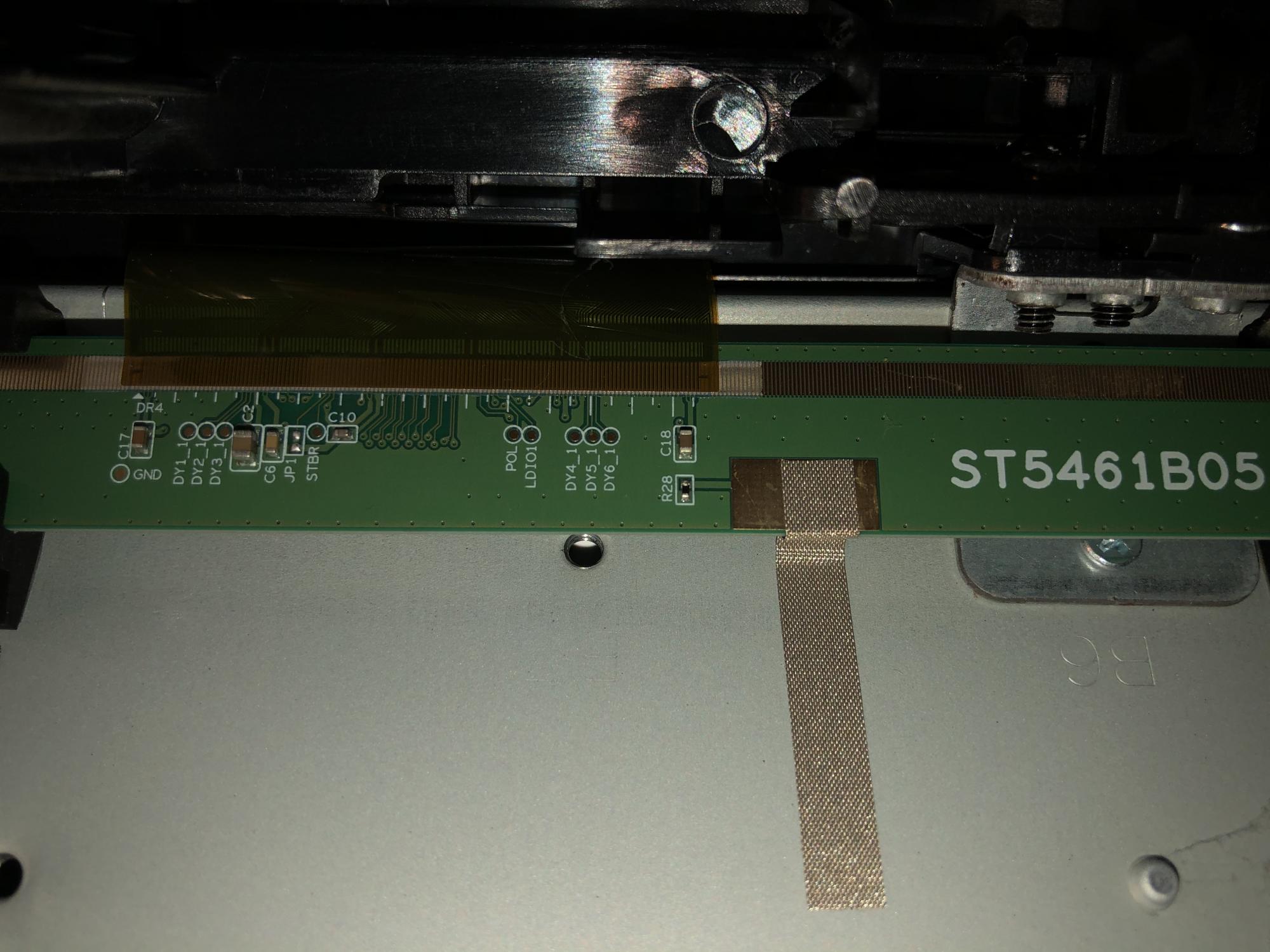

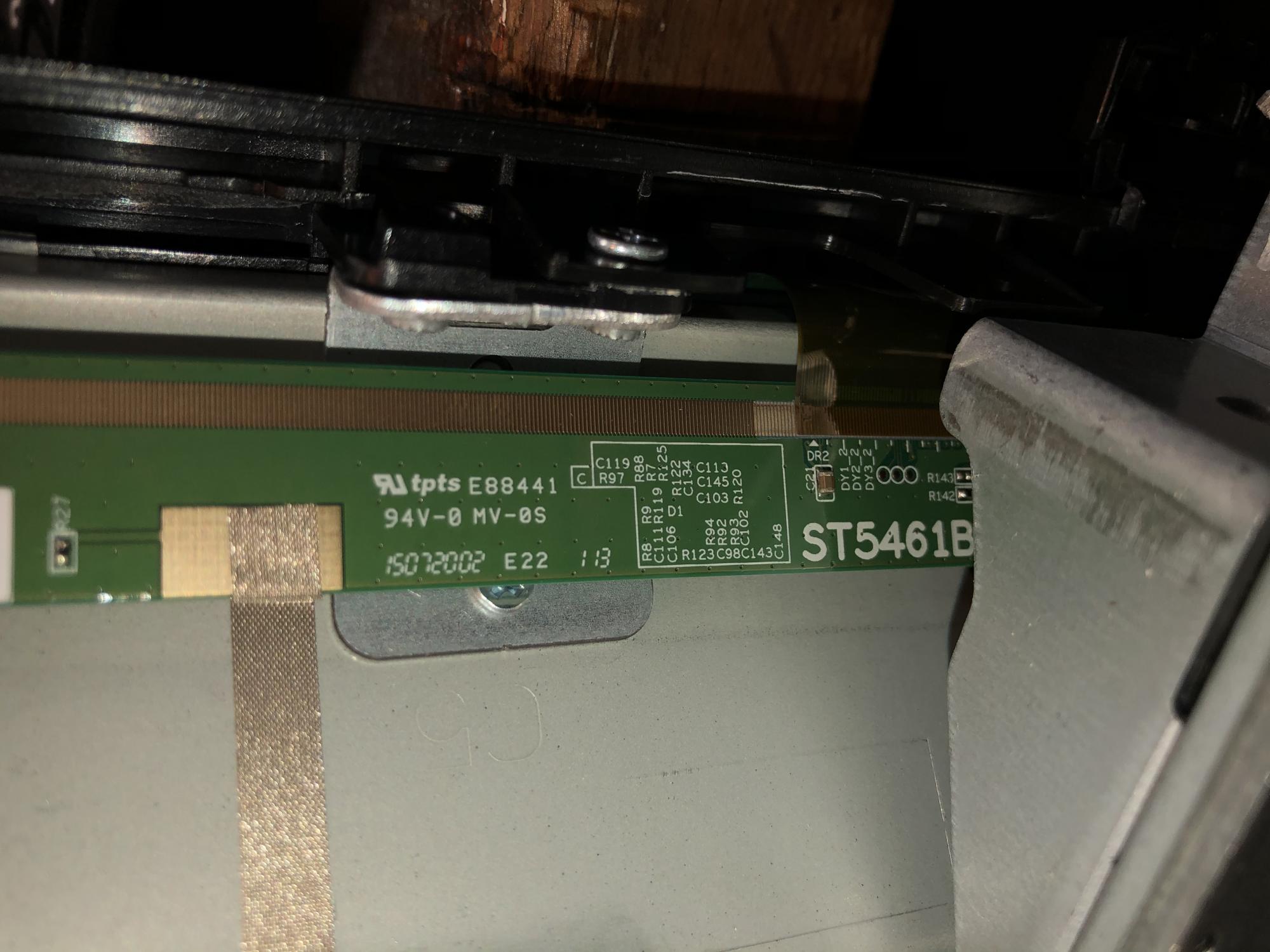

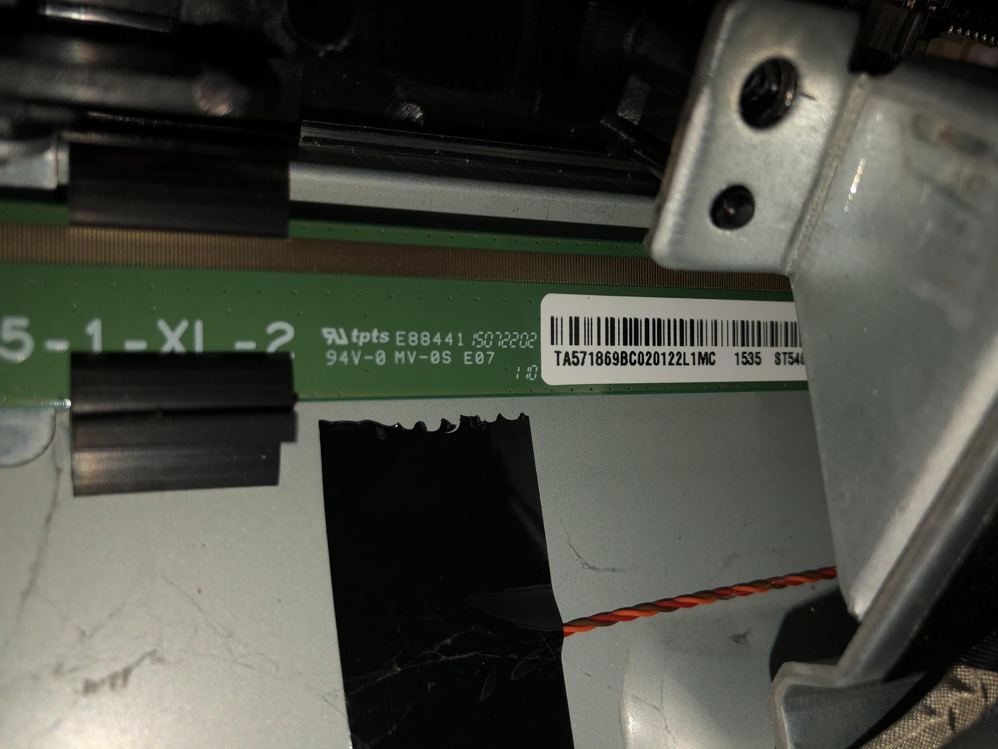

                    You need to look for the Voltage test points on that T-CON board, your pictures are not clear enough to see them or if they provide the test points or not.

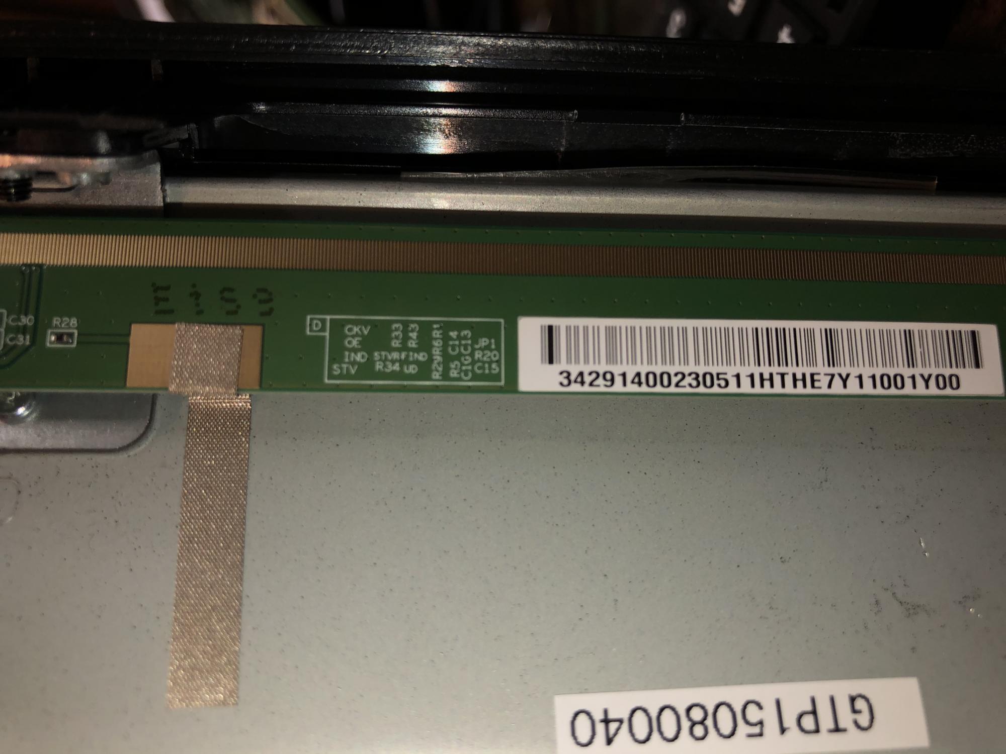

                      Here are some more photos.

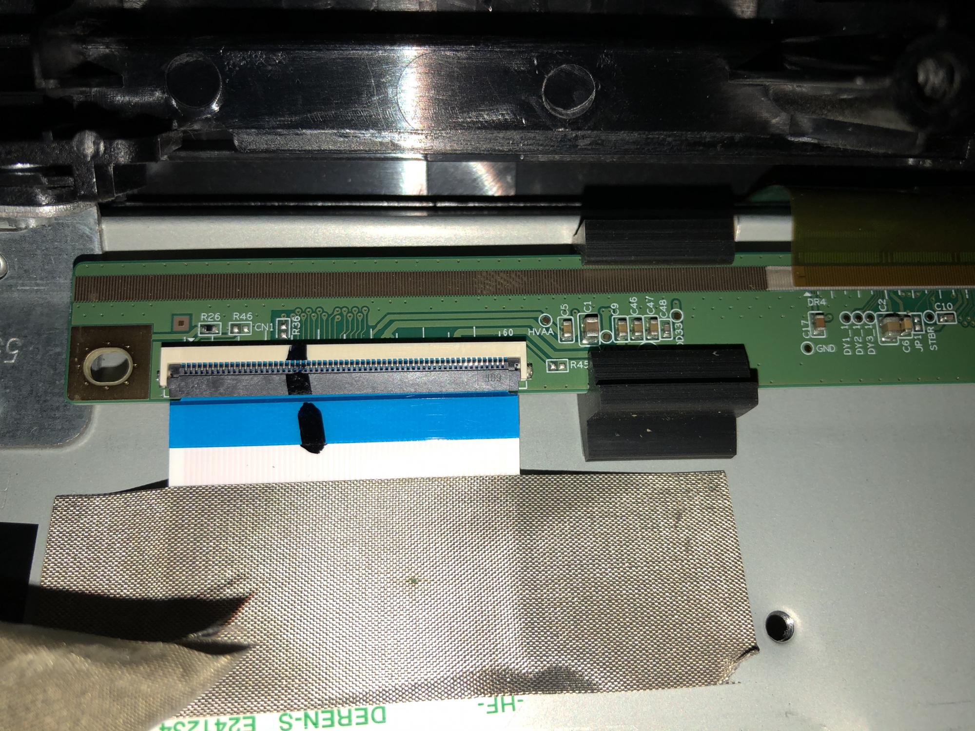

                      • mkoser
                        • Nov 2019
                        • 13
                        Sorry. Here they are.

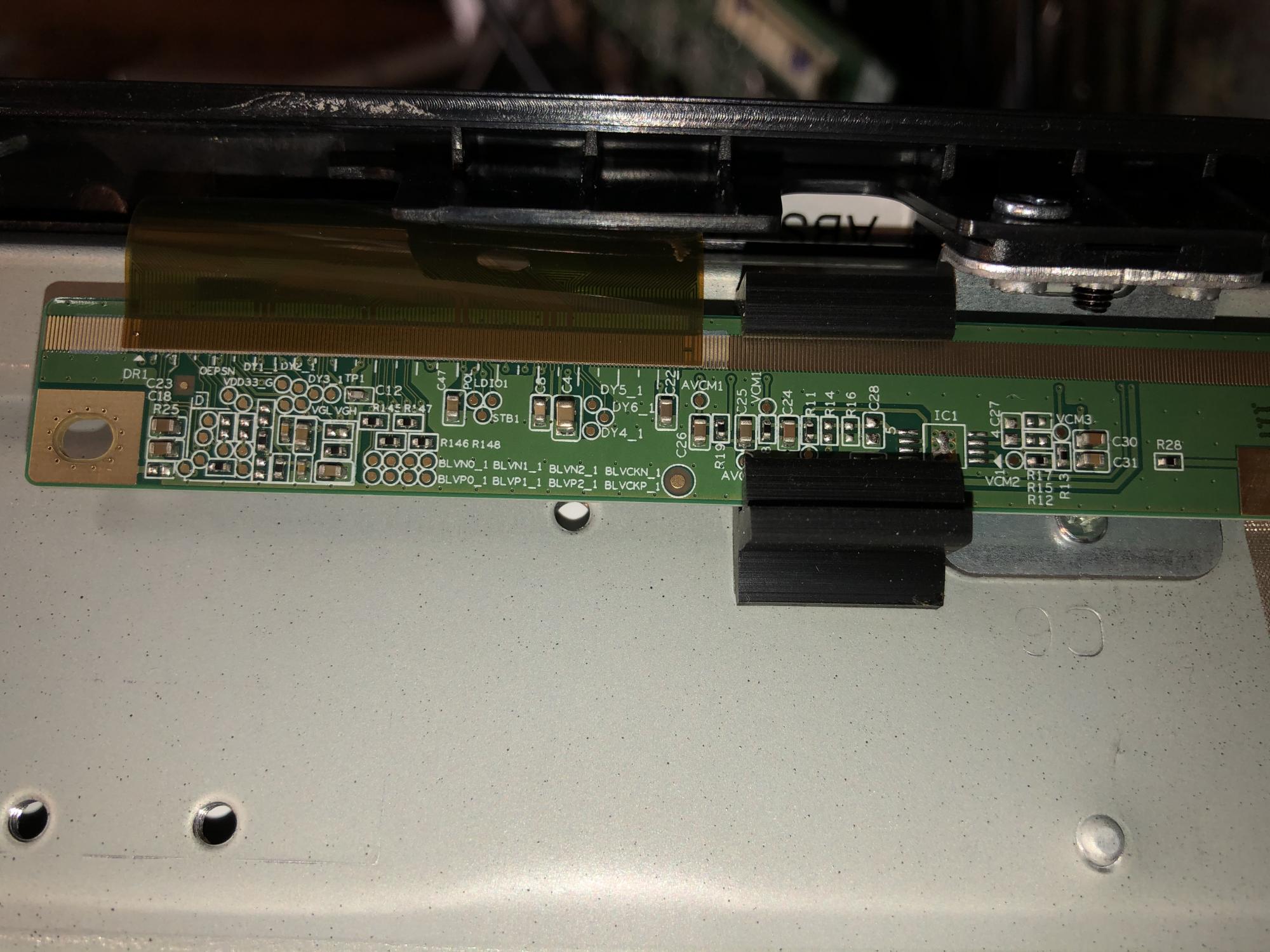

                        • mkoser
                          • Nov 2019
                          • 13
                          Last two.
                            Example: https://www.badcaps.net/forum/attach...0&d=1573089237
                            You can see VDD13 test point.
                            More here: https://www.badcaps.net/forum/attach...5&d=1573089237
                            VGA, VGH, etc.
                            BTW, you do know how to remove/install SMD devices, correct?

                              VDD13 1.3v
                              VGA -5.4v
                              VGH 23.9v
                              Do these seem correct? Again. Please excuse me noobness.
                                VDD13 1.3v
                                VGA -5.4v
                                VGH 23.9v
                                My typo for VGA, it is VGL.
                                The Voltages look correct, but you also need to find AVDD, it is used for running the COF.
