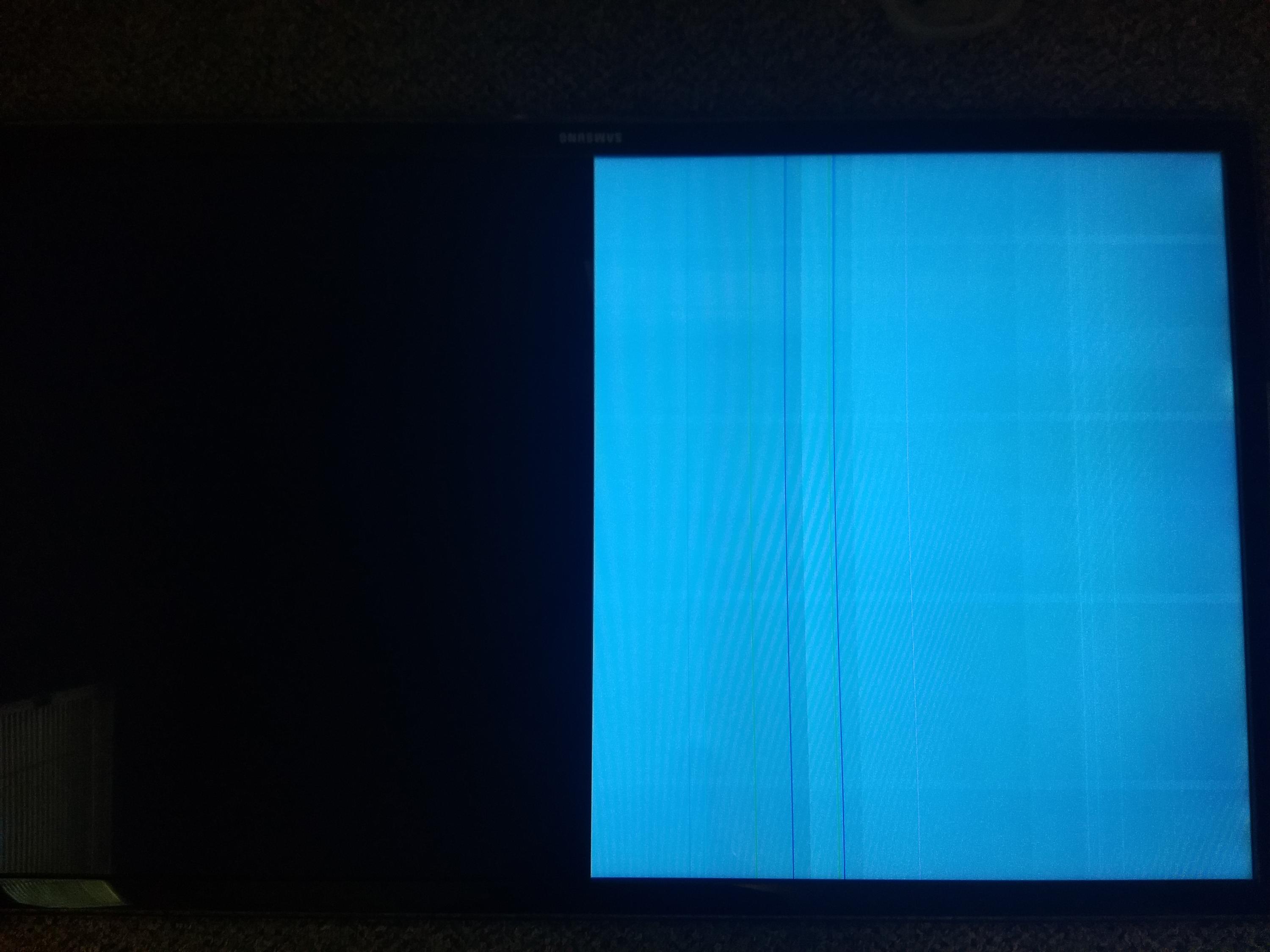

                              Re: Samsung UN55D6005SF
                              Good, so lets try again with having ribbon cable between T-CON and the LCD panel connected one at time to see what you will get, I want to see if you can get good half the screen and how long the image will stay on the screen.
                                  Ok please forgive the horrible pictures but when i disconnect the left tab and power on i get half the splash logo on the right but now on the left that is white vertical lines start to appear on the screen. Starts off as a single line and the longer it stays on the more that appear. If i disconnect the right side i get the exact same effects just opposite.

                                    Originally posted by nomoresonys View Post
                                    Tcon issue?
                                    No, seems like a bad mainboard, forgot I already suggested it in post #7.
