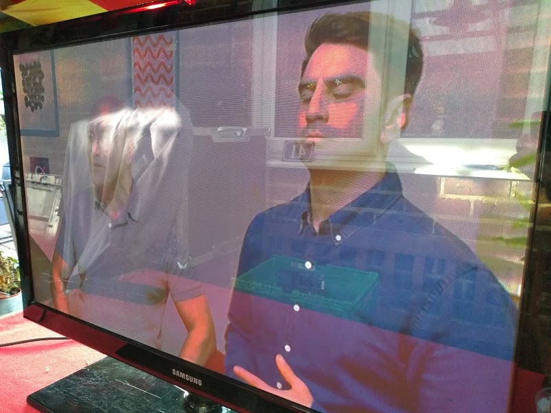

    Hi All,
    I'm just starting to look at this 7 year old Samsung PS42C450B1W that, on first power up the picture is fine. Then, after a few minutes, the picture becomes distorted with highlight noise and solarization effects. This is present on tuned images along with USB sourced video files.
    On brief inspection there was no obvious visible bad caps, etc.
    Looking at threads related to solarization, many point to the T-Con board (named logic board in this service manual)
    Before I dive in and start measuring voltages, are there any general pointers for this kind of fault?

      Re: Samsung PS42C450B1W Picture Noise/Solarization
      I assume you mean the inbuilt test patterns accessed via the Service Mode.
      If so, each test pattern displays varying amounts of the distortion I describe above.
      Does this indicate the main board is suspect?

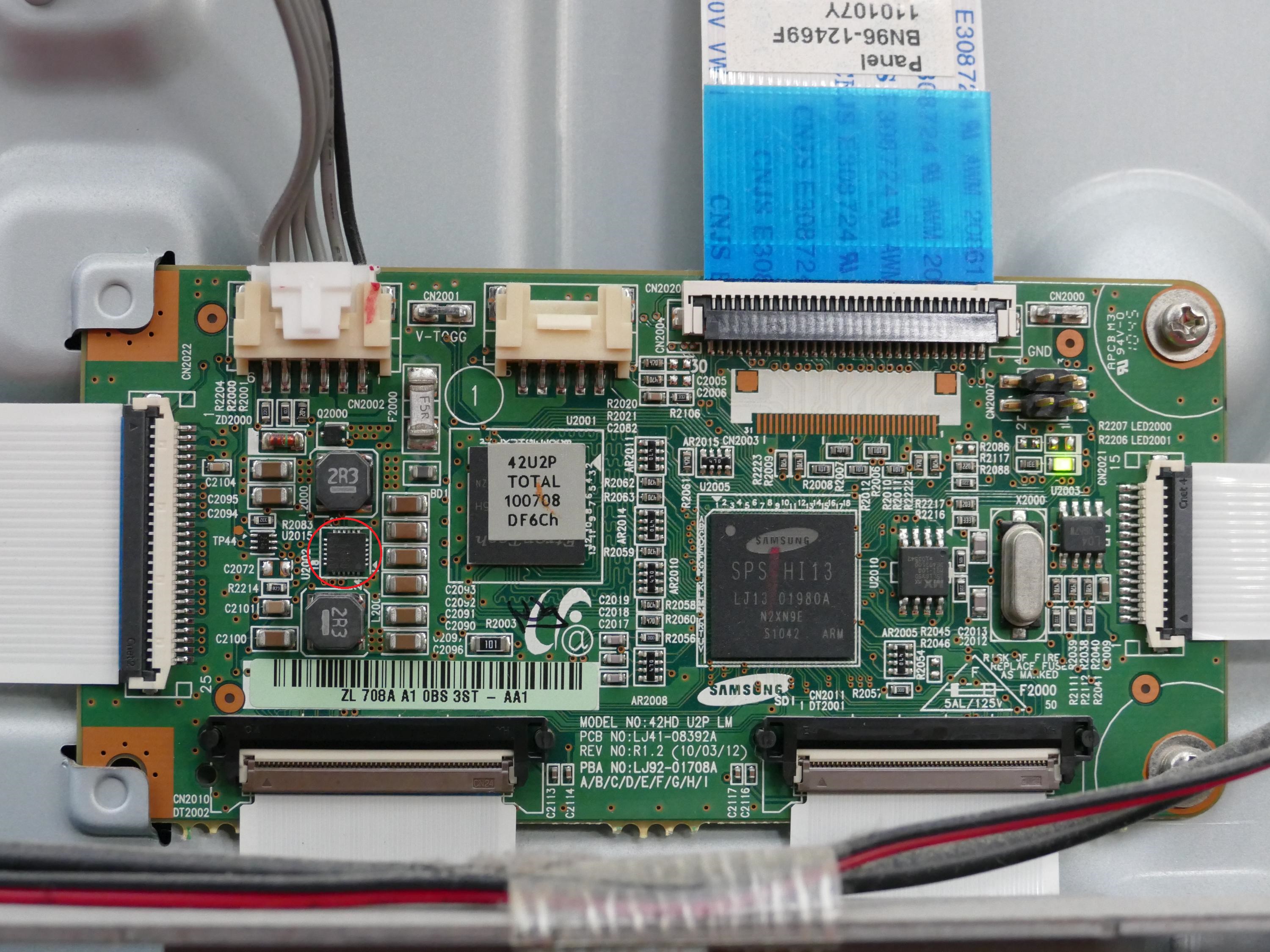

                Following the instructions in the post you cite I am in service mode born out of the T-Con board.
                It is cycling though the various test patterns and displays the solarization distortion I described above.
                What can be concluded and Is there a component level fix possible for this fault?
                • yokoono
                  • Apr 2010
                  • 475
                  What writes on the IC surrounded by red?

                    • Nevillet
                      • Sep 2019
                      • 272
                      • United Kingdom
                      Hi
                      The IC you indicated has no markings (checked with microscope)
                        I've just ordered the t-con board from eBay.
                        BTW: It still has the same fault: When it first turns on it's fine but after a couple of minutes it exhibits the solarisation effect fault.
                              I installed the replacement T-con board but unfortunately the symptoms remain the same:
                              Good picture immediately after switch on. After a couple of minutes the picture becomes distorted on the highlights, similar to solarization.
                              Can you suggest any next steps?

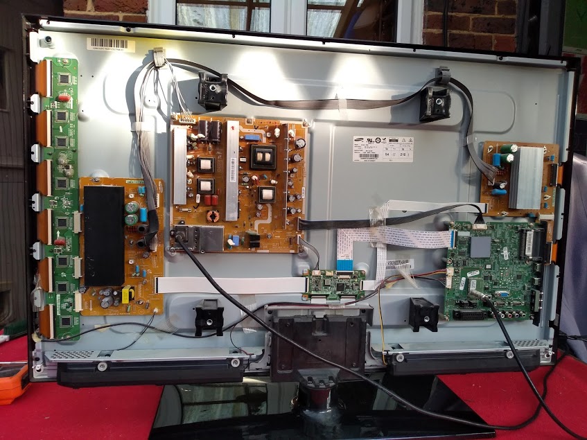

                              • dick_barton
                                • Aug 2015
                                • 6642
                                • Wales
                                That's a pity. Can you check your voltages as given on page 56 of the manual. The correct voltages for your set will be as given on the voltage label on your set.
