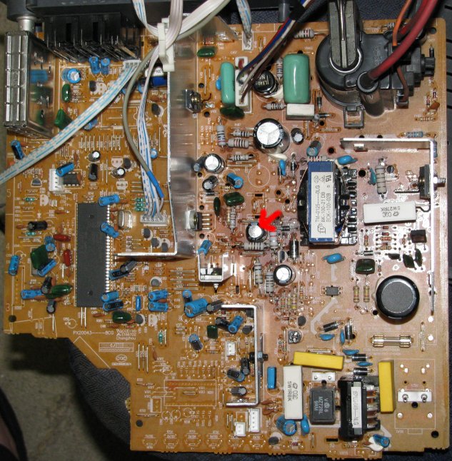

    Today, I was given a GVA HGG3440 (most likely a Hisense) to repair, which was said to be about a year old.
    Upon removing the back, C553 (1000uF 25V) on the +12V rail was bulging.
    The following capacitors were replaced with low-ESR units:
    From the power transformer: C551 (+110V), C562 (+25V - upgraded from 330uF to 1000uF), C553 (+12V), C554 (+12.5V)
    From the flyback: C477 (+200V), C471 (-13.5V) and C474 (+13.5V).
    The 400V unit was replaced with a better quality unit.
    After replacing these capacitors, the set was turned on and all of the voltage rails were within specification.

    Re: GVA HGG3440 - easy fix
    Worked on several versions of these. Designed sloppily and to the minimum. Terrible solder and worse than fuuuyhi capacitors.
      Dang!! Look at all the pins on that IC!
      It must literally do everything.
      Most CRTs I see have at least 4-6 ICs inside handling the signals.
        thats just the jungle.
        the cpu is a qfp on the bottom.
          kc8adu,
          Yes, it is IT, *everything* in that giant IC, I know because worked on plenty and knew what it is. Anything else is either audio processing IC or inputs switcher IC.
          To old farts, that big IC is combined micro, jungle, deflection drive outputs, pre video and pre-audio processing. 8 pin IC is serial eeprom to hold settings (factory and user) only, the firmware is fixed permenantly in the big IC and have I2C bus for controlling audio processor if it has one, tuner, video/audio switch IC if equipped.
          Does really good job for what big IC were. What ruins or improve the quality of picture is how is the circuit around this big IC was designed. I have a JVC 27" with this big IC and it is genuine JVC chassis and have excellent picture.
