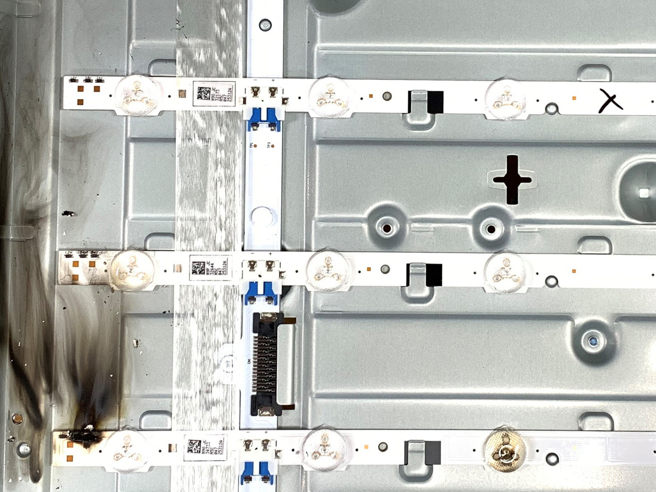

    Hi again! I've had great success with repairing several LCD monitors and TVs with the help of the friendly members here.
    I recently rescued a Samsung UN55F6350AFXZA from the curb.

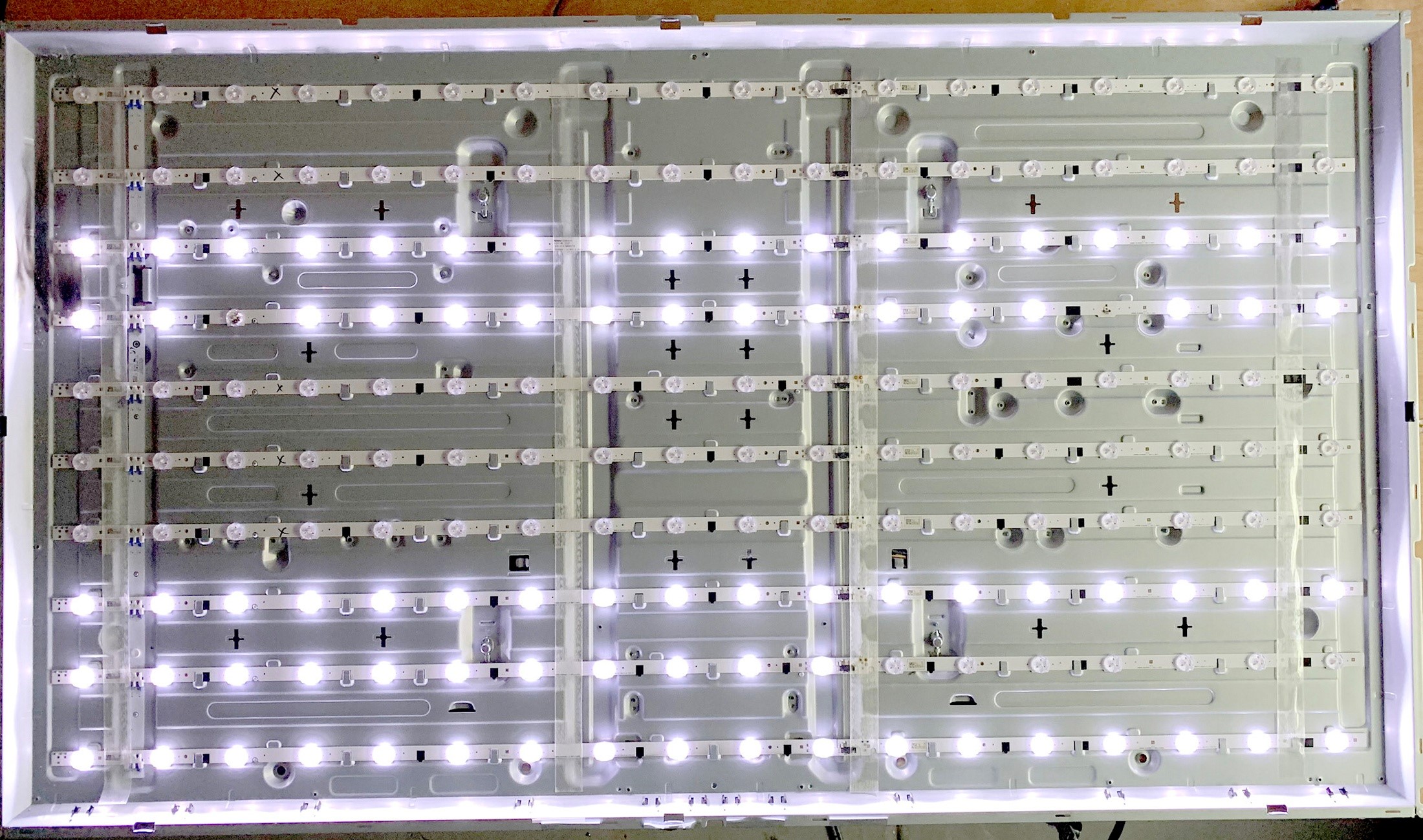

    I powered it up and let it run for about an hour. It seemed to work fine other than half of the backlights not functioning, and a dark splotch near the upper left corner of the screen.
    I disassembled it and found some scorched components on one of the backlight strips. There are also components on other strips that appear to have been overheated, with discoloration showing through the mounting tape.

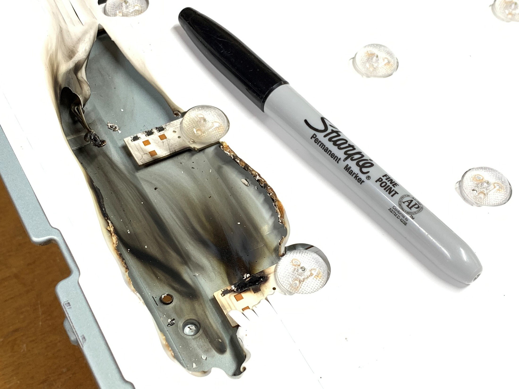

    The dark splotch seems to have been caused by the missing section of the reflector and soot on the diffuser. I shined a powerful flashlight through the screen while displaying an image and it appears undamaged.
    Oddly, all but two of the LEDs on the scorched strip are still functioning. The third LED from the scorched area gets very hot, and I can smell the small lens melting.
    Will a full set of new replacement backlight strips remedy the issue?
    Is there possibly a separate root cause further back in the circuit that needs to be addressed first?
    Thanks for any help you can offer!

    I would replace all the strips.

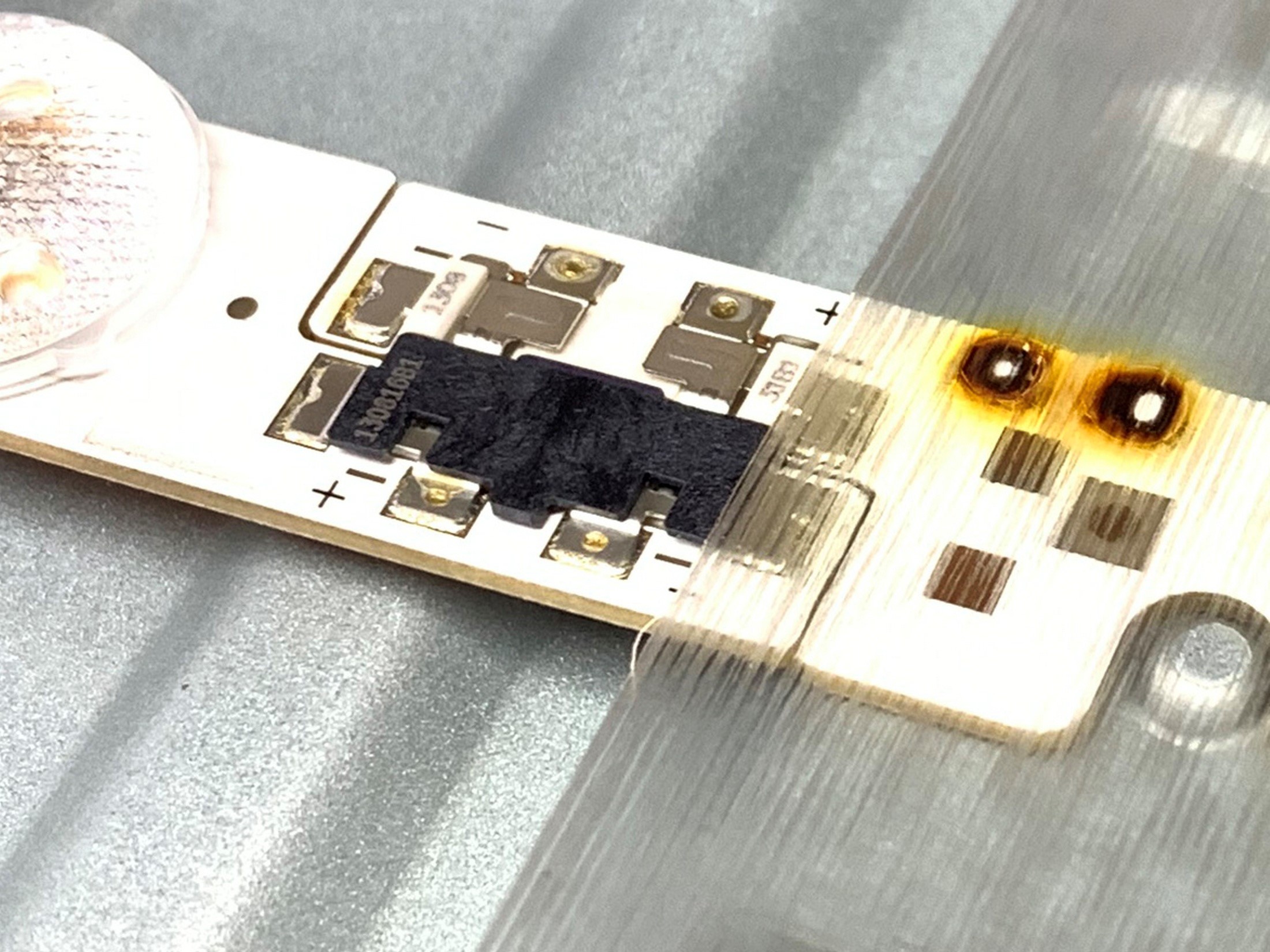

    That looks like poor solder joints that heated up.
    https://www.badcaps.net/forum/attach...1&d=1567020745
    Those 3 black SMD devices look to be part of the protection circuit.
    You are lucky that the panel did not catch on bigger fire and burn down the house. when you finish the repair, male sure to turn down the backlights level on all inputs to as low as possible. They drive the LED's way too hard so they fail very often.

              While I wait, I’ll stay busy attempting to patch the burn hole in the paper reflector. Any suggestions?
              I plan on rotating the reflector and the diffuser panels so that any minor difference in light with be in the lower right corner of the screen rather than the upper left.

                    The replacement backlight strips arrived a couple days ago.
                    I managed to install them and get the TV reassembled without issue.
                    I patched the melted area of the backlight reflector with a small piece of thick white paper coated with gloss white spray paint. There’s no sign of the repair, even when displaying a solid light-colored background.
                    I turned the backlight level down to 12 out of 20.
                    I’ve logged about 12 hours on it with no problems.
                    Thanks budm and everyone else for the help!
