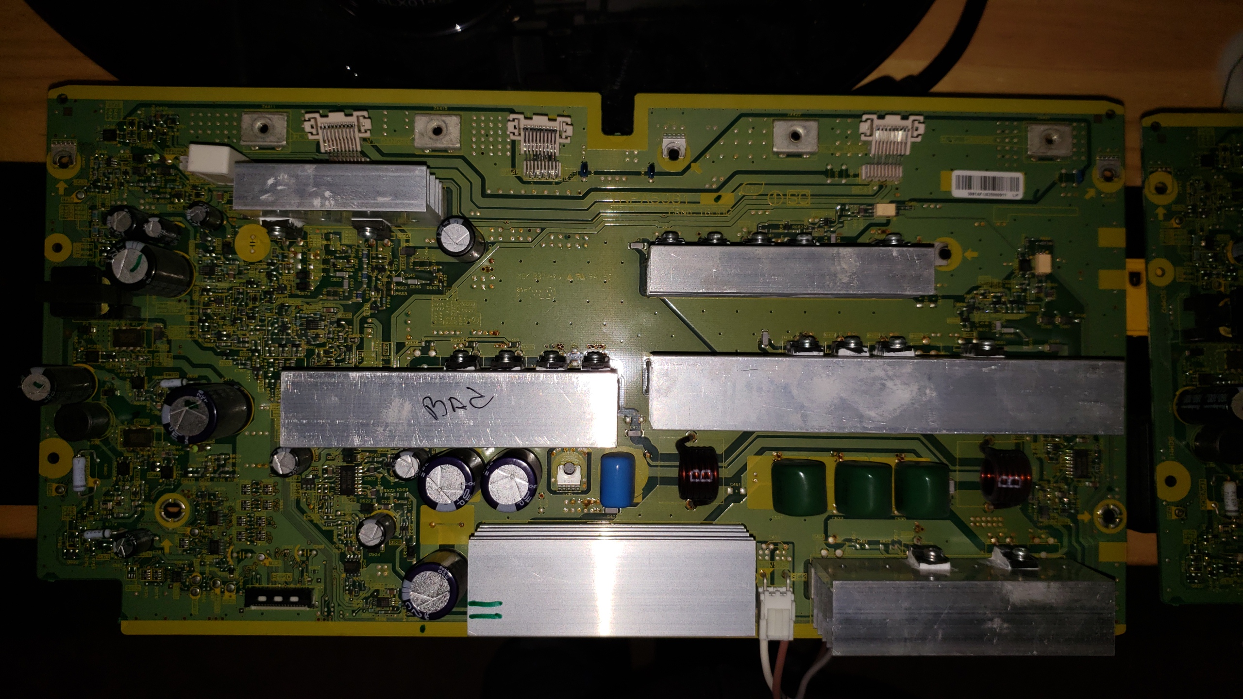

4 Blinks Panasonic TC-P50G20 Help to target the problem.
+ More Options
Posts
  • autoperformance
    • Jul 2019
    • 35
    Re: 4 Blinks Panasonic TC-P50G20 Help to target the problem.

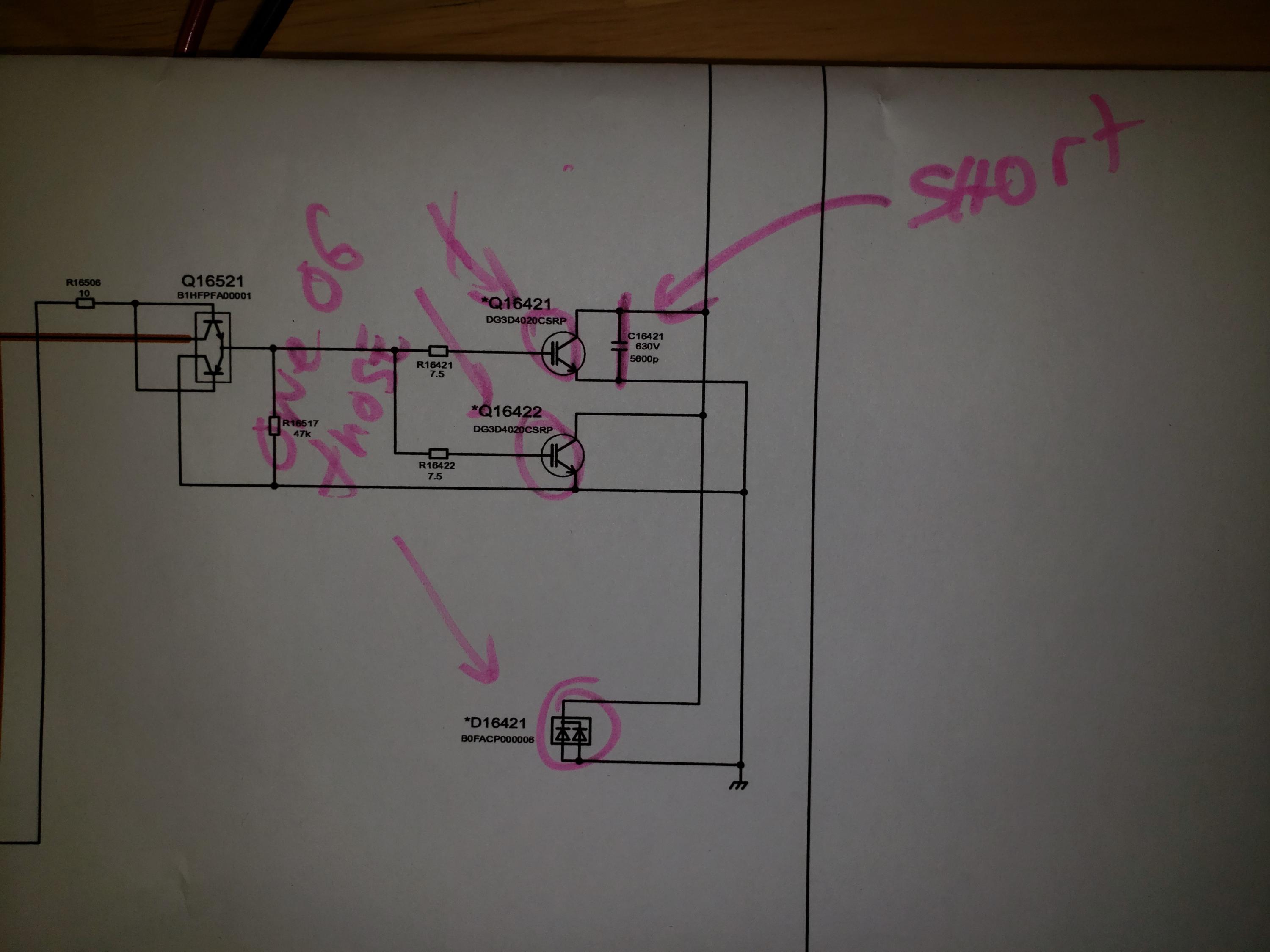

    Originally posted by tvtimmy
    It is DEFINITELY a bad sc board. Do some testing on the IBGTs and you will find some shorted ones. There are repair kits that have up to 100 or so components to change. If you miss anything, that board goes up in smoke again. Way too hard for me to attempt a repair on that sc board.
    Yeah it's true. Do I have to change firmware. Some persons said we have to change firmware when you change SC Board?
    I don't remove IGBT but when I test capacitor in parallel with IGBT it's around 0.1 ohms so it shorted.
    My board finish by AF so I need TNPA5081AF board right ?
      You shouldn't have to change the firmware, but you must get the exact SC board with matching numbers and the suffix(AF).

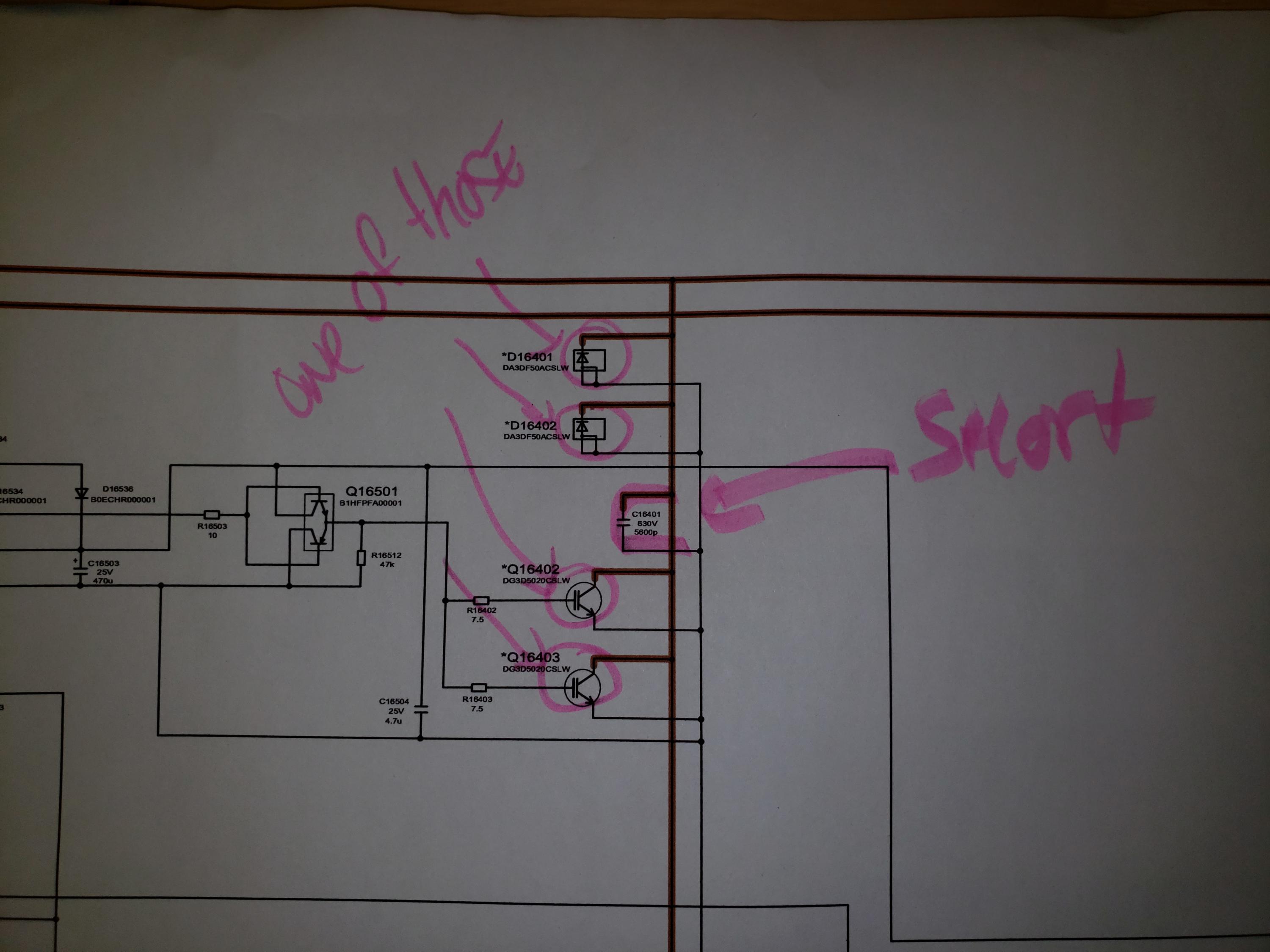

        Ok I found a brand new one on aliexpress hope it will be ok. Everywhere else it's out of stock.

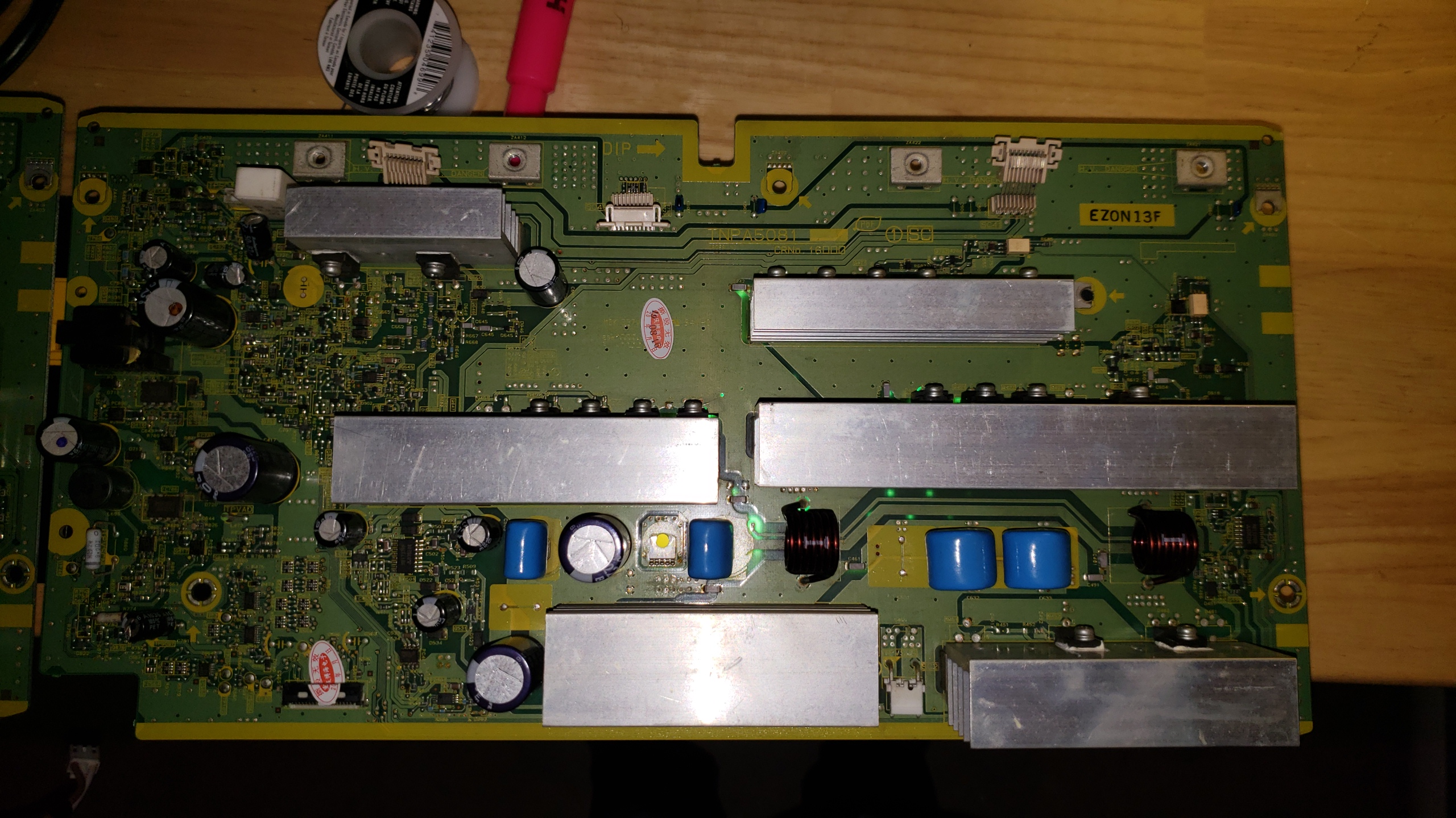

            I received the new board but there are a only two caps instead of 3. Should I add the third on the new board?
              As long as you have purchased the correct board number with the correct suffix, I wouldn't worry about it.
