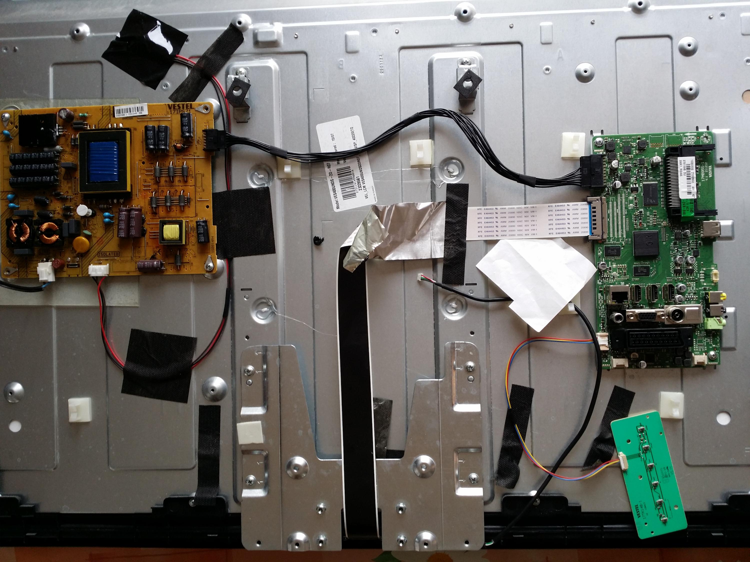

              What Voltage testing have you done? Is 12 VDC present on both ends of the SMD fuse on T-CON?
              You also need to upload the pictures of the whole back side of the TV showing all the boards so we can see what we are dealing with.

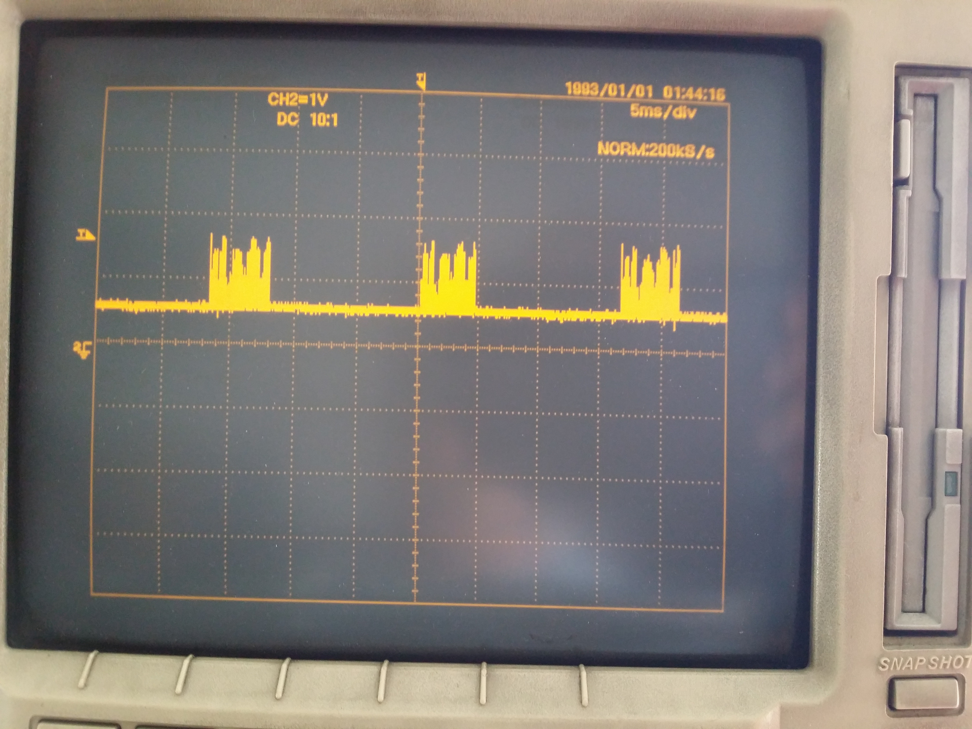

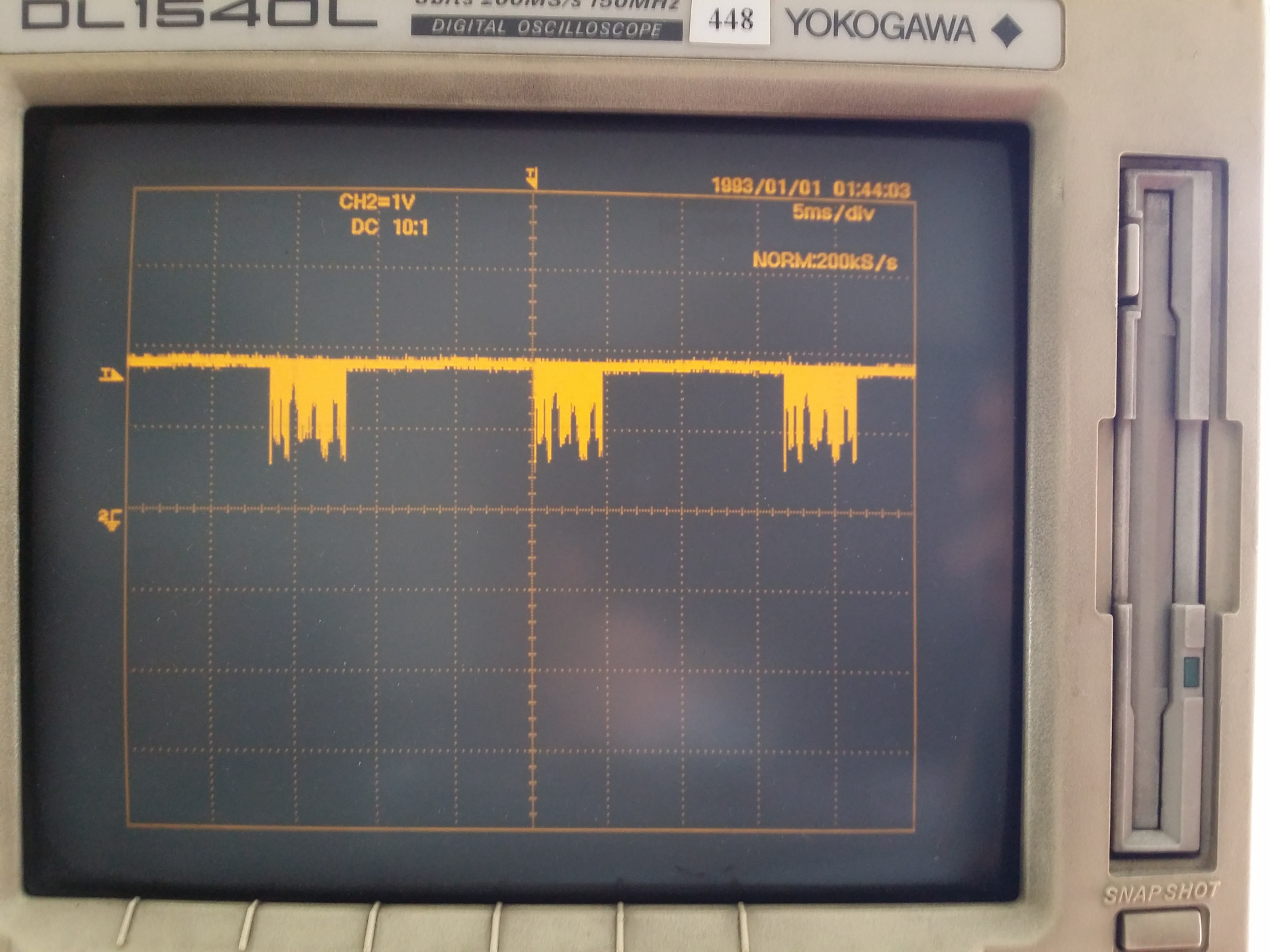

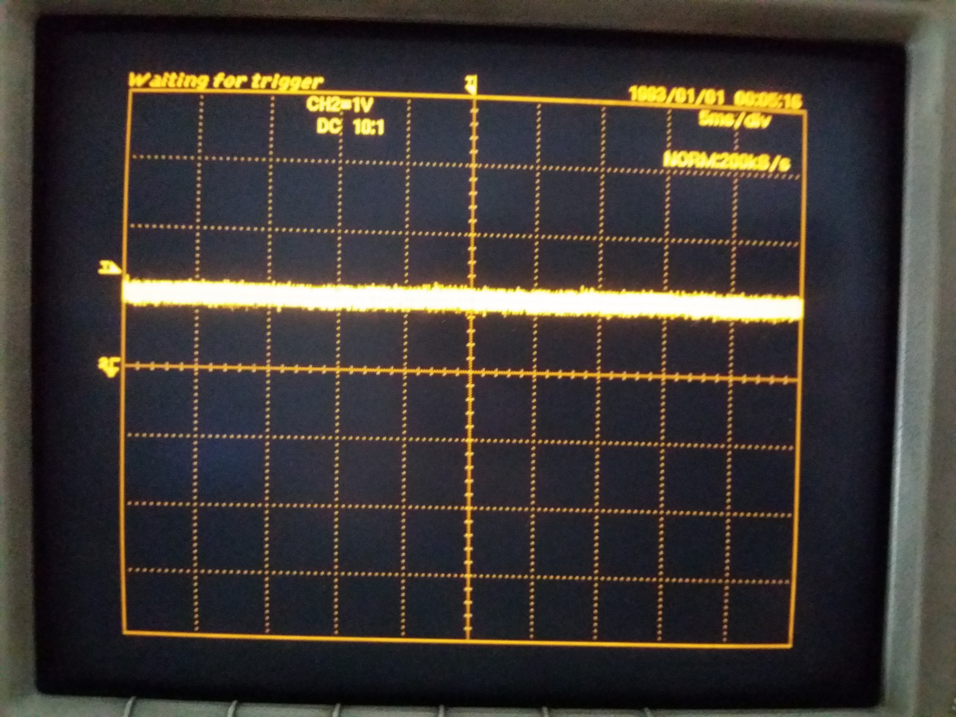

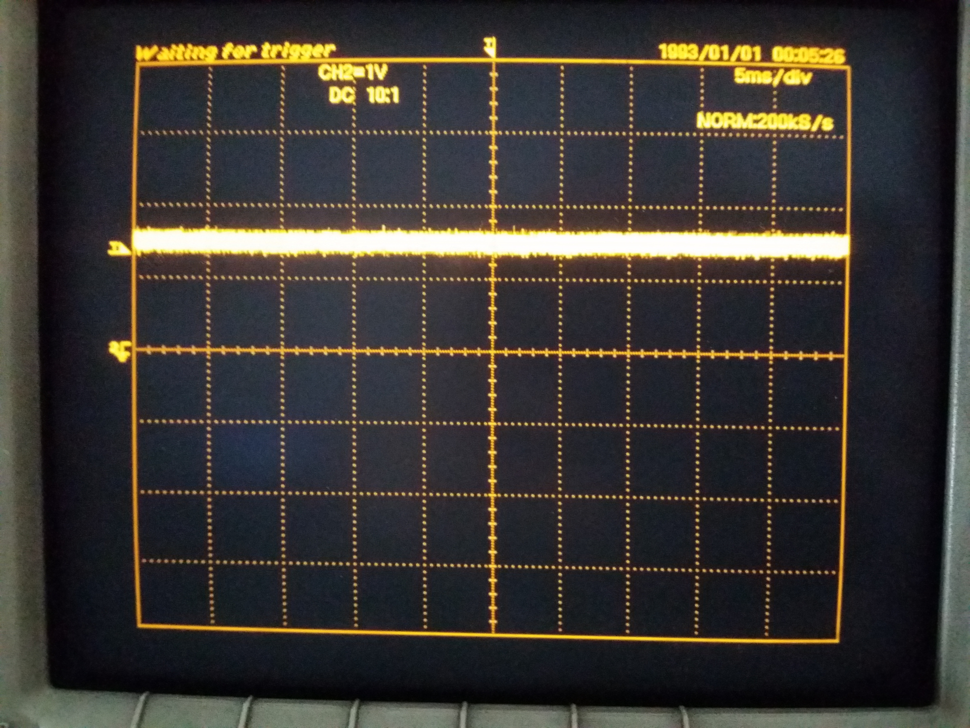

                          Re: Toshiba 40L3433DG backlight OK but no picture
                          I took measurements directly on the TCON and for each pair, signals are as shown on the attached pictures which are for the TX_1_0_N/TX_1_0_P pair but other pairs show similar signals, except for the 2 clock pairs which are with no intervals (see 2 other pictures).
                          And as you suggested R_J, when I depress a menu button I see changes in the displayed signals which most likely means changes in the displayed picture.
                          The clock signals are lower in amplitude as compared to the data signals.
                          So the mainboard is likely to be ok and the issue on the TCON.
                          Shall I take picture of the TCON? What more may I check on the TCON?
                          I also had reading of the voltage on the main's filtering caps: 333V in standby, and 330V when ON (main is 220V AC).

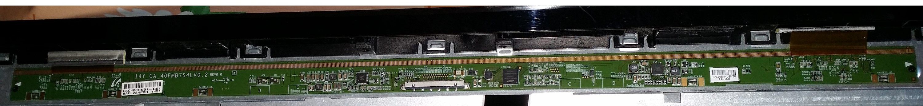

                              The LCD panel has integrated T-CON, so you already get to the T-con board which on the bottom edge of the LCD panel assembly?
                                Yes backlight is ON and yes I've got to the T-CON board which has an unusually wide shape (see picture).
