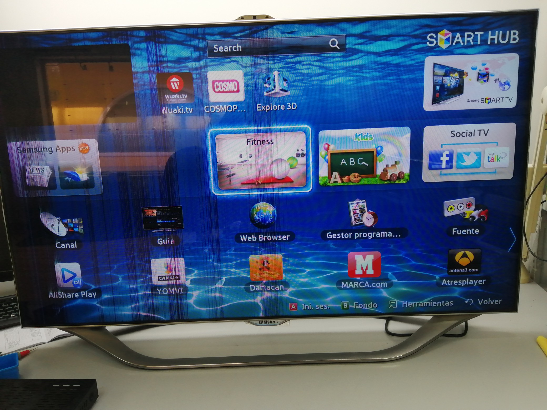

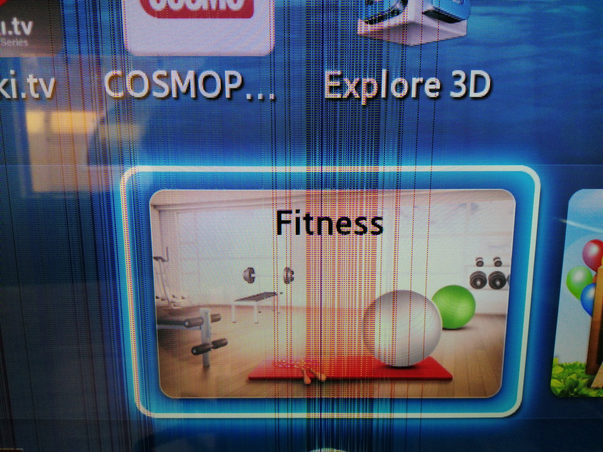

    Hi guys
    Is this likely to be anything else other than a faulty panel?
    The vertical lines are dotted not solid like I usually see on a panel with bad tab bonds
    see pics

    Re: Samung UE46S8000 vertical dotted lines
    Originally posted by dicky96
    Hi guys
    see pics
    this is noise issue caused by one of three reason.. 1-LVDS, 2-Ribbon ( both can be cleaned and reseated carefully, 3- Gama IC on T-CON
