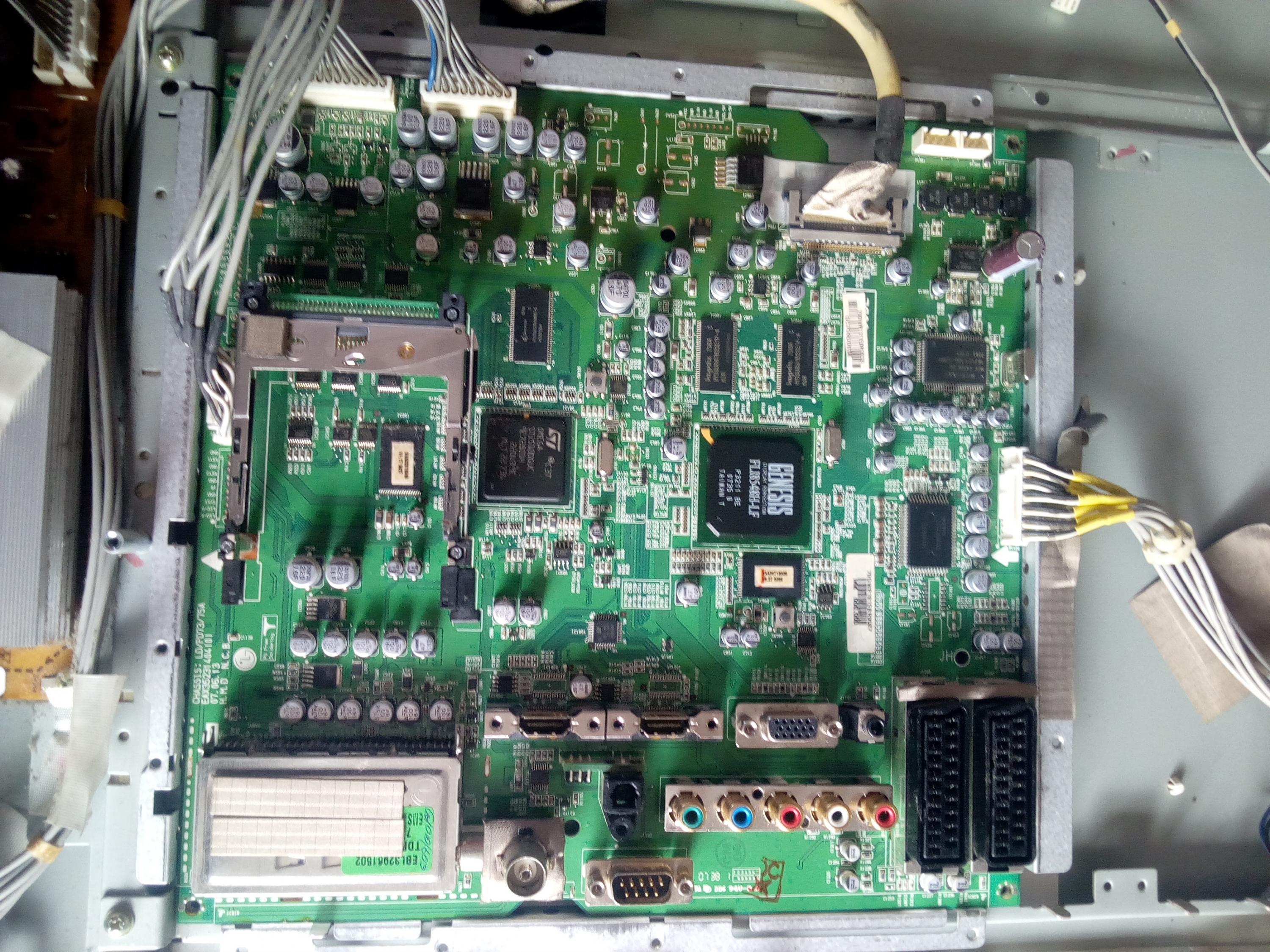

                Re: LG 37LF65 no video signal on Av1,2,3
                Originally posted by hispeck
                very well i did and is working fine, like i said, i connected the same device on component and it work fine, but no color because the device does not have component
                Here is the main board, please which of the IC you are talking about?
                  The one above the HDMI ports. You can see the traces going to it.
                    Sorry please i mean the AV 1,2and 3 is not working, does this ic have any link with AV? like i said am sorry we are learning here, is very good for me to learn what i dont know
                      What is AV 1, 2 and 3 ? Look at the ICs, identify them through data sheets then you will know their roles.
                          Looks like it's shared, are you plugging the yellow rca plug into the green and the red and white on the right side, not the middle red?
                            The IC that has connection to the AV is IC 1400 CXA2069Q
