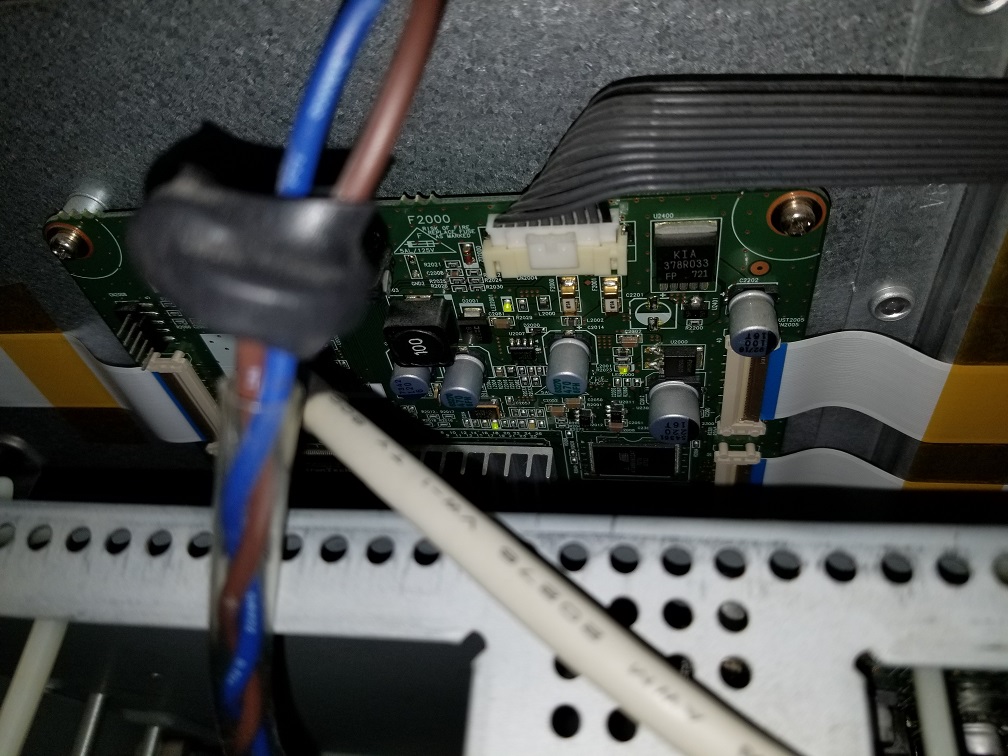

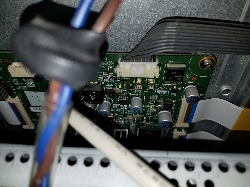

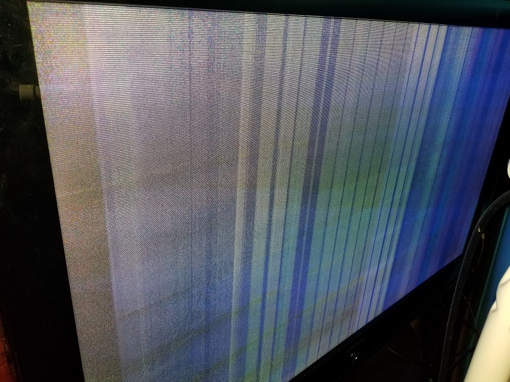

                      Got the new Buffer Boards in and we now have a plasma screen thats lit (not black) but not proper...I have included a pic of the screen.
                      The screen will occassionally go to half (left to right) for a second or so and then back to whats seen. It appears to be responding to what would be on screen. The sound still works and the Y Sustain board LED is no longer lit up.
                      If I pull one of the Far left Y buffer connections to the panel... a whole vertical section will disappear responding to which connection was pulled...which previously did not occur.
                      Likewise if I pull the XMain ribbon cable to the logic board...The screen will appear (similar to the pic) but will be much darker.
                      From my quick reading it leads me to think the Logic Board....Included some pics of the Logic board operation...There appears to be 4 LEDs...The one on the left is flashing consistently...There is one (not pictured) that lights up and then goes out after a brief period of time...The remaining two are always lit...Any Ideas?
                      Thanks for the help,
                      Chris
                        Re: Samsung HPT5054....

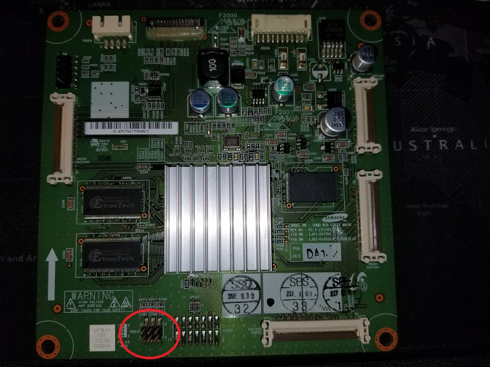

                        You'll need to run the test patterns by jumpering two pads on the logic board - haven't a clue where they are I can't see them in your pic.
                        Maybe someone else can tell you or if not read some of the previous threads on this set as I'm sure the info is in there somewhere.

                          I beleive I supposed to cross pins 3 and 4....At least its briefly mentioned here.
                          https://www.badcaps.net/forum/showth...tterns+HPT5054
                          I also believe the pins to cross are in the image include and is circled in red.
                          I will keep looking to see what I can find in the forum...Anyone confirm?
                          Chris
                            That's the one. Put an old hard drive jumper on it if you have one and disconnect the lvds cable from the main board then plug it in and check out the patterns.

                              I am assuming it will cycle through a set of color screens...What exactly am I looking for or testing.
                              Chris
                                Running the patterns bypasses the main board. If the patterns look good then you know your ysus/buffers are good and the main board is likely to blame.
                                If the patterns look bad then you still have more troubleshooting to do...

                                  Tried pins 3-4 with the lvds cable disconnected. The same type of screen previously displayed showed up. Two of the vertical bars seemed a little more pronounced (darker) a little less color but same screen. Tried pins 1-2 and 5-6 separately and the same screen as 3-4 was displayed.
                                  Not sure where I should look now...?
                                  Chris

                                      The presence of static in the pictures you posted makes me think you have problem still on your ysus. Where did you get this replacement board ?
                                      The fact nothing changed when running the test patterns says the main board is not the culprit.
                                      The fact you have a full raster indicates the buffers are functioning.
                                      So at this point I would guess in order of likelyhood that the ysus is to blame, and if not then the control board. Control board is cheap might want to try that first.
