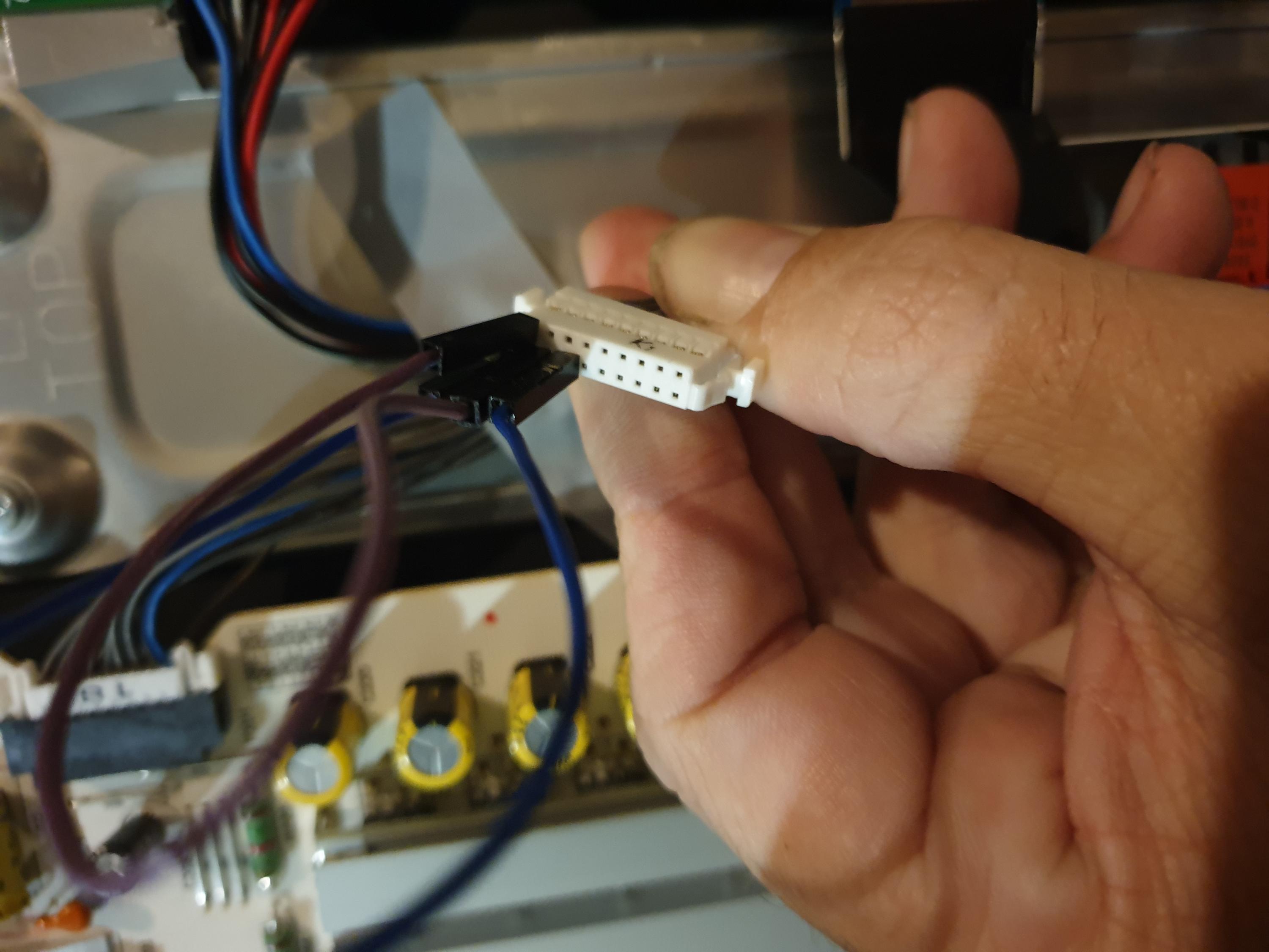

        Hi Diah, Once again thank you for your help. Sorry for my confusing posts..
        1. Yes MB is disconnected from PSU
        2. Yes have 3.5v STBY
        3. I hear the relay click Connector P201 on PSU has the voltages below working
        12v
        24VS
        3.5v
        Connector P202 doesn't have 24v as expected.
        4. With the DRV-On connected to 3.5v connector P202 has 24v. No change in display though.

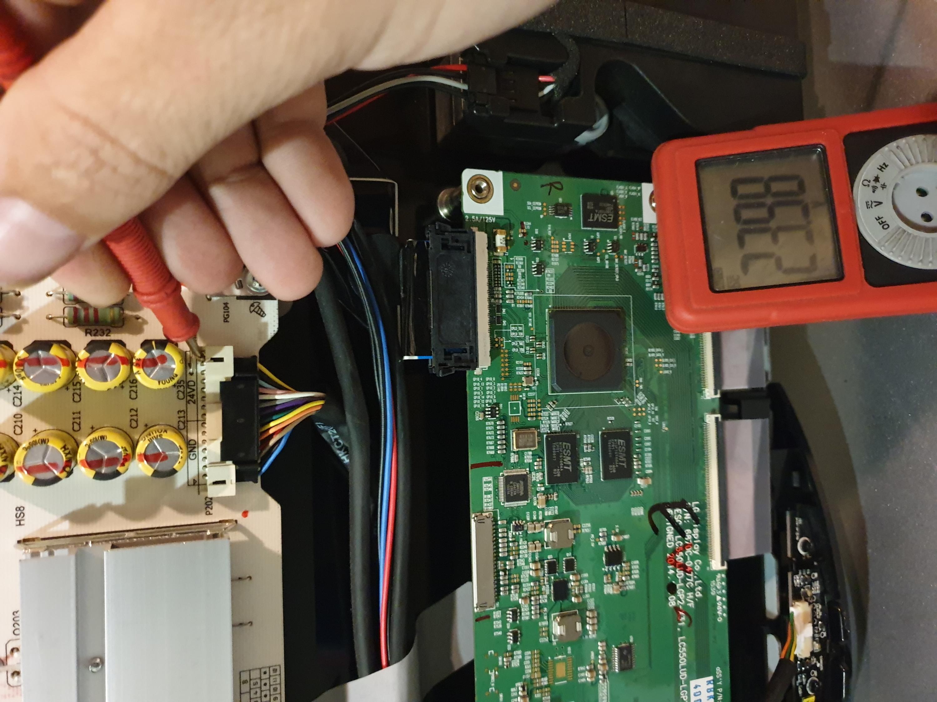

          Re: Lg curved oled 55ec930t not starting
          Voltage test
          • Diah
            • Feb 2013
            • 6437
            Originally posted by advancedservers
            Voltage test
            now clear.
            as your points 4 now we are sure PSU provide us what we need.
            same way of the connected STBY to Power on and driver ON. with out MB connected. T-CON should be connected to PSU. use car lamp Dual flame . to make load test of the PSU

                I used a 24v 3A Fan and is worked at full speed.
                • Diah
                  • Feb 2013
                  • 6437
                  i will apply for you A patent for Fan use
                  the Idea of Lamp are how much currents it will use not volts. in other way how many watts will add on the load circuit of the 24V. line.
                  yours Fan patent its just 0.2 or less w.
