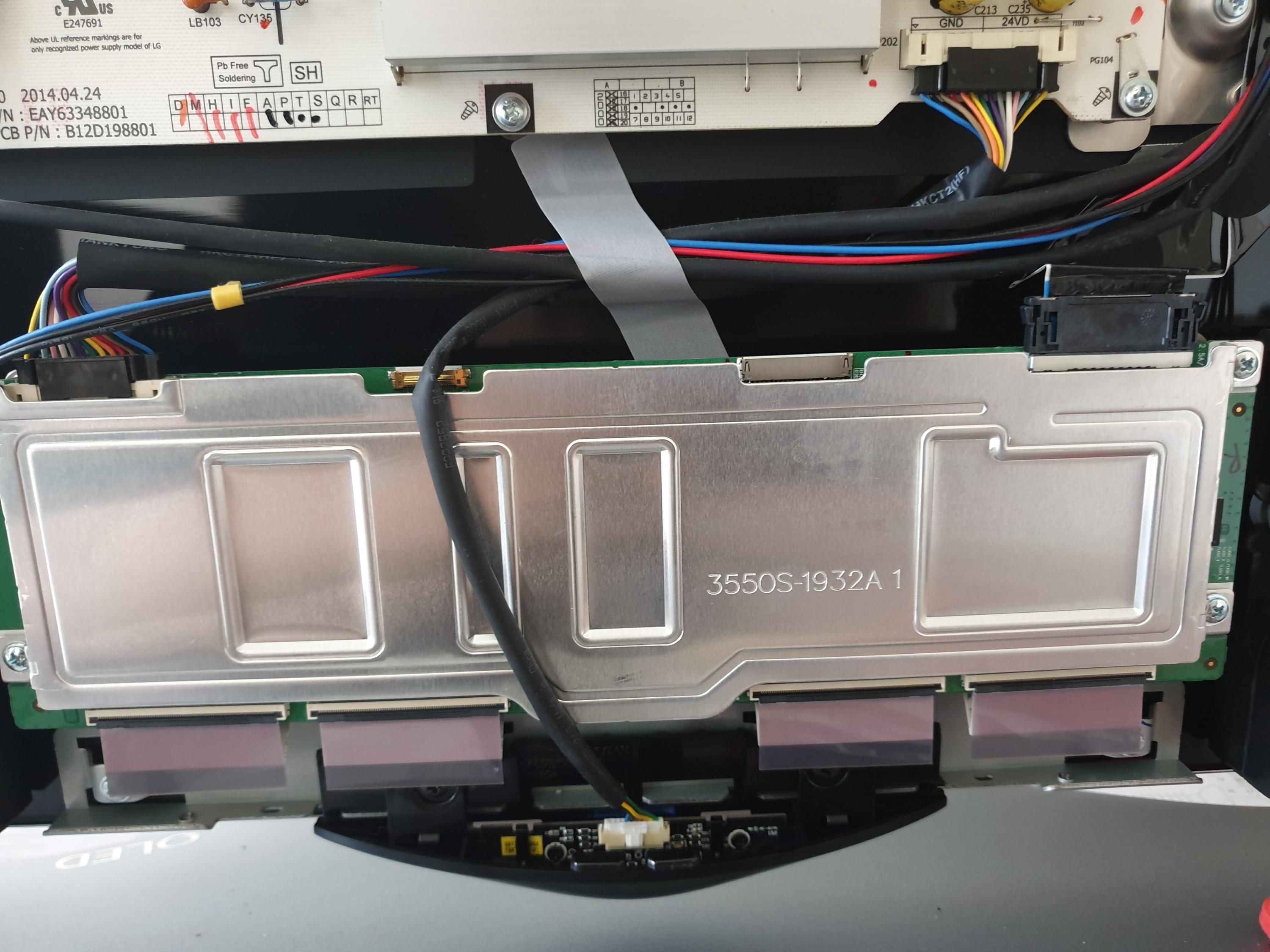

          Pictures fam

              Re: Lg curved oled 55ec930t not starting
              Originally posted by ReeceyBurger123
              Pictures fam
              Pictures please

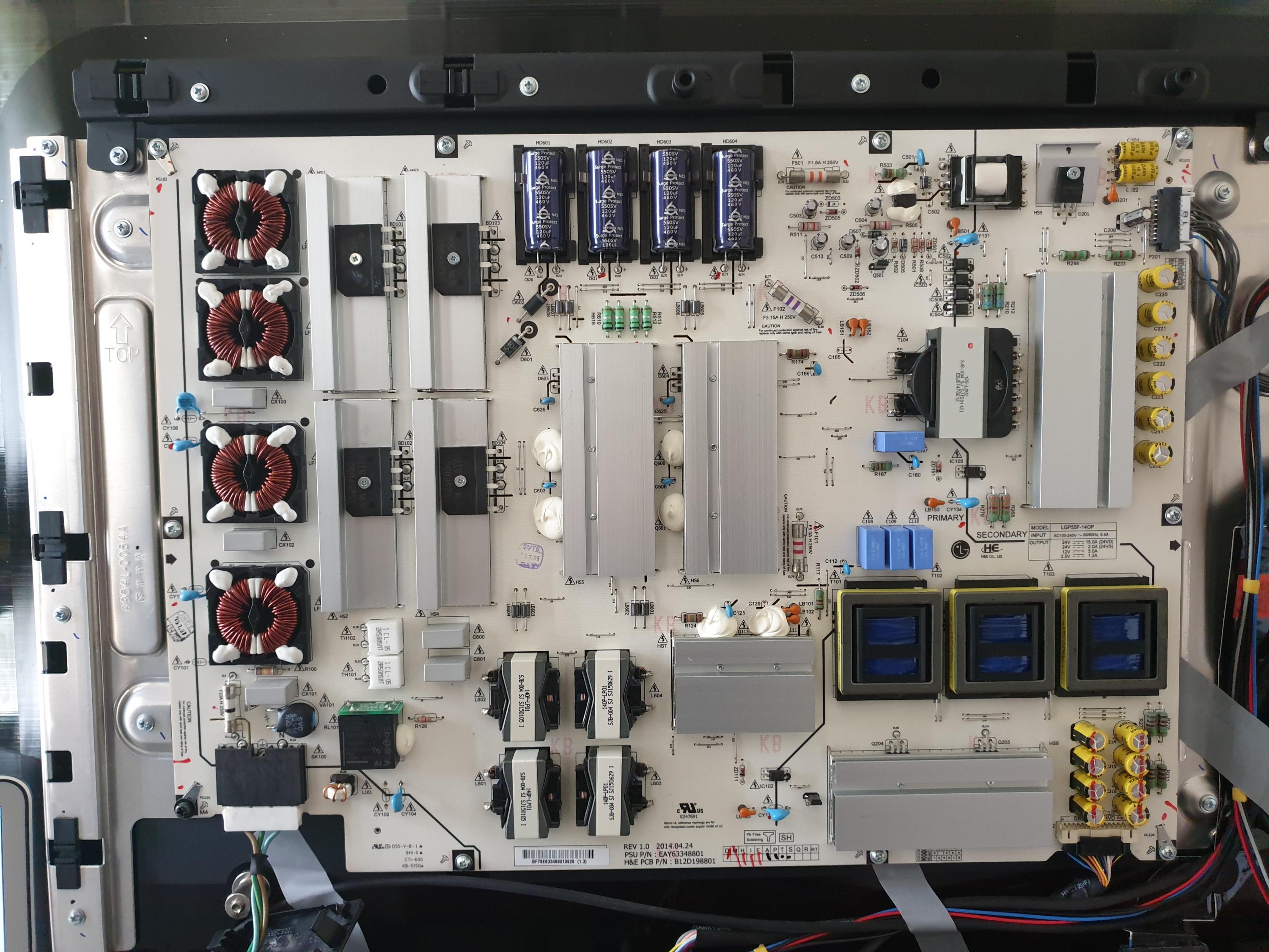

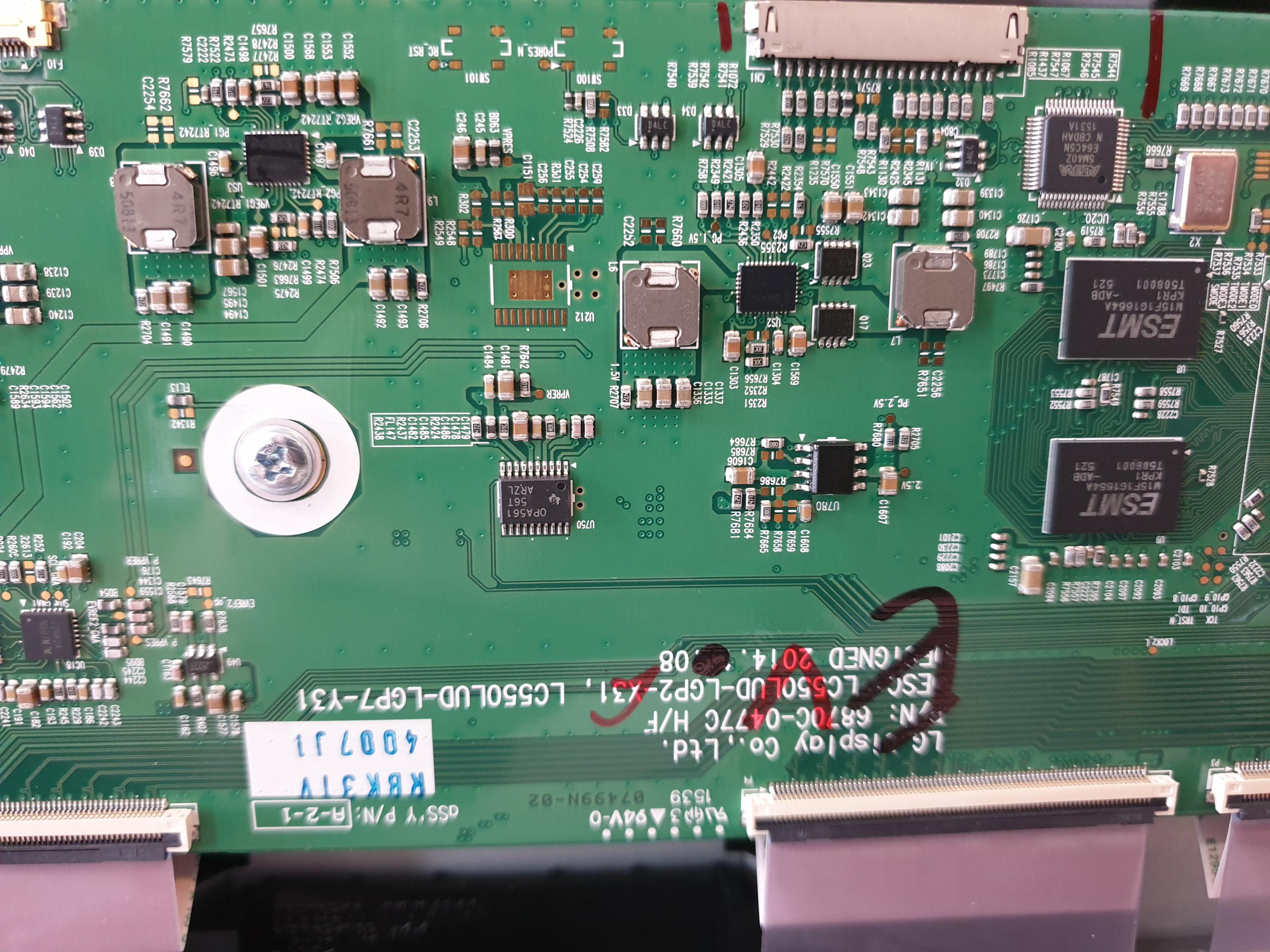

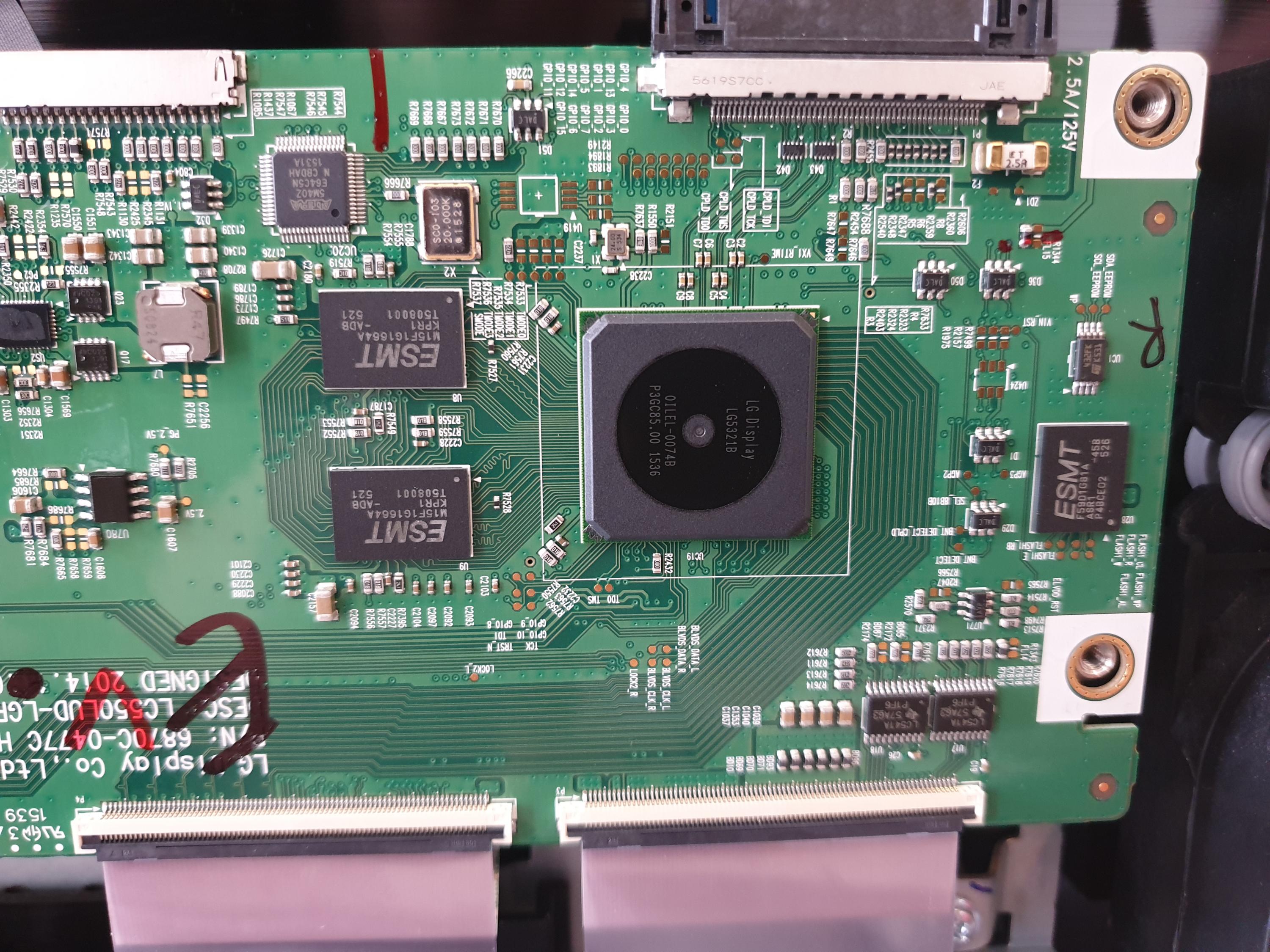

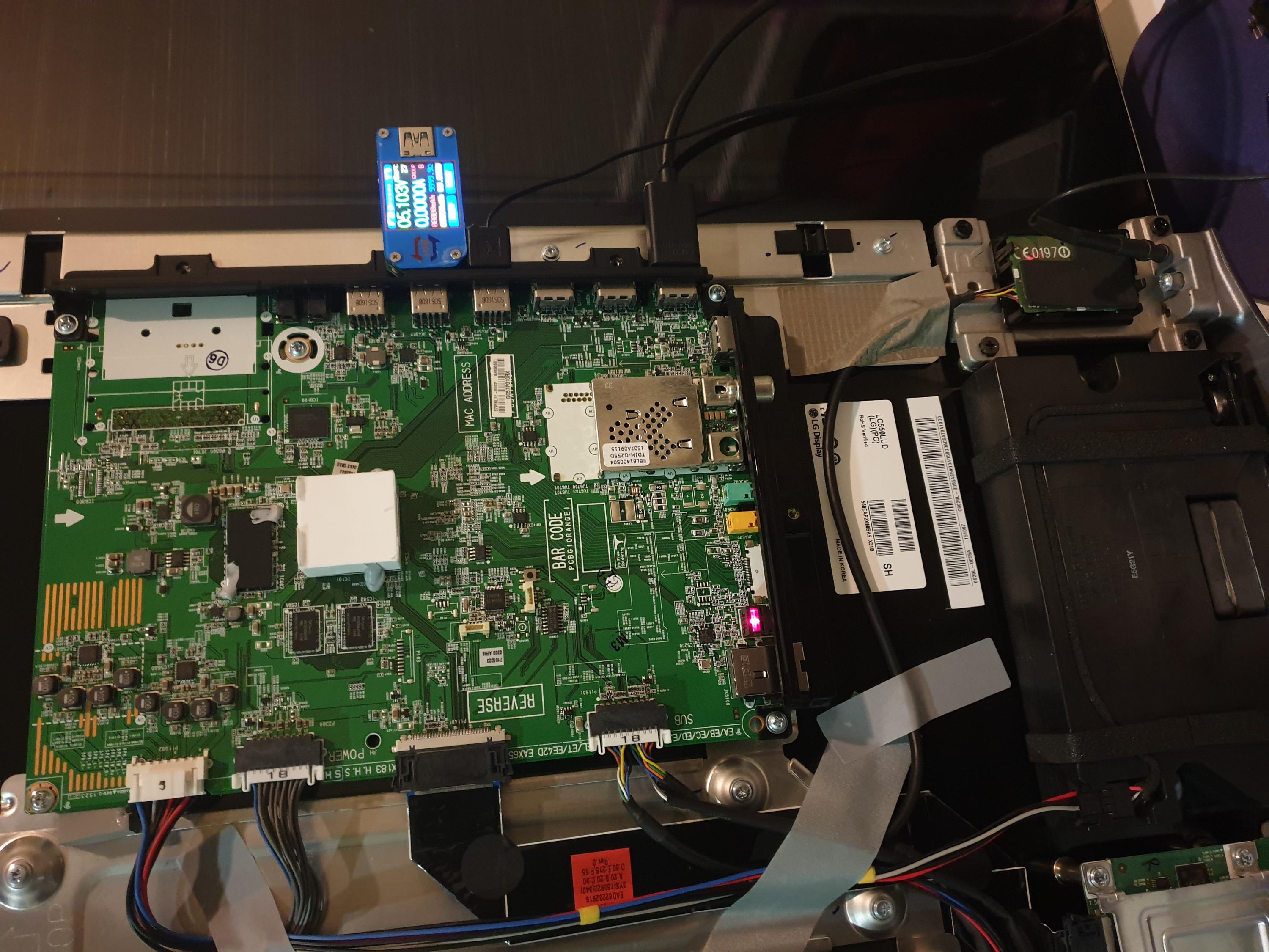

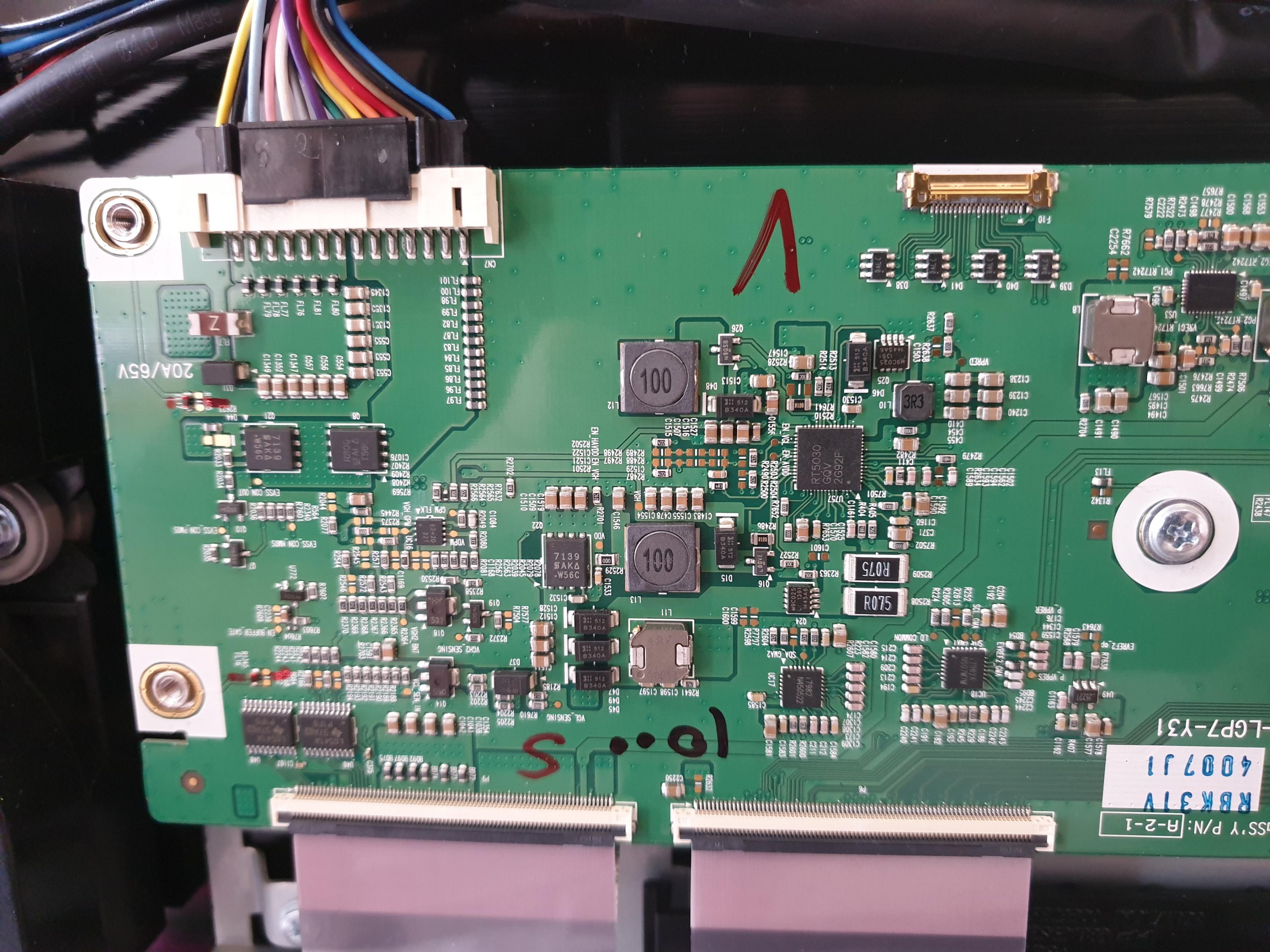

                Please see attached pics. I have checked with another multimeter and voltages are ok. I dont seem to be getting 24v to the tcon board. I have managed to get the TV to turn on and stay on (without any picture) and deliver 24v to tcon by pressing the reset button on the main board.

                  In the first picture 20190419_222123.jpg this is where i had the tv turn on by pressing the reset switch. you will notice that the usb is also receiving 5v power.

                            however from your test i assume you have driver issue which it located on T-CON. take out the metal shield of it and post clear photo of the top and down side
