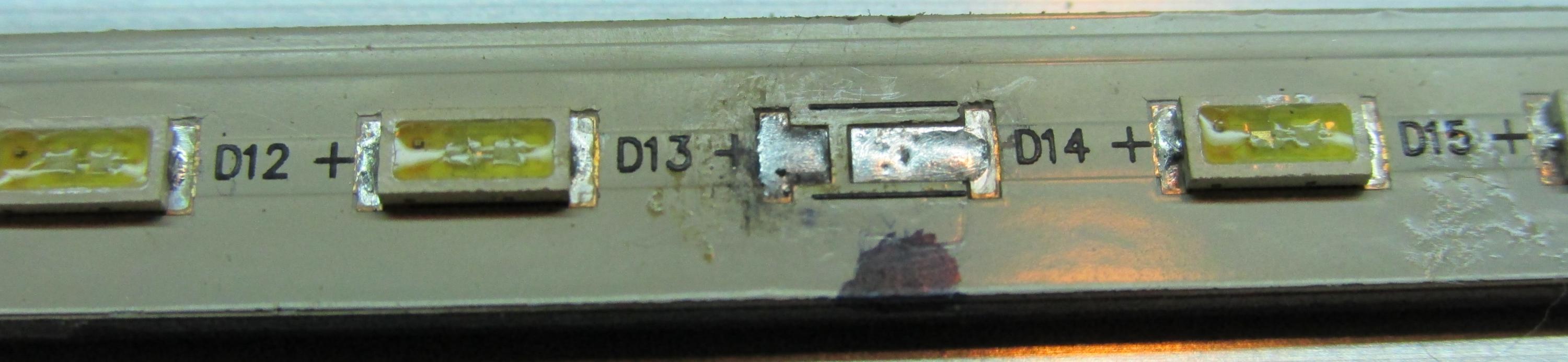

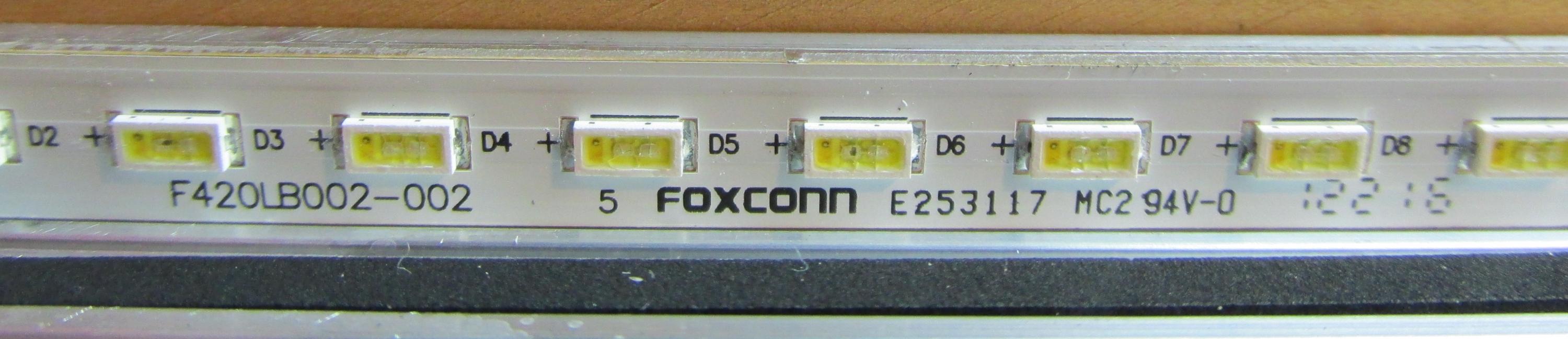

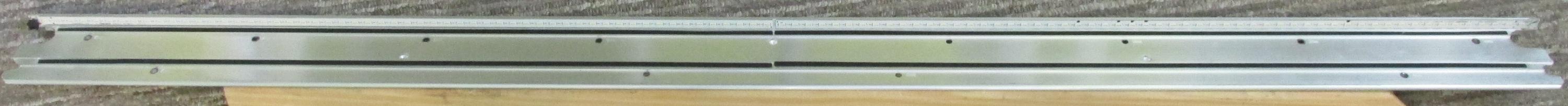

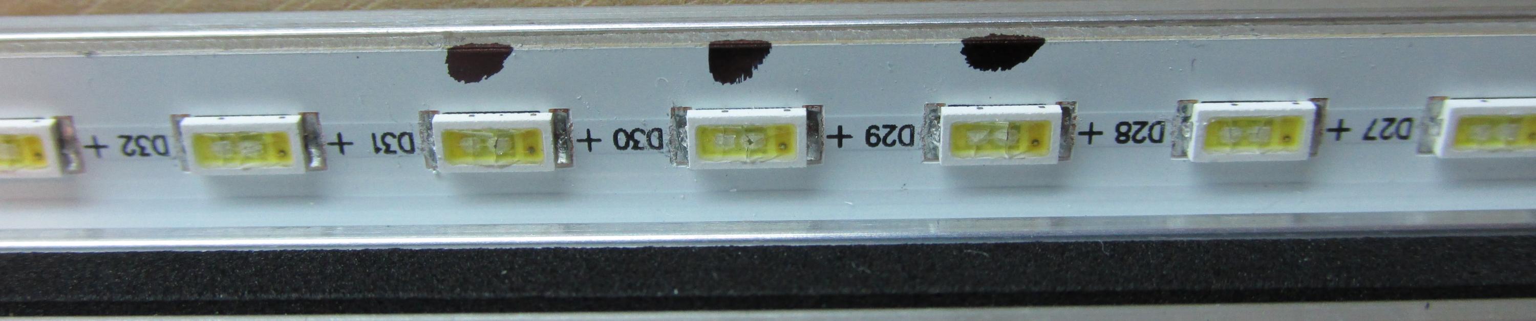

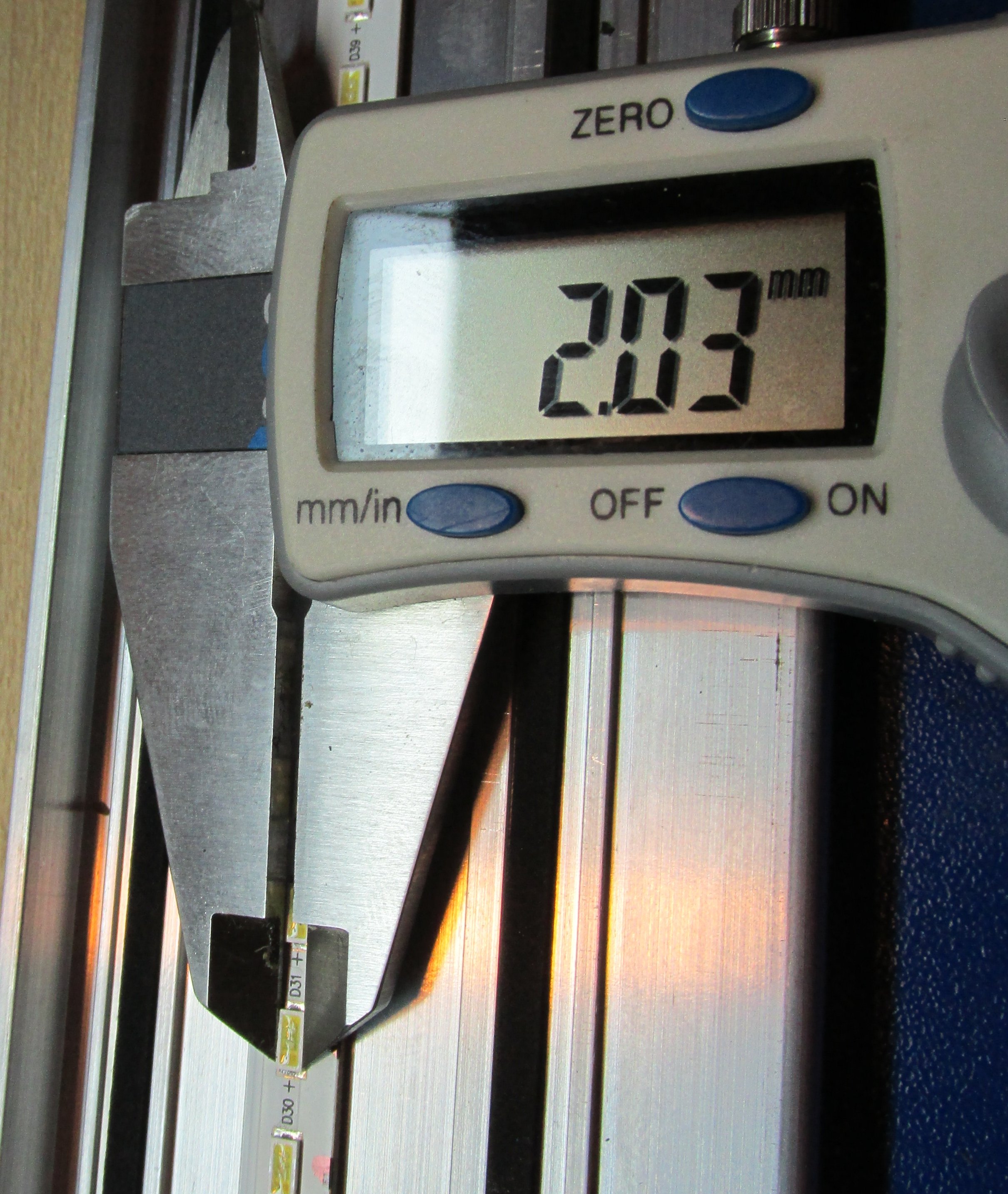

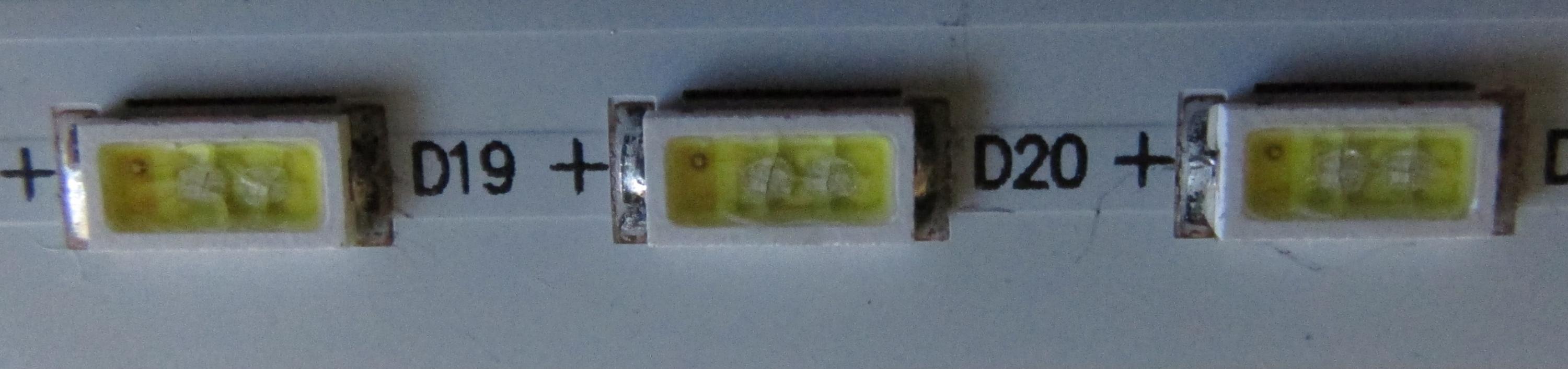

          I have disassembled the panel.
          There are two strips mounted on one aluminum cooler, each strip contains 56 LEDs.
          I have tested LEDs using voltage slightly under 6V (there are 5 LEDs broken on one strip, all LEDs are OK on other strip).
          I presume that LED voltage is 6V but I found that there exist also 6.2V LEDs.
          It seems that supply voltage should be over 336V per strip. I have measured 200V on my PSU.
          LED dimensions: 4mm x 2mm
          Strips are made by Foxconn (F420LB002-002) - can be seen on one photo.
          Bad LEDs are marked black on one of attached photos.

            Re: Sony Bravia KDL-42EX440 - problem - turns off after switching on
            Additional photo of LEDs.
            This one is more precise.

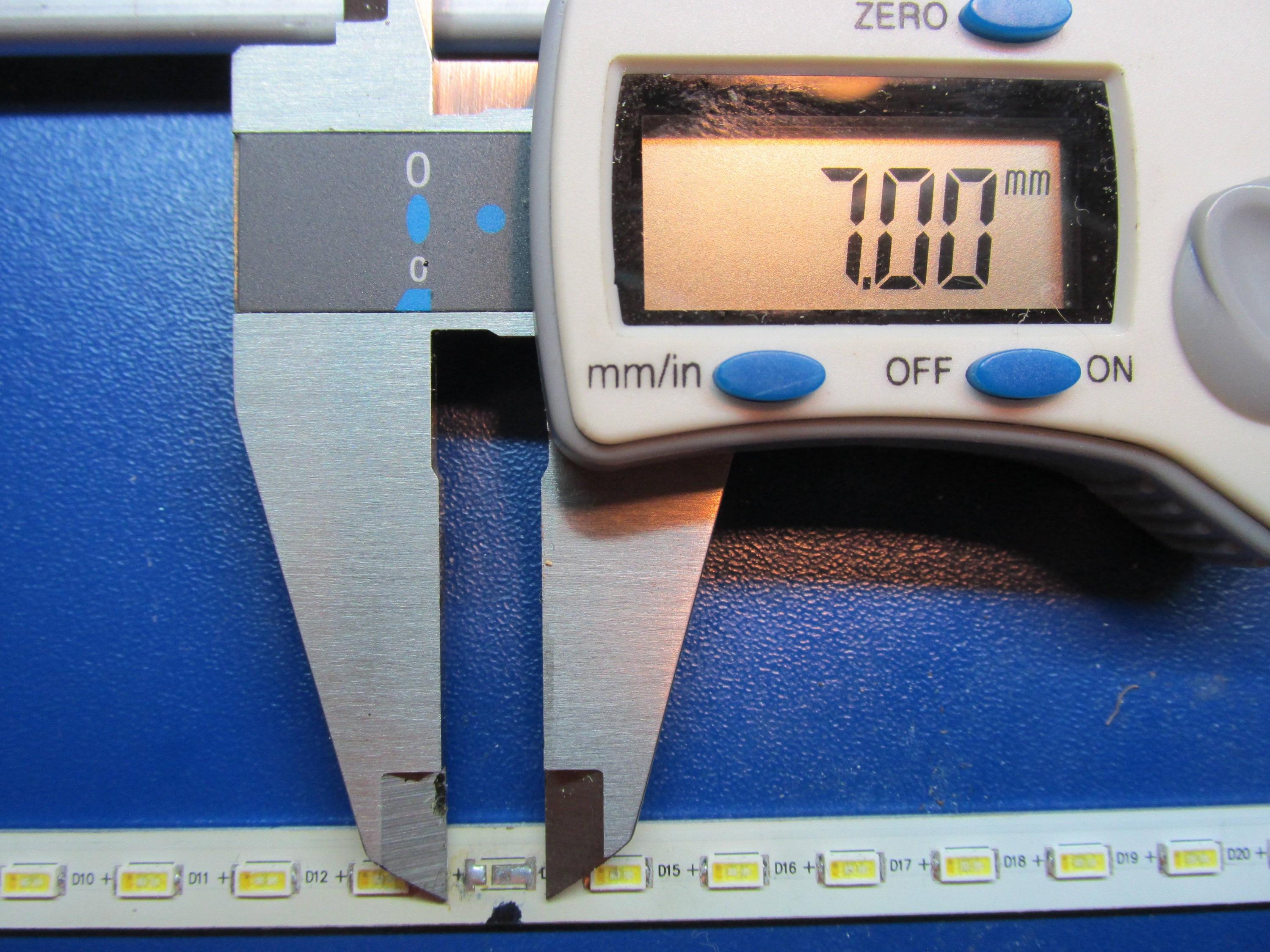

              i think double LED 7030 6V. you can measure on LED 7mm long 3mm wide, take on out of its place and check the down side of it as it had 2 chassis grounded or one,
              on Aliexpress you found them for example http://www.aliexpress.com/item/100PC...445357361.html

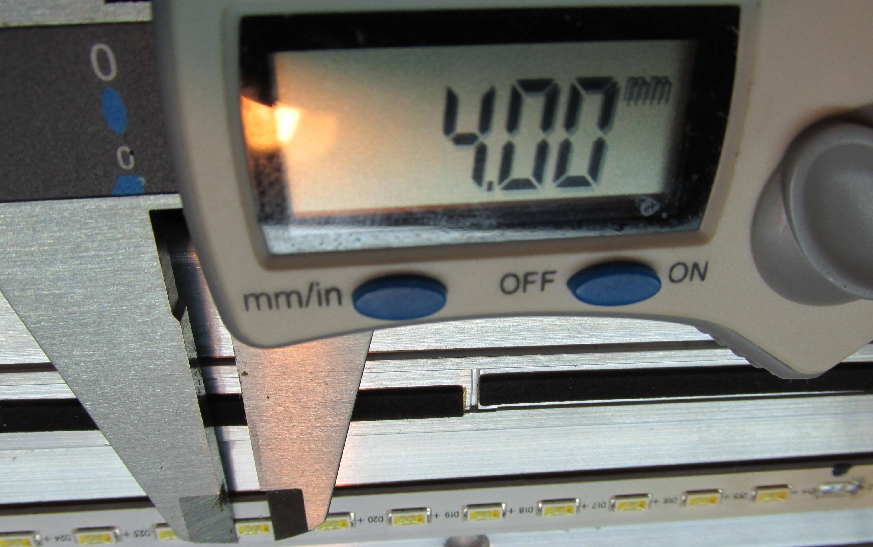

                I have measured, LED dimensions are 4mm x 2mm.
                I removed one LED, layout can be seen on attached photo.
                What temperature should be used for hot air soldering of SMD LEDs?

                  are u sure.. in mm
                  • zarko
                    • Mar 2019
                    • 14
                    • Serbia
                    Yes, definitely 4mm x 2mm.
                    Photos attached.
                    • Diah
                      • Feb 2013
                      • 6600
                      its 7030 6 V mat, you are measuring the long of LED body only, don't forget you have 2 legs on + - down side for soldering
                        4020 LED: Your width is 2mm. Remove one from the board and verify footprint and pad assignment for the Anode and Cathode.
                        https://www.aliexpress.com/store/gro...32782be9JIyRoZ
                        See the spec of 7030 attached, see dimension on page 3.

                          budm, 4020 surface mount with out soldering bed , look on his leds they have beds left and right
                          i may wrong,
                            But the width is 2mm not 3 mm, see LG spec for 7030, the width is 3mm since there is no solder pad to come into play for width dimension, and if you look at the SMD pad (not the PCB solder pad) if you add what are on the LED it will still not come out to be 7mm pin to pin.
                            Since he already remove the LED, so now he can accurately check the dimension and the pins assignment to be sure before trying to get the replacement, better to be safe than sorry.
                              7mm is larger than LEDs on this strip - photo attached.
                              I think I could fit 7030 LED if i scoop the white paint from copper.
                              I found that 4020 LEDs can be found on Aliexpress too, but maybe I should go with 7030 since the quality is probably better.
                              Maybe I should go with replacing all LEDs? I assume 7030 would last longer than 4020.
                              What temperature is OK for hot air station when working with SMD LEDs?

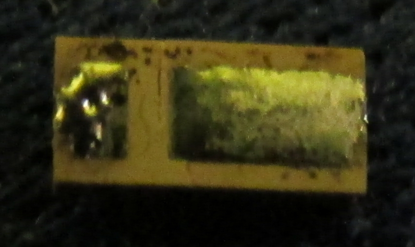

                                you are correct with width but if the LED had solder pad then will be not 4mm.
                                best way he remove one and see the pad exist or not, from photo show it had
                                • Diah
                                  • Feb 2013
                                  • 6600
                                  the one you took it out it had soldering pad on both side + - or not just flat
                                  • Diah
                                    • Feb 2013
                                    • 6600
                                    budm correct 4020 with out pad. don't go with 7030. stay at original type better to you
                                      Based on this picture, it is not 7030:
                                      https://www.badcaps.net/forum/attach...1&d=1553283312
                                      • zarko
                                        • Mar 2019
                                        • 14
                                        • Serbia
                                        Here is a photo of bottom side of LED. No pads.
                                        I will go with 4020, 6V, 150mA.
                                        I have few questions regarding SMD LED soldering, I have no experience with this type of components.
                                        What is the best way to solder SMD LED without pads?
                                        Can I try with soldering iron or I should skip it and go with hot air station?
                                        What is max allowed temperature if I go wit hot air?
