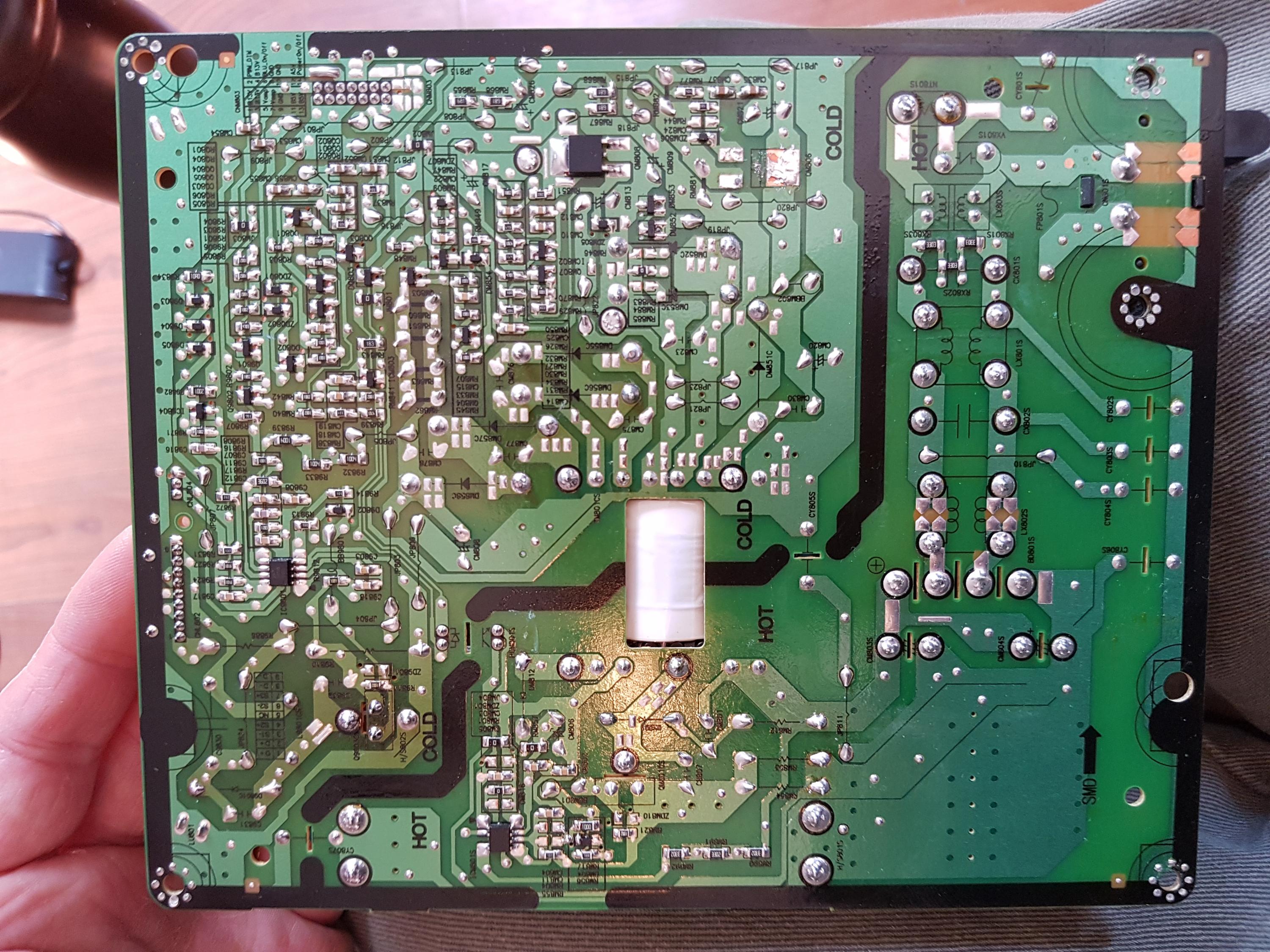

    Hi!
    I have a Samsung UN39FH5000FXZA Ver PF03. I was working on the PSU and removed QM806, but the chip was destroyed.
    I didn't get pics before the removal, but it was unreadable anyway. I was hoping someone could help me figure out what is supposed to go there.
    The PSU is BN44-00666A. I just had one of these BN44-00666A PSUs as well and I'm kicking myself for not taking pictures of the first one before working on this second one.

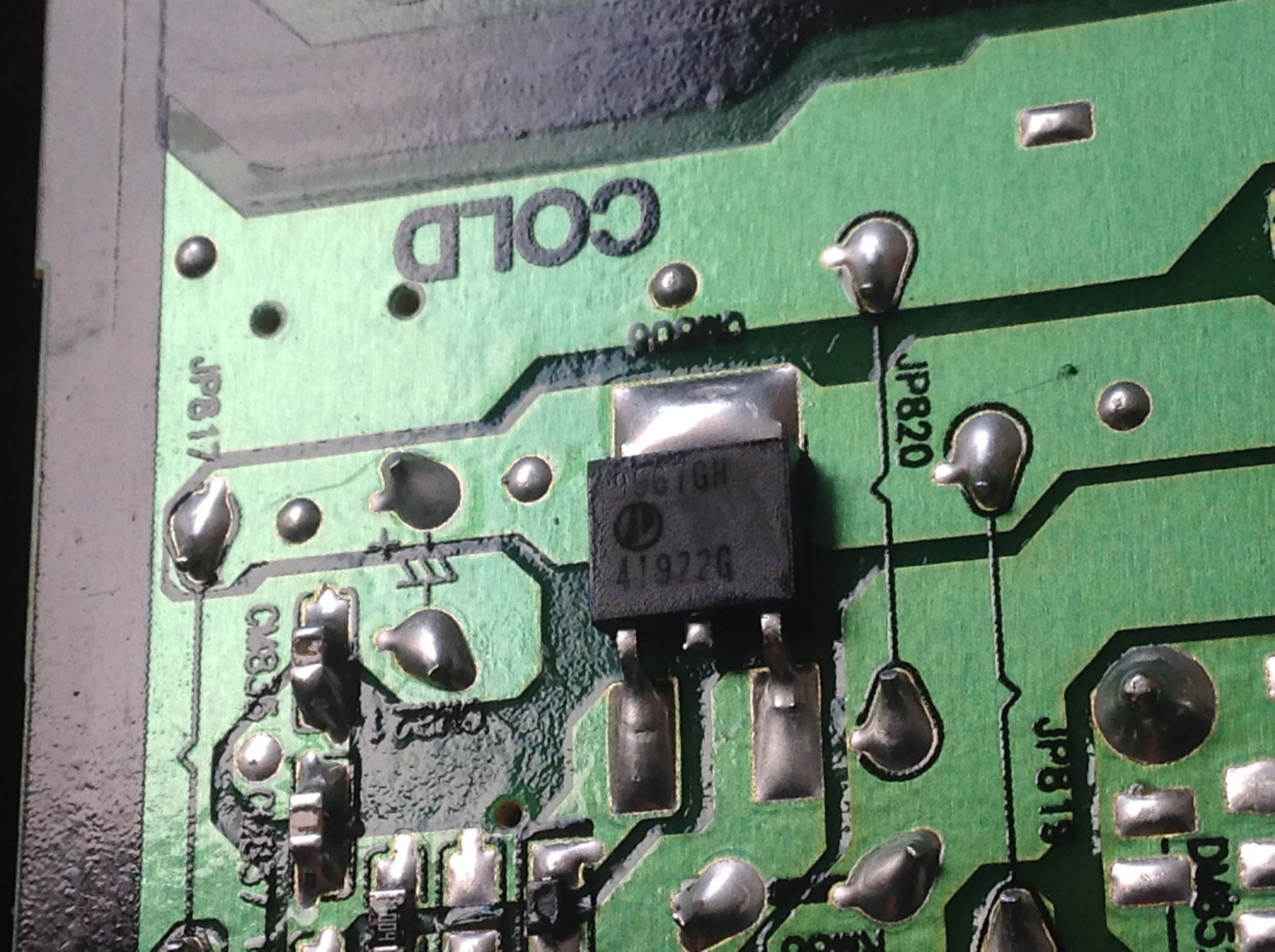

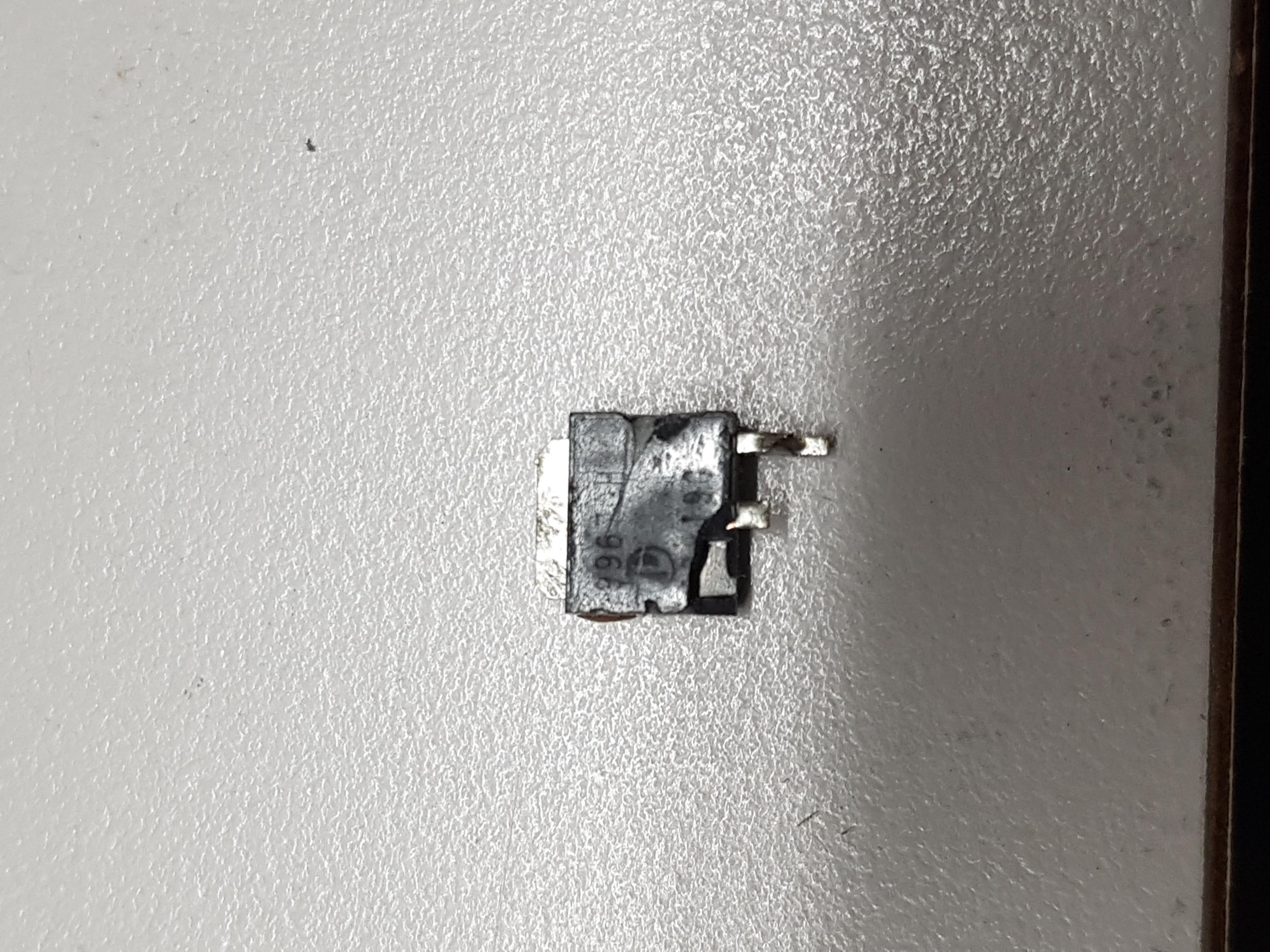

    Re: Samsung UN39FH5000FXZA (Ver. PF03) Component Identification
    Looks like it might be the Advanced Power Electronics Corp AP9967GH-HF POWER MOSFET.
    Now I need to find a compatible one that DigiKey or Mouser (preferable at DigiKey) that I can order. Anyone want to help me find one?
    I've uploaded the datasheet for the suspected MOSFET and will post any MOSFETs I find that I believe are compatible. Thanks!

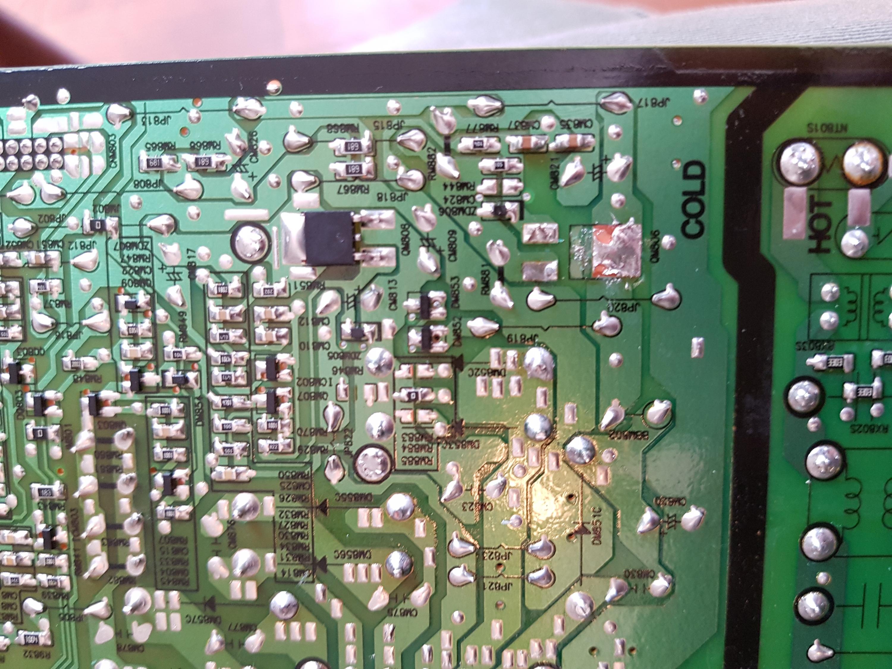

        Does this pic help? I'm actually troubleshooting this inverter board myself, I only get high voltage to 1 of the 3 LED strips with the LEDs connected. I tried mesuring voltage without the LEDs connected but I don't get voltage described like on YouTube. Sorry I'm a neuf. Working on Samsung UN40EH5000F. Can you help me?
            The fet is there to switch the B5.3v which is rated on the board as 1.2 amps the AO4186 should handle that no problem
                Thanks! That worked like a charm. Now I have to replace the LED strips.
