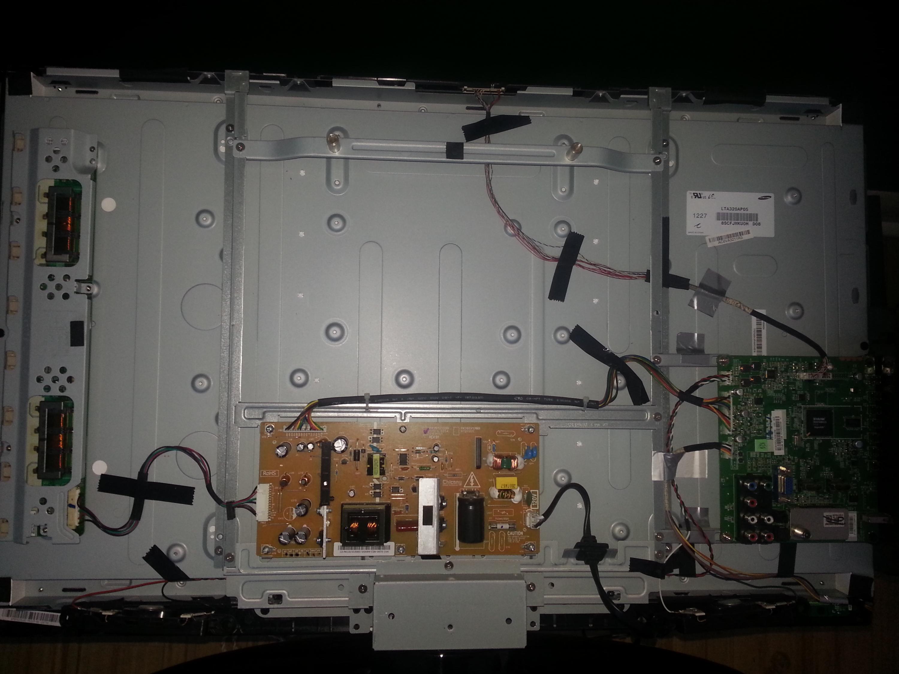

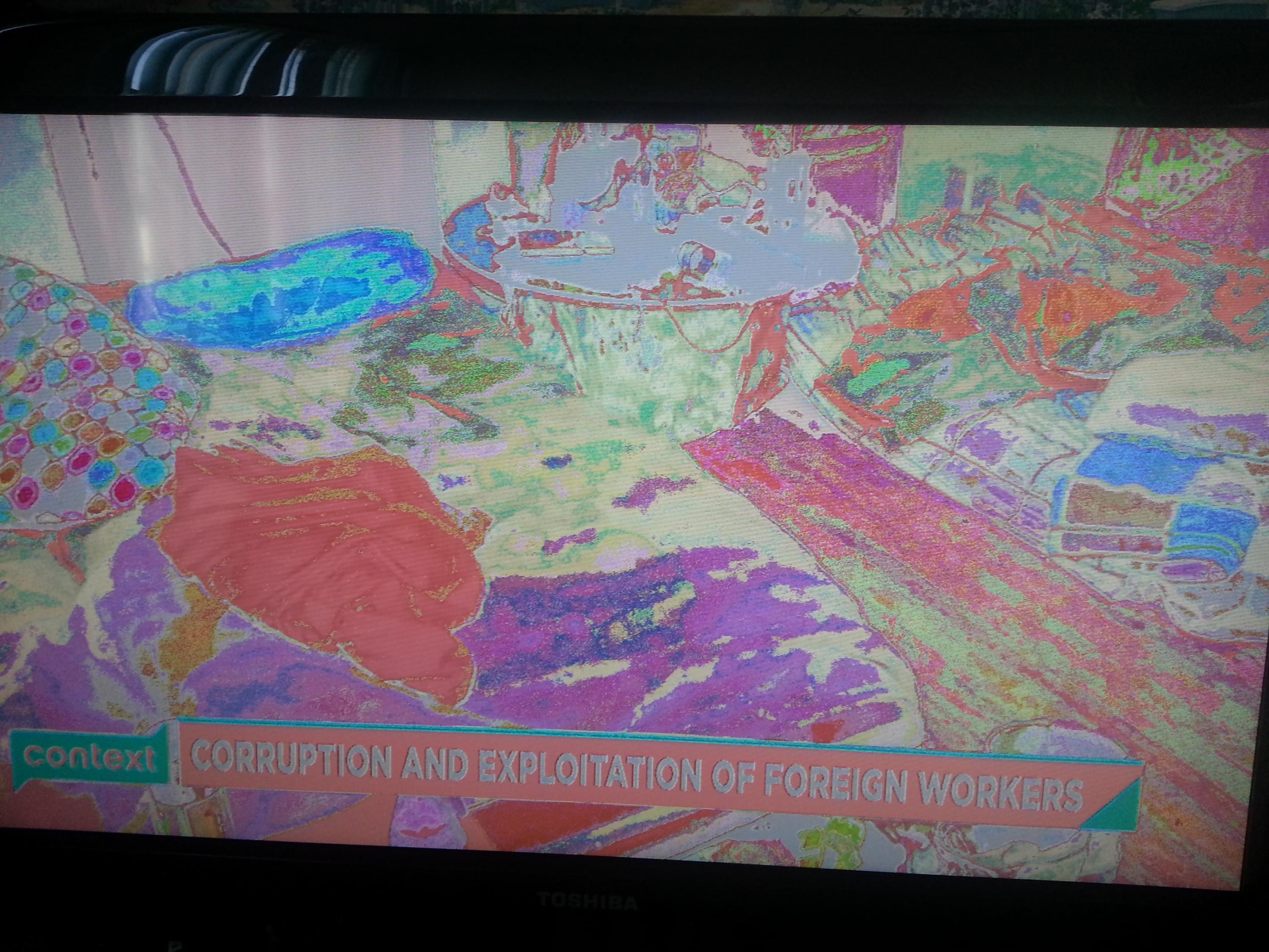

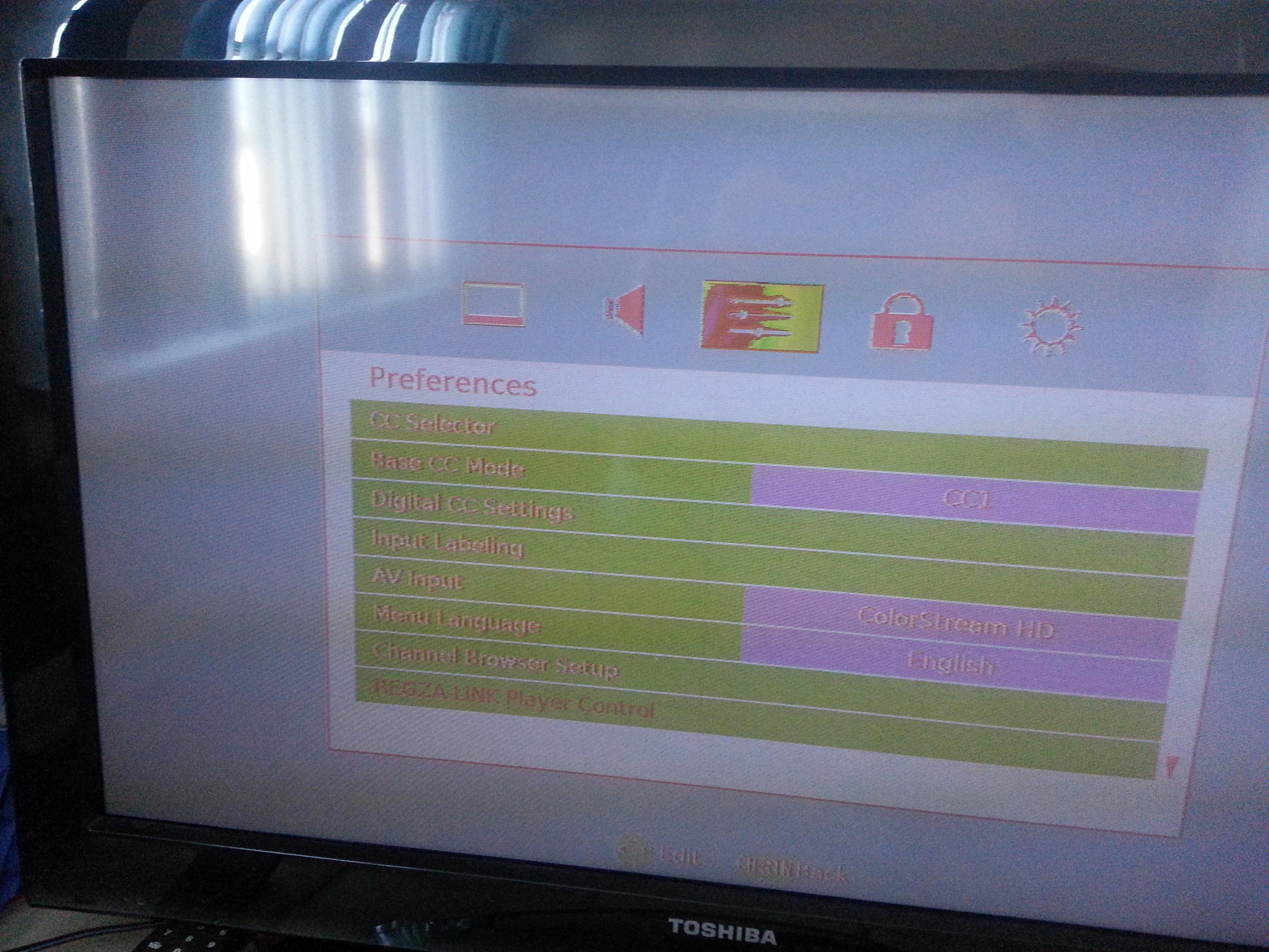

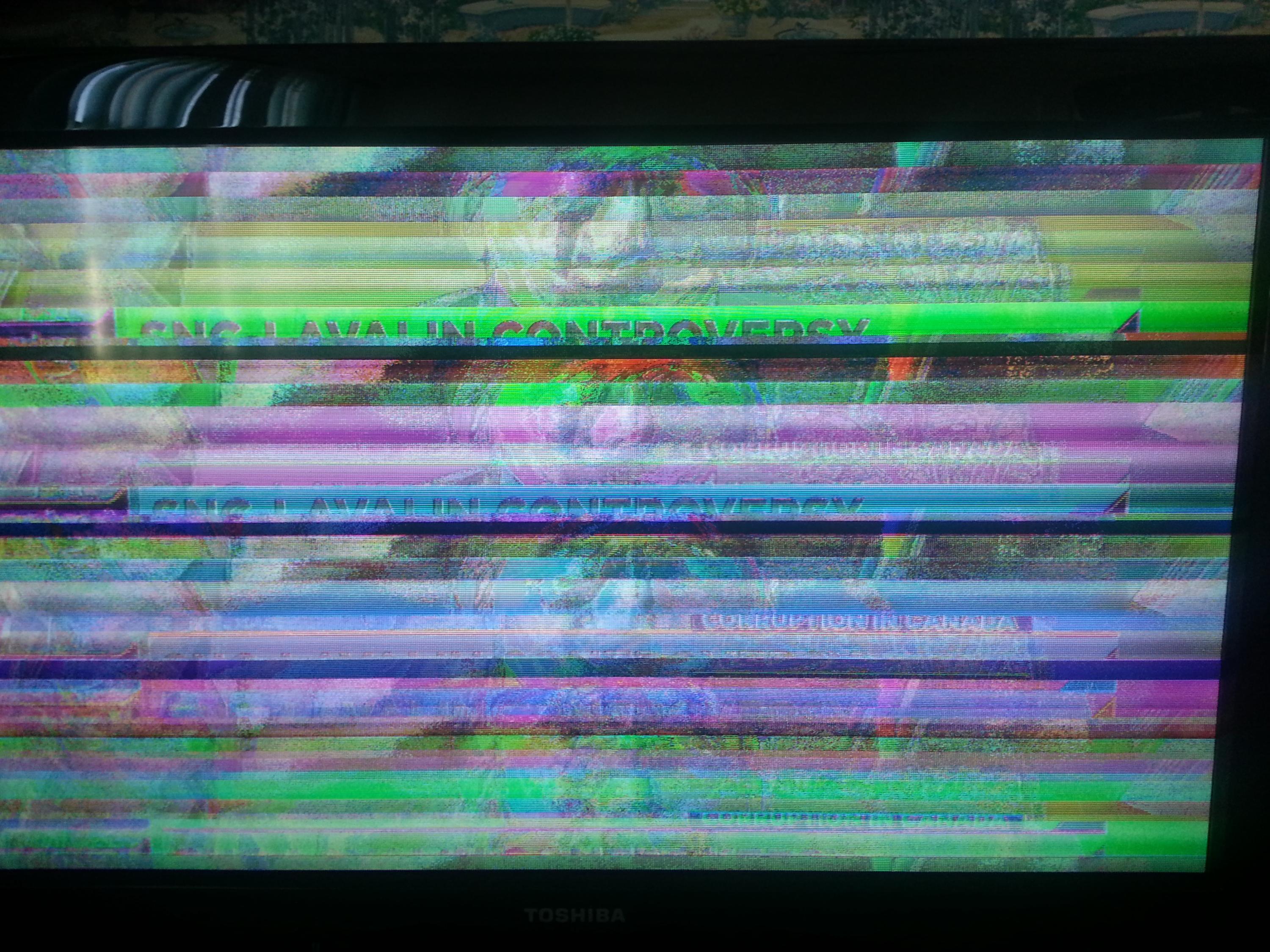

    Toshiba 32C120U. Looks like T-Con symptoms but it seems to be integral to the LCD panel. First two pics of the display are right after turn on, the 3rd is after about 5 minutes. Just thought I'd post in case I'm missing a possible solution.

    Re: Toshiba 32C120U T-Con symptoms
    T-CON Bd is under the metal cover at the middle-bottom. Yes the issue does look like a bad T-CON Bd.

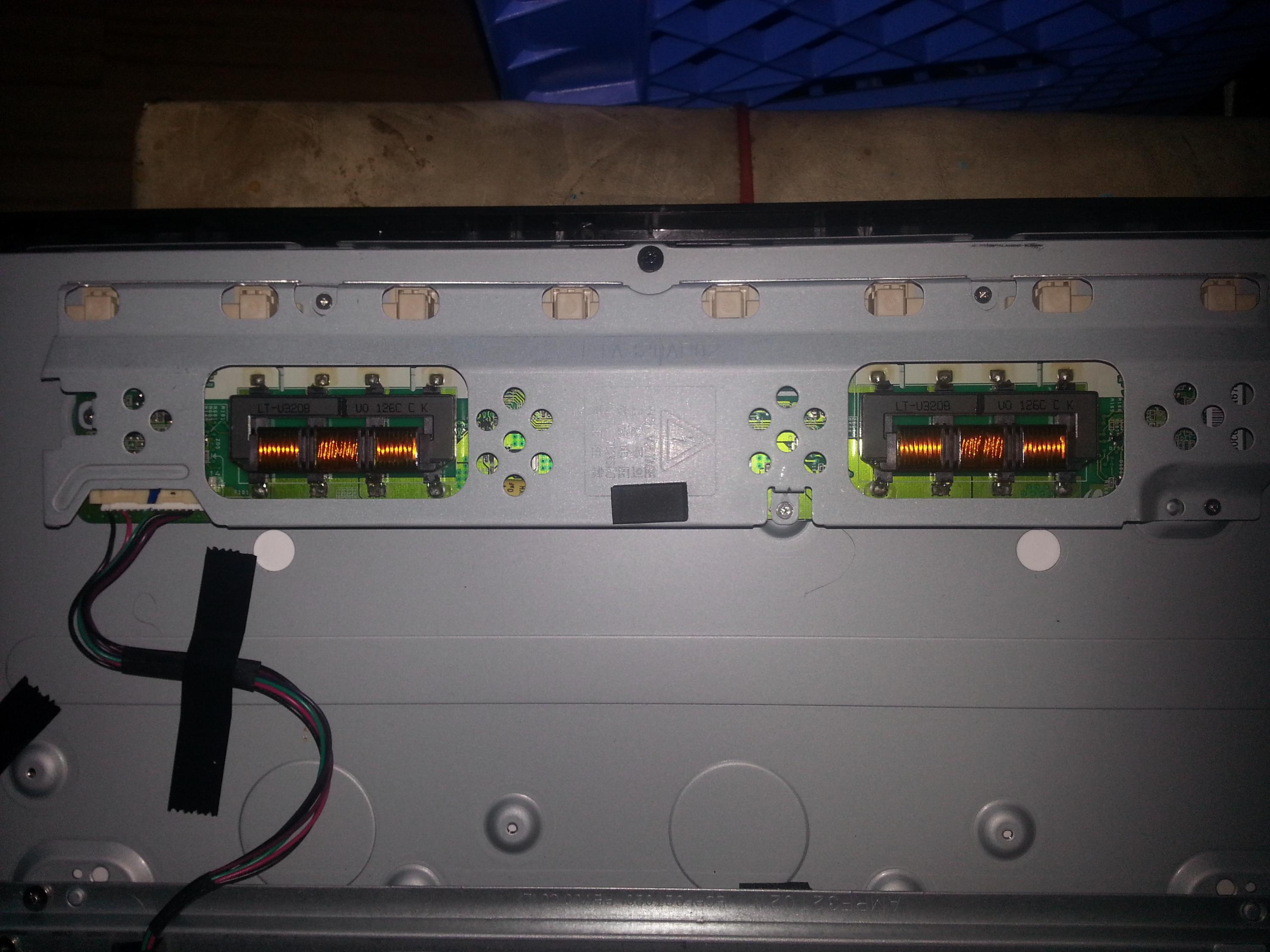

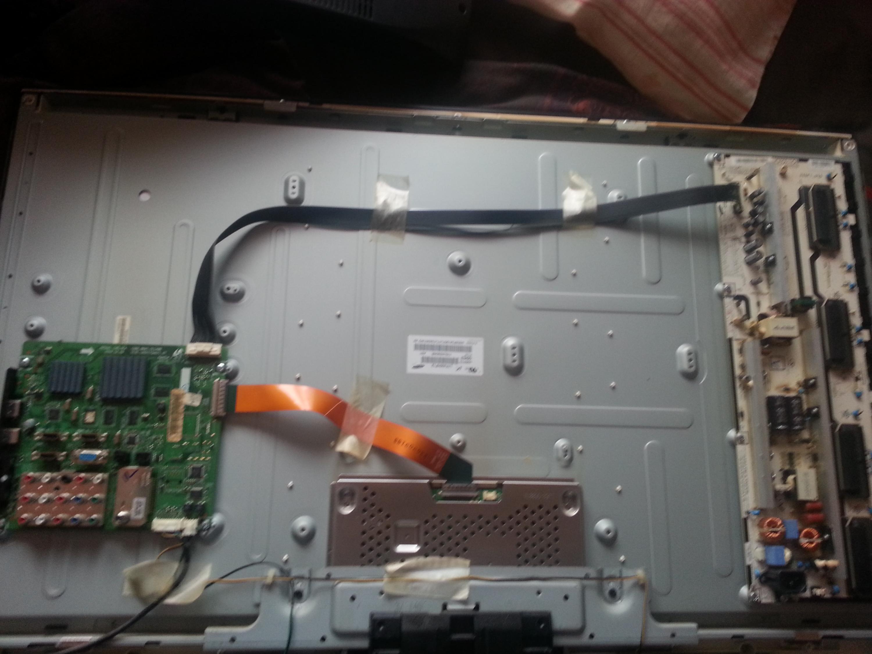

      Oops, posted wrong pic of the back. Here is the right one..
        Try a factory reset, might not fix issue but won't hurt any.
          Thanks for the input, no change after factory reset.
            See lvds cable going from mainboard to tcon? try reaseating it at tcon, maybe clean it with some isopropyl alcohol carefully don't want to damage anything. Careful not to force anything, should come off easy, usually by pinching both ends and sliding off.
              https://www.badcaps.net/forum/attach...6&d=1552226082
              That is due to bad Gamma Voltages.
              The LCD panel has integrated T-CON.
              What is the history of the TV?
                Cleaning made no difference.
                  Belongs to my neighbor. Don't know a lot about the TV. He said the screen would go black, turning it off and back on would restore the pic for hours or days until one day, he turned it on and the pic was as you see. Damn that integrated T-CON...lol
