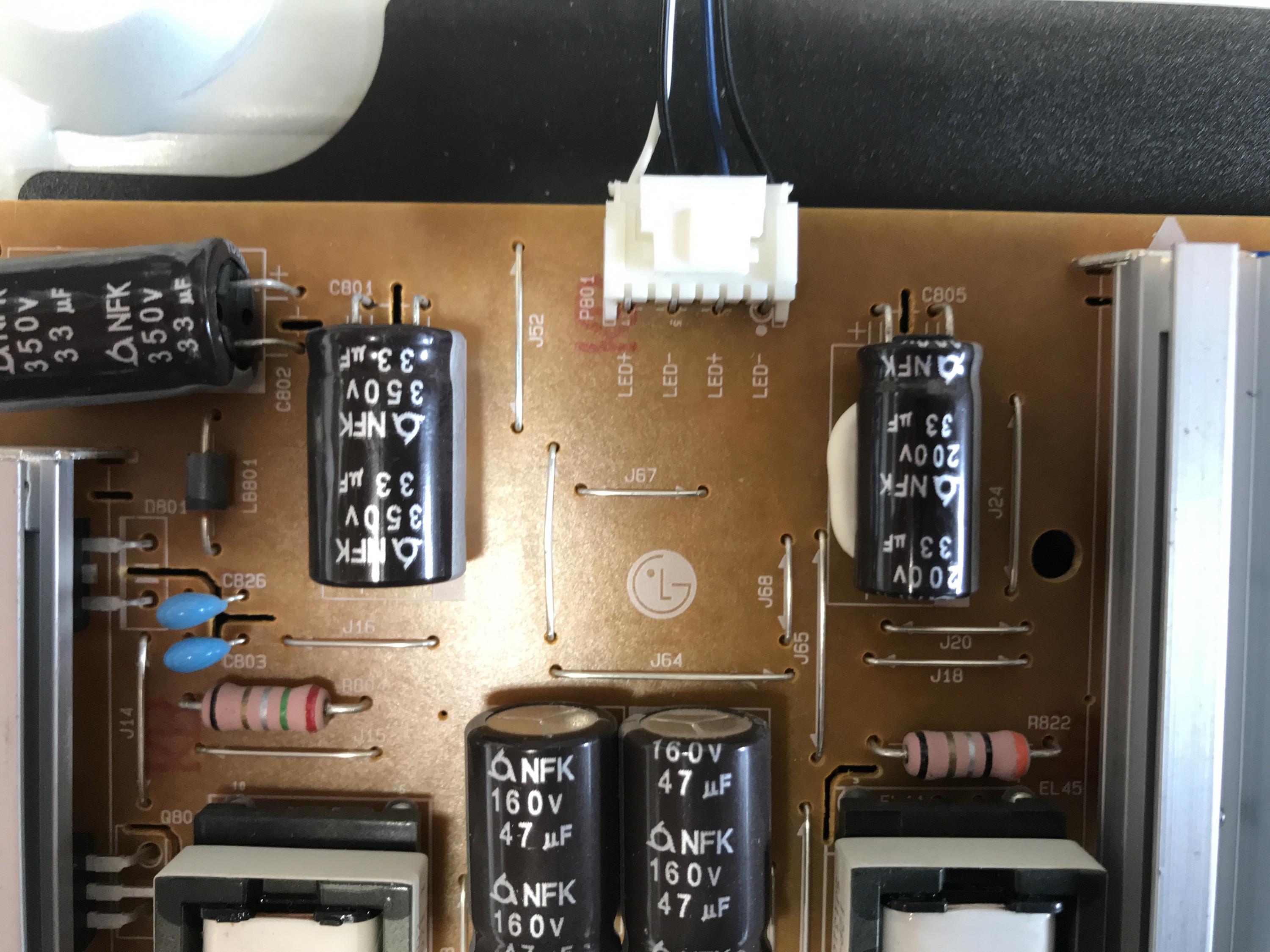

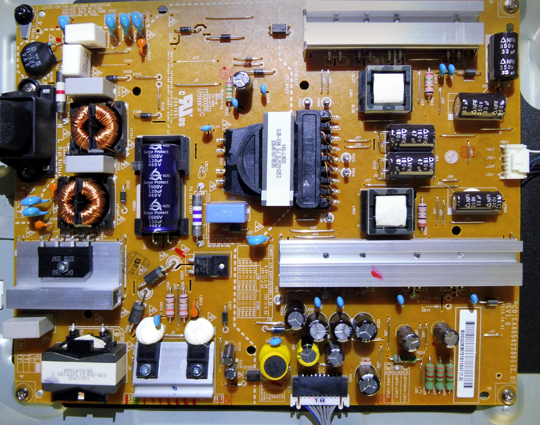

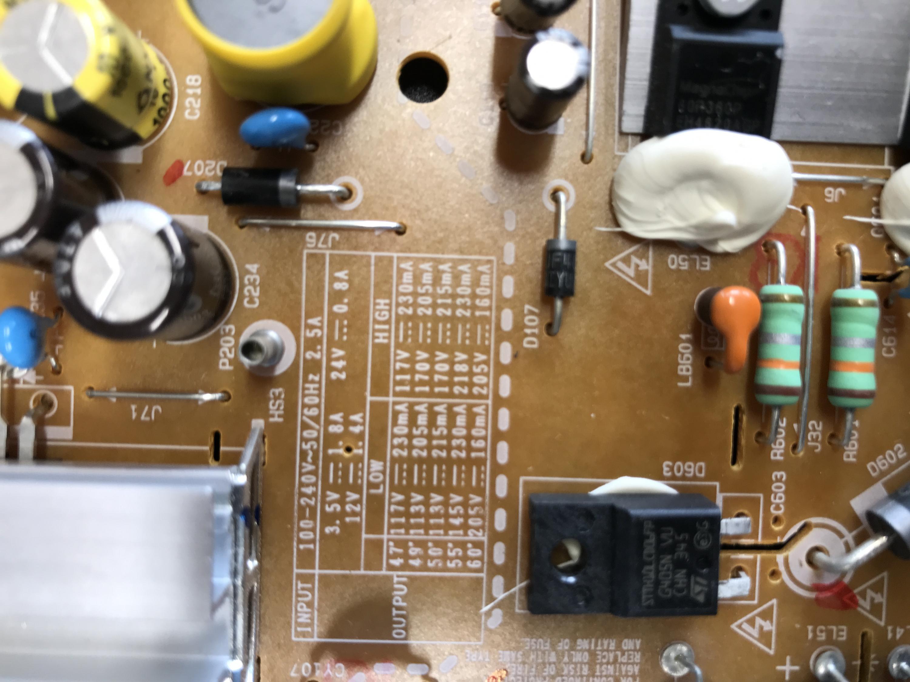

        Re: LG 55LB6100 Led blinks every 4 seconds
        Lots of stuff do not make sense to me:
        1) With the TV switched on, and driving the backlights with my backlight tester the blink still occurs. How do you drive the two strings of the LED st the same time with the tester? For it to blink the curent or the Voltage applied to the LED cannot be steady.
        2) On connector with negative on LED-
        Bank 1 = Solid 172.8V
        Bank 2 = Solid 113.7V
        No fluctuations
        The two LED - are the rectum lines for each LED strip, so to have that much Voltage on the LED - do not make any sense. With that much Voltage on the return line, it means you will have very little Voltage for the LED strings.
        3) If you look at the LED Voltage chart for 55" TV, one of the LED power supply is rated at 218v @ 230mA with load for the large LED string, for the smaller second LED string, the power supply is rated at 205V @160mA with load. Your report shows as: On connector with LED's(negative on chassis)
        Bank 1 = 241,1V solid: This is not right.
        Bank 2 = 161V solid: this is not right.
        On connector without LED's (with negative on chassis)
        Bank 1 = Range between 226V and 197V: It should be a lot higher without LED connected.
        Bank 2 = Range between 173V and 160V: It should be a lot higher without LED connected.

        • henryvrensburg
          • Oct 2018
          • 104
          Hi Budm
          You are right, I could only drive one set of Backlight banks
          The readings I got from the backlights were with the negative probe on LED- and the positive probe on LED+. You think this is incorrect.
          Looks as if you think it might be the Power Supply board because of low voltages to the Back Light Strip

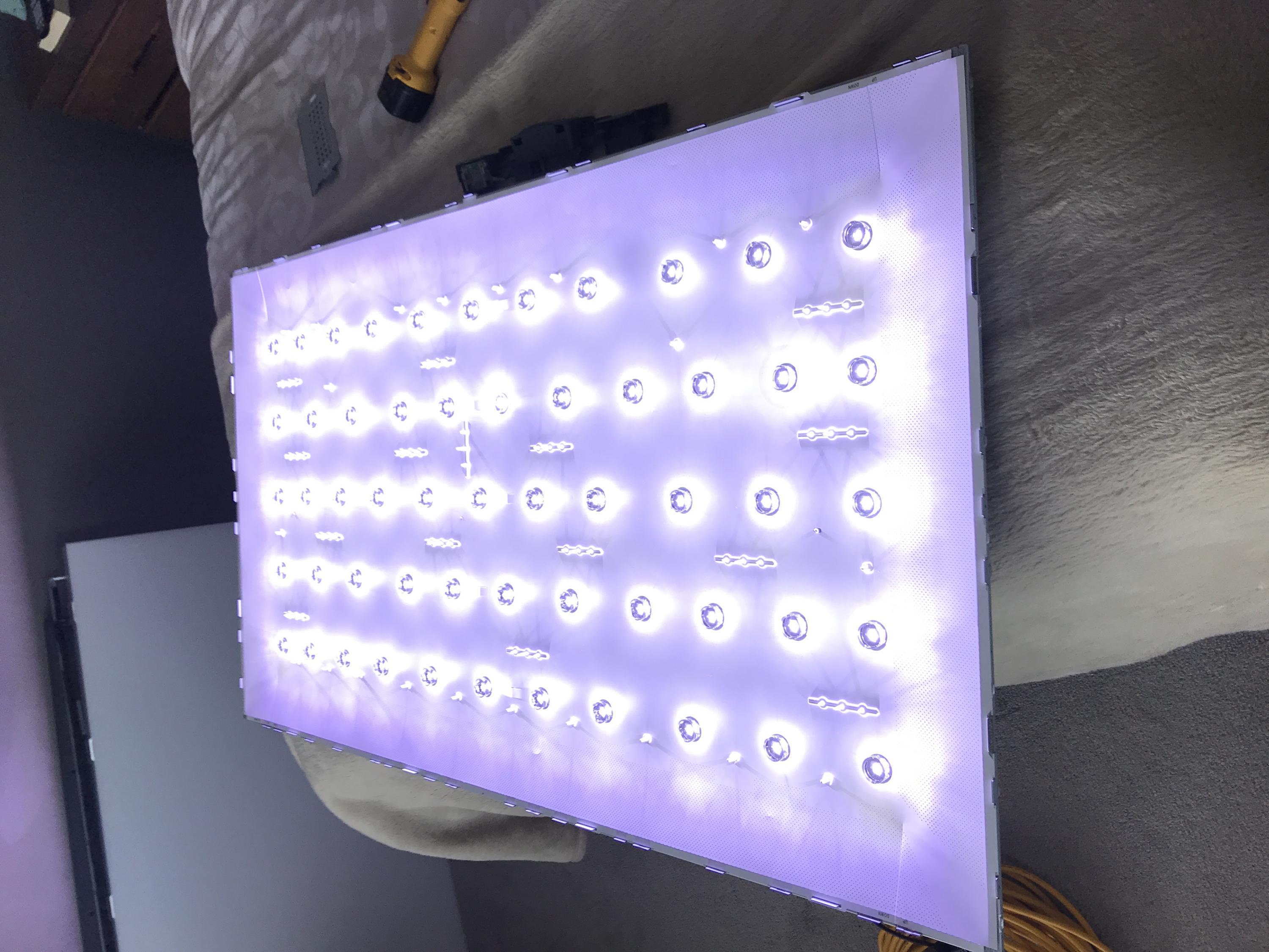

                      • neilc6
                        • Nov 2015
                        • 1550
                        Can you provide a picture of the backlights lit up with the panel and diffuser removed?

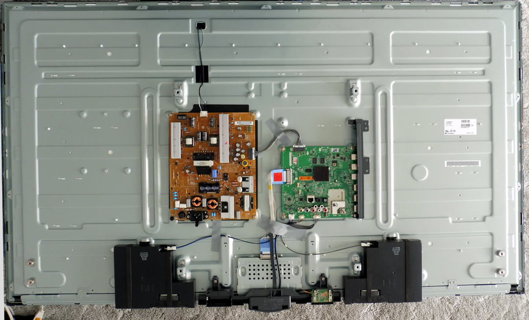

                              • henryvrensburg
                                • Oct 2018
                                • 104
                                HI guys
                                I decided to strip the TV down to the backlights. The attached photo is off the backlights. I can see no problem with them. They are all burning exactly the same, they are the same brightness, I also cannot discern any bad connections. I replaced the panel, testing at every stage, I could only see the slight dim again when the panel was connected to the T-CON board.
                                Is it possible that the backlights fail only on brighter settings, although I turned them down in the MENU to aroaund 40%.
                                Can it be the panel?
                                • nomoresonys
                                  • Jan 2013
                                  • 12269
                                  • U.S.
                                  Test the little capacitors on tcon board for shorts, diode mode, meter probe on each end, might beep if there's short somewhere on tcon or driver board.
