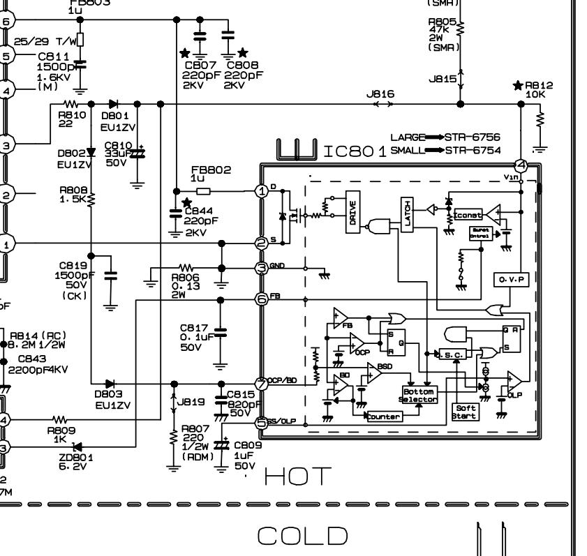

            Re: Lg crt tv :rt-29fb75ve chassis : Mc-049a
            The original was a STR-X6757, correct? this is a TO-3P case style
            The case are also different, the W TO-220, The X is TO-3P (like original)
            The original STR-X6757 is rated at 18 amps
            The other two 6756 are rated at 13.2 and 15 amps
            The W has pin 2 & 3 connected internally, the X has 2 & 3 seperate, so if using the X, make sure pins 2 & 3 are connected together on the pc board.
            Check if R806 resistor is good or is it a jumper wire?
            Check the voltages on the ic and post them here. I do not think you are getting fake parts.
              The STR-X6756 is a TO-3PF-7L package. 7 pins. Pins 2 and 3 are separate but usually joined on the circuit board.
              The STR-W6756 is a TO-220 package. 6 pins. Pin 2 is clipped. Pin 3 internally serves the same function as joining pins 2-3 on the X6756 version.
              These chips have the same functionality but completely different size and pin spacings so they are not interchangeable without lots of modification.
              Also not same rating as the STR-X6757. Why are you trying to use 6756 instead of 6757?
              I recommend you get an exact replacement.
              At one point, you said resoldering the original STR-X6757 worked but stopped working when you closed the cover...
              Did you follow my advice to do a major resolder on all major components ? I honestly think you have intermittent cold solder joints that are made worse when the cover is closed.

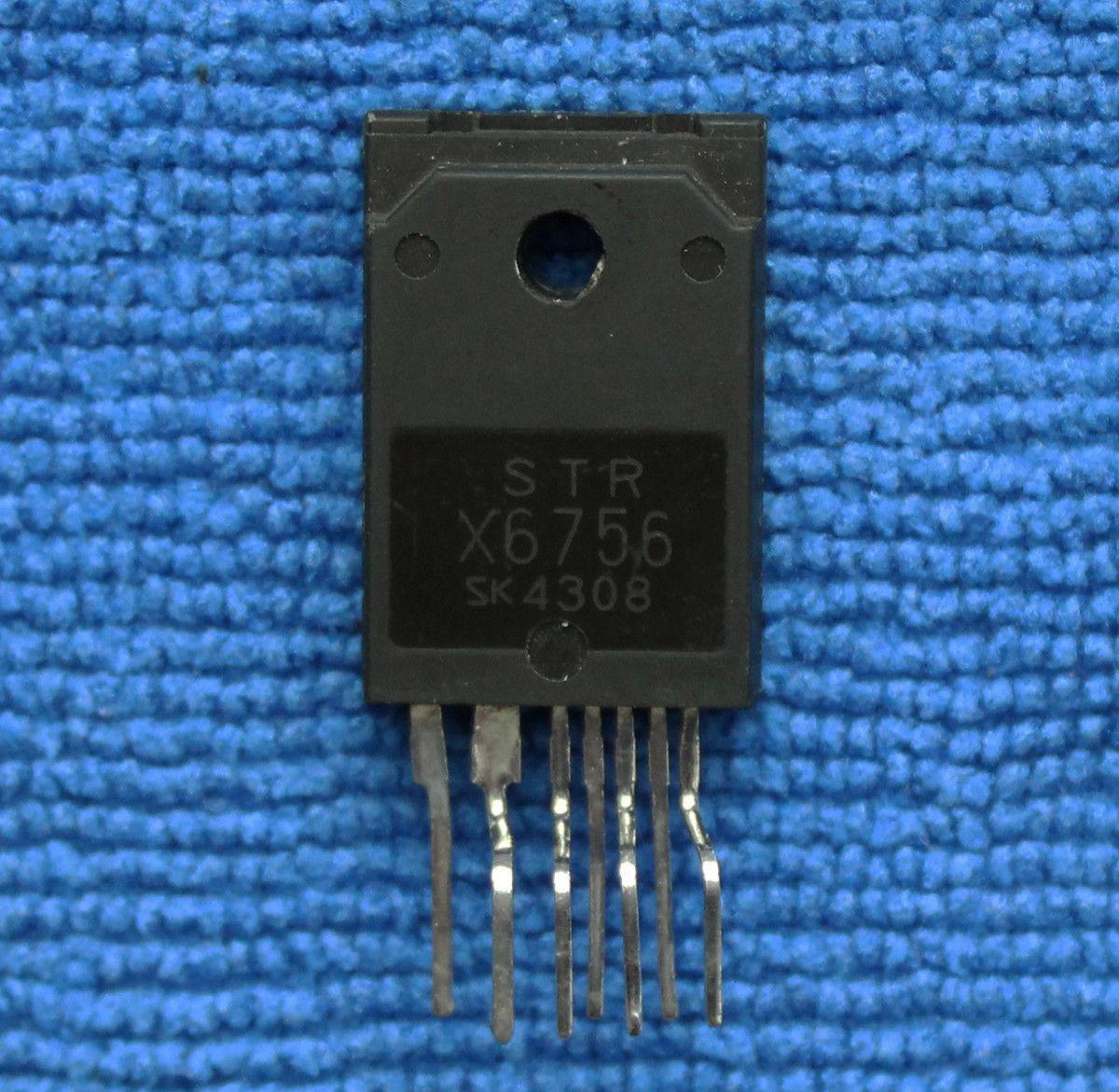

                You know what guys?
                I still think that the original STR is ok
                I also still think that the ones we got are not fake, but both my pros said that they found dead voltages out of it!, I am not an expert
                PLEASE NOTE THAT THE ATTACHED photo is for the actual str pulled out of the tv
                yes you can see other model number in the manual screen shot I sent,but that is the one, if you download the full service manual from the link I sent in the very first post you should find it matching
                the last pro DID re-flow and change many caps around the power area, still dead, it does not work at all now
                both pros are putting the blame now on fake str replacement!!, i heard it is very hard to test an str outside of the set but i thought to ask you here guys! is it possible to test an str?
                Thank you very much for your care and support
                  If the original is a STR-X6756, you posted the wrong number in your first post.
                  If all I have to go by is
                  I can't help much.
                  You need to at least post pin number and the voltages on the ic.
                  I suspect the ic is also good, and you have a cracked circuit trace on the board
                  What is the voltage on The main capacitor C803 (330µf/450v)?
                  What is the voltage on pin #1 of IC801 ?
                  What is the voltage on Pin #4 of IC801 ?
                  These voltages must be measured with negative probe on (-) of C803 (HOT GROUND)
                  Check R803 (1Ω/15watt) and check it's solder connections
