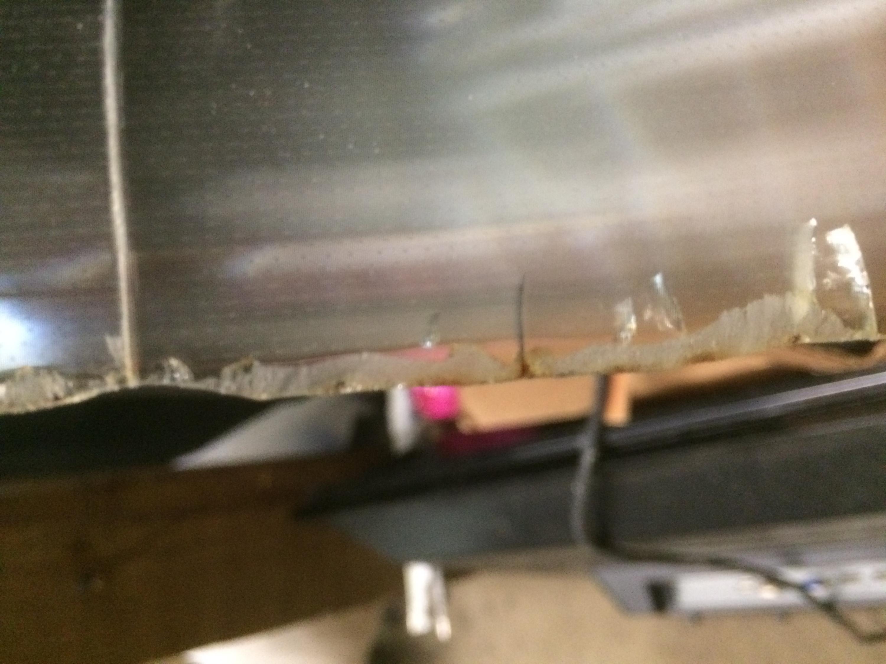

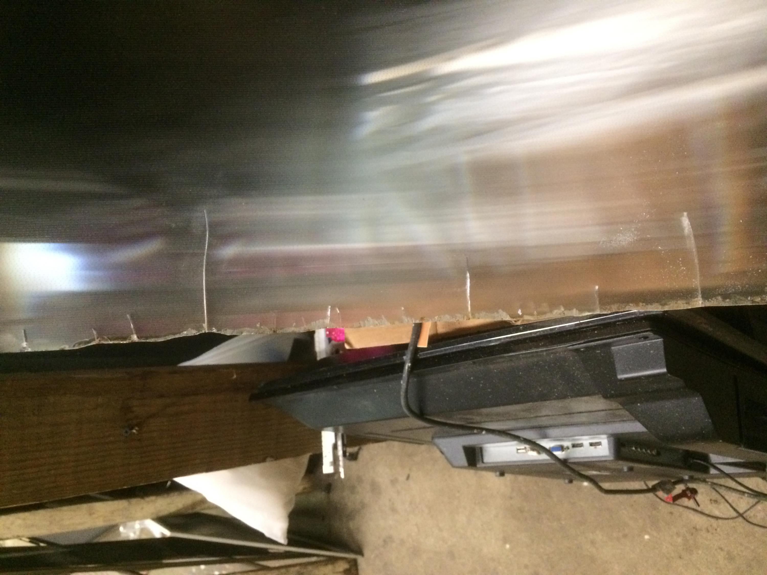

    un65js8500 Diffusing panel
    Ive replaced the side edge light led on this tv, but they were so bad they melted the thick hard diffusing panel.
    Ive shave most of the burn part off, but still cant get the light to travel to the middle of the screen..
    Also tried replacing it with bottom edge light diffusion panel,it fits.. but still no light to middle of screen..
    Any Suggestions?
  • Unspun01
    • Jun 2011
    • 343
    Re: un65js8500 Diffusing panel
    Honestly, even if it works, the diffuser panels will be discolored from heating and image quality on your panel will be terrible because of extreme yellowing or dark spots.
    I would safely put the TV together until such time that you can locate a cracked screen TV of the same size (to use diffuser panels) or the same model (to keep everything intact and just transfer the good panel LCD to use with the good diffuser and backlights).
    You may even find diffuser films from other brands of 65" or larger cracked screen TV that you may use...
    There is no reason to re-use those diffusers because they are completely damaged.
