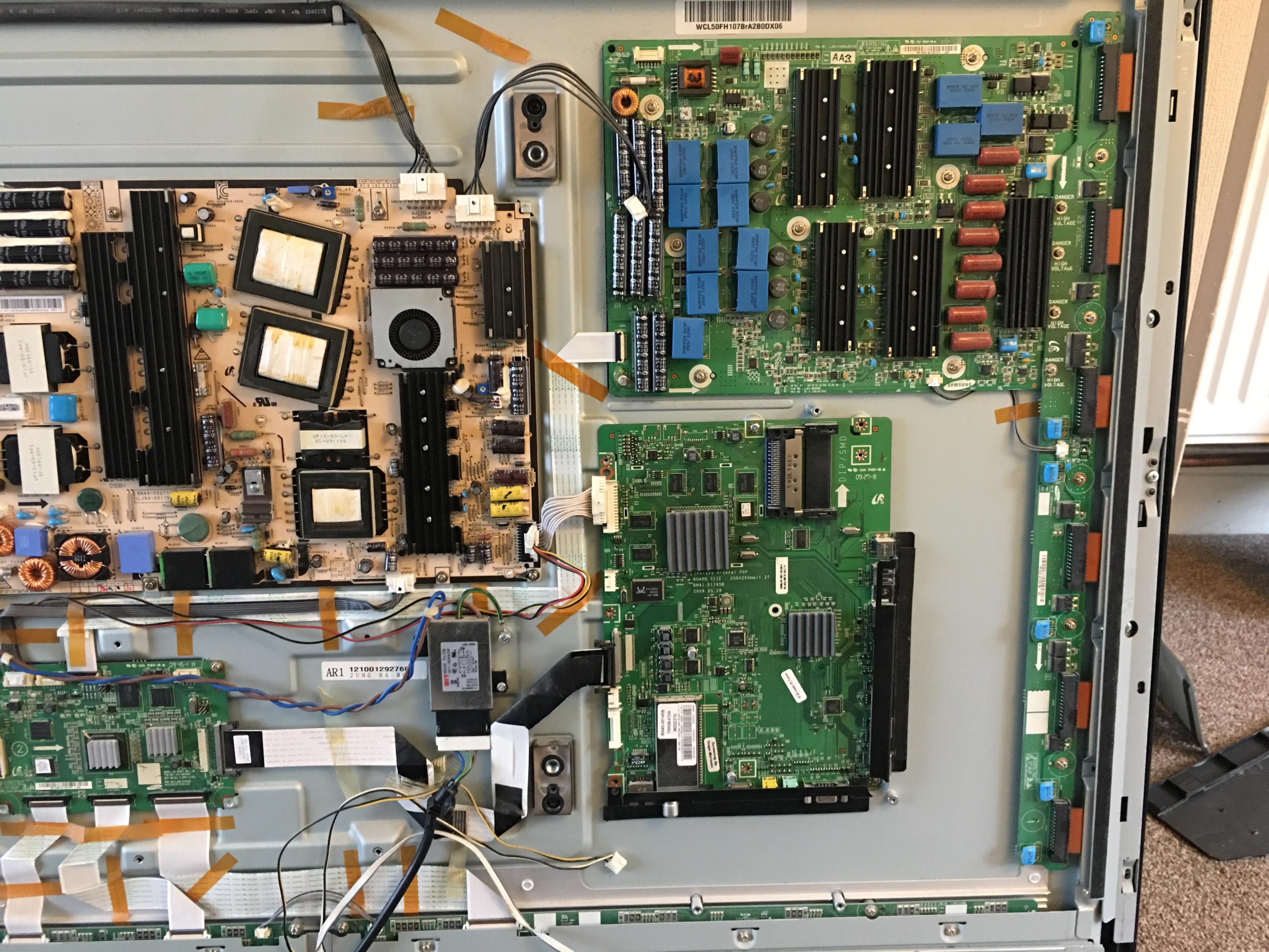

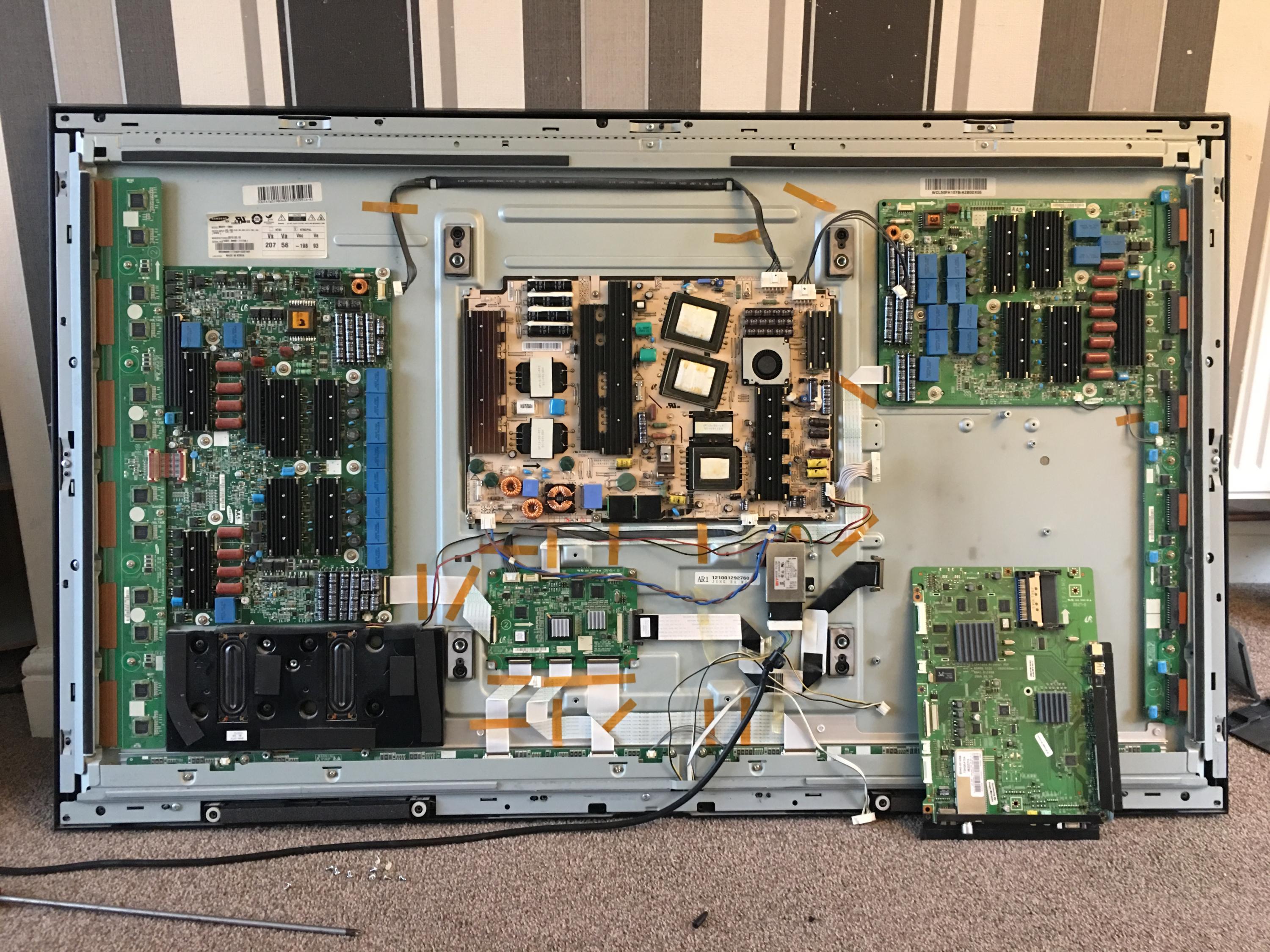

    Hi All
    Been a long time since i had a plasma and just my luck one iv never seen before
    PS50B850Y1W Just clicking

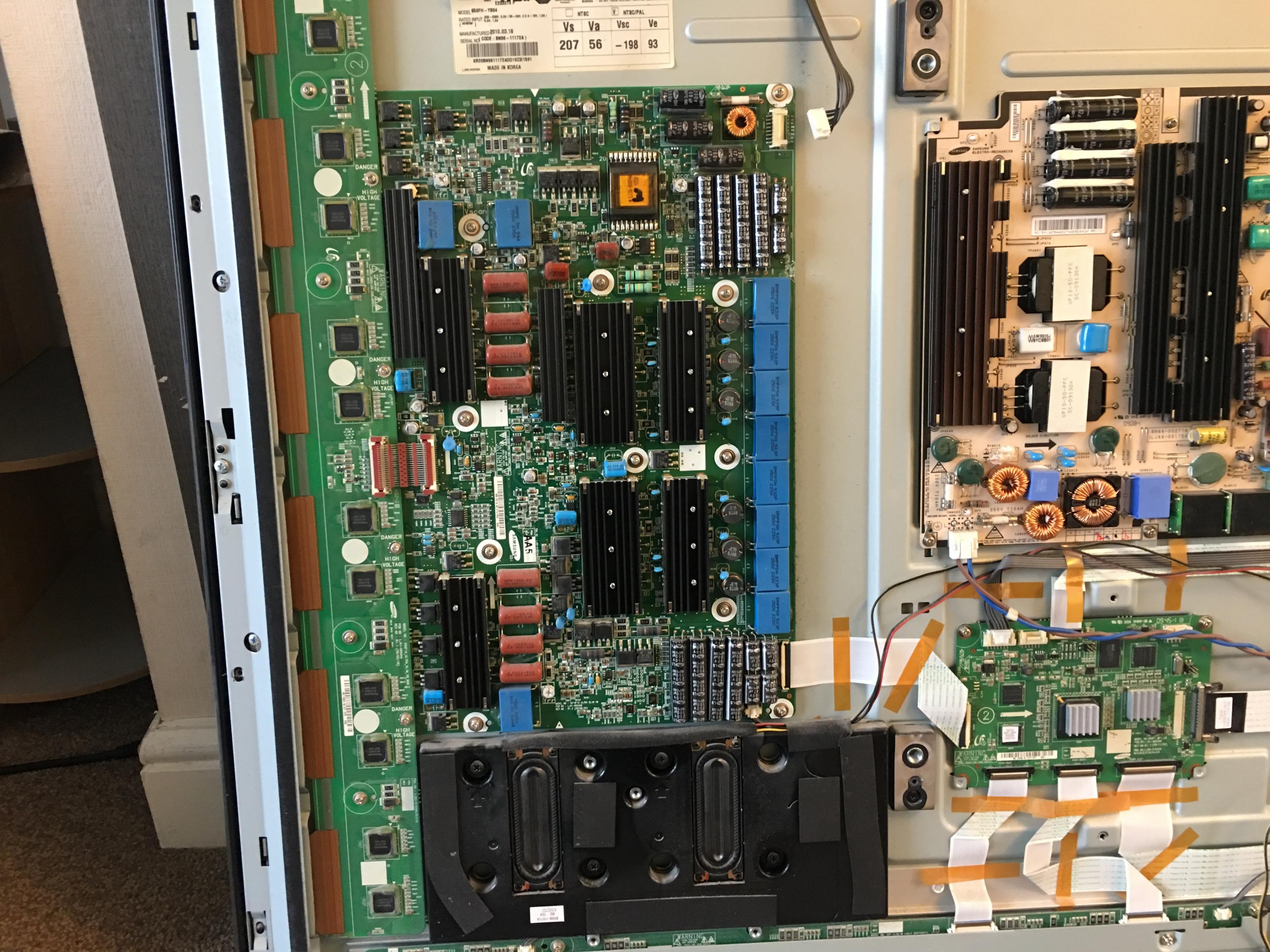

    Va and VS come up briefly while its constantly clicking
    I have tried disconnecting YSUS then XSUS but still the same
    Both Y board and X board do not have short to ground on either VA or VS

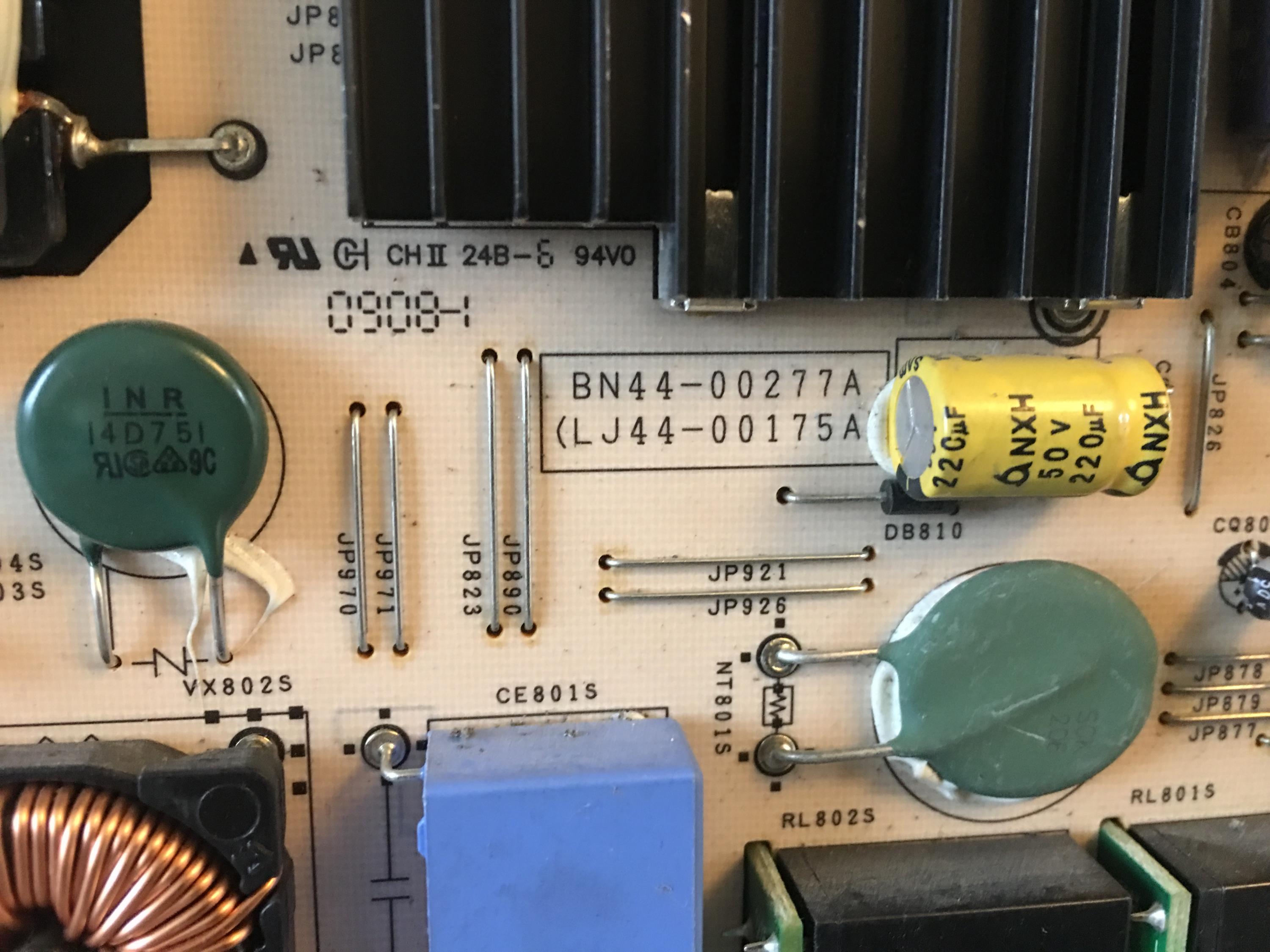

    On the powerboard and i noticed it had some damage to the fan wire(been cut), not trusting this board iv tried a replacment but its still the same.
    Can anyone help me with jumping the power supply on so i can rule the mainboard out ?
    Also any oter checks i can do ?

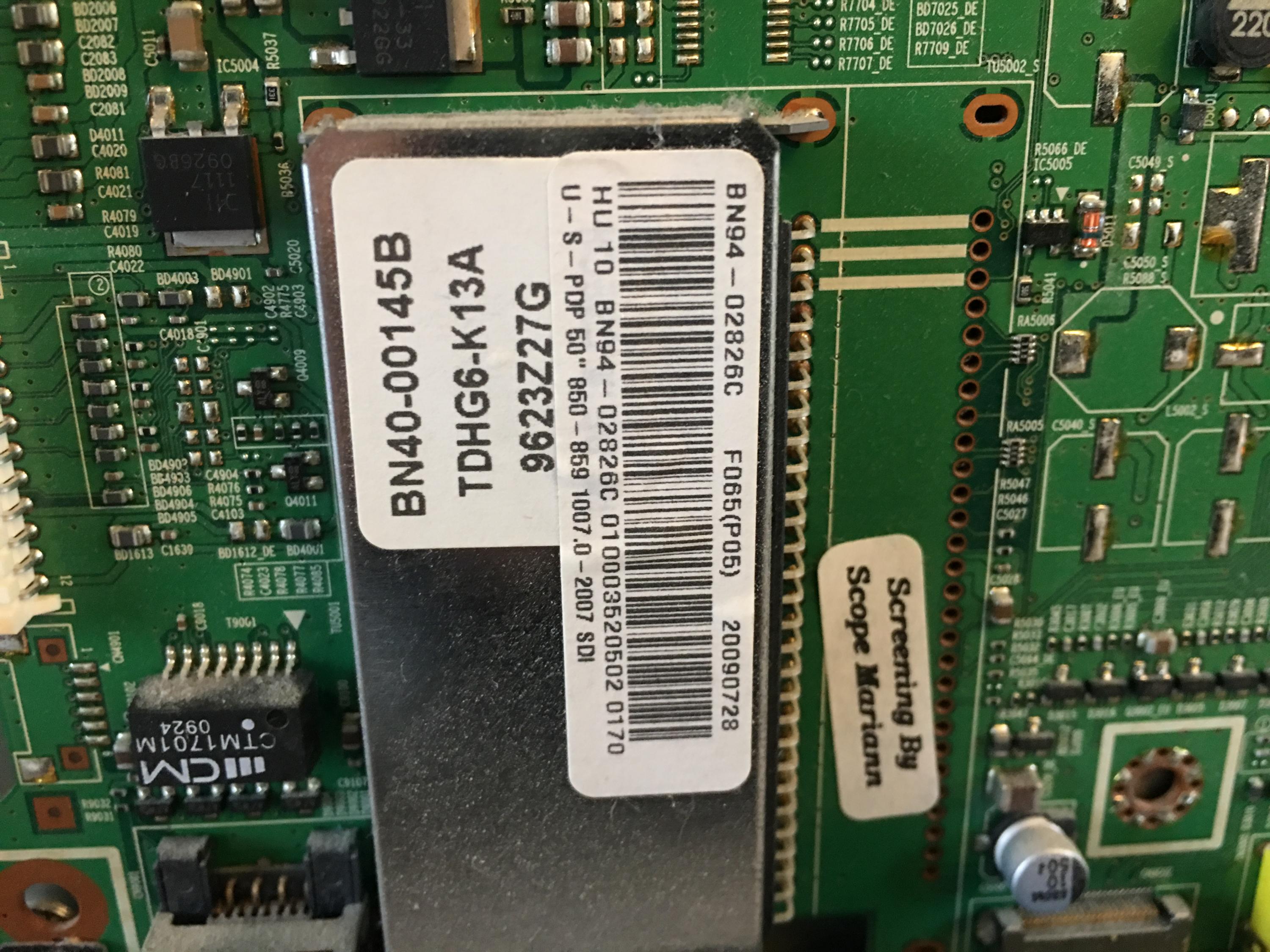

    PS - BN44-00277a
    Main - BN94-02826c
    Regards
  • noledud
    • Dec 2013
    • 413
    • united kingdom
    Re: Samsung PS50B850Y1W No power just clicking
    Jumped PS-on to GND and the power supply all came up with correct volatages and all boards plugged in = Mainboard ordered
