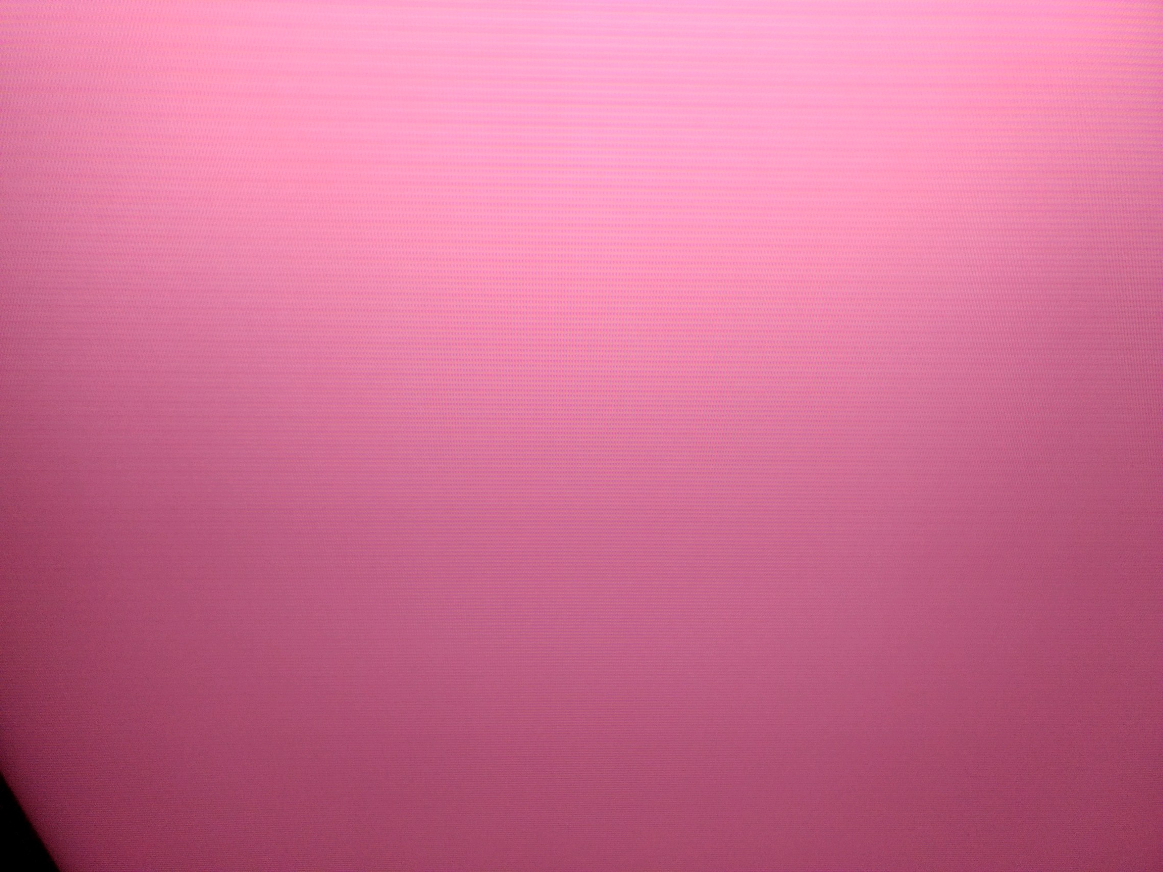

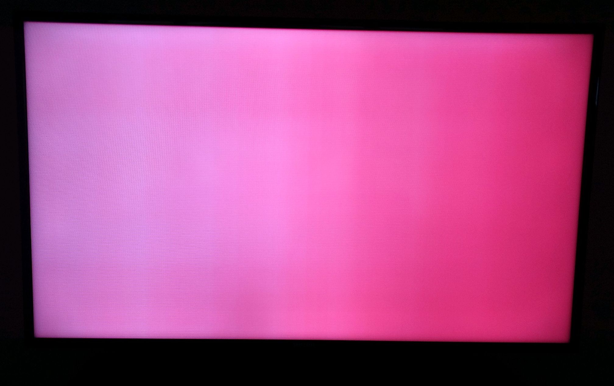

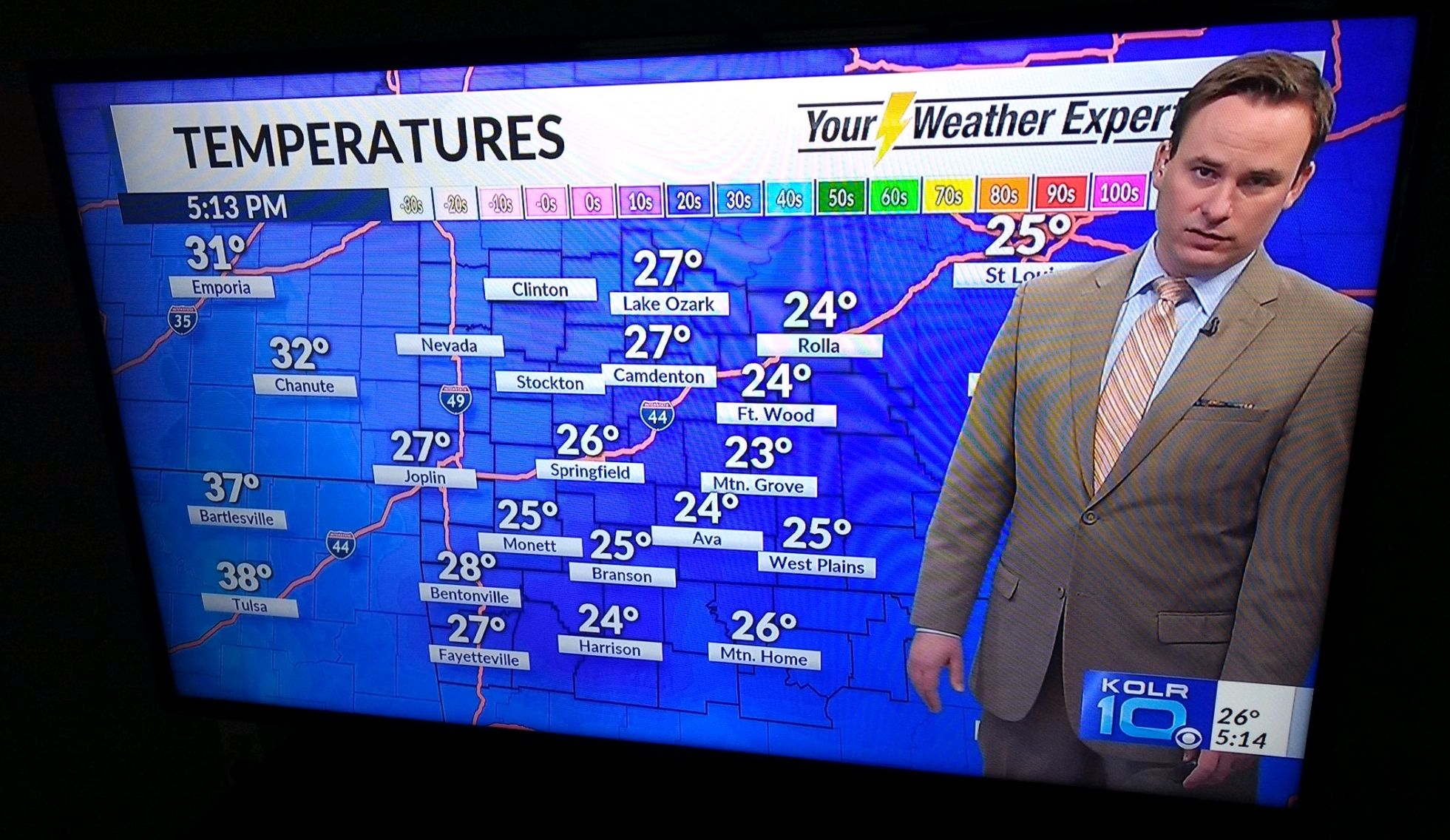

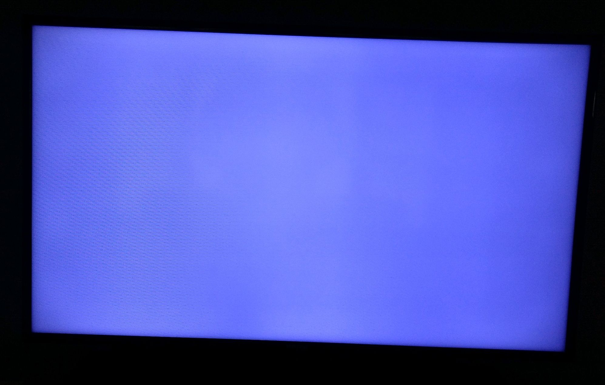

    Bottom line, I kept the original FFC cable and replaced it with one from the parts pile and cut through 7 traces on the left side, just under the T-CON. This is what it took to restore a watchable picture but it still has very faint horizontal lines and colors in or close to the red range have lost color strength. For a rescued TV it looks really good for the most part.

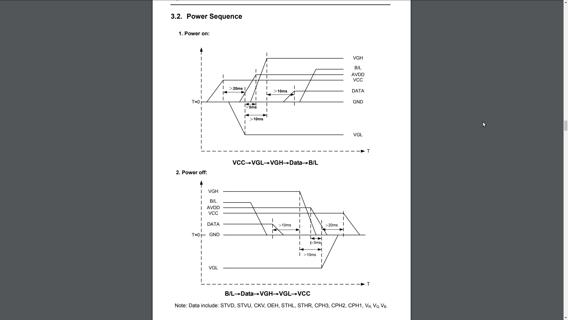

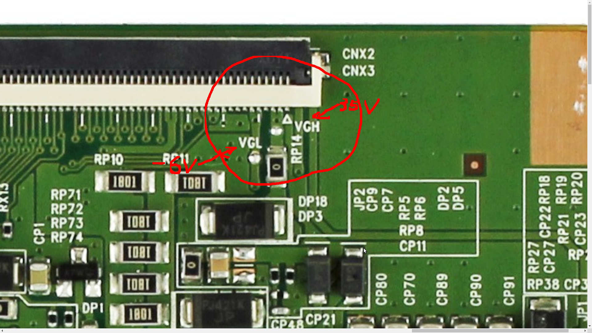

        i don't think you could cut more traces on Samsung BN96-30067A (V650HP1-CPS1) T-Con Board's FFC cable which would be LVDS TTL picture drive signals..... photo 1, 2
        the 6 traces, you've insulated are VGL VGH, the answer is as simple as yes or no to VGL VGH power sources.
        You can refer video below. Some people have to fix this missing VGL VGH scan driver voltages and some people have to avoid this VGL VGH scan driver voltages which could avoid some TTL picture drive signal shorted problems, as you did....please don't tell me, you did cut other side!
        PS: Isn't this a good idea, if we can put DIP switches on FFC cable?
        references
        What is VGL VGH?
        Two regulated adjustable charge pump driver provide the positive V(VGH) and negative V(VGL) bias voltages for the TFT. The device incorporates adjustable power-on sequencing for V(VGL) as well as for V(VGH). ... The device has an integrated high-voltage switch to isolate V(VGH).
        VGH 0.3 - 40v Typically Operation Conditions 35v
        VGL -20 - 0.3v Typically Operation Conditions -6v
        VGH P Positive power for scan driver
        VGL P Negative power for scan driver
        LCD LED TV PANEL REPAIR VGH VGL FAULT REPAIR BY MAGICCARE ELECTRONICS.
        https://www.youtube.com/watch?v=rHw4O-6lZ2o
        GATE COF RM76180FC-086 BONDING ISSUE, HALF SCREEN BLANK, HORIZONTAL BELT, VGH/VGHC MISSING
        https://www.youtube.com/watch?v=zIFcxfdh25E
