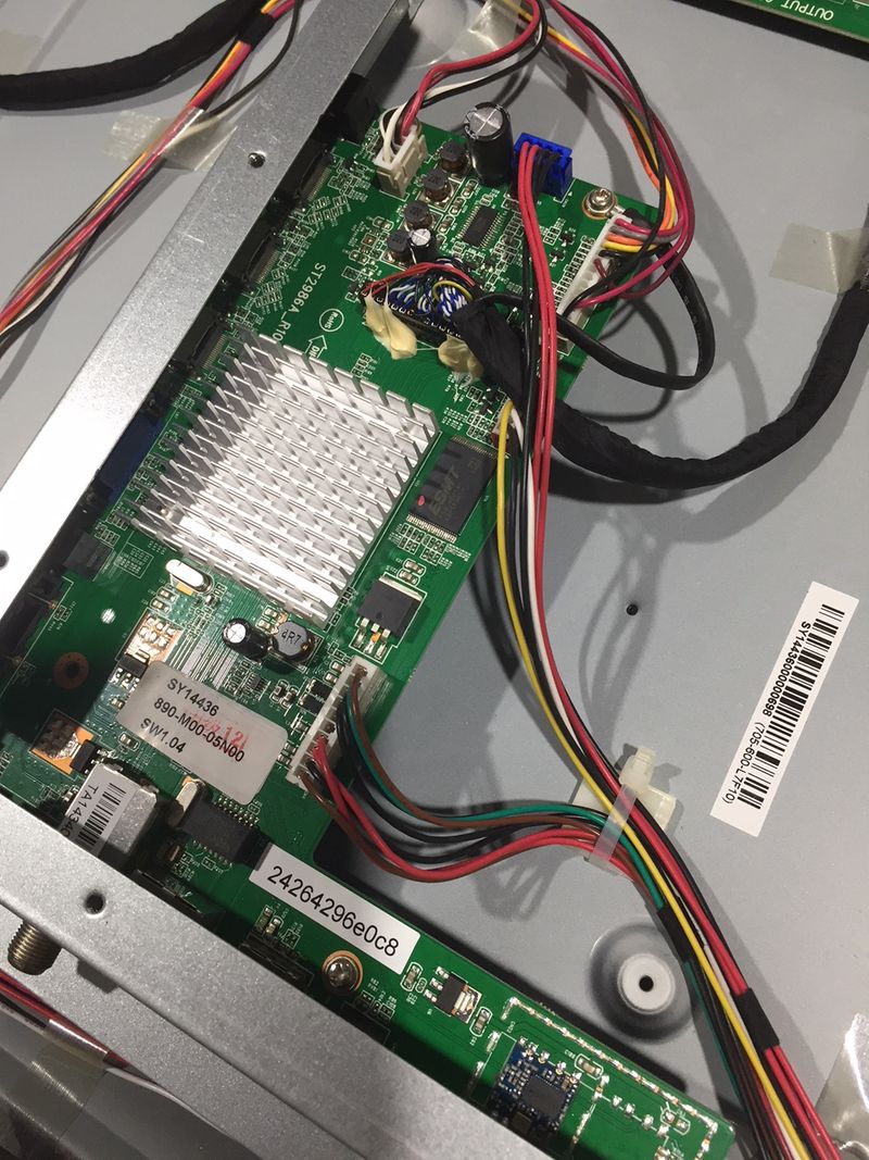

sharp lc-60le644u no control no osd.
  • sputnikoff
    • Feb 2016
    • 203
    • canada
    Just wanted to give back to an awesome forum.I had a sharp 60le644u today that would show red power light and dull backlight screen when plugged in,no response to remote or controls and slightly lit screen.After some checking found it pointed to motherboard sy14436.I had one from another tv tried it and up and running.The main processor on board was kinda hot with in a short while which pointed me to this board.Anyone else have issues with this one.
