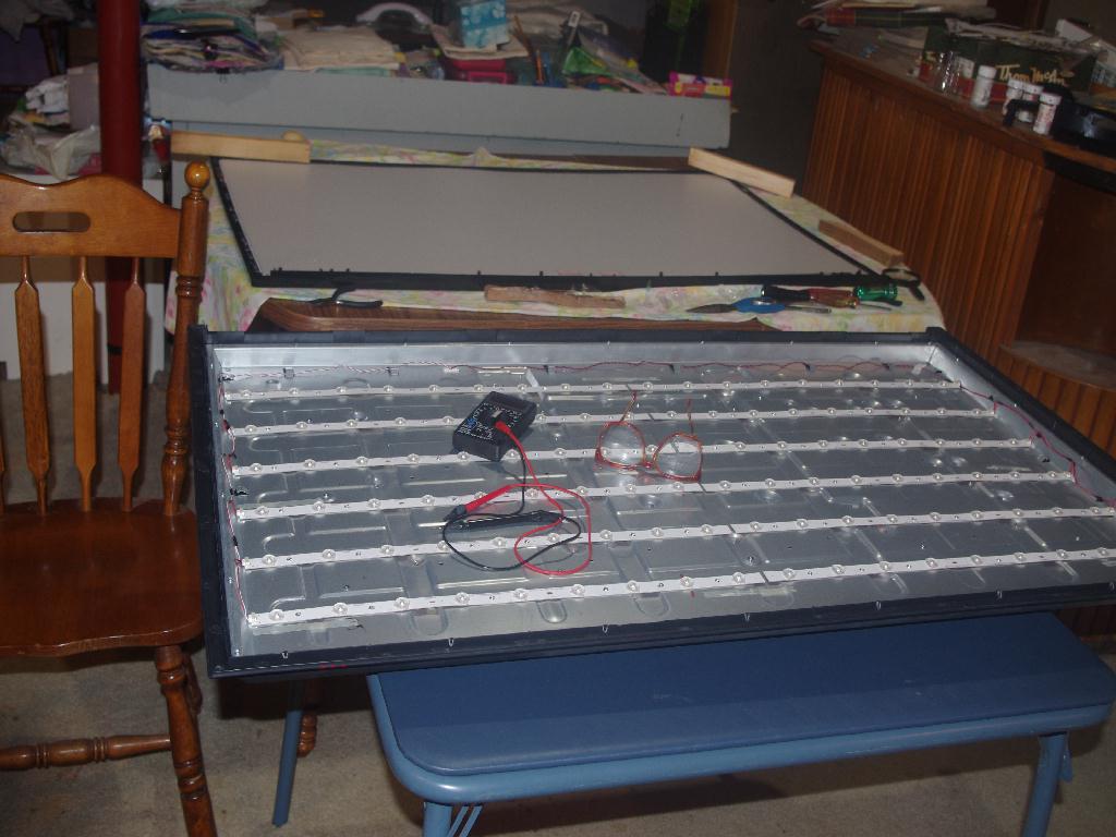

    Rca le55g55 a 405194022015
    RCA LE55G55 A 405194022015
    Sound but no backlight/picture.
    This TV comes apart by laying face down and removing the back cover (s).
    This leaves the screen and related parts intact and the led panel is lifted off
    for service
    I found 2 bad LED's.

    Re: Rca le55g55 a 405194022015
    Good job. I'll recommend changing the entire strip/s and not the individual LEDs. on repair completion, turn down the Backlight setting tp 60-65%.
      Thanks Andrew , I plan on doing that.
