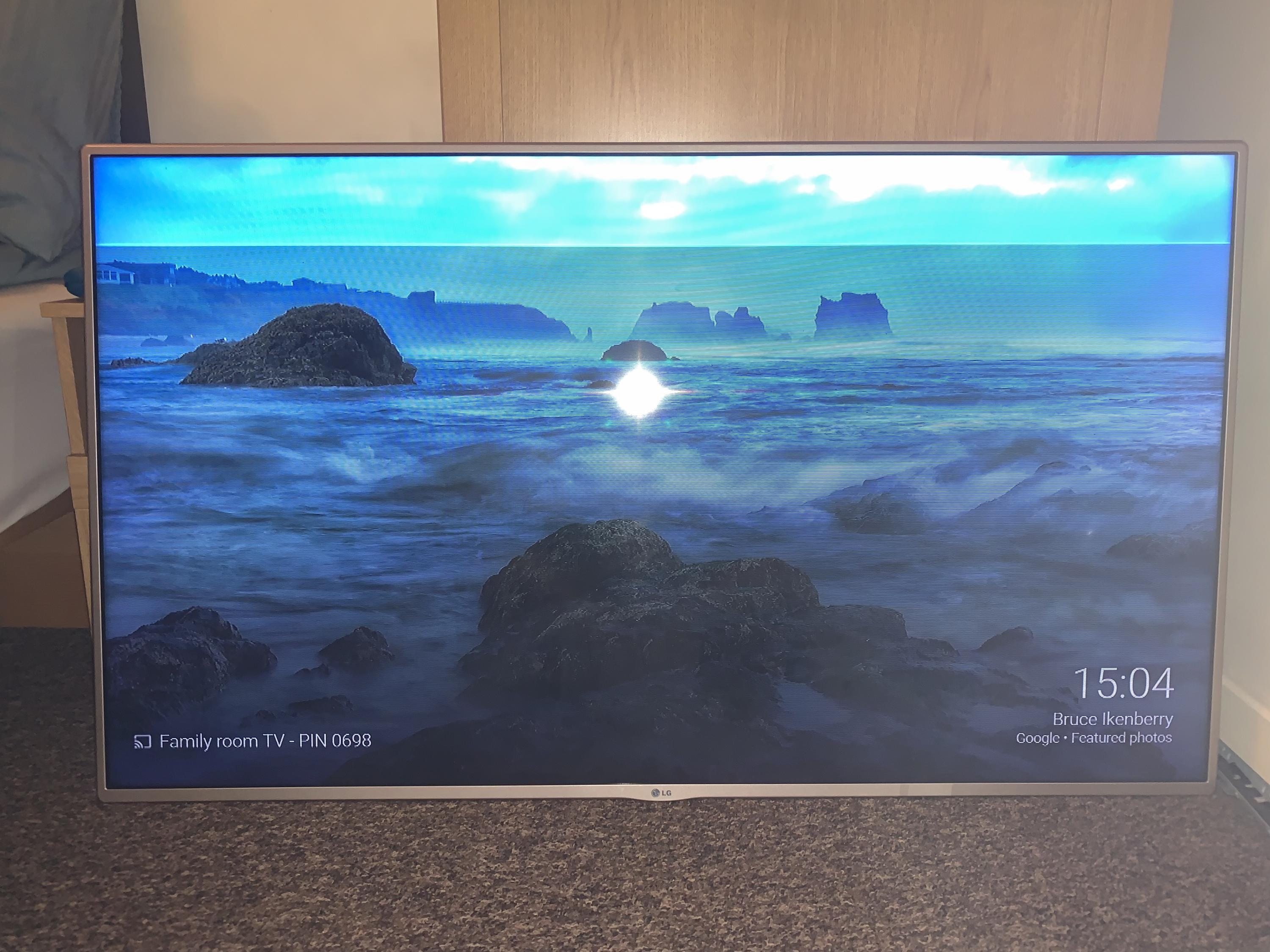

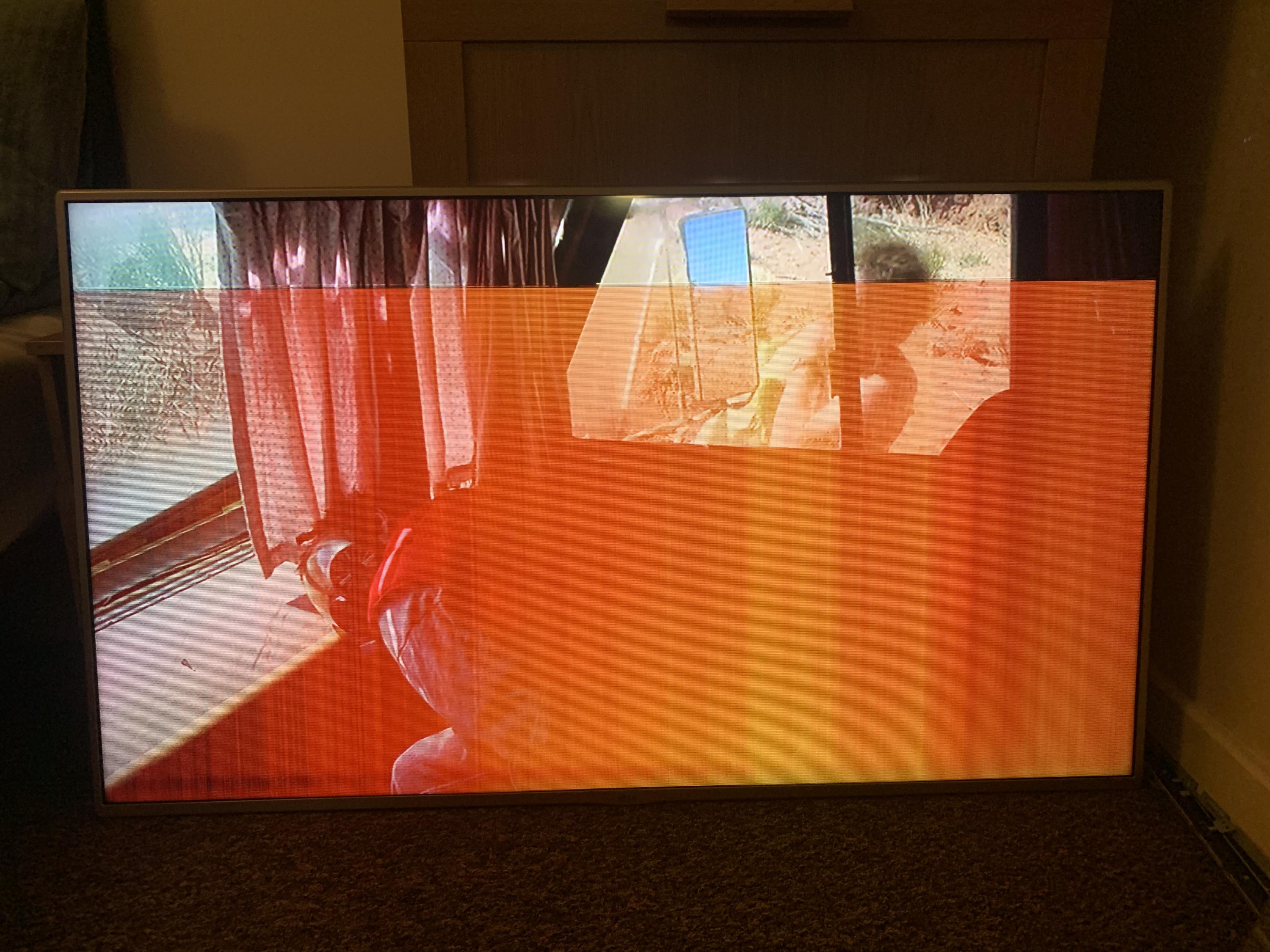

    I was hoping someone might be able to tell me whats wrong with this LCD TV or point me in the right direction. I don't know the history of this TV. It came from a friend who acquired it from their place of work with this fault.
    There is a horizontal band across the top of the screen which appears to be unaffected but below this band the screen has horizontal black lines. After a minute or so the screen progressively gets saturated in yellow / orange colors which moves with the images displayed on the screen.
    I have replaced the tcon and AV board but unfortunately that didn't work.

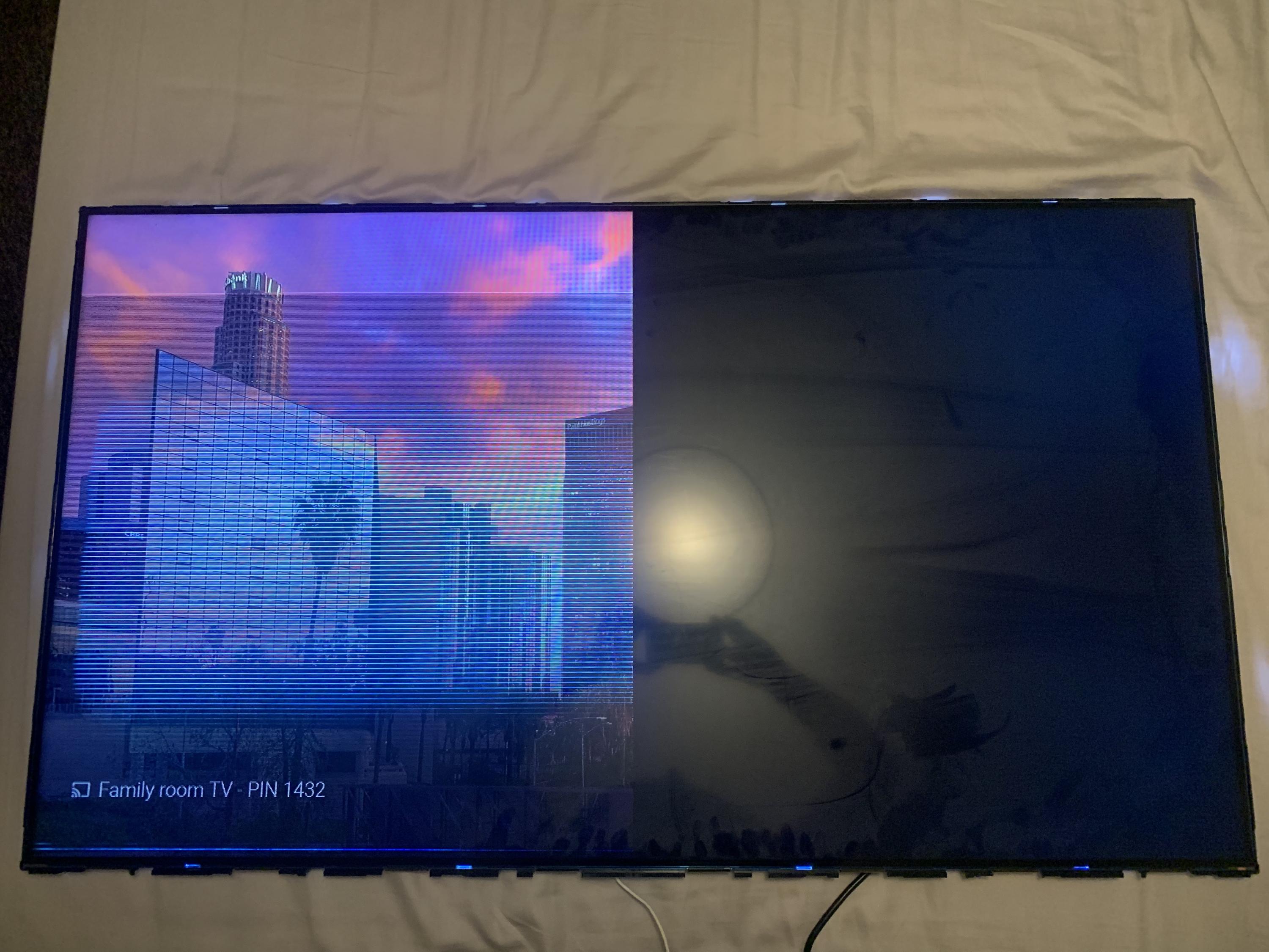

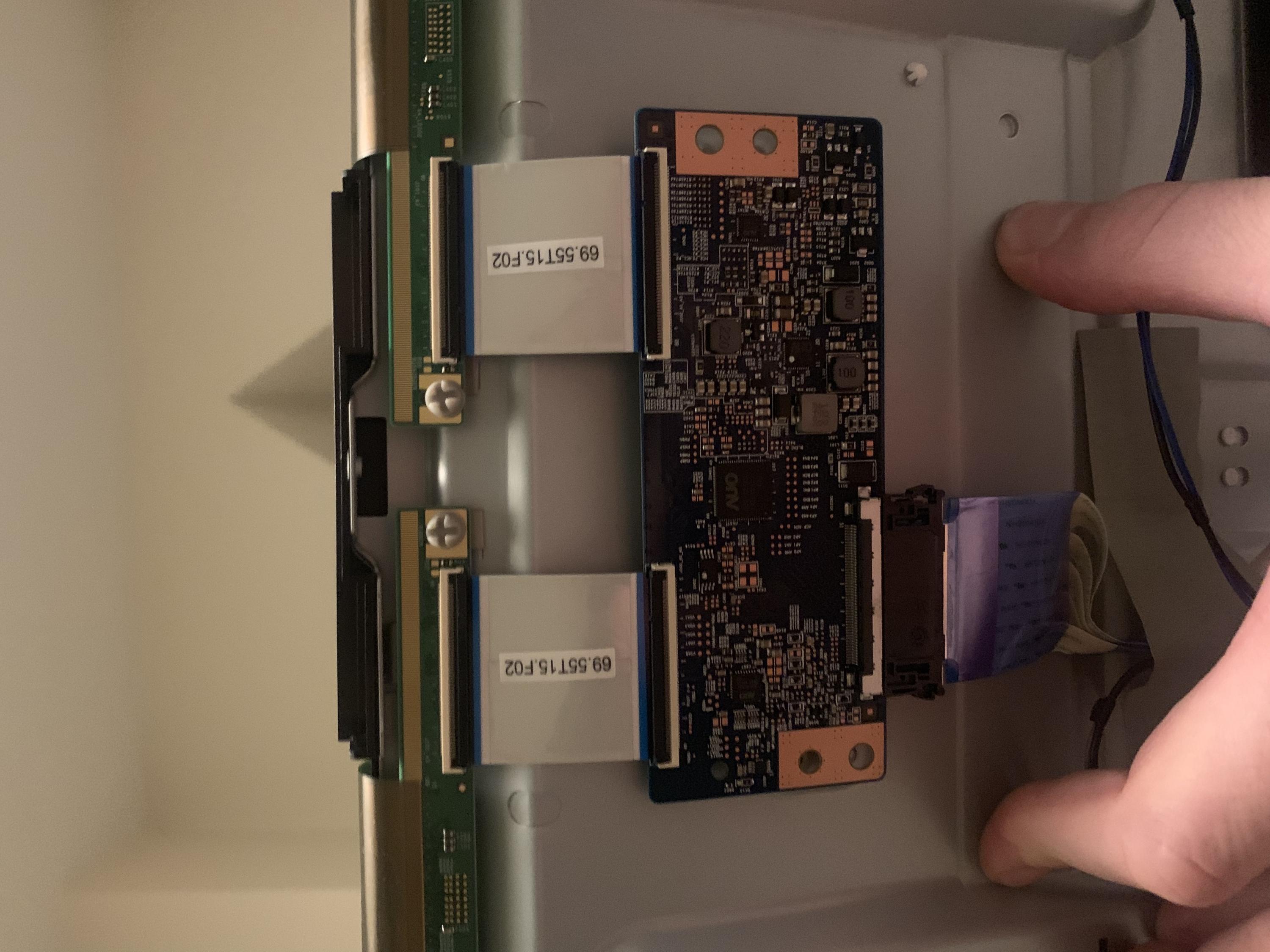

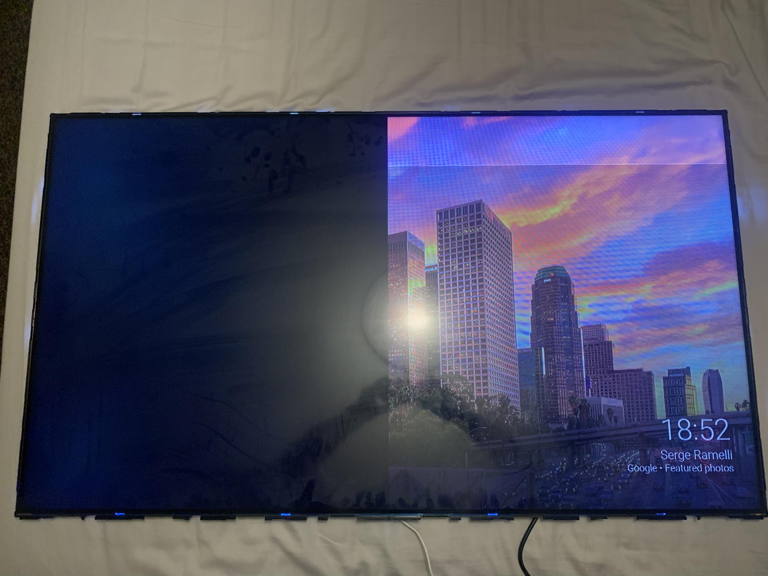

                  Thank you both for your input. It appears that there is no interconnecting ribbon between the bottom left and right driver boards. The only thing that links these together is the tcon board. Image attached.
                  I removed the left and right ribbons one at a time from the tcon board and was surprised to find the same fault (but only on one half of the screen) regardless of which ribbon is connected / disconnected. Images attached.
                  I was going to try the "tape cut off" method but as it currently stands, it appears that both the left and right drivers are effected with an identical fault which may be the case but it leads me to believe the fault may lay elsewhere?
                  Please feel free to correct me if I've misunderstood.
