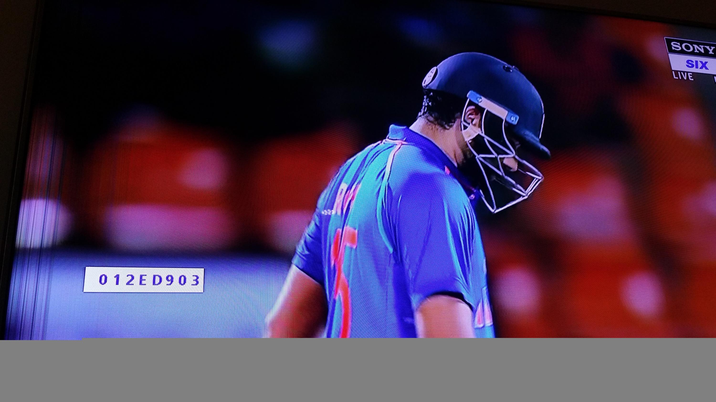

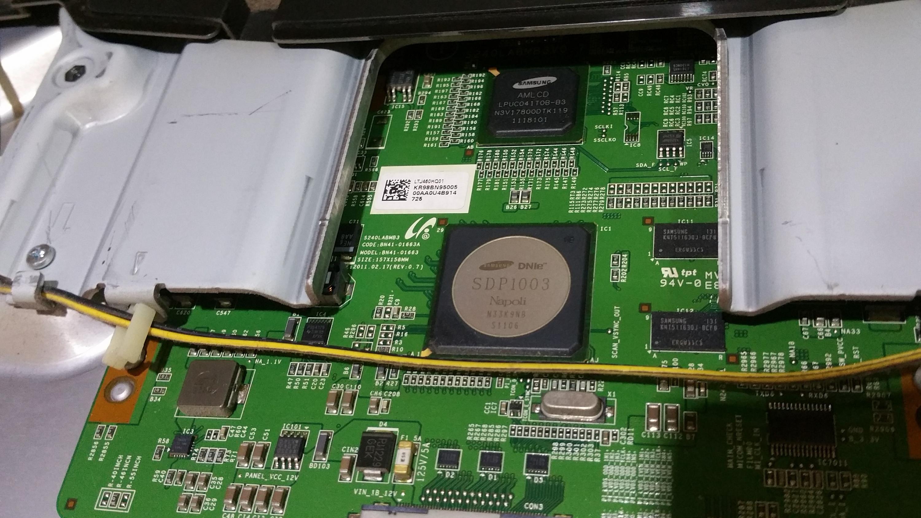

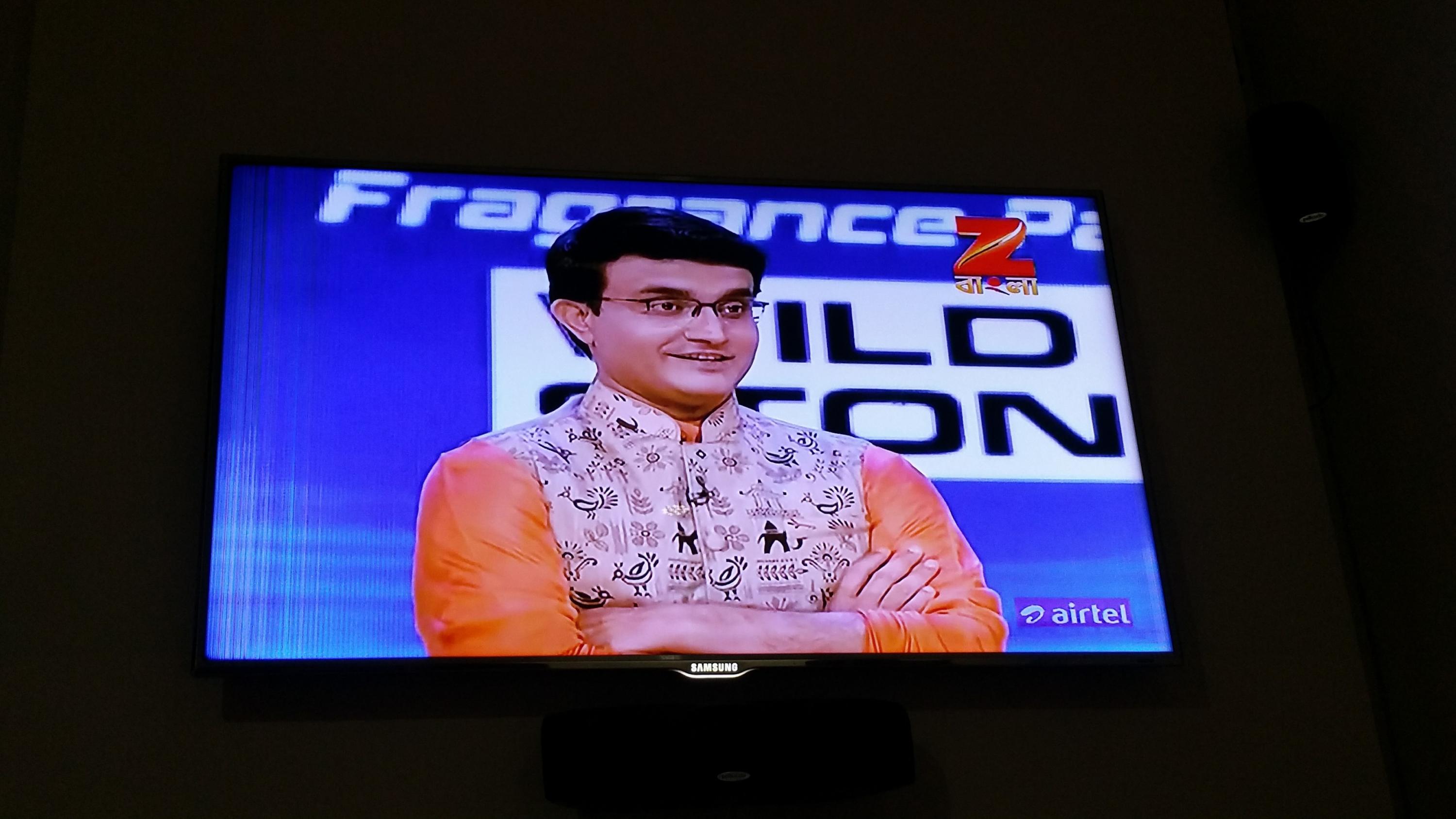

    Hi guys,
    Will appreciate if anyone can help.
    My TV is showing muticoloured very narrow vertical lines on one side (left) & that is very slowly progressing over time. It starts immediately after switching on & remains on all inputs.
    Do you feel its T-con issue or its the Panel which is doomed. Any easy way out?
    Thanks a lot for helping out.

    Re: Samsung UA 46D8000 Vertical coloured lights on one side
    Looks like a bad panel
      Looks like the usual culprit, left tab bond, could strip it down and applying a little pressure on tab bond, see if it clears up, if so a shim might work.
          As nomoresonys suggests, I would agree with that and or bad panel.
