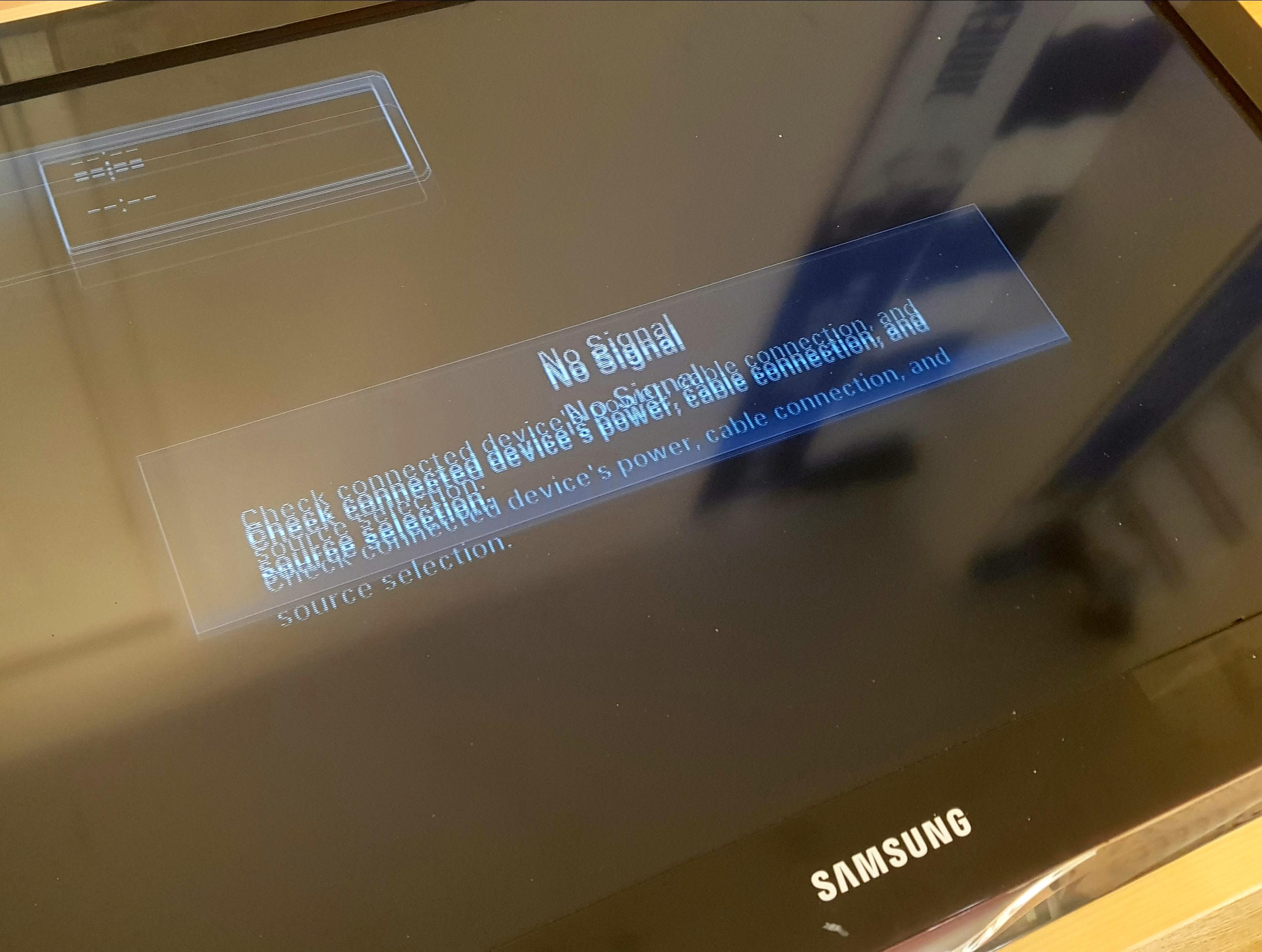

    Hi all.
    Can you help me to diagnose it please? Is it LCD panel damaged or one of logic boards?
    Picture attached.

    I believe it's one of the tab drivers on the panel. There is a possible fix for it but for how long I don't know.
    Search Youtube for how to.
    https://www.youtube.com/watch?v=kEGX_QJUYdo

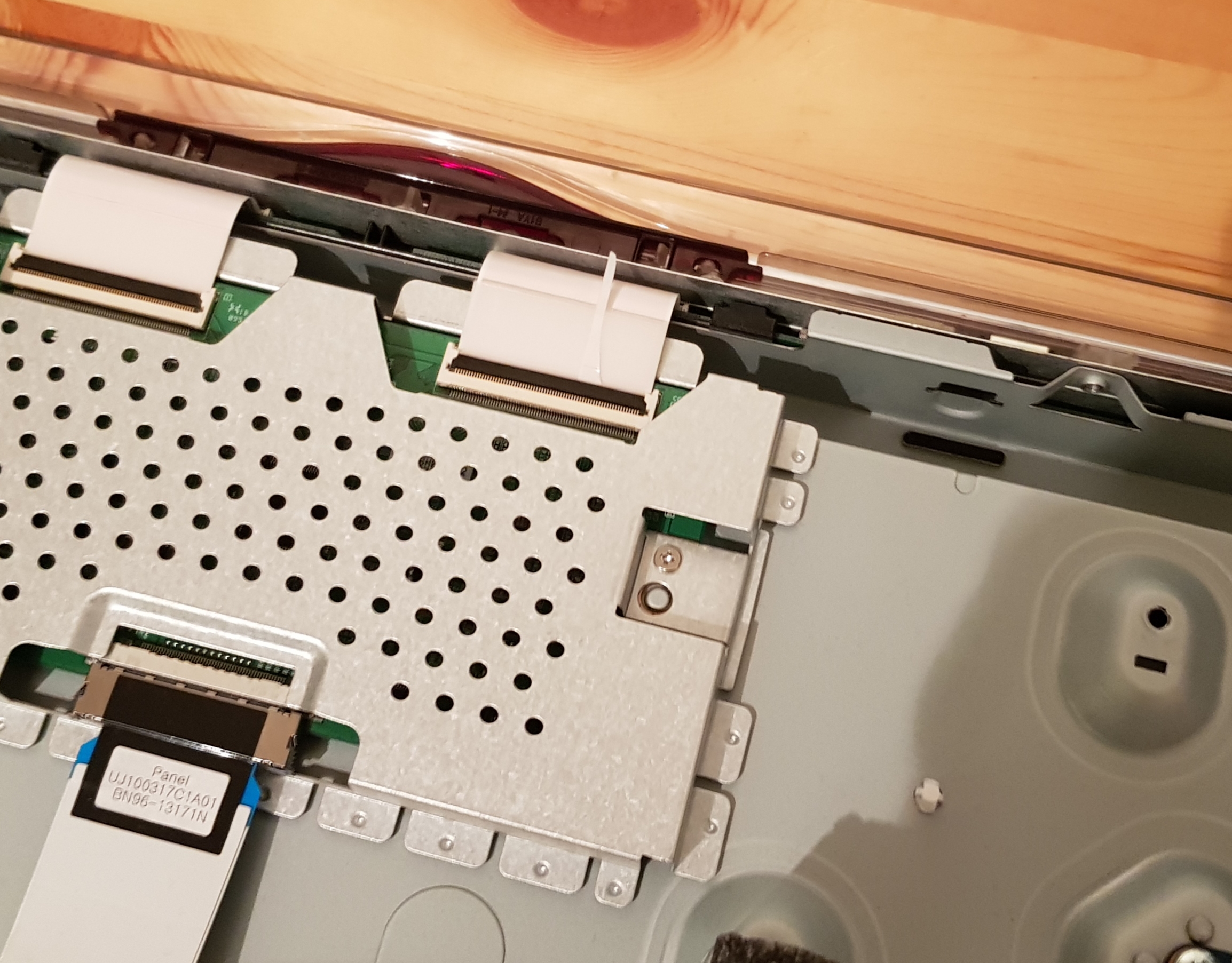

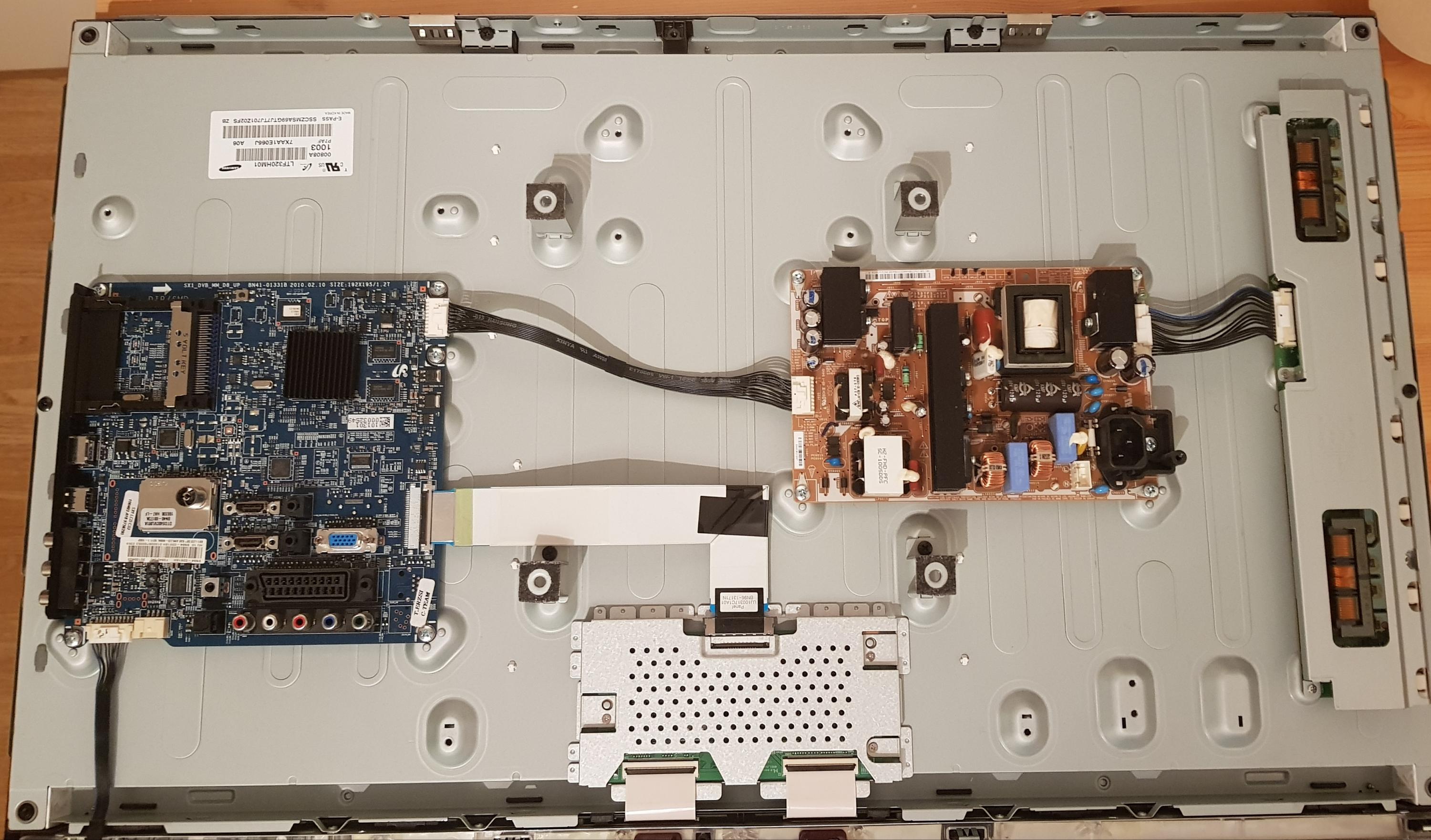

      Photos of the rear of the TV will help so we could see how the boards are interconnected. In particular pictures of the T-CON Bd. Does your T-CON Bd. the LVDS cable coming from the Main Bd. into the T-CON Bd and are there two (2) FFC coming out of the T-CON Bd to go into the LEFT and RIGHT Panel Bds or is it just one (1) FFC???
        Re: Samsung LE32C530F1W
        There is a picture.
          Try cleaning the ribbon cables that go from the screen to TCON and fit them tightly!

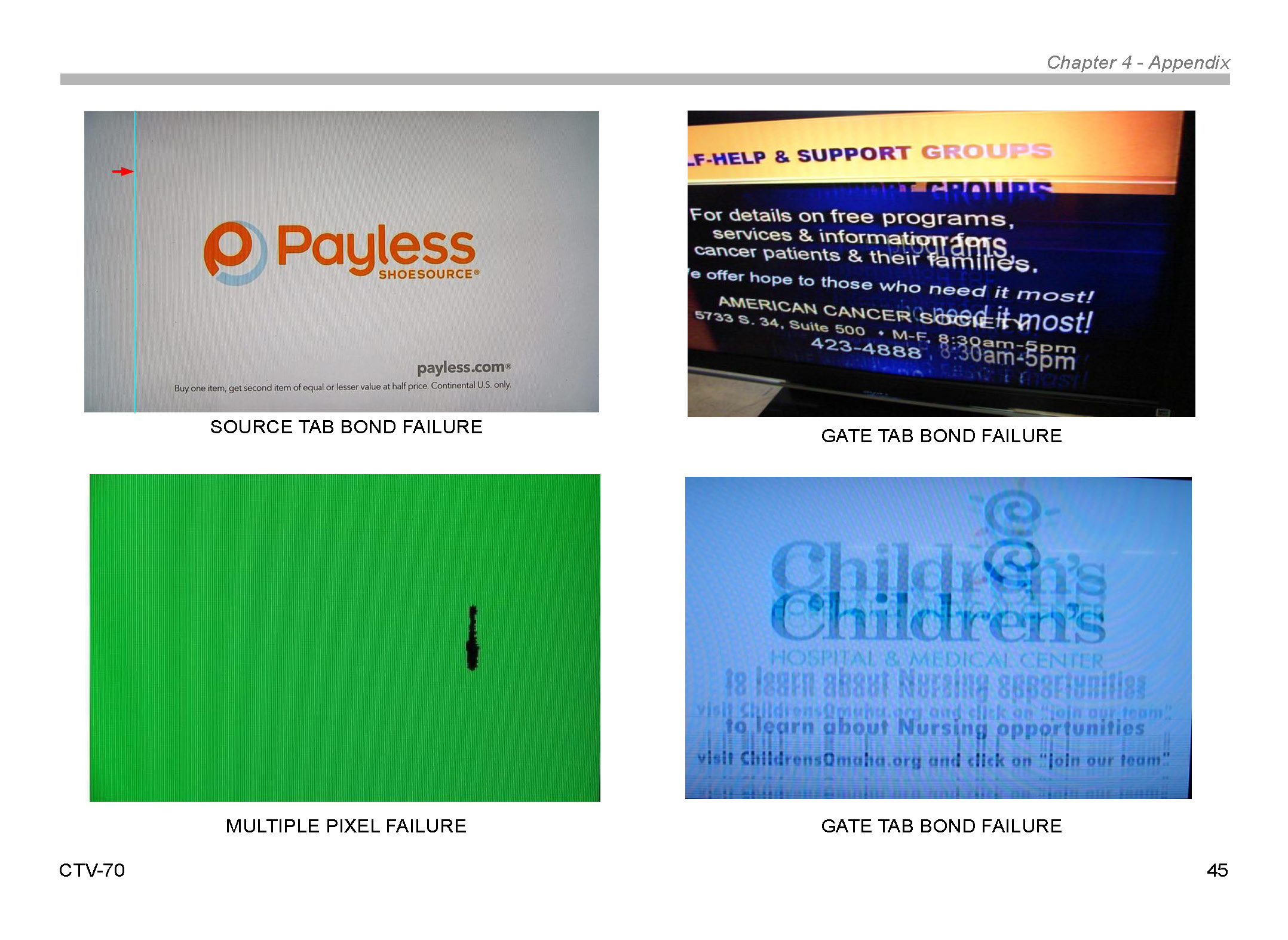

            GATE DRIVE tab bonding.
              After some research, a bit of tape did the trick.
