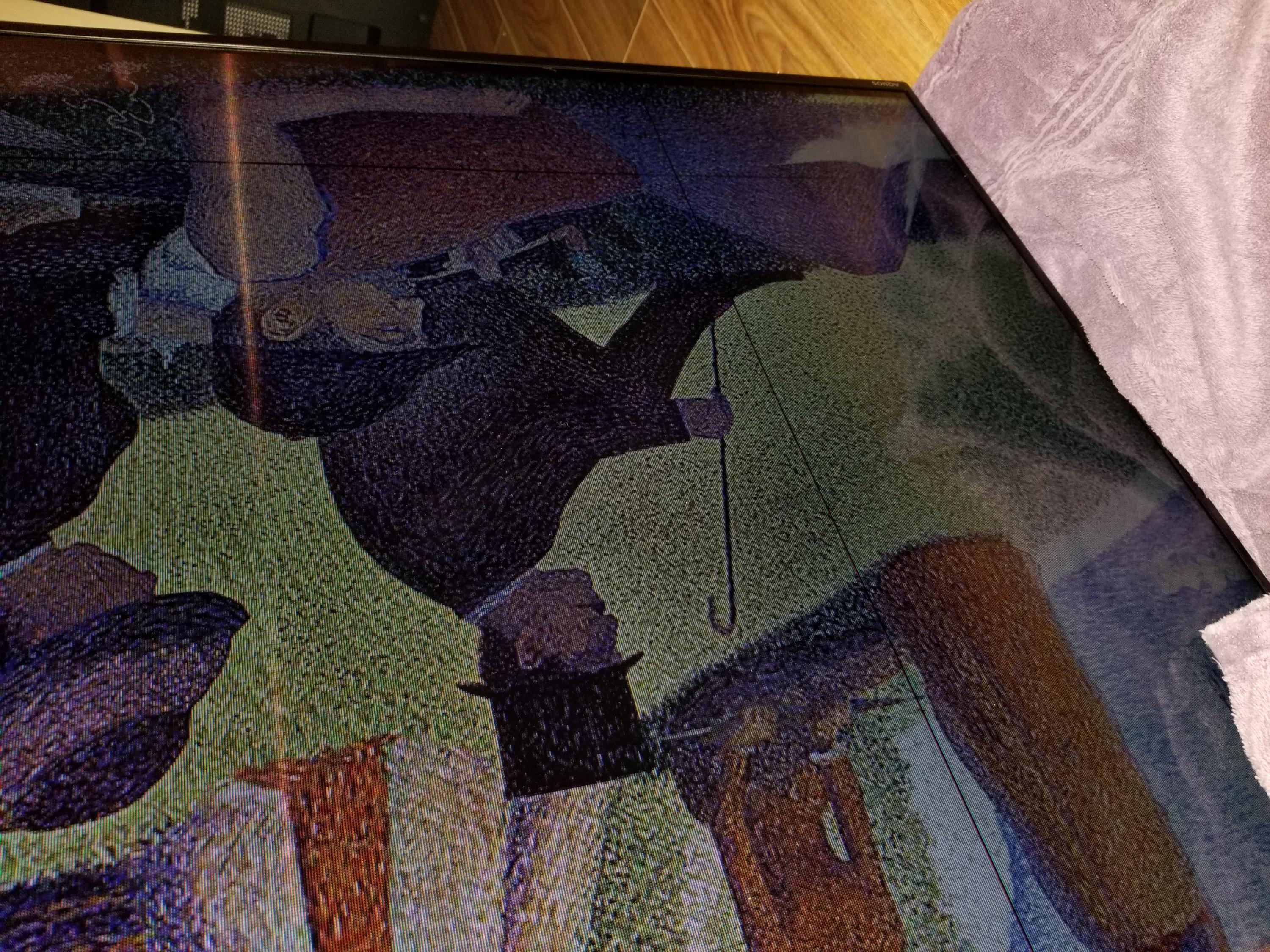

    Hello!
    I do not have the 2-5 blink error, it basically seems to maybe flash once on startup(never turns off).
    It will just flash briefly when I turn it on, the dim backlight flash.
    I cannot turn off with remote or power button.

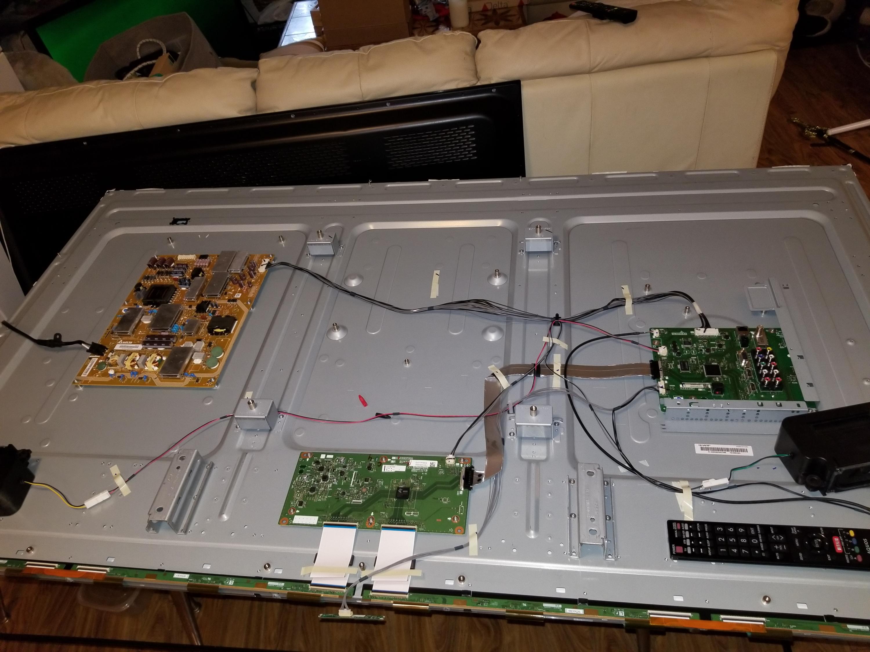

    When I disconnect either side of the t-con, the side disconnected goes white and the other side looks fine (sharp logo etc). So BOTH sides show the image when the opposite is disconnected.
    Is this an obvious panel fault? Doesn't seem to have side tabs like other posts mention, there are little flaps with ic's on them on the sides... but not sure i should be ripping them off lol.
    Where should I be going from here? Trying to read through all the threads - I feel like this should definitely be pointing me in the right direction.
    Any thoughts?
    adding pics from my phone shortly.

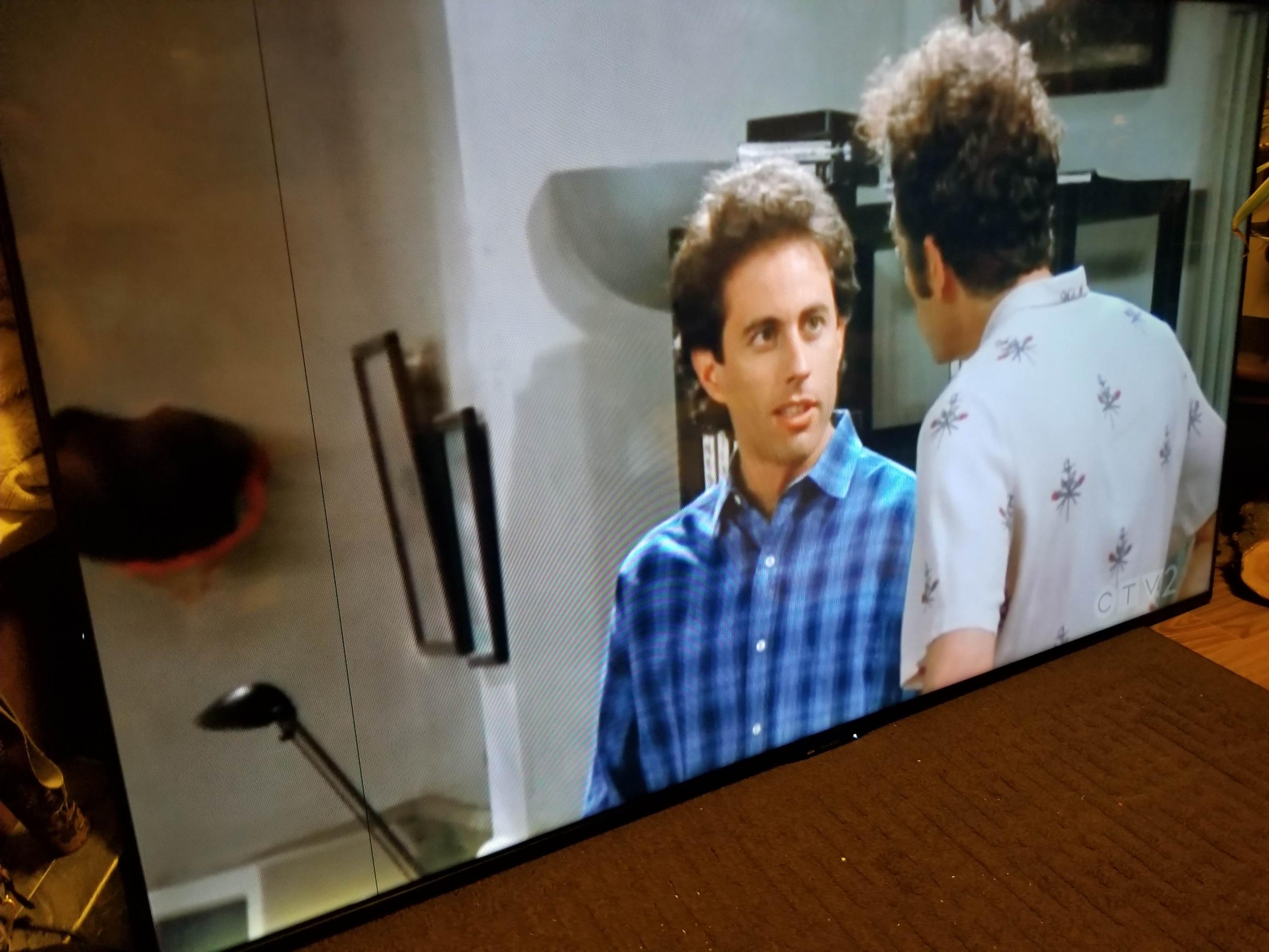

    Ok, lies.
    So while trying to and failing to upload photos- made it work for now. Read anothers post where they throught it was good to go and failed out.
    Basically after operating the TV with disconnected tcon sides, or them back together and it works.
    Loaded internet, no updates.

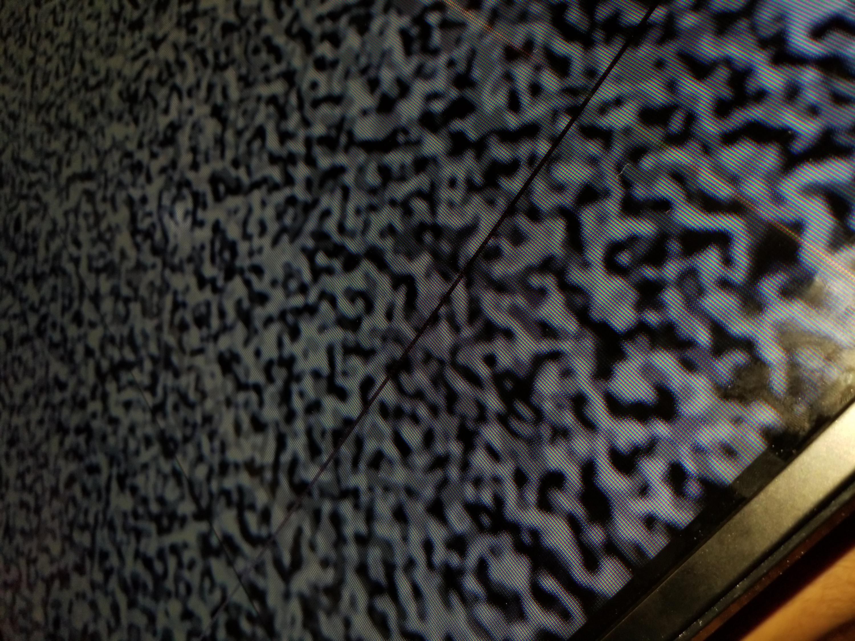

    There are two lines visible on the screen though. See pictures. Bad panel? I expect it to fault out again soon.

      about the visible lines. This kind of vertical line is caused by a bad bonding between the flat cable on the top/bottom (source drivers), that connects the LCD screen itself to the slim pcb. It can not be repaired, unless you have a tab bonding machine, but it can be worked around. You need to press gently on the flex cable that is the closest to the line on top/bottom of the screen. If it makes it go away, you have to think out something to constantly get that area pressed. Some uses heat gap pads (i think it is the best solution), some uses rubber, etc.
      The horizontal line is caused by a gate driver. There are many articles on BC, how to handle this. But we can walk you trough, if you want to make it go away.

        My set has tiny ICs attached along the side, maybe 4-5 per side on tiny tabs not connected to anything... I'll play with those too.

          Since your set has both a dead horizontal and dead vertical line, I am inclined to suggest impact damage, or a failed pixel that has shorted and killed both drive lines. Nothing much you can do.

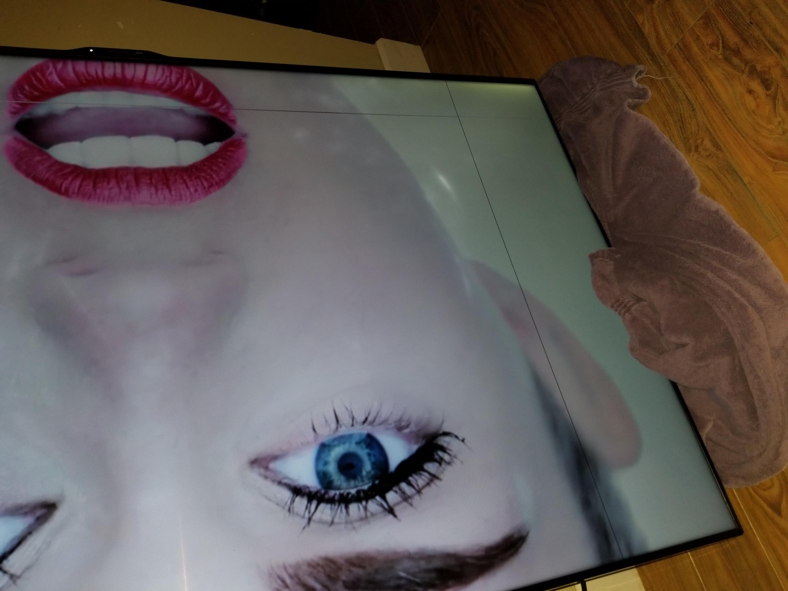

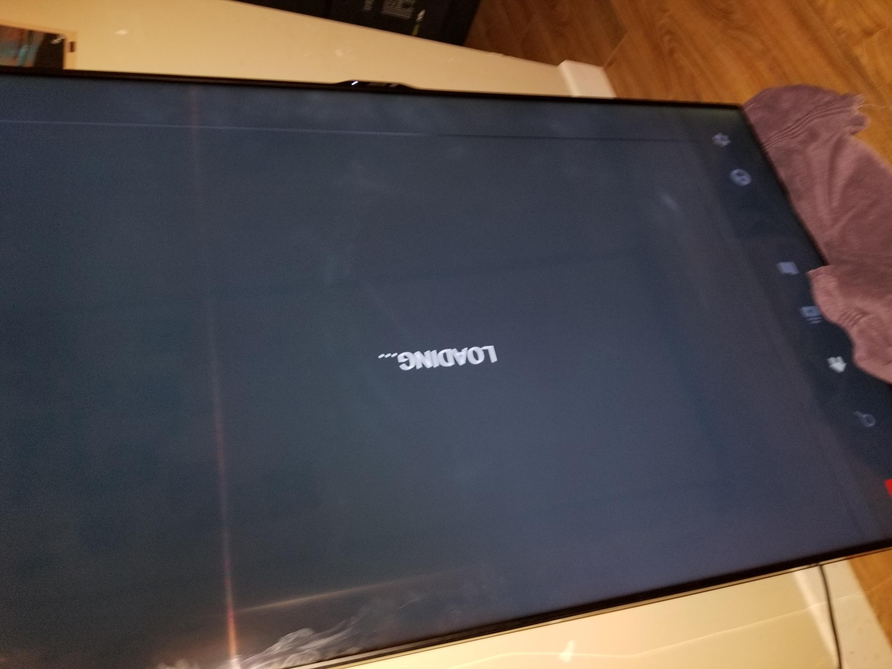

            I took the plunge and ripped off the panels tab bonds on the right side (side which showed the horizontal line with tcon half disconnected).
            The horizontal line is gone! Yay.... Too bad is got a vertical line. Fail. Of well.

              Hi, i don't understand well your first posts, but i can see well the images, so with a pressure on the source driver it doesn't make difference? You don't have to press the glue strip but on the chip itself...

                Unfortunately it seemed to make no difference, I put a heatsink foam piece between the chip and the frame to try and help cool/provide pressure. Didn't work, nor did any manipulation of the cof-bond tab thing.

                  The vertical line is black? In effect it tends to let me think it's a three-output failed at the same time and not a connection problem, let we remember that in source drivers the 3 subpixels are displayed one per clock cycle. I think a very brief spike have destroyed in the moment the pixel at the crossing point of 2 lines was displayed. It's only story now.. I'm thinking, is there any overvoltage suppressor on the TCON's??
