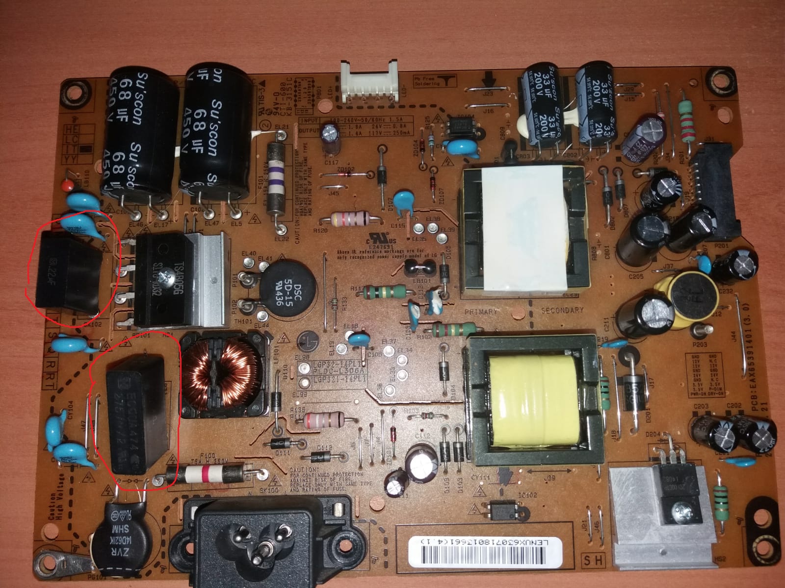

    Hey guys! I've been trying to fix this tv i had laying around for some time, was wondering if you could help me find the problem because i ran out of knowledge, i'm just a self taught repair wannabe so i apologise in advance for my lack of knowledge
    So, one day this tv stopped turning on, only flashed the red light once and then stopping, i took it apart and looked at the power supply, noticed two blown capacitors (the red circled ones) and replaced them, soldering was a bit wonky because one was longer but its the right farad and voltage, still nothing, no turning on no pic.
    Then i replaced every capacitor i could get my hands on, nothing.
    I tested fuses and diodes (well i think i did, i'm not so sure of my work ) they seemed all fine.
    Searched the schematics of the board EAX65391401 3.0 and started trying to understand something.
    I measured the voltages at the connector that goes in the logic board, 3,5v 24v and 12v are there and perfectly fine
    Then i measured the backlight current that should be 117v and found that it was putting out approx 140v
    Oh and today i noticed a really low crackling noise (bzzzzzzzz) coming from the bottom right of the board, like an electric dispersion but could not find where it was
    Tl;dr Tv didn't turn on, only one red blink, Replaced bad caps on powersupply, still nothing, backlight line puts out 140v instead of 117v, crackling noise on bottom right of the board, i have no idea of what i'm doing
    Sorry for the long post, i tried to put as many info as possible, tried to follow the guides sticked at the top but nothing,
    Am i better off buying a new board or is there hope?

    What made you think those caps were blown? they usually don't give a problem, Usually a high led voltage indicates an open led string in the panel.

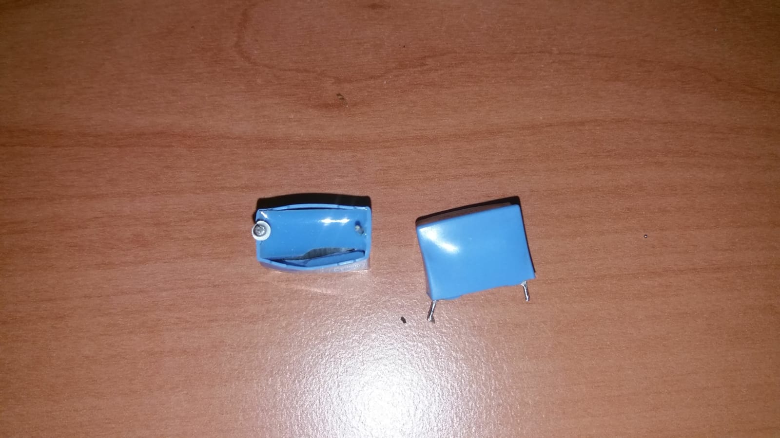

      I still keep those capacitors because i never saw something like that, i attached a pic of those

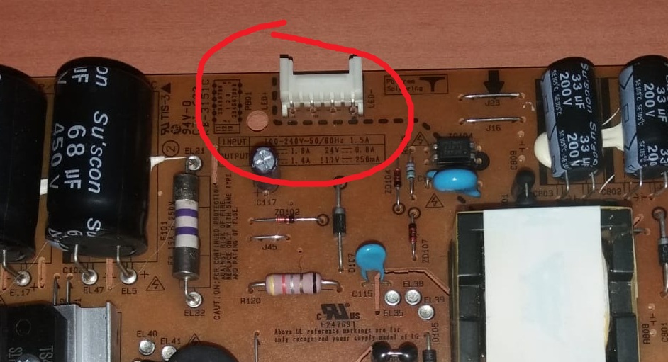

      Edit: i attached another pic to show where i got the 140v (117v) measurement, is that the right spot?
      Edit2:Now measuring from the + and - on the connector gives out 63-64v while putting - on the big screw in the bottom left corner of the board still gives 140v, this tv confuses me lol

        Those caps are definitely bad. How many wires go to the leds? If it is just two and you measure 64v I would think the backlights should be on
        If you measure the voltage from the led (-) to ground what do you get? they usually supply full voltage to the (+) side and control the (-) side of the led's.
        I still think its bad led string.

          Its 2 wires to the leds, measuring those 2 wires gives out 80v when leds are connected and 64v when they are not
          Led(-) to ground gives 0.00 and led(+) to ground still gives 140v
