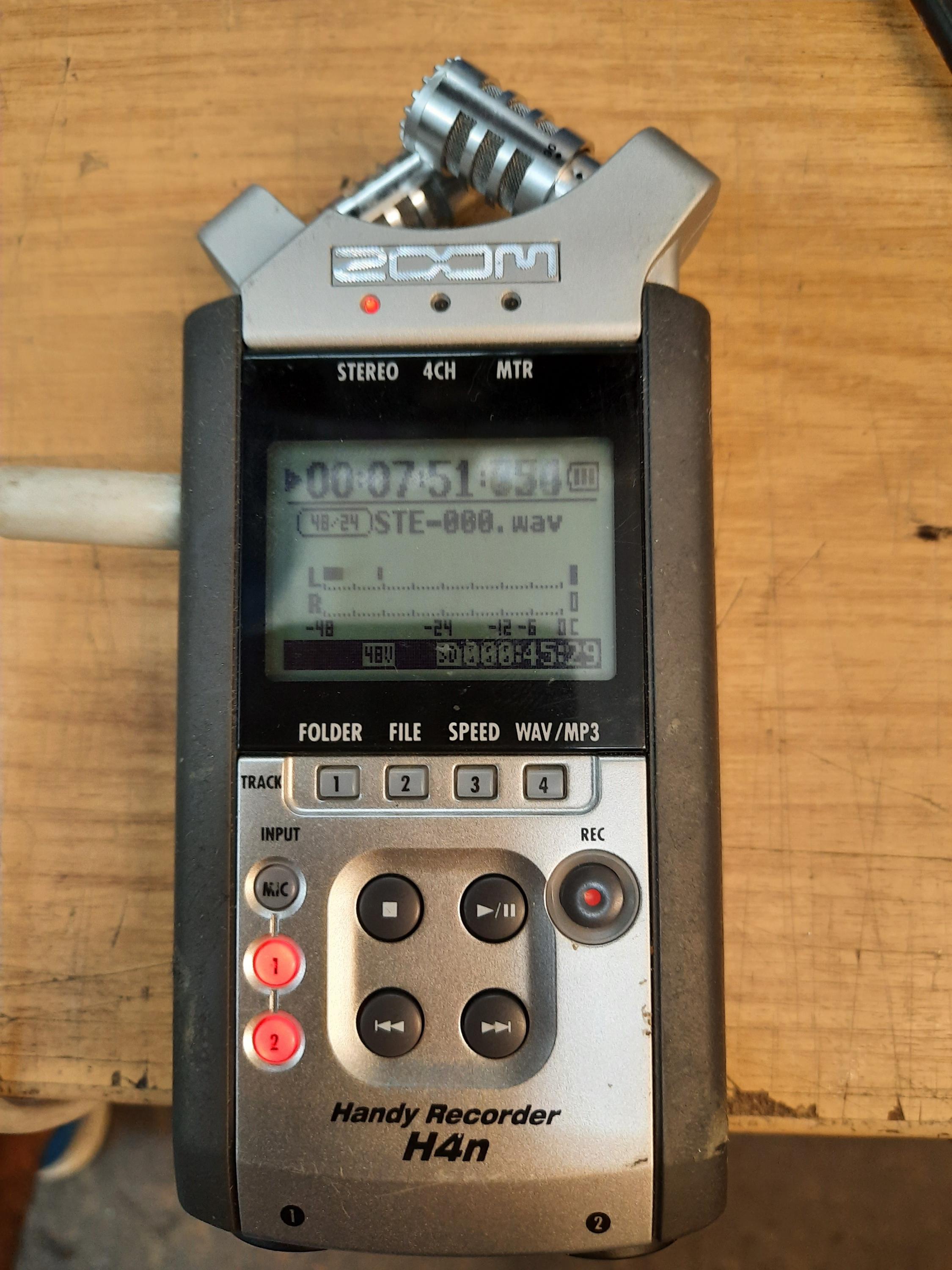

    Hi All
    These seem to be quite popular , but first time i'm attempting to repair one .
    Customer mentioned a crackling coming through when using an external mic to record via XLR ports .
    What i have experienced is the unit being tap sensitive & crackling even without playback .
    Anyone have experience of working on these units ?

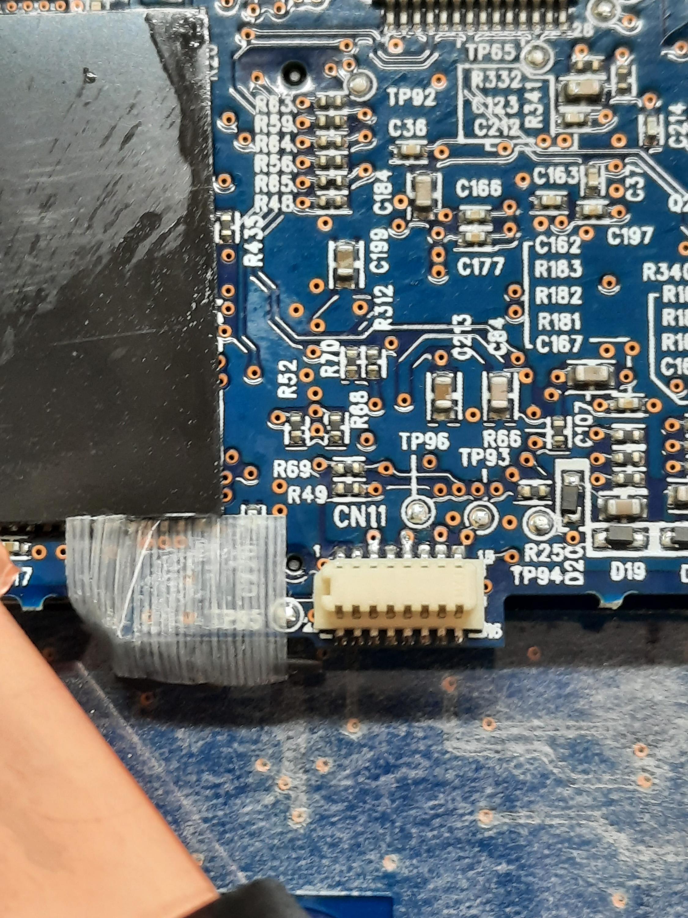

    May have cracked it .
    Under magnification spotted dry joint o the XLR PCB connector on the main board . Also re - flowed connector on XLR board .
