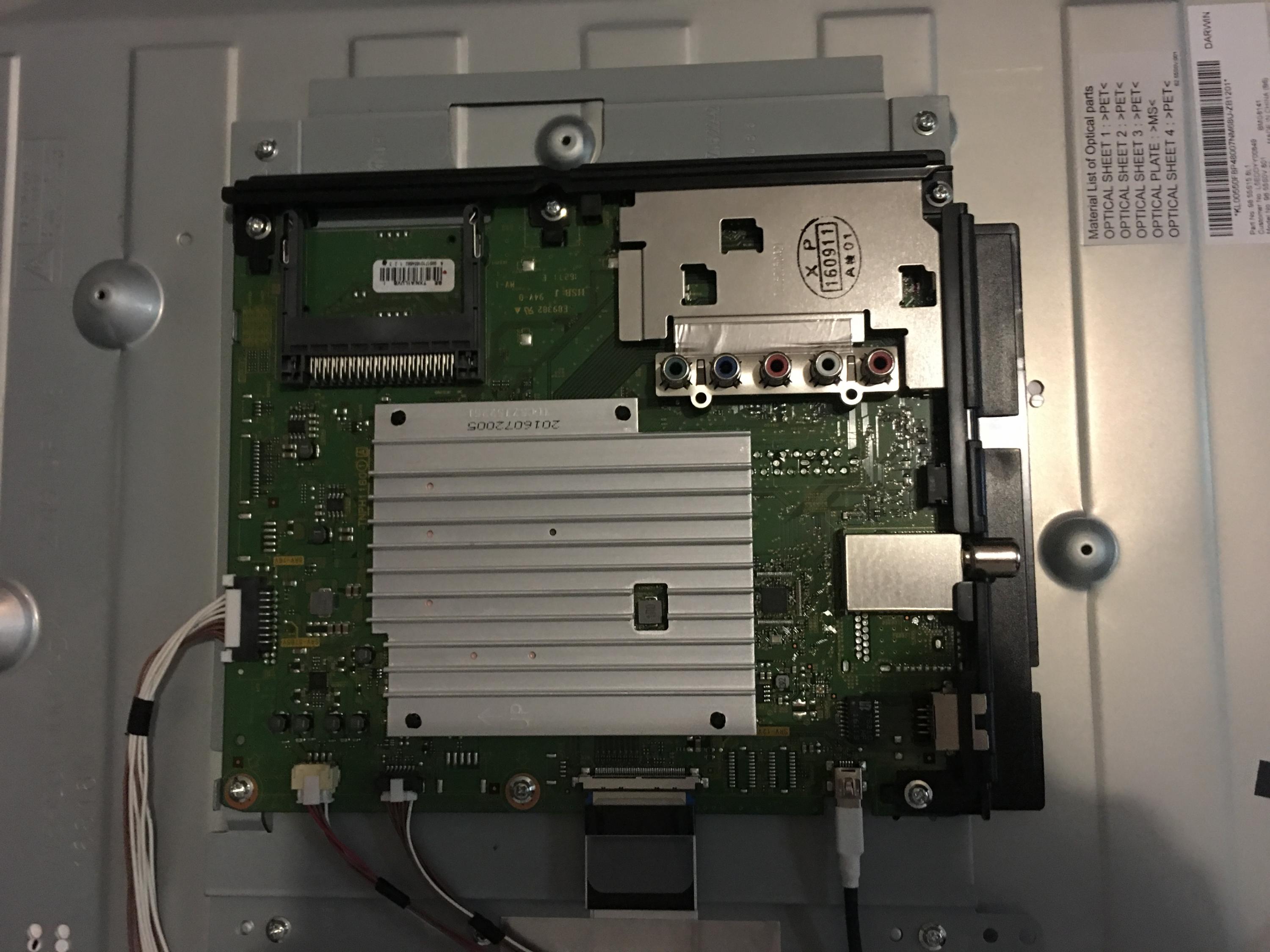

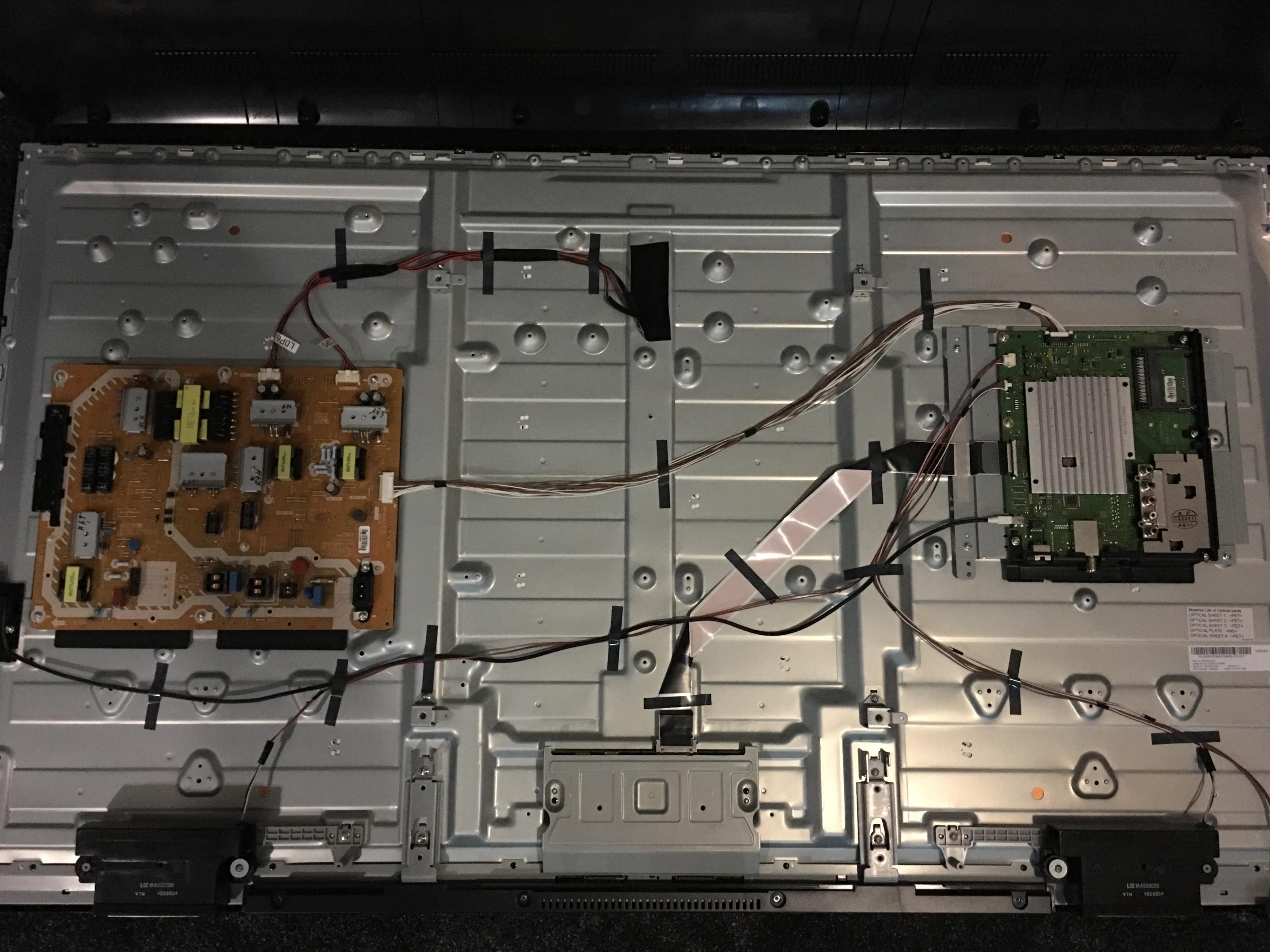

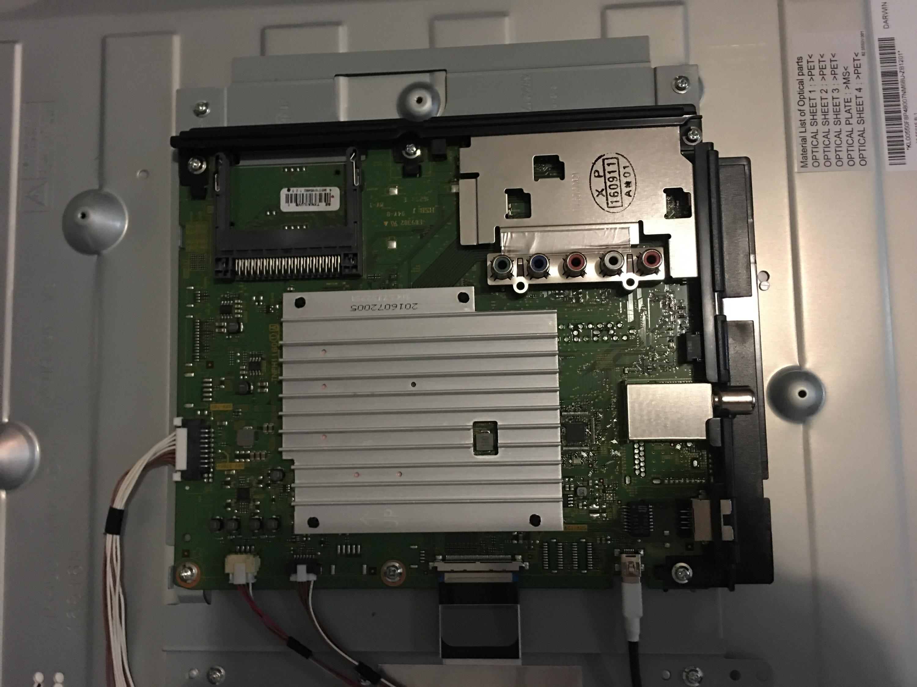

    I have a TX-55DX600B bought 16 months ago from Panasonic outlet on Ebay, seemed cheap at the time. Worked well up until now I have the following issue;
    Turn on.
    green light flashes quickly for maybe 3 seconds.
    then screen flashes (can only see if back cover is off, or if in dark room.
    Red light continues to flash every 3-4s.
    I believe one blink code.

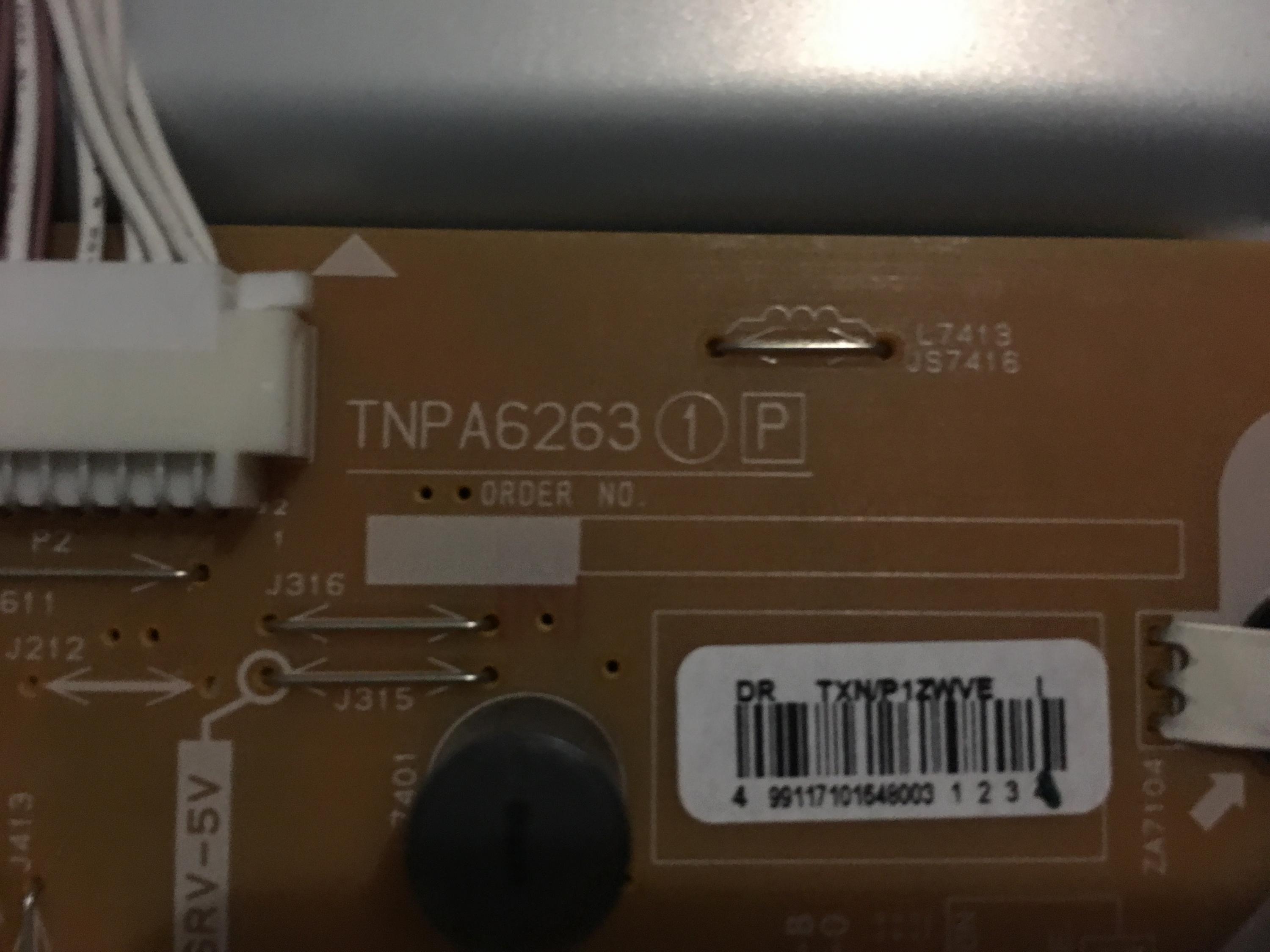

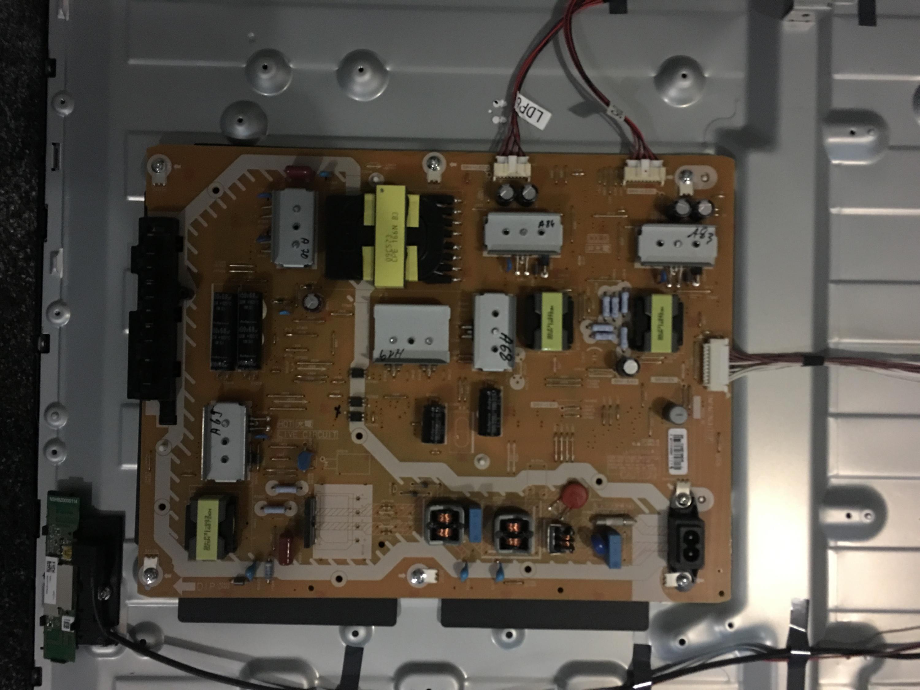

    I checked for short on PDU - P board with meter from fuse (which received V) to ground and none - is this correct?

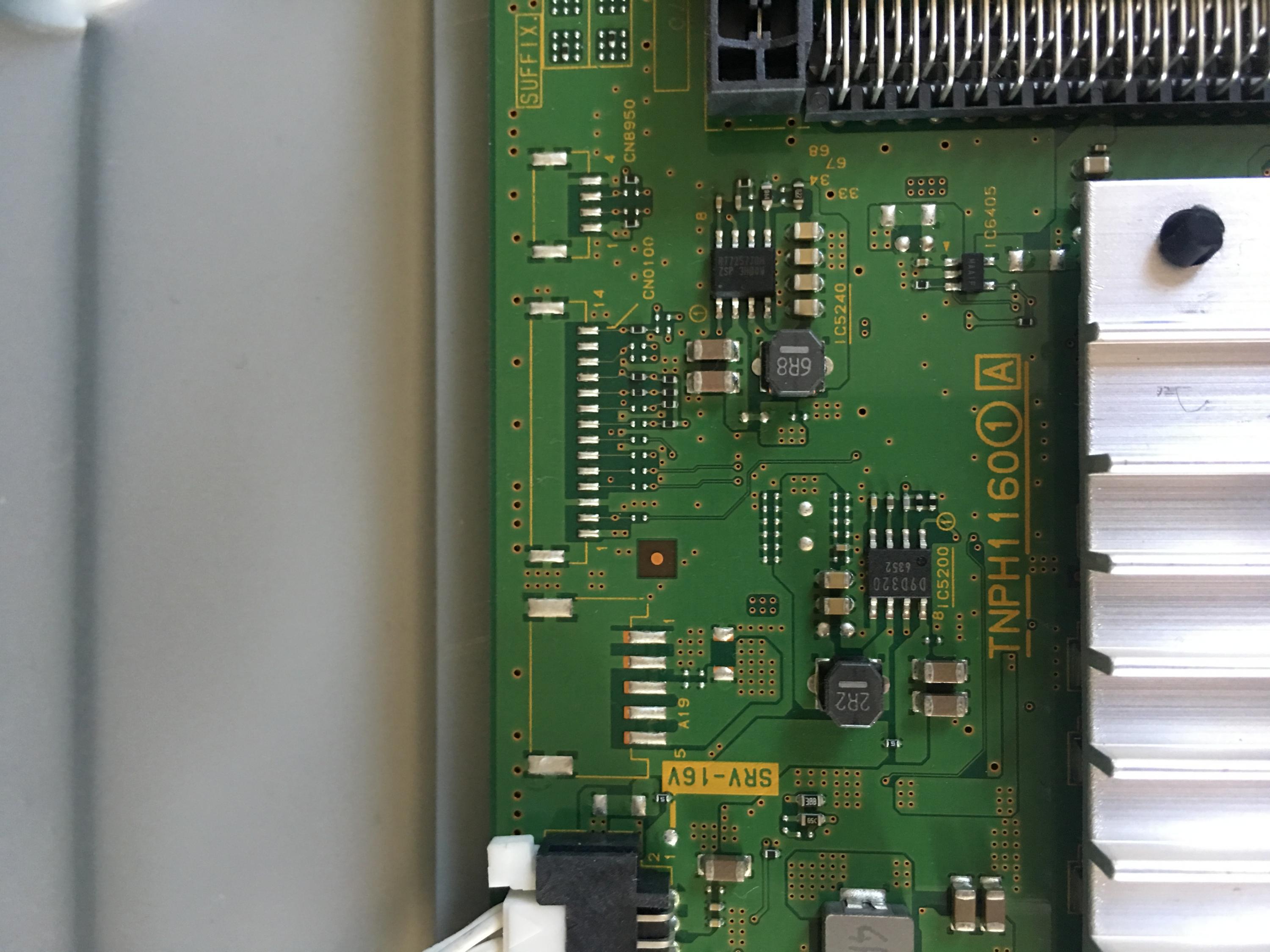

    I have ordered an A board, coming this week (can return at cost of postage).
    If its not the A board - I believe it is relating to Backlight LED - BL_SOS (LED driver).
    Question - Am I correct in my assumptions - I got info from this forum and also;
    If not A board, should I try P? or is this likely to be LED strip - in which case is it worth bothering, simple enough for a normal person to manage? I guess I'd need suction cups and two sets of hands.
    Attached are images of back of board.
    Any help / advice appreciated, Would really love the SM for one of these if someone has one.
    Thanks,
    Tom.

    Re: TX-55DX600B one (1) blink SOS code
    Looks like the Backlights have failed.
      Thanks for the reply.
      Could I ask what makes you say that and also would you advise to attempt repair? All led’s or just the faulty strip?
