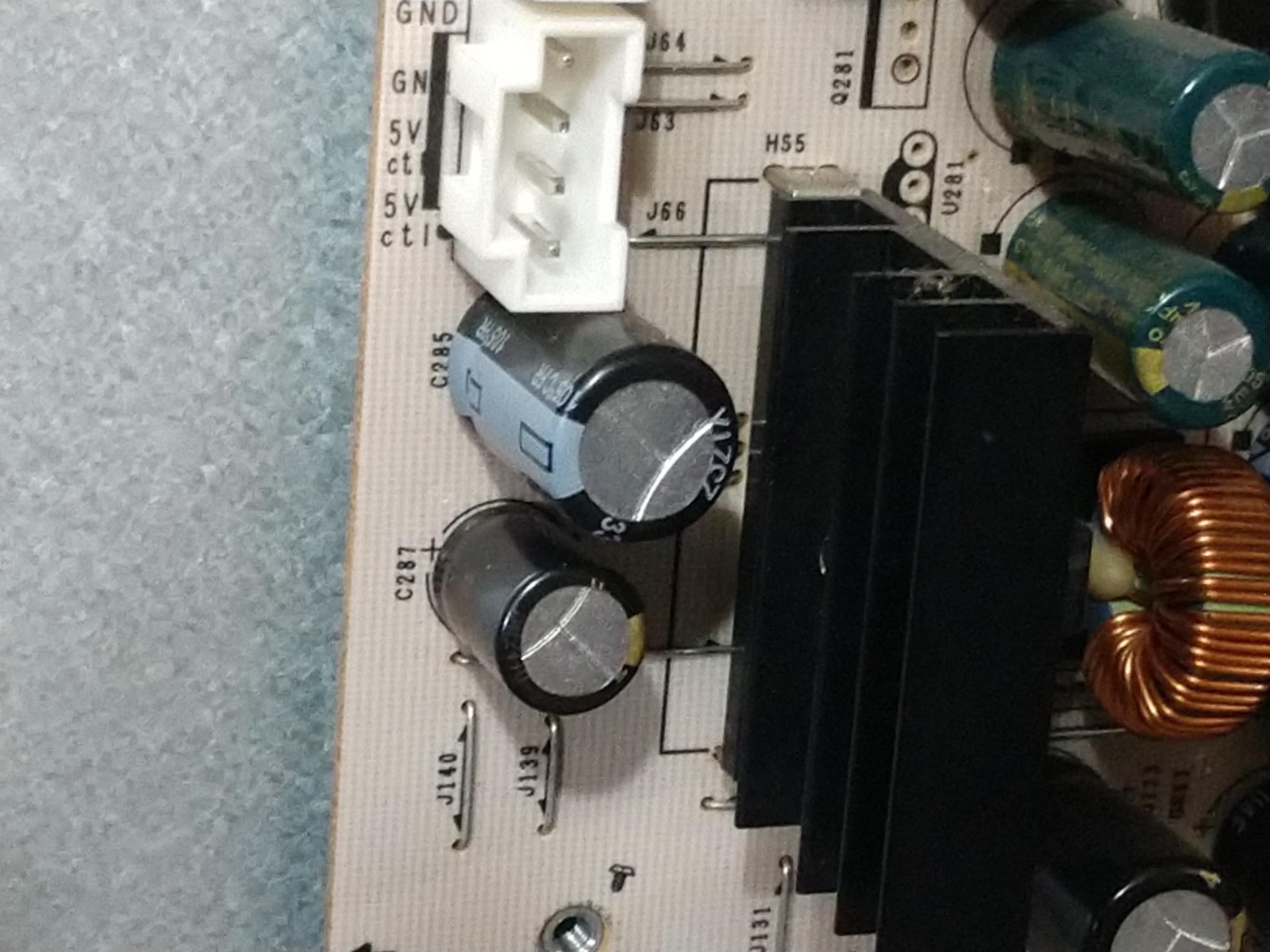

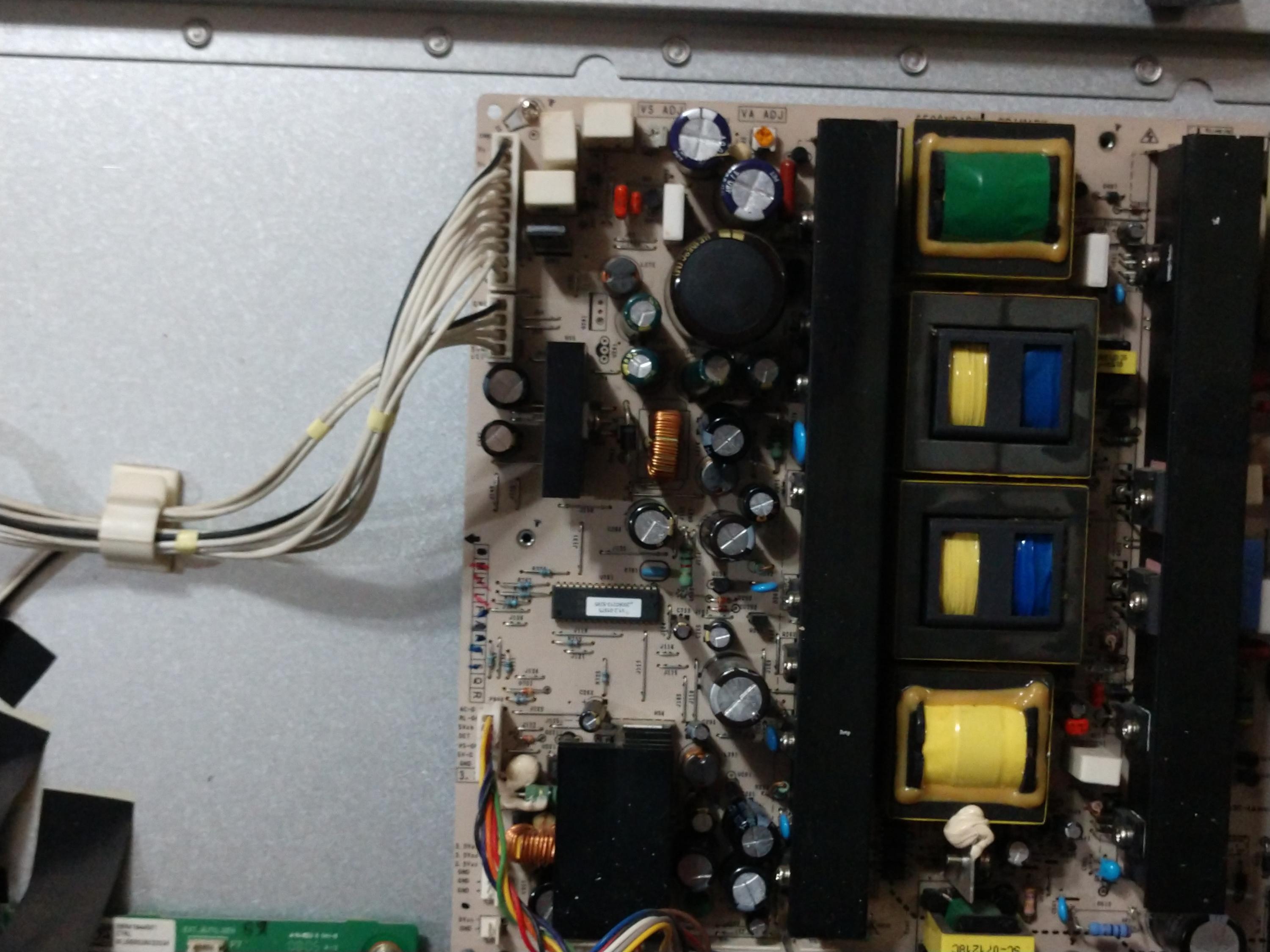

    hello everyone i am currently working on a vizio jv50phdtv10a with power supply aax30284301. for some reason when i test to voltages at the connectors all of the 5v supplies are putting out .81 volts instead of 5 volts. the p.o. attempted to replace the caps on this board and im pretty sure caps 285 and 287 are wrong, if anybody knows the values of those caps and any ideas as to why the 5v connects are only reading .81 volts that would be great. thank you in advance.

    What makes you think the caps are wrong? post some pictures so we can see what you are talking about.
    The 5 volt standby comes from T501, the smps ic is U501, What voltage do you have across C522? You should have about 160v dc, If you have 160v, unplug and check the resistance of R510, if it is open, U501 is bad.
    C287 is 470uf likely 25v C285 could be around 100uf or less likely 25v also

        at the moment 285 is a 10v 3300uf and 287 is a 10v 1000uf so id say something is wrong there lol. heres a couple of pictures

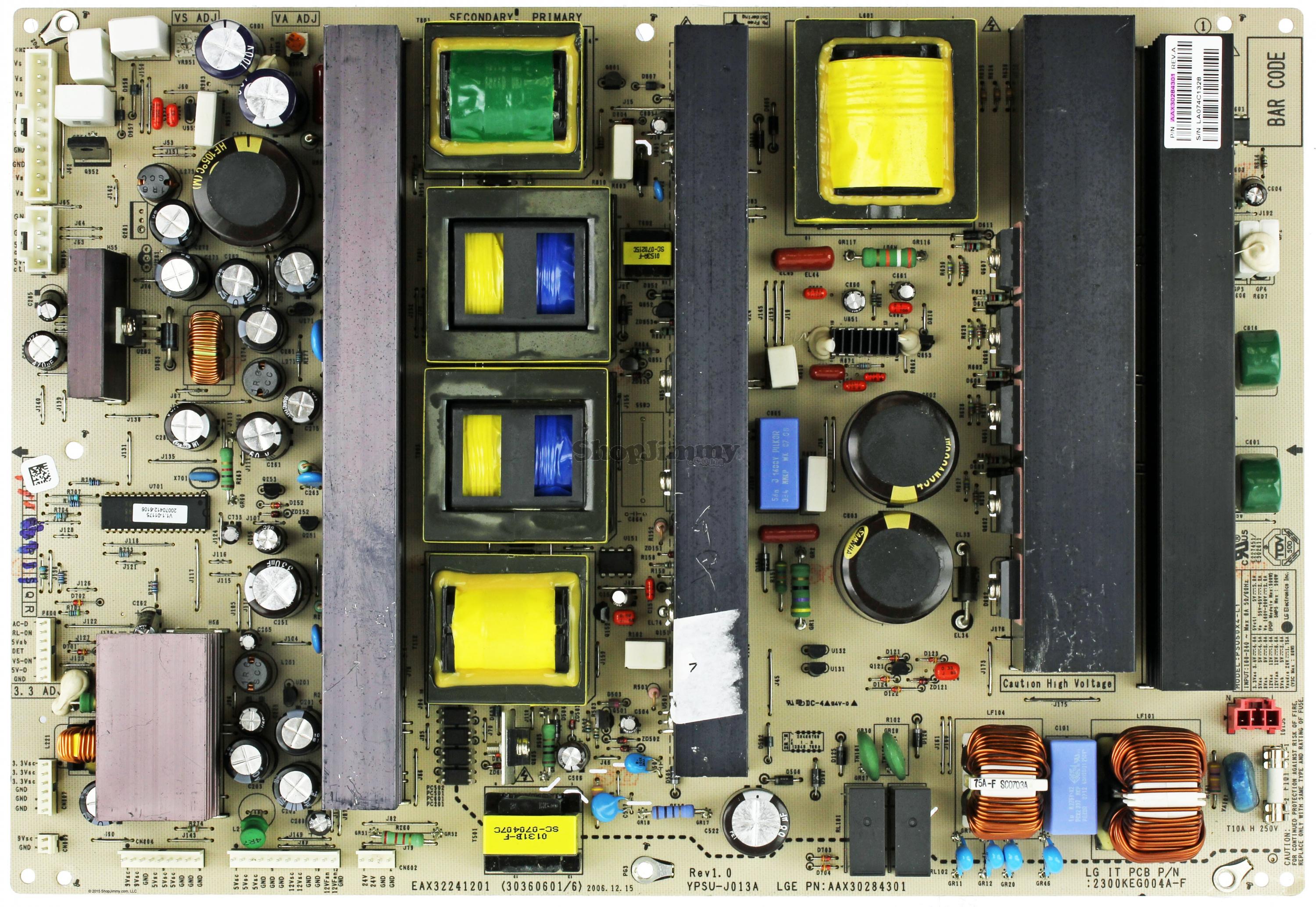

          Here is the shopjimmy picture, those caps are indeed wrong but not the cause of the missing 5 volts. What is the part number on U501?
