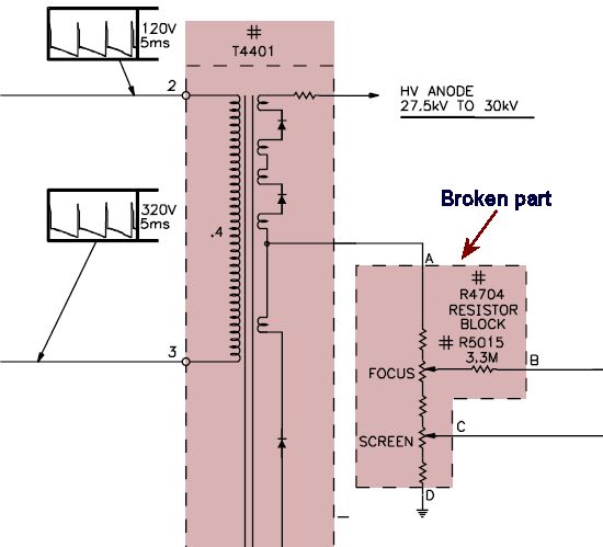

      "broke the screen / focus block", this probably the whole problem. after I broke that little board inside,I tried to approxamate where those wipers were. I marked the knobs before I messed with it. I got a reading on my megohm scale of the wiper service.After approx. where the two wipe tits touched on that slide, I cam up with about 18 meg on the focus and 6 meg on the other one. I got a bunch of resistors, made these resistences up and solder to the exiting wires. I knew it wouldn't be perfect, but I thought it would work enough just to verify that the HVT was bad. I'll take some pictures and show you what I mean.

        These resistor network is made via the pots and both arcs of black material is in megaohms range in series, One input, one output for 1KV to 7KV focus, one other output for screen between 100V to 500V. And current is fraction of a mA because of grid are open and are mostly DC and filtered by ceramic cap (one for focus via stray capacitance and one 47 to 100nF at 2KV to 3KV blue or yellow disk on the CRT board for G2 as screen).
        You'll need a good assembly and I offered you a good substitute.
        Cheers, Wizard

          @bogart219- See attached schematic image
          Notice the connection thru the block from points A to D. It's essentially one long resistor with 2 taps off of it for screen & focus.
            Toast
            Hey toast, thanks for the pic.

                Hey Toast, couple of questions about that schematic image you posted.
                1) At point A, what approx. would the kv be at this point?
                2) From point A to ground, what should the approx. current be?
