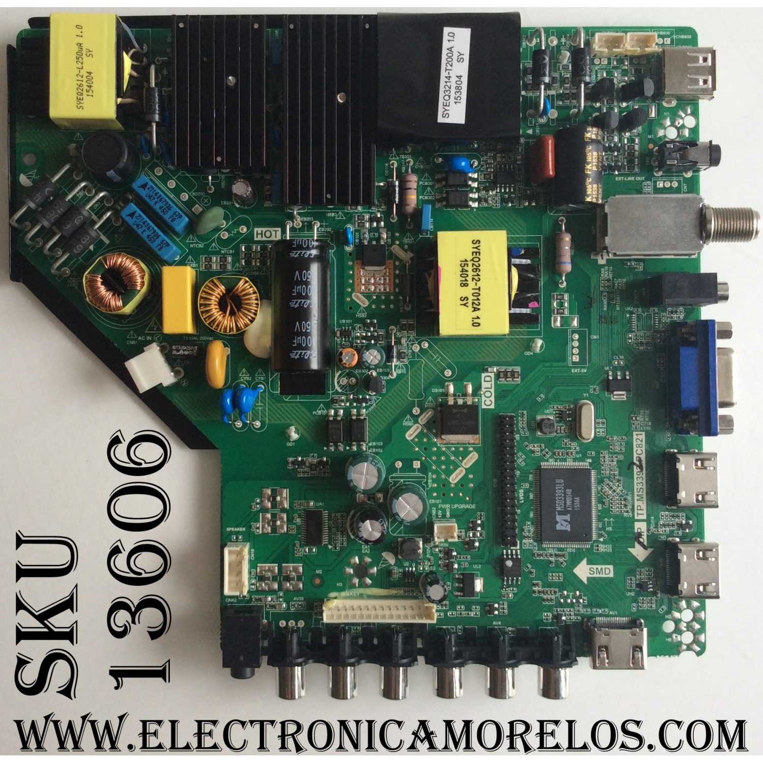

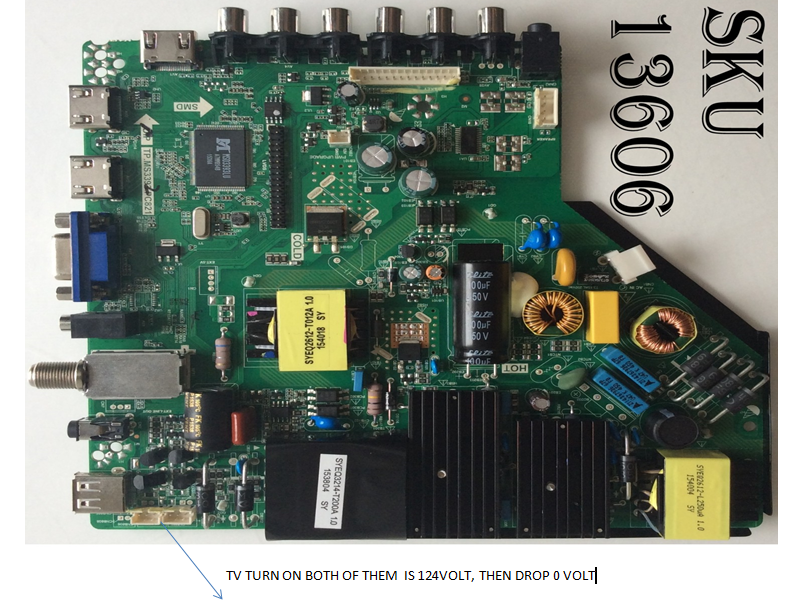

    Led TV Proscan elite EP 5585 is problem... Tv turn on green light is stable
    tv screen flash then black
    checked led driver both way connected and disconnect to led string when first tv turn on 124 volts at led driver channel, then voltage drop to 0 volt 100% problem with power supply produce led voltage

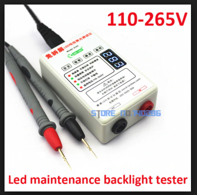

    Because I already checked led backlight with led tester backlight bright and voltage show on tester 94 volt 100% no problem with led backlight
    I just all professional help me what component cause Tv turn on i have 124Volt but drop to 0
    Thank you all

      led voltage drop from 124 v to 0v even disconnected to led power supply
      problem is from power supply led driver

        I tested 2 led string is 94V each , the same voltage both and the backlight is bright
