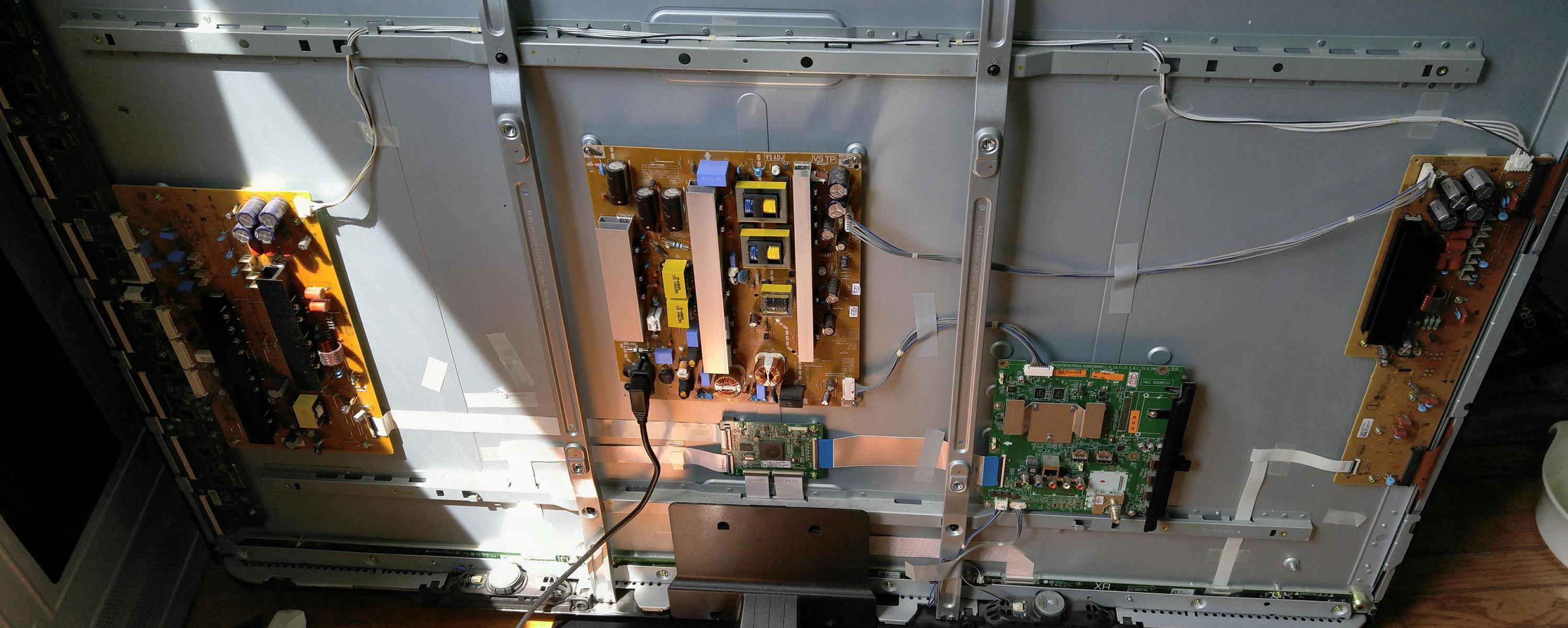

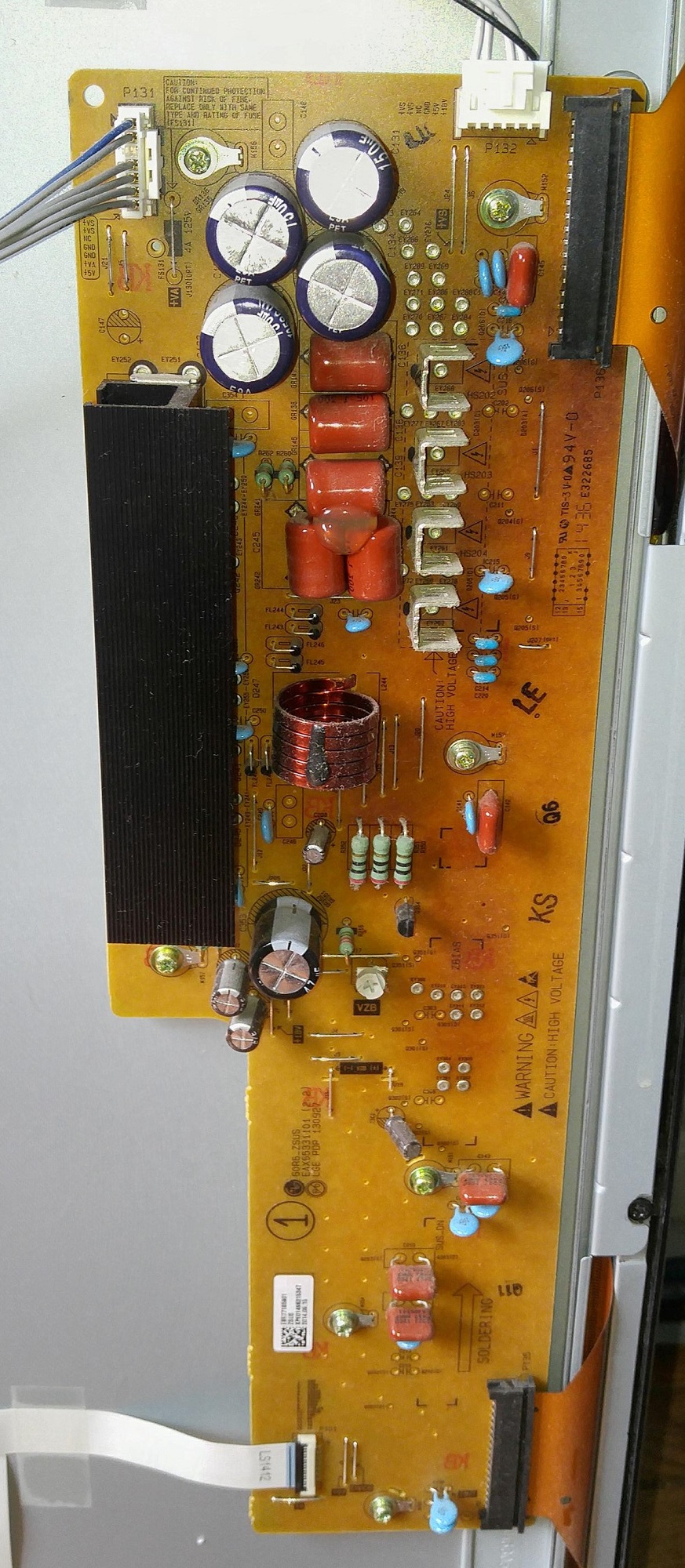

    Hello all,
    I was recently given an LG 60PB6600-UA that was having issues.
    I was told that it had audio, but no picture. When I have attempted to turn it on, the screen will flash grey "snow" then go black. While the tv is turned on, I can hear a whine coming from the power supply area.
    The standby red light is on while plugged in, but turns off when tv is turned on.
    I have tried disconnecting ysus and zsus, only stops the grey flash from happening, still black screen.
    I can't see any obvious bad capacitors.
    I'm hoping you can help me with this,
    Thanks!

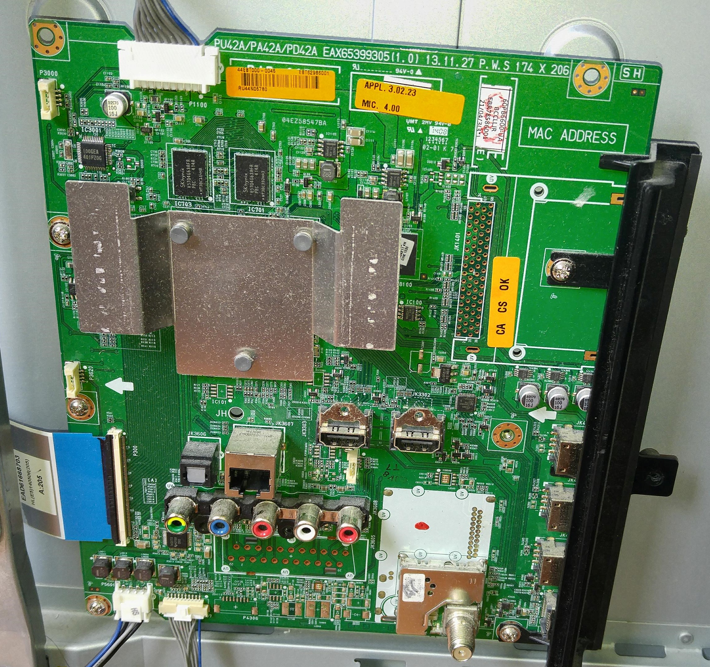

    Re: LG 60PB6600-UA No picture, whine from PSU

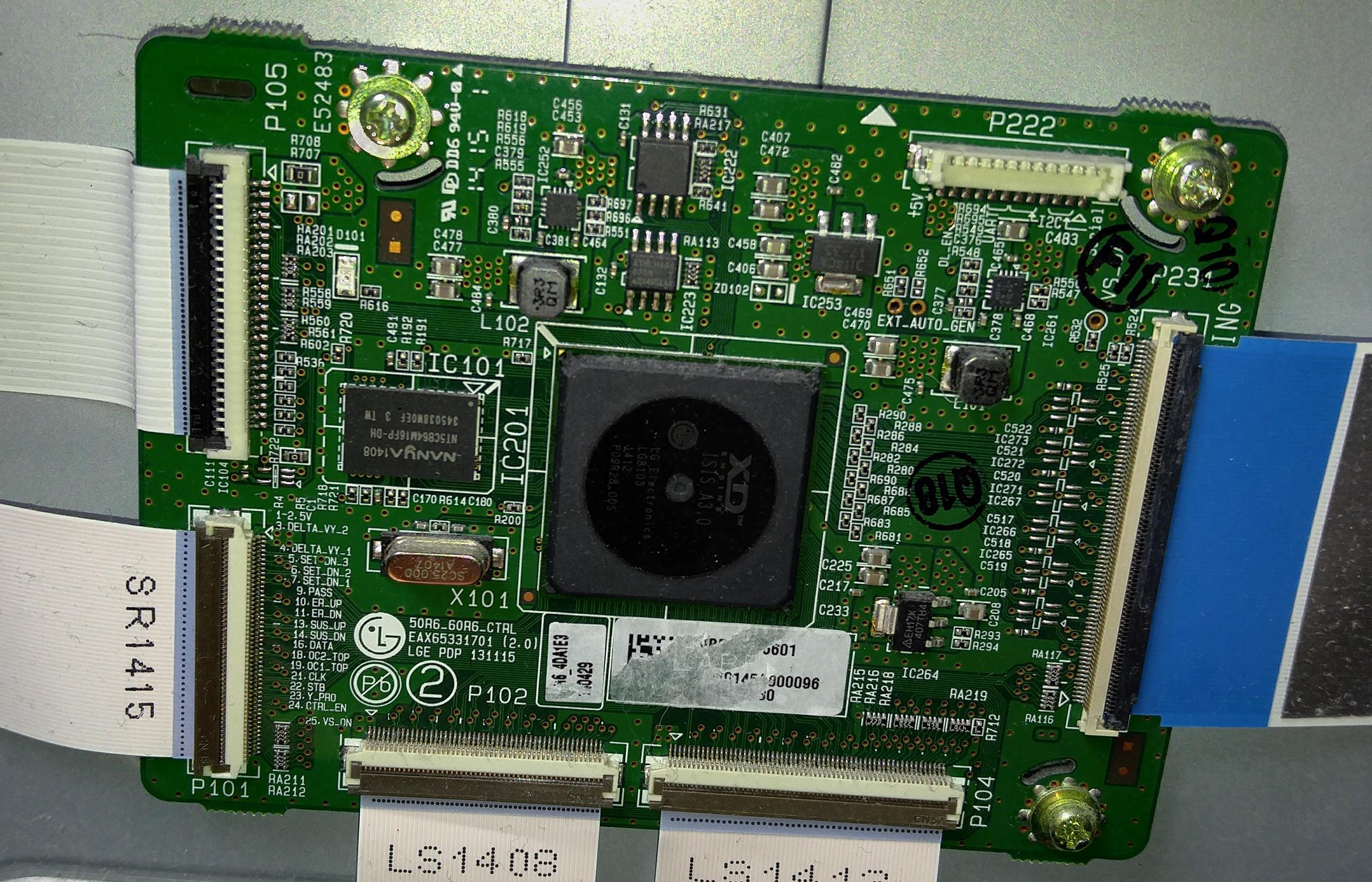

    On your last pic, there is the big main cpu. Just up from the right corner are two holes marked auto gen. Unplug the cable that goes from the mainboard to the one in the pic(logic board).put a piece of wire in each hole and plug in the tv. If you see screens of colors and patterns the mainboard is bad.
      Just gave that a shot, the grey seemed to be a bit brighter, and lasted slightly longer, but no patterns.

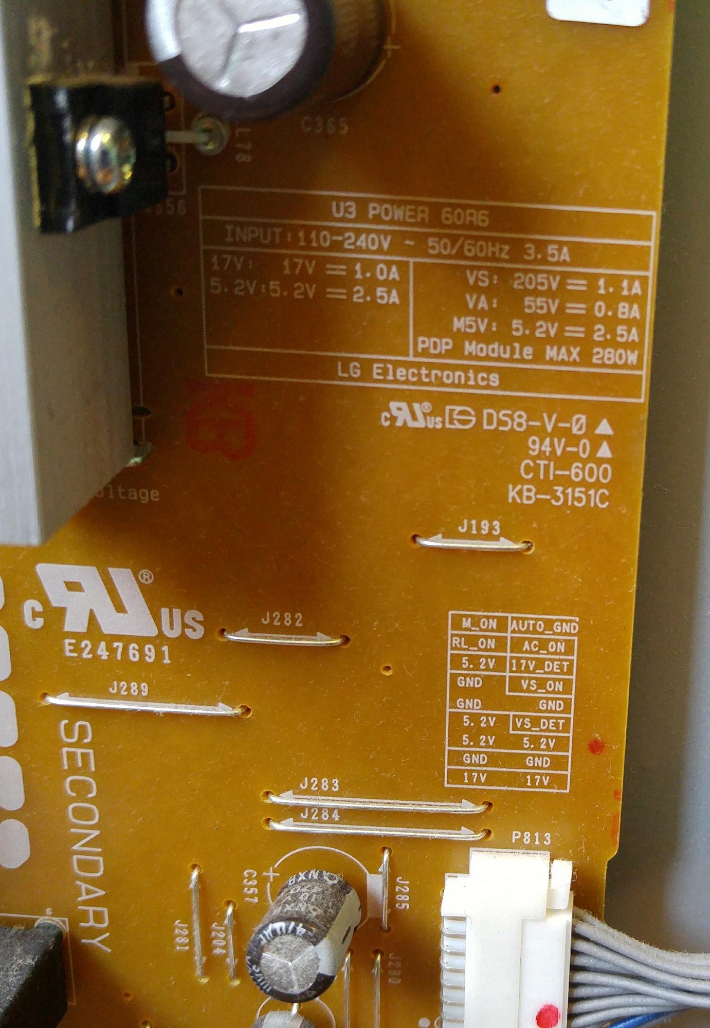

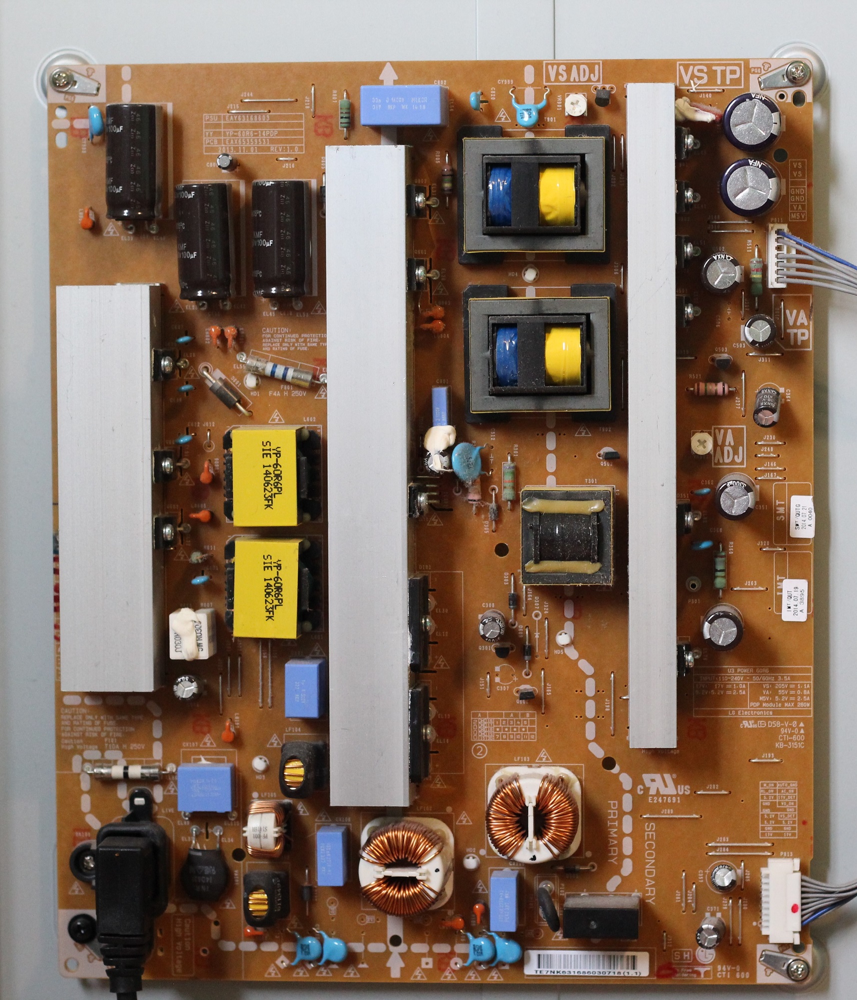

          What voltages do you have at the connectors in the red boxes when you switch on?
          eg.
          P811
          Pin 1 VS =
          Pin 2 VS =
          Pin 3 No Connection
          Pin 4
          etc
          P813
          Pin 1 1(7V) =
          Pin 2 (17V) =
          Pin 3 (GND) =
          Pin 4 (GND) =
          etc
            Readings are from top pin down
            p811
            Pin 1 VS = 205
            Pin 2 VS = 205
            Pin 3 No Connection
            Pin 4 VA = 54.94
            pin 5 M5v = 5.1
            P813
            Pin 1 = 3.3
            Pin 2 = 3.2
            Pin 3 = 5.1
            Pin 4 = 0
            Pin 5 = 0
            Pin 6 = 5.1
            Pin 7 = 5.1
            Pin 8 = 0
            Pin 9 = 16.9
              Hi KuroYamaneko, It looks as though there may be 18 pins on the second connector. One row being 1 to 17 (all the odd pins) and the second row being 2 to 18, all the even pins. It's really useful if you put the name associated with the pin number alongside with the voltage read.
              Could you also post a picture of the white sticker stuck on the panel which gives the voltages on it. Thanks
                Sorry about that,
                p811
                Pin 1 VS = 205
                Pin 2 VS = 205
                Pin 3 No Connection
                Pin 4 VA = 54.94
                pin 5 M5v = 5.1
                P813
                Pin 1 M_ON = 3.3
                Pin 2 Auto_GND = 0
                Pin 3 RL_ON = 3.2
                Pin 4 AC_ON = 5
                Pin 5 5.2V = 5.1
                Pin 6 17V_DET = 2.2
                Pin 7 GND = 0
                Pin 8 VS_ON = 3.0
                Pin 9 GND = 0
                Pin 10 GND = 0
                Pin 11 5.2V = 5.1
                Pin 12 VS_DET = 2.8
                Pin 13 5.2V = 5.1
                Pin 14 5.2V = 5.1
                Pin 15 GND = 0
                Pin 16 GND = 0
                Pin 17 17V = 16.9
                Pin 18 17V = 16.9
                  Your voltages all look good. There is an led on the logic board (photo 6 of 6). Is it flashing and at what on/off rate. eg 1 sec on, 1 sec off.
                  Also can you check if you have sound.
                    The led blinks 4 times over 1 second when tv is turned on, then 1 sec on, short off, short blink, 1 sec on, short off, short blink, 4 sec off

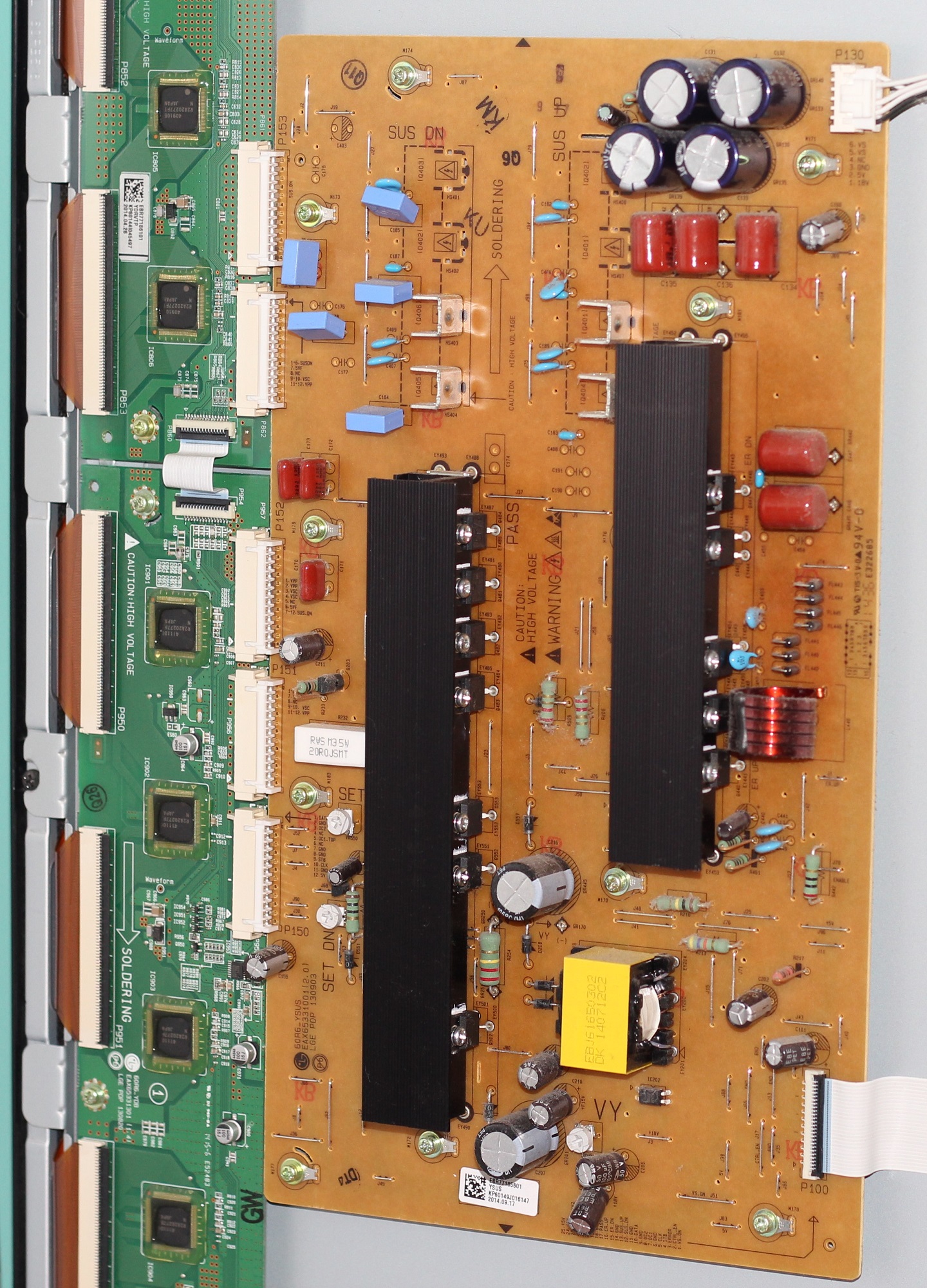

                      Do you have the correct voltages on P130?
                      There's a Vy voltage on the Ysus board which is often read between two "identified points" but I cannot see where they are located on your Ysus photo of the board. The two test points may be above R254 and you measure the voltage between the two points and not chassis.
                      Hopefully others can help you from here since it's starting to go beyond my current knowledge.
                        Readings for P130
                        Pin 6 VS = 205
                        Pin 5 VS = 205
                        Pin 4 NC
                        Pin 3 GND = 0
                        Pin 2 5v = 4.965
                        Pin 1 18 = 17.9
                        VY points read 186.9
                          I would try once again to disconnect the LVDS cable going to the mainboard and short out the Auto_Gen pads with a piece of wire or paper clip and power back up to see if you get the colour patterns. Also make a note of the led flash sequence on the Logic board.
                            Still no patterns.
                            Led changed to three blinks, 1 sec on, 3 sec off, then back to previous pattern.
                              I think you may have a faulty logic board. All your voltages appear to be correct and the screen test pattern is failing to come up.
                                    Update;
                                    I have received the logic board today. Installed it, tried turning it on. No change. Quick flash of grey, then black screen.

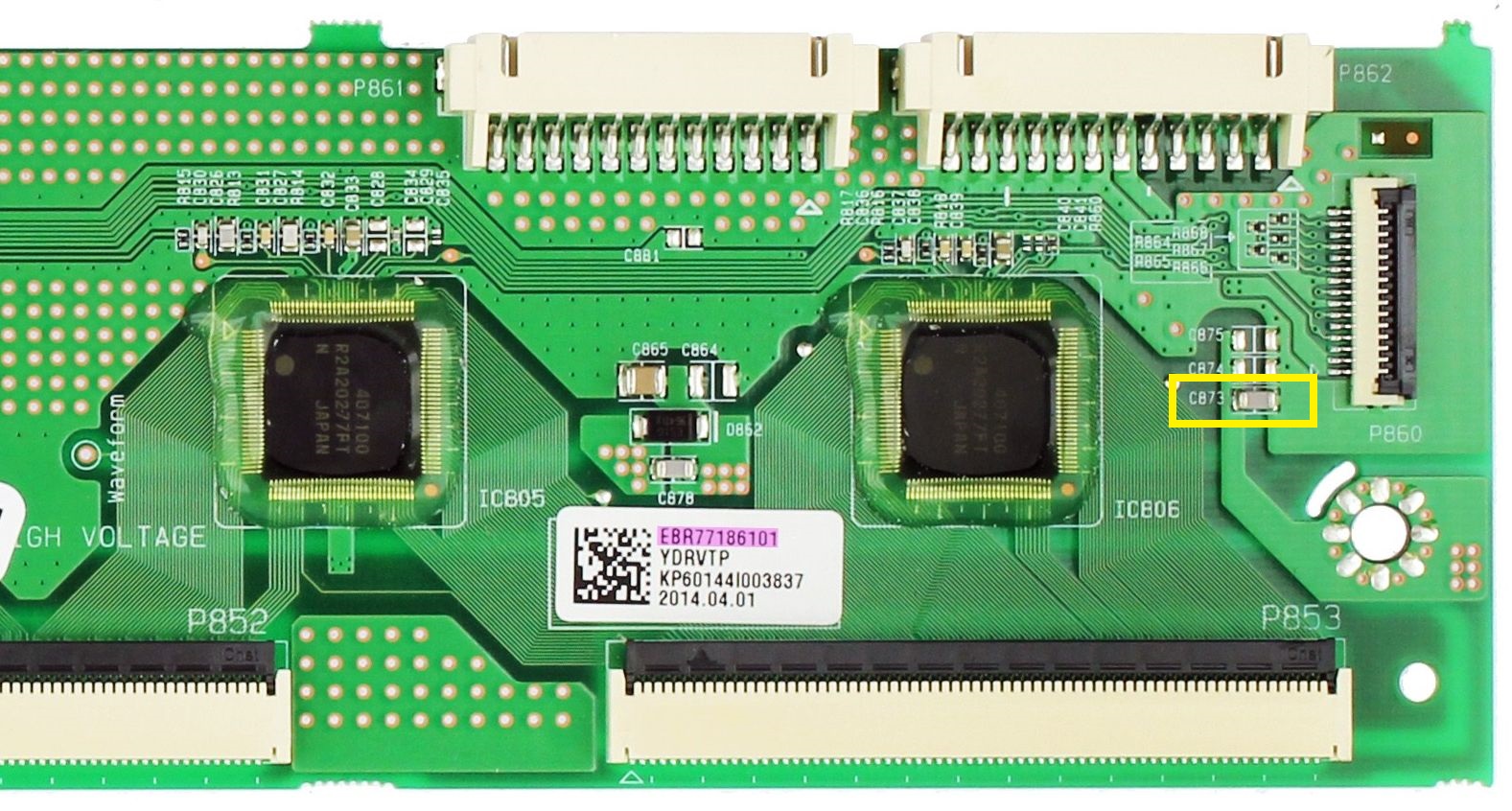

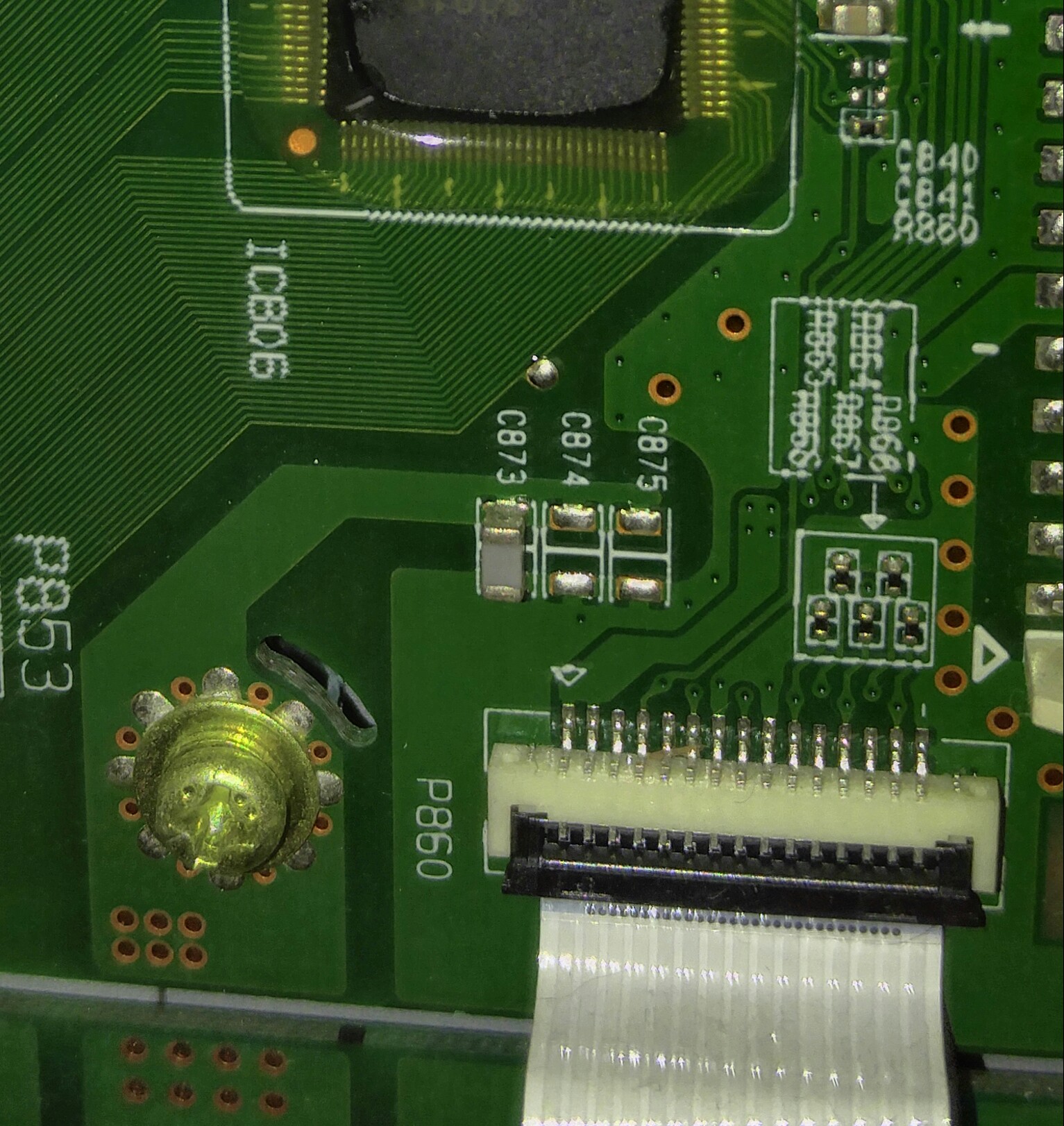

                                      That may be a panel primer flash. Have a look at the side of capacitor C873 on the upper Y buffer board (attaches to Y-Main). See if it has a diagonal line across it or if it looks like its burnt.
                                      I have a 6650 that once had the same symptoms, save for the noisy power supply. It's now up in my living room.
                                      Partial pic of upper Y buffer courtesy of ShopJimmy. Cap outlined in yeller.

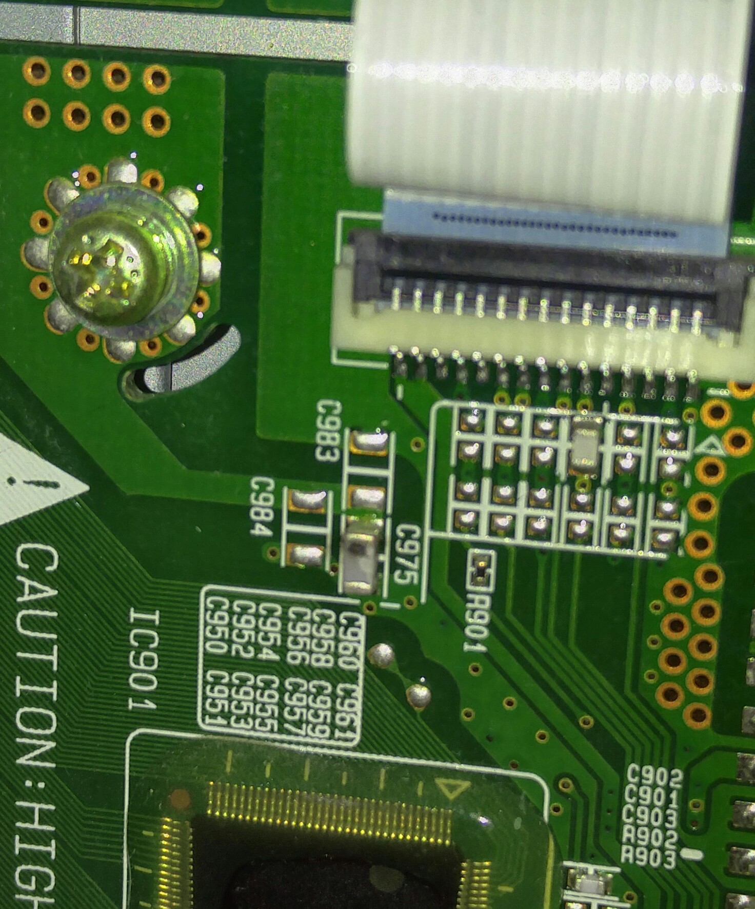

                                        Thank you,
                                        I had a look, and that capacitor has a very slight dot of discolouration. There is also one on the board below that looks burnt.
                                        Are these smd caps able to be replaced with a soldering iron? Or does the board need replacing.
                                        First image is upper buffer, second is below that
