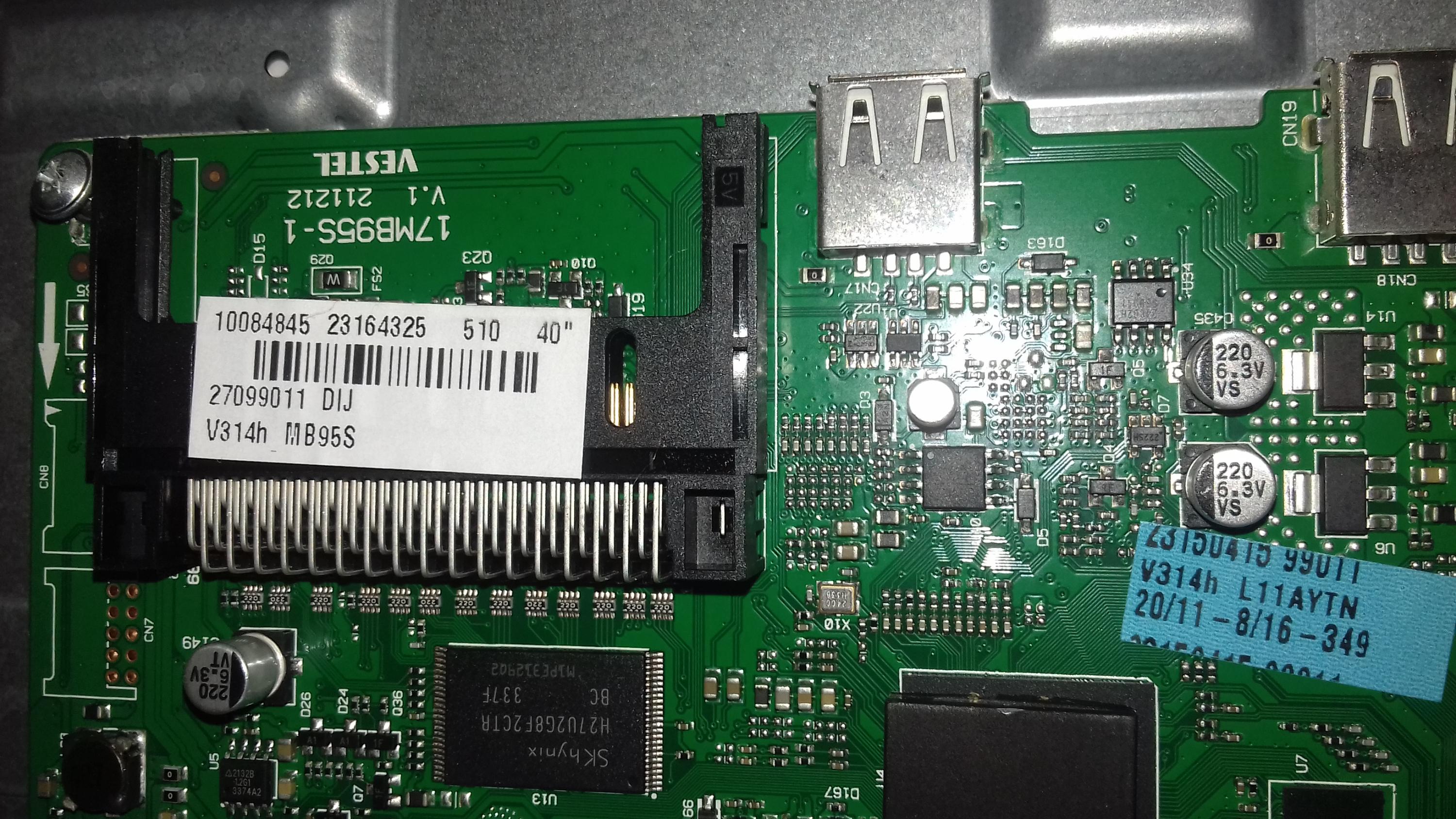

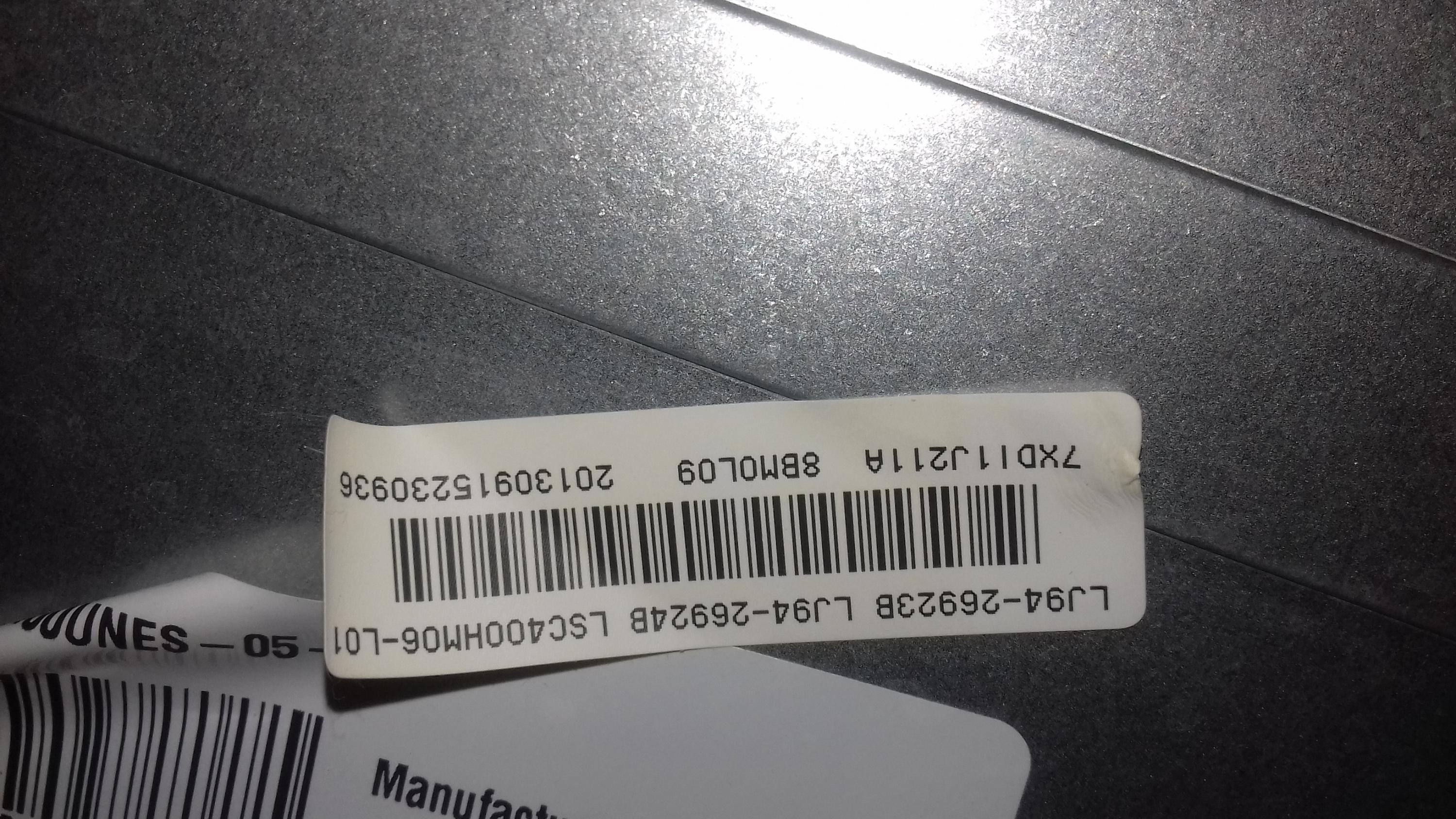

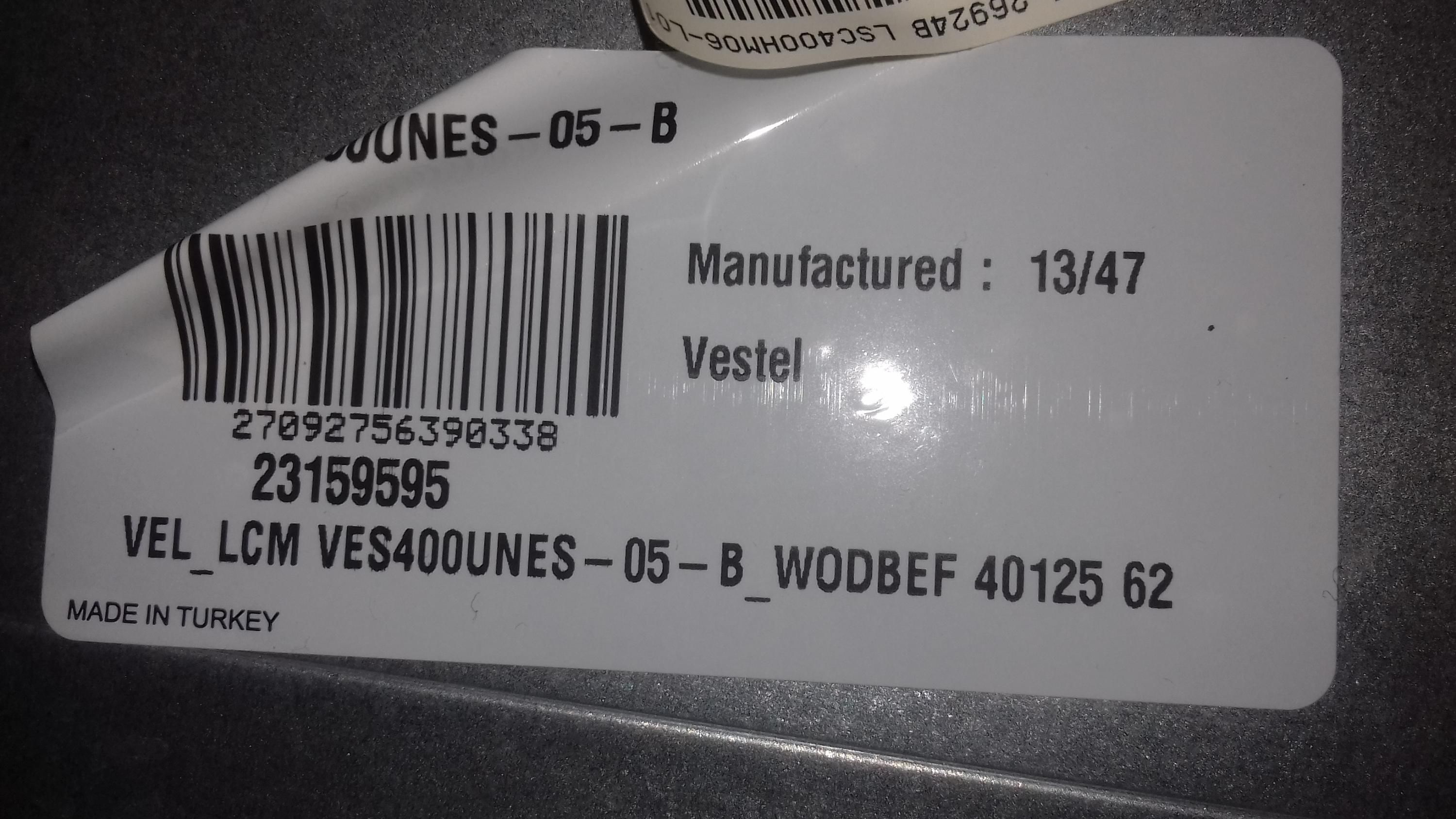

    Hi all i have faulty BUSH led40127fhdcntd,the main board is 17mb95s-1 the tv turns on and reboots and cycles like this all the time,the screen panel is VES400UNES-05/LSC400HM06 the closest board i can find to mine is a 17mb95s-1 but that is for LSC400HM08 screen panel,does anybody know if it will work?,is it worth buying to find out,The board looks identical to the existing board.Thanks all in advance!.

      Hi ive took a chance and bought the board now ill let eveyrbody know if the swap works and post pictures of the original board and the one i swapped it with,maybe this will help some people either way,thanks for the reply anyway.

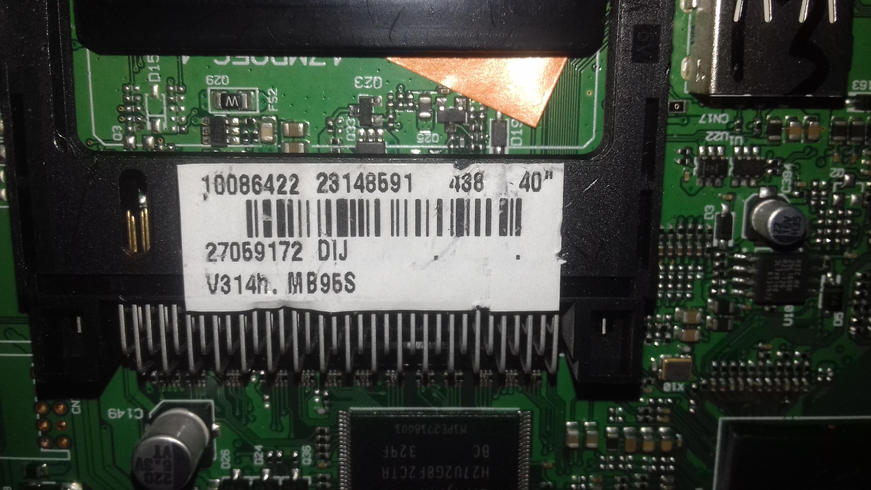

        the board swap worked i swapped a board from a 40 inch luxor tv(the second picture)with the bush led40127fhdcntd one and it worked fine,ill include pictures of all the numbers on both boards,this may help somebody if they cant get the exact board to replace their faulty one..
