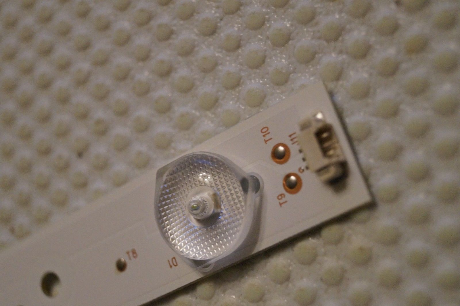

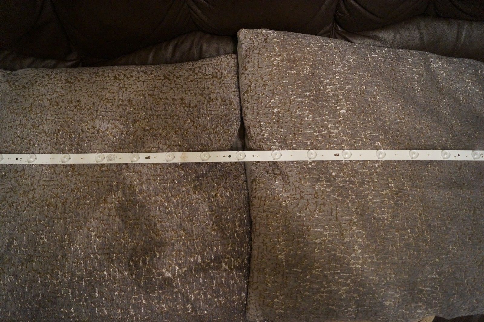

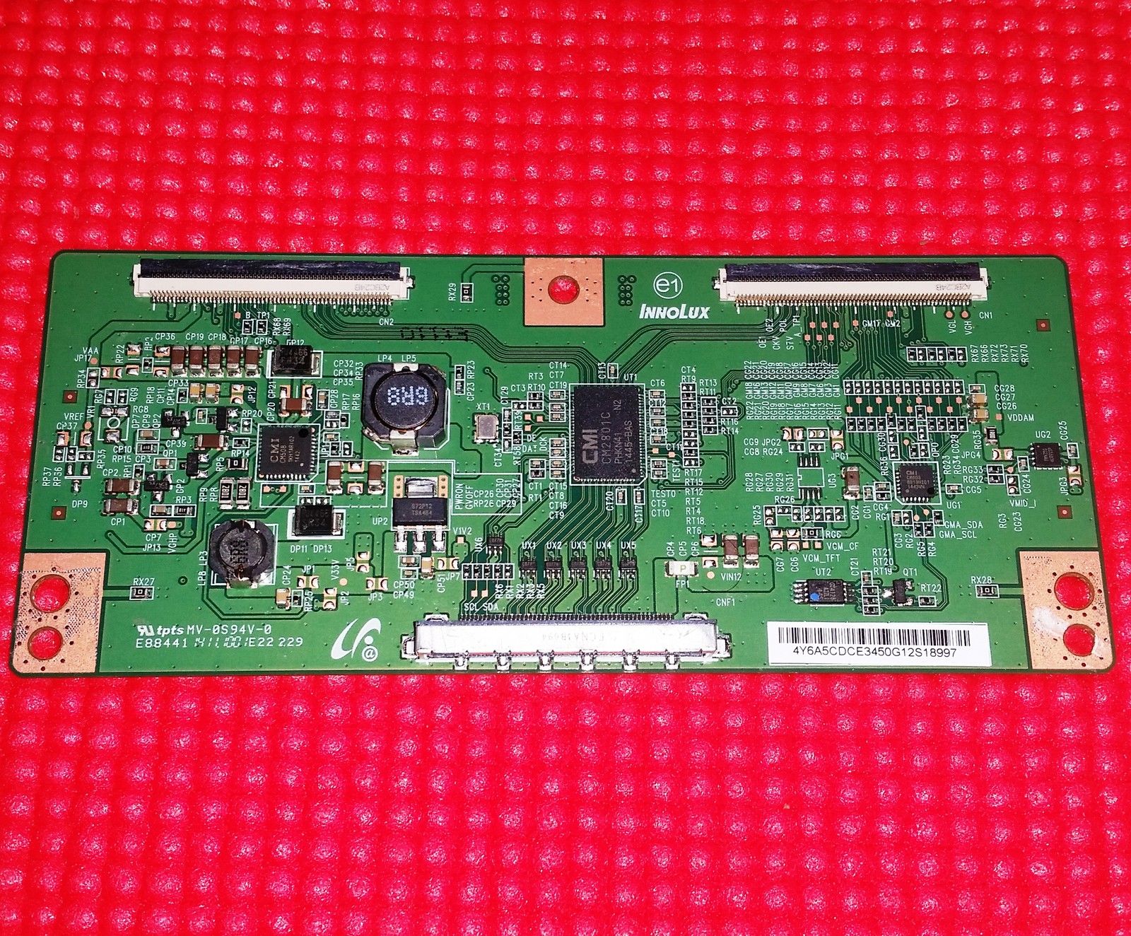

    Anyway ... I now have an Altius A-400F that I can easily repair and give to my son if I can identify the LED strips ... I've tried my best to find any info on the net about them but pretty much drawn a blank ... I've noticed in a few posts here that some of you guys can possibly help identify suitable LEDS from the T-con board ... so I'll attach a pic ... can anybody help me identify suitable replacements? (If you right click the picture and choose "view image" a hi res version is available) ...
    Re: Altius A-400F & Aldi Customer Support.
    That LCD panel is made by Samsung, that is a surprised for no name TV.
    What is the exact LCD panel model number?

      Hi Bud ... I haven't disassembled the TV yet ... that pic is of a spare part for the same model ... I don't have room to take the TV apart and leave it lying just now. I was always completely happy with the screen though.
      Can you help me identify suitable replacement LEDS? I'll be happy to give a full rundown of the innards when I get space to take it apart ...
        You cannot tell what kind of LED strips are use in the panel until you get the LCD panel model number, same TV model can use more than one LCD panel manufacturers.

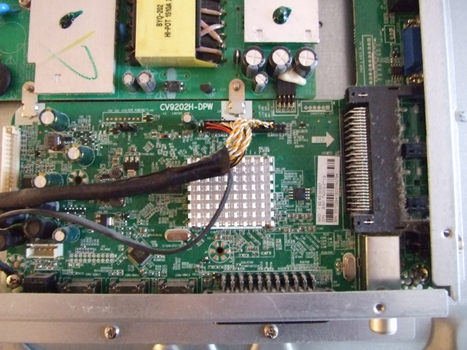

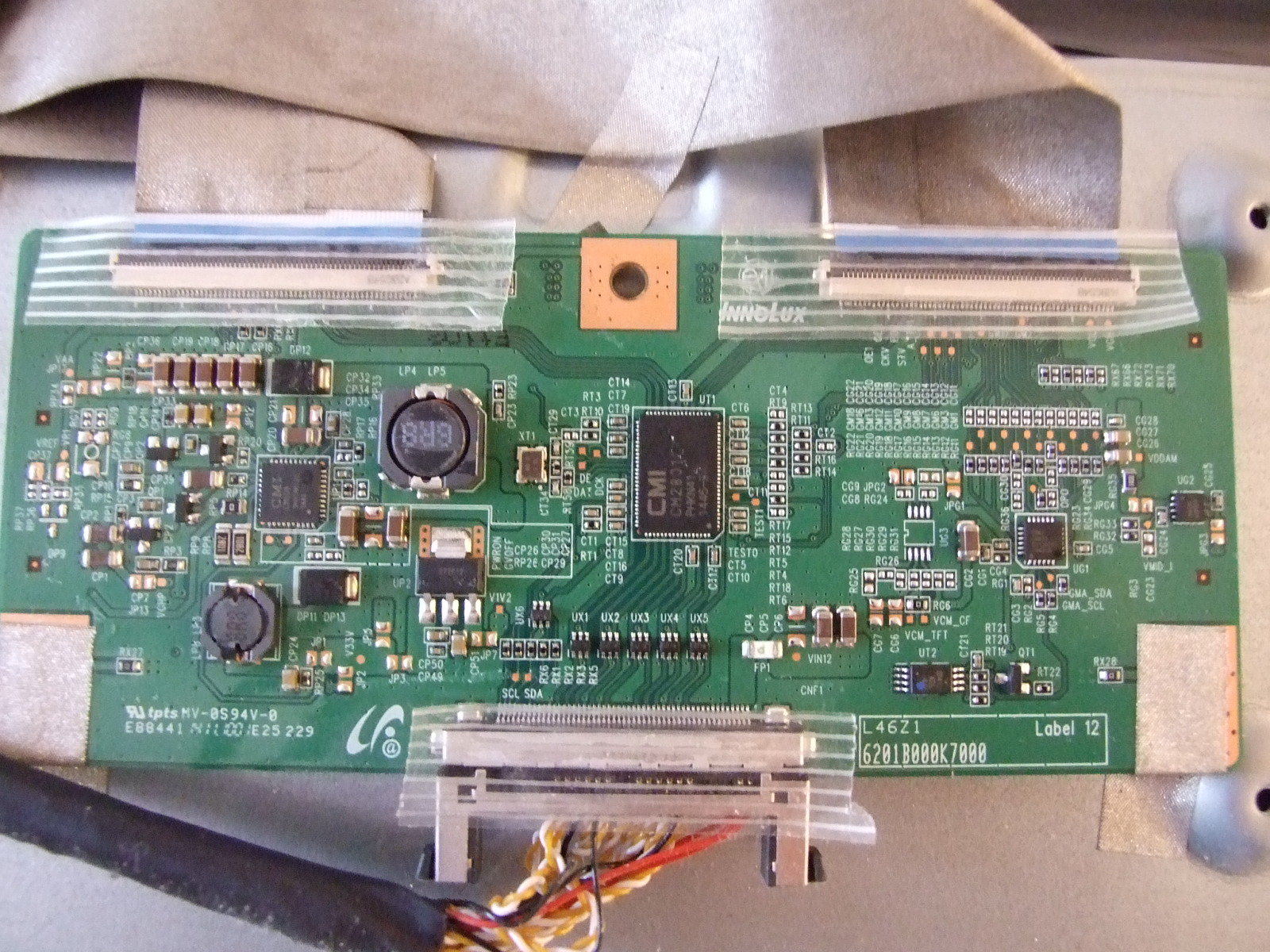

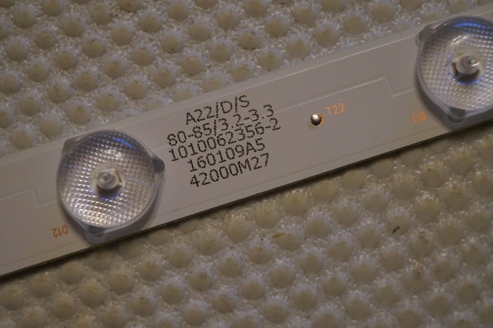

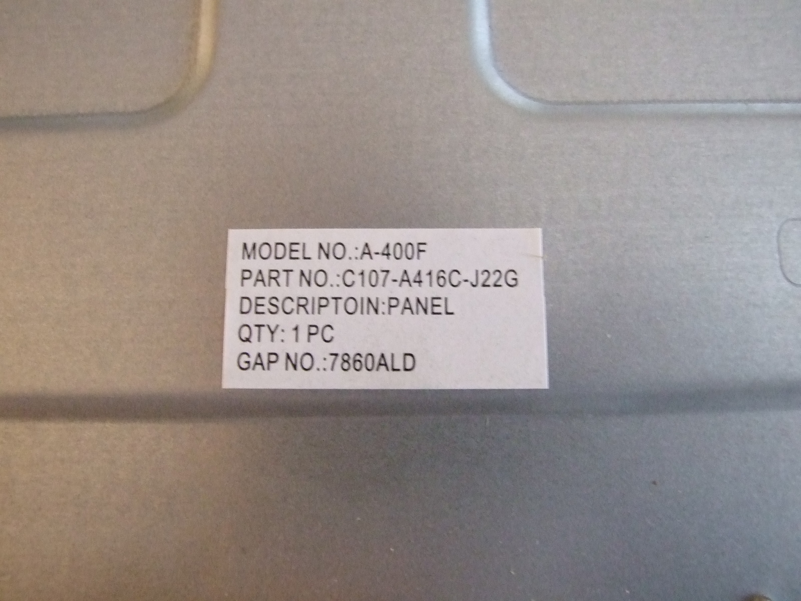

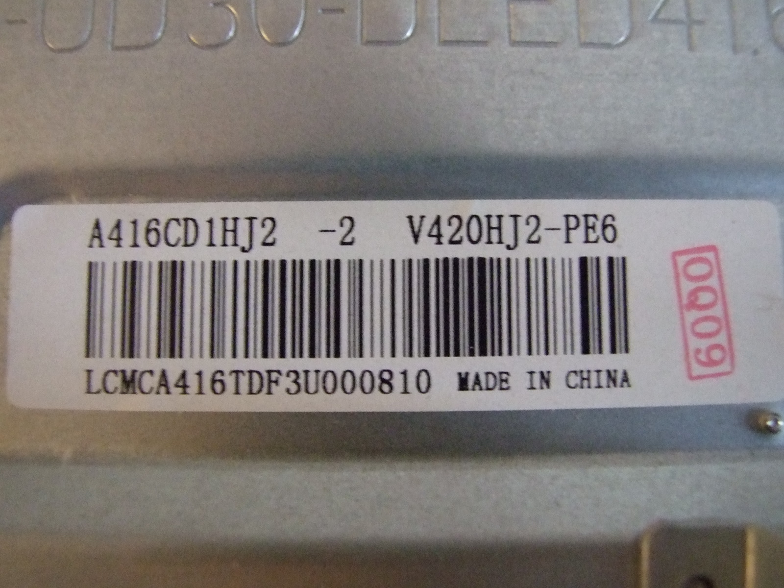

            Had a chance to get the TV open ... here are pics of the boards and labels ... can you identify the LEDS from these?
            If you need any more pics or info just ask and I'll post it up a.s.a.p.
            • check12
              • Nov 2012
              • 103
              So far I've only taken the back of the casing off ... are these the correct serial #'s or do I have to disassemble further for the correct LED panel #'s?
                I did not have the time to search for the spec sheet or LED strips that will fit that CHI MEI INNOLUX panel number V420HJ2-PE6 yet.
                  Thanks for the reply bud ... I just wasn't sure if you knew that I'd taken the pics.
                  I've been searching myself since opening the case ... but can't find any panels/LED strips with a matching/corresponding serial number, some very close but nothing of an exact match and I don't have experience searching for TV panel parts so don't know if any other close matches would be suitable in this case ... so by myself I'm pretty much stumped.

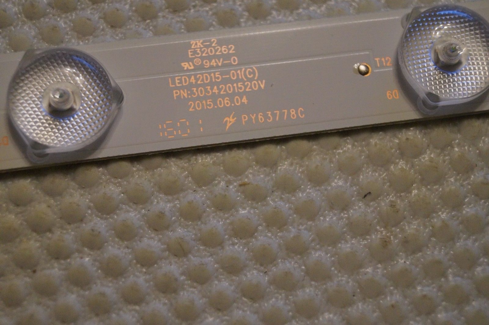

                    Closest I found was "V420HJ2-P01" .... which was for a JVC LT-42C550
                    The LED strips for it are LED42D15-01(C) 3034201520V
                    But I'm taking it that could be the completely wrong parts ... I've attached some pics (of the JVC parts) just in case it's of any use.
                    Doesn't have to be LED strips ... I don't mind replacing all the individual LED's if they can be identified and would be a lot cheaper as I see some of the strip kits can be over £100.
                    Because of lack of space at the moment I was hoping to avoid full disassembly until actually fitting the replacements but would further disassembly be worth it at this point to get a look at the actual strips that are fitted?
