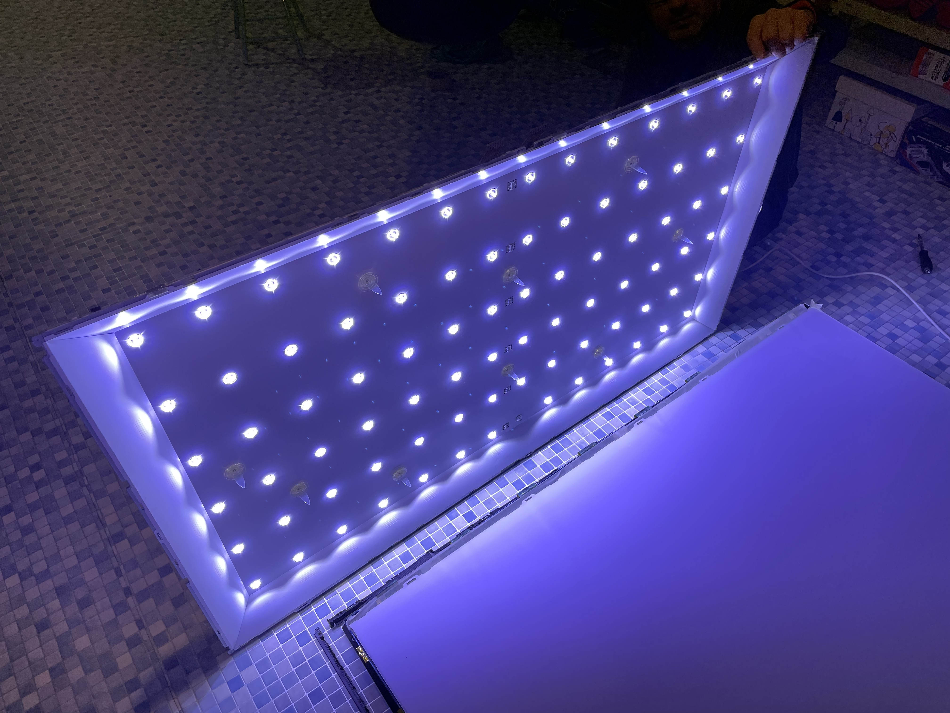

                      • limo
                        • Jan 2021
                        • 5
                        • P
                        Re: Samsung UE58J5200 LED fail repeatedly
                        PSU checked again (MOSFETs and diodes): no shorts
                        D1 line voltage: 120V
                        D2 line voltage: 110V
                        Calculated current on R9162=1.58 Ohm power resistor is 0.115A.
                        Power voltages on all boards seems to be OK 12.75V, 1.5V, 1.0V depending on circuit and IC).
                        Backlit: one LED broken (no big deal)
                        After reassembling screen and replugging two T-CON flex cables there is an image (menu) but with ghosting:
                        Faulty LCD screen, T-CON board?
                        Next steps:
                        1. To reassembly screen again (right side LCD bezel on the picture is not assembled well).
                        2. To clean pads on all flex tapes.
                        3. Check flex tapes conductance.
