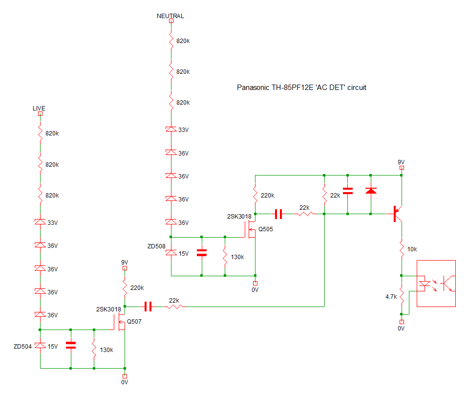

    Notes on the schematic:
    - the '0V' node is the negative end of the DC output of a bridge rectifier (D506 on the board)
    - as neutral is basically ground, the circuit relies on this '0V' point out of the bridge being a diode-drop above the negatively-swinging 'live' mains input during the one half-cycle (well it took me a while to get this straight in my head!)
    - the 15V zener at the bottom of the chain is not 'zenering': measurements/calcs show that about half the (peak) voltage of 340V is dropped across the 3x 820k resistors, giving a peak current of around 70uA; this drops about 9V (peak) across the 130k's at the bottom, thus keeping the zener off.
    - the 2SK3018s are SOT-323 packaged and marked 'KN'
    - the 130ks having no marking - 130k is based on DVM readings
    - I've included a few of the actual reference designators on the board on the very small chance someone else really wants to know them

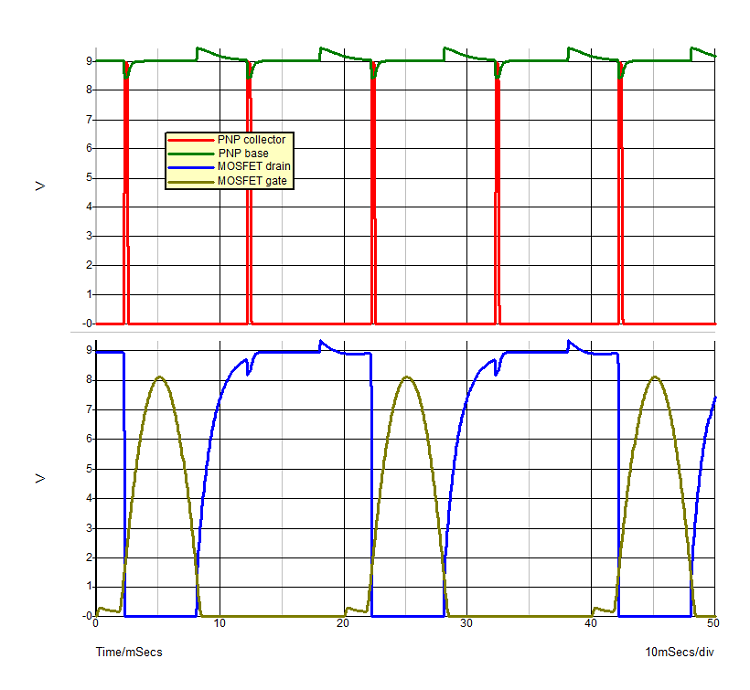

    Not immediately bothering to work out the precise functionality of the caps involved, I guessed the two MOSFETs would keep the PNP continually on, thus giving a 'high' 'AC detected' signal. However on applying the scope to the board (powered-up on the bench), we got 50Hz spikes from the PNP, a looks-like-it-is-working dip at the one MOSFET drain, and nothing from the other. This immediately suggested that one of the MOSFETs wasn't working: the input at the gate on the good transistor was peaking at 9V, the 'bad' one was 200mV at most. So we kludged in a SOT23 2N7002 instead, and discovered we now got 100Hz pulsing at the PNP, which looked encouraging, but it was asymmetric, with 7ms/13ms between pulses. This was because the voltage swing at the 2N7002 gate was only peaking at about 3V (and not 9V as the good one) - whether due to further damage in that locale, or because it is not the correct replacement transistor type (they are on order) we have yet to determine.
    Thinking there was maybe a 20% chance this would allow the TV to run, we replaced the P(SUB) board into the TV and powered up, immediately to get some clicking, a front panel LED, and she is clearly running! An immense feeling of satisfaction I can tell you, as it had taken several weeks and a good deal of head scratching to arrive at this point!
    I have now cobbled together a SPICE simulation of the circuit, using a very idealised 177V zener (!), and found the Rohm 2SK3018 SPICE model on the web, and can now better understand the circuit operation. I have attached a few traces for those that maybe like to see such things (as I do!). I guestimated the value of the caps on the drains at 4.7n, as this visually ties in with what we saw on the scope. Because these charge up quite quickly, this explains the narrow pulses at the PNP collector (feeding the optoisolator LED), which again tie in nicely with the narrow pulses we saw on the scope. (The little glitches in the blue trace are the interaction with the other transistor's switching on the other half-cycle, which I've not plotted.)
    If using a correct 2SK3018 transistor significantly changes the situation I will report so later!

    Not sure how the circuit works but if the positive and negative half-cycles charged the capacitors on the gates of the mosfets and turned them on, then if the discharge time-constant of the C*R is much greater than the incoming pulse I would expect both mosfets to switched on and stay on.
    This would then pull the capacitors connected to the drains down to ground. The base voltage of the PNP would be held somewhere around 1/2 supply (if the the capacitors connected to the 9V supply and the two other capacitors connected to the drain of the mosfets were all the same value). The result would be to hold the opto diode on.
    If you lost either of the positive or negative half cycle then the opto would pulse.
    Just my thoughts.
    Edit
    If you short circuit the emitter/collector of the PNP, does your set operate?

      ... if the discharge time-constant of the C*R is much greater than the incoming pulse I would expect both mosfets to switched on and stay on.
      It turns out the opposite is actually the case. The cap at the drains, which I guessed at around 4.7nF (and as used in the simulation traces), charges through the 22k and the other 22k from the 9V rail to the PNP base; it discharges through both these resistors and the 220k at the drain. This gives time constants of 0.2ms for charge, and 1.2ms for discharge. The latter is easily seen by the upward curve of the blue trace over a handful of milliseconds. The smaller time constant is what gives rise to the short pulses at the PNP collector, because...
      ...the base actually clamps at about half a volt or so below the 9V rail, and as the cap on the drain quickly charges at the short time constant, it isn't long before the base gets pushed back toward the rail, turning the PNP off again.
      We were firmly considering doing that whilst we contemplated what to try next, but as soon as we saw the narrow pulses at 50Hz, and not 100, we realised our assessment that the PNP probably would be held on all the time was erroneous, and then we changed the transistor with all becoming good (or at least, good enough!) so we didn't get around to shorting the PNP out.
