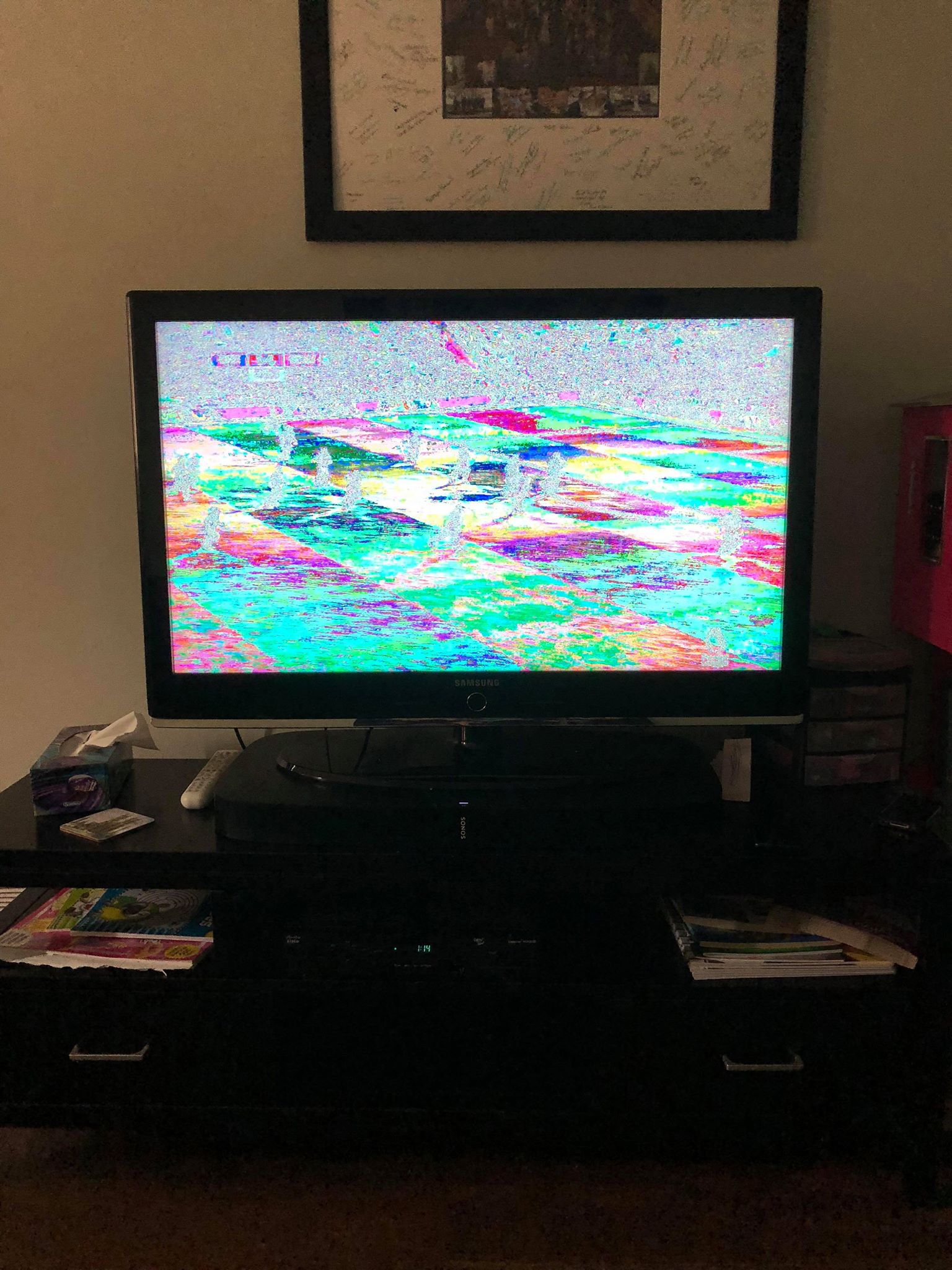

    Hello Everyone,
    New to the forum here and I was just looking to get some input on a TV i got from a friend that I wanted to attempted to fix. As the title states is a samsung ln-t4061f and all of the inputs have no clarity and are completely pixelated. I have attached a photo of how it looks on a TV receiver and can also provide shots with other devices as well.
    I was wondering if anyone has come across this before as I was seeing things about Tcon boards and how these TVs are also known for the Samsung capacitor issues back in 2006 - 2009. I have yet to open it up but just thought I'd ask here first before I go and start taking it apart likely tomorrow (Monday).

    Re: Samsung LN-T4061F All Inputs Pixelated
    My initial thoughts would also be Tcon.
    Doing a quick search on the forum does appear to show this set as being quite problematic.
      I'd also think it is the tcon.

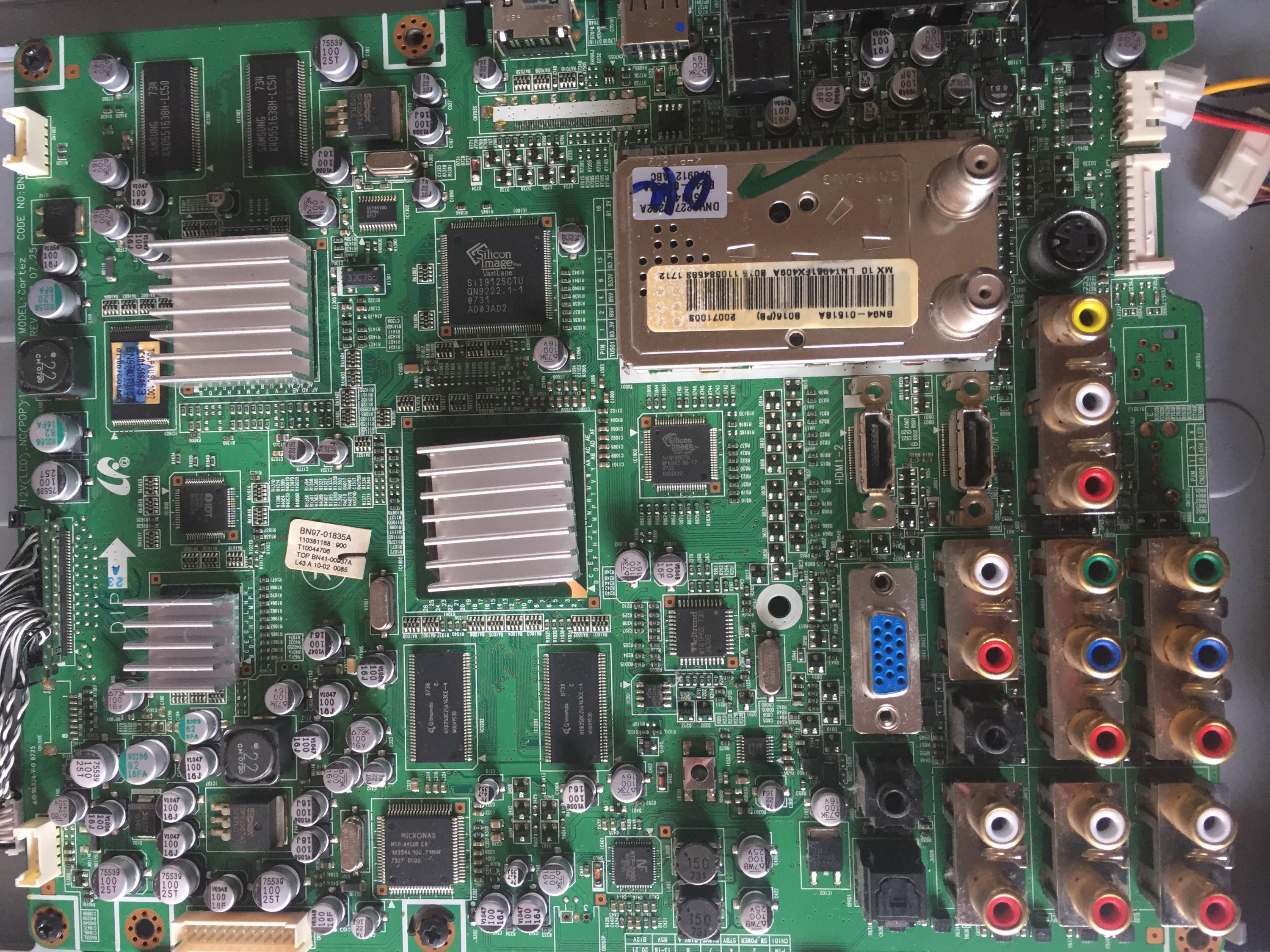

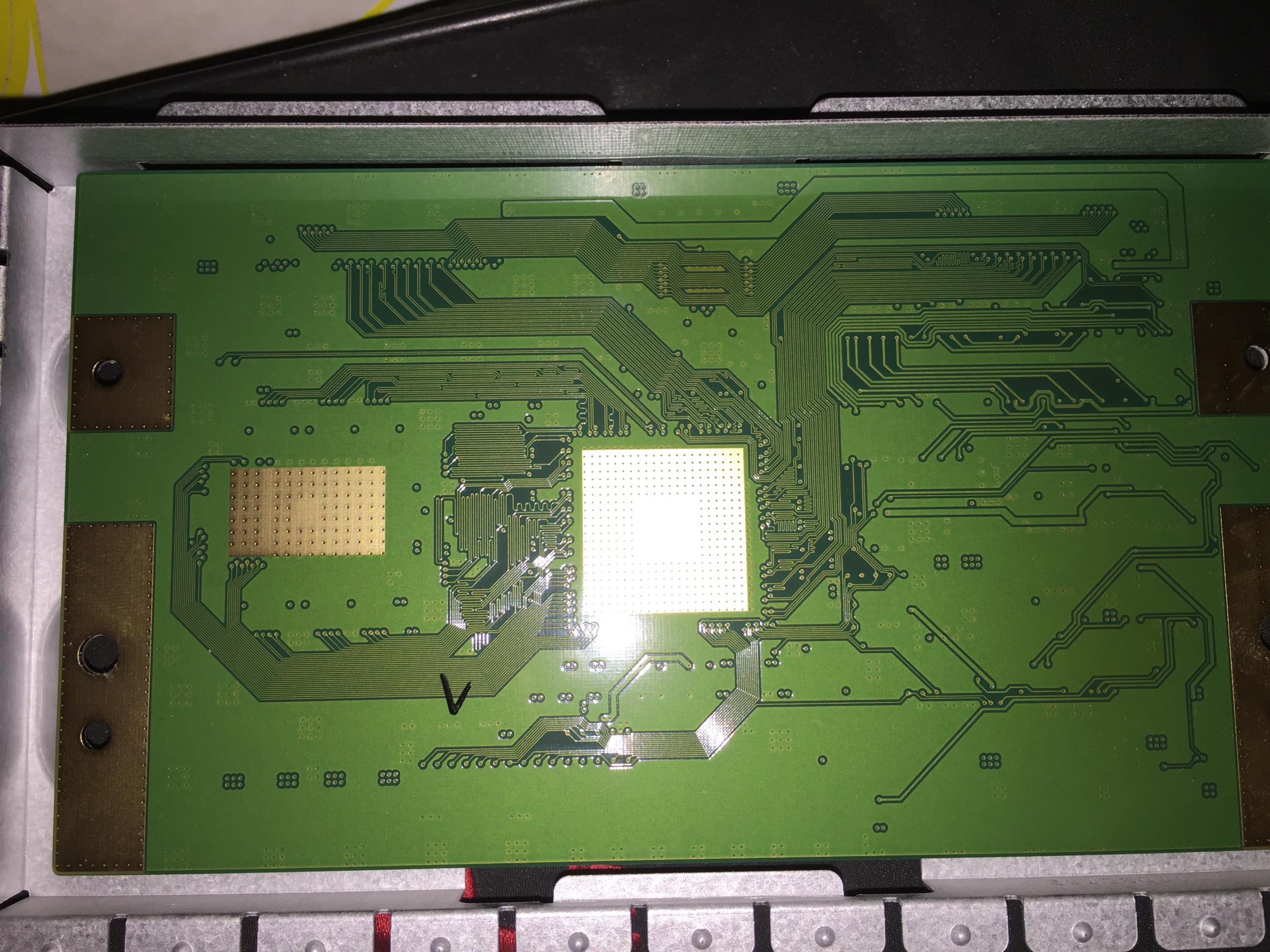

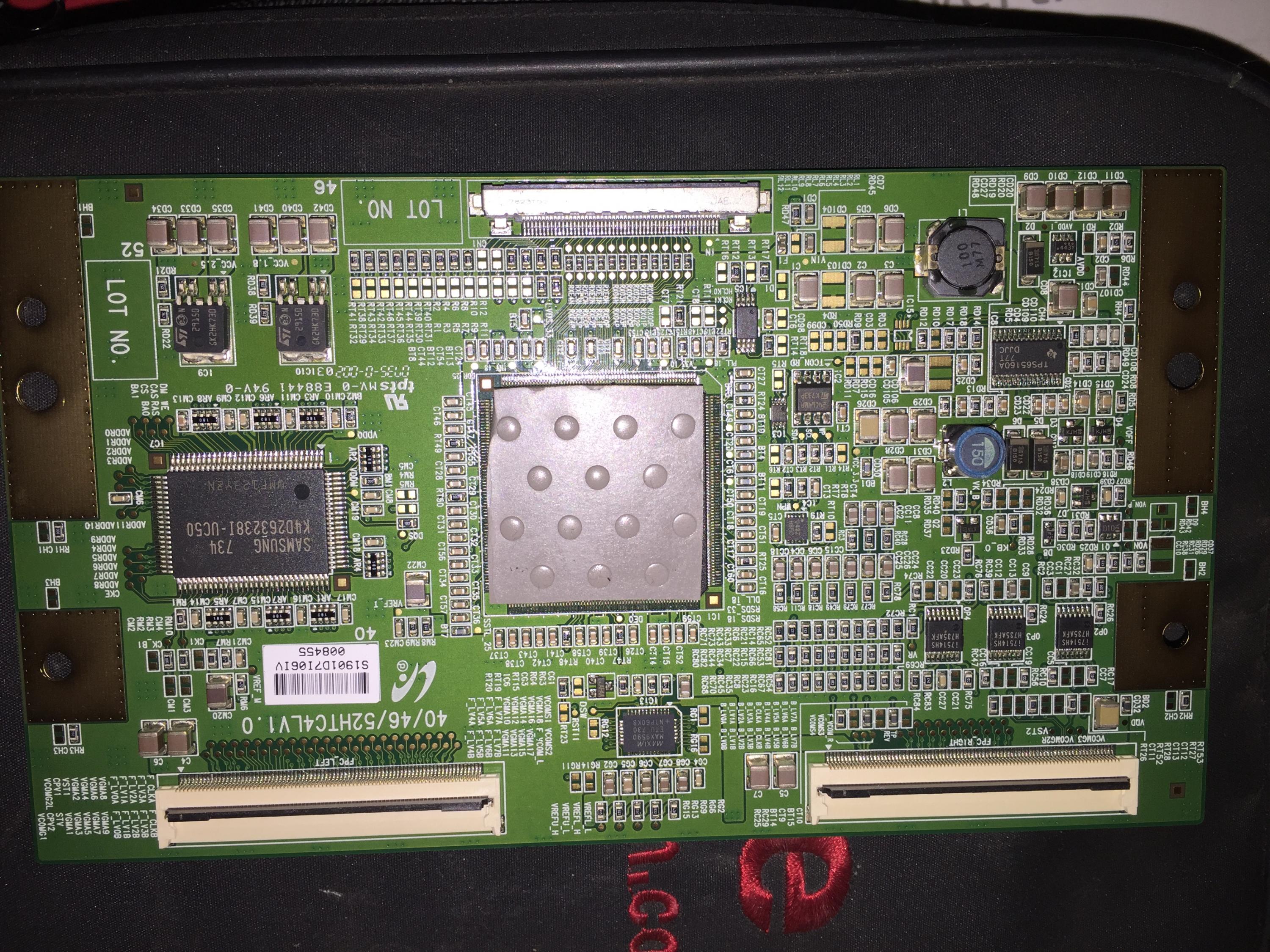

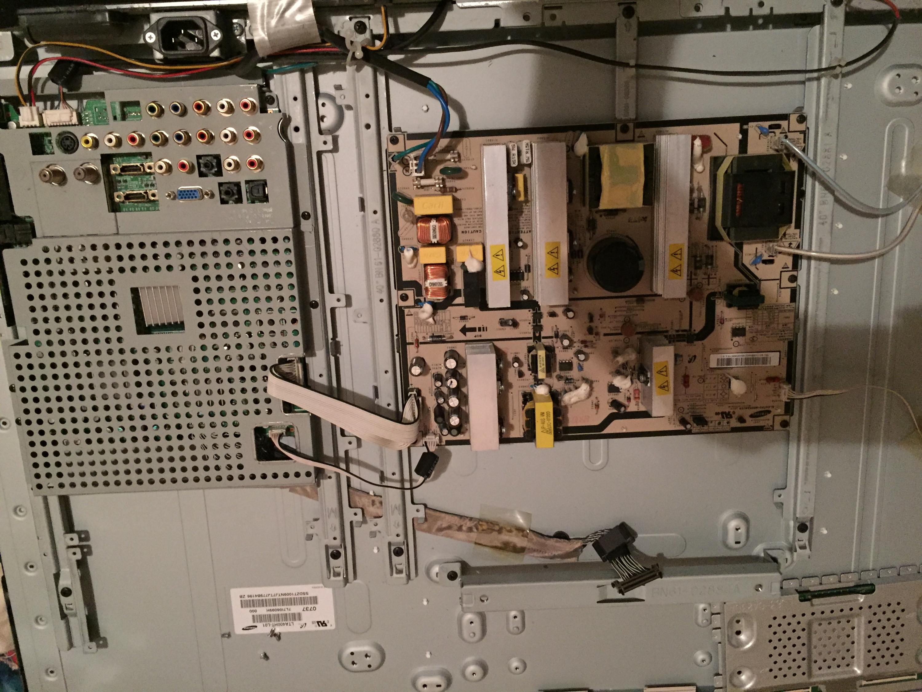

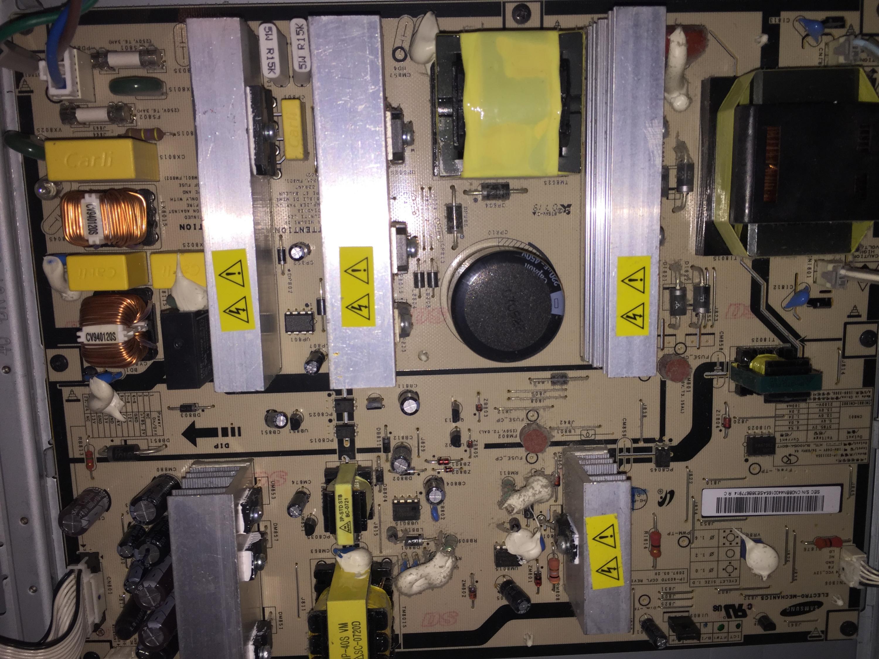

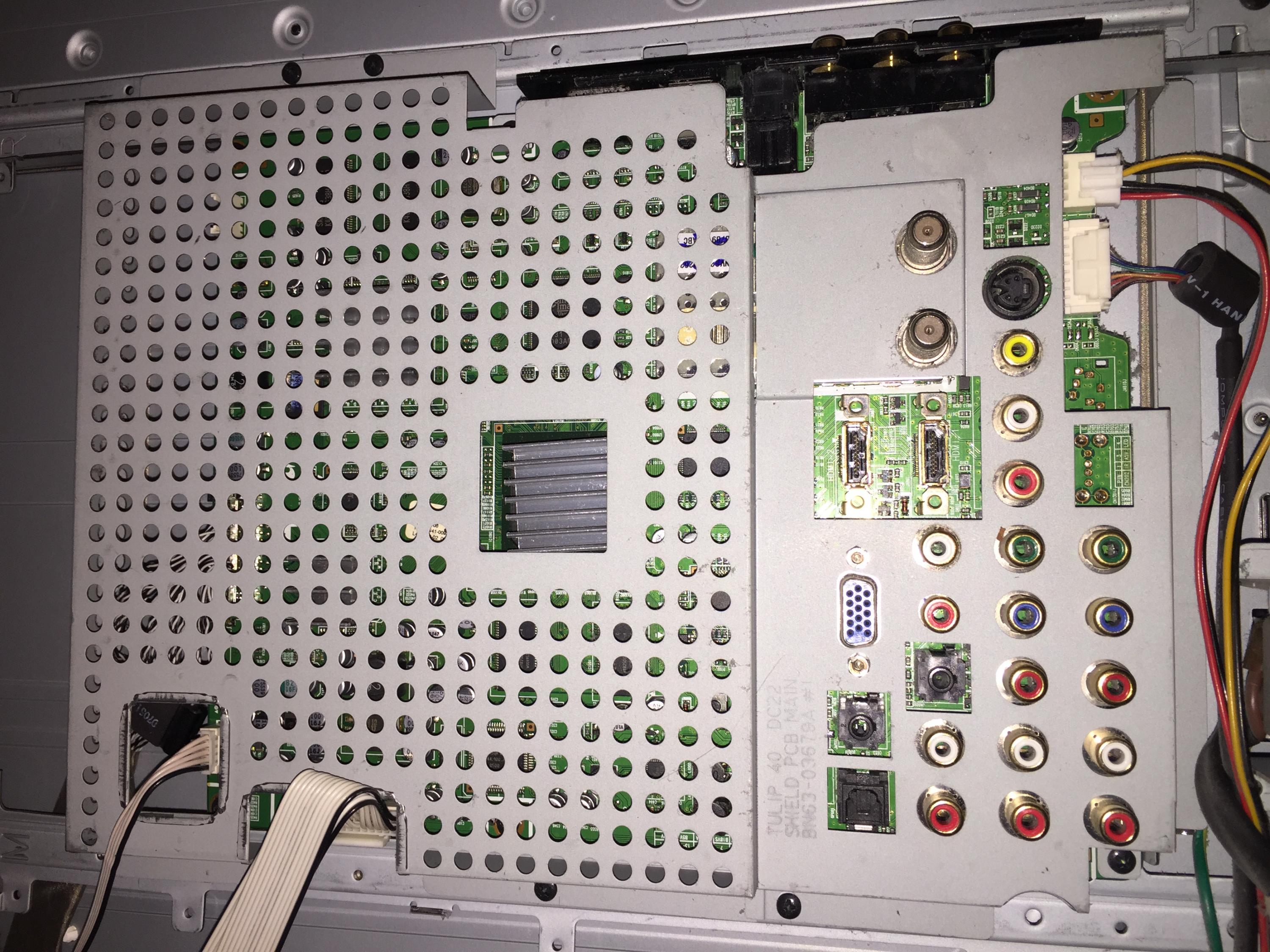

            I have pulled the back of the unit and there doesnt seem to be any capacitor issues that I can see visually. The Tconn board at the top though does have a different smell than the other components which makes me think something may have fizzled out to cause the problem I am having.
            Here are the pics of the mainboards and the Tcon. Let me know if you want pics or information about anything else.

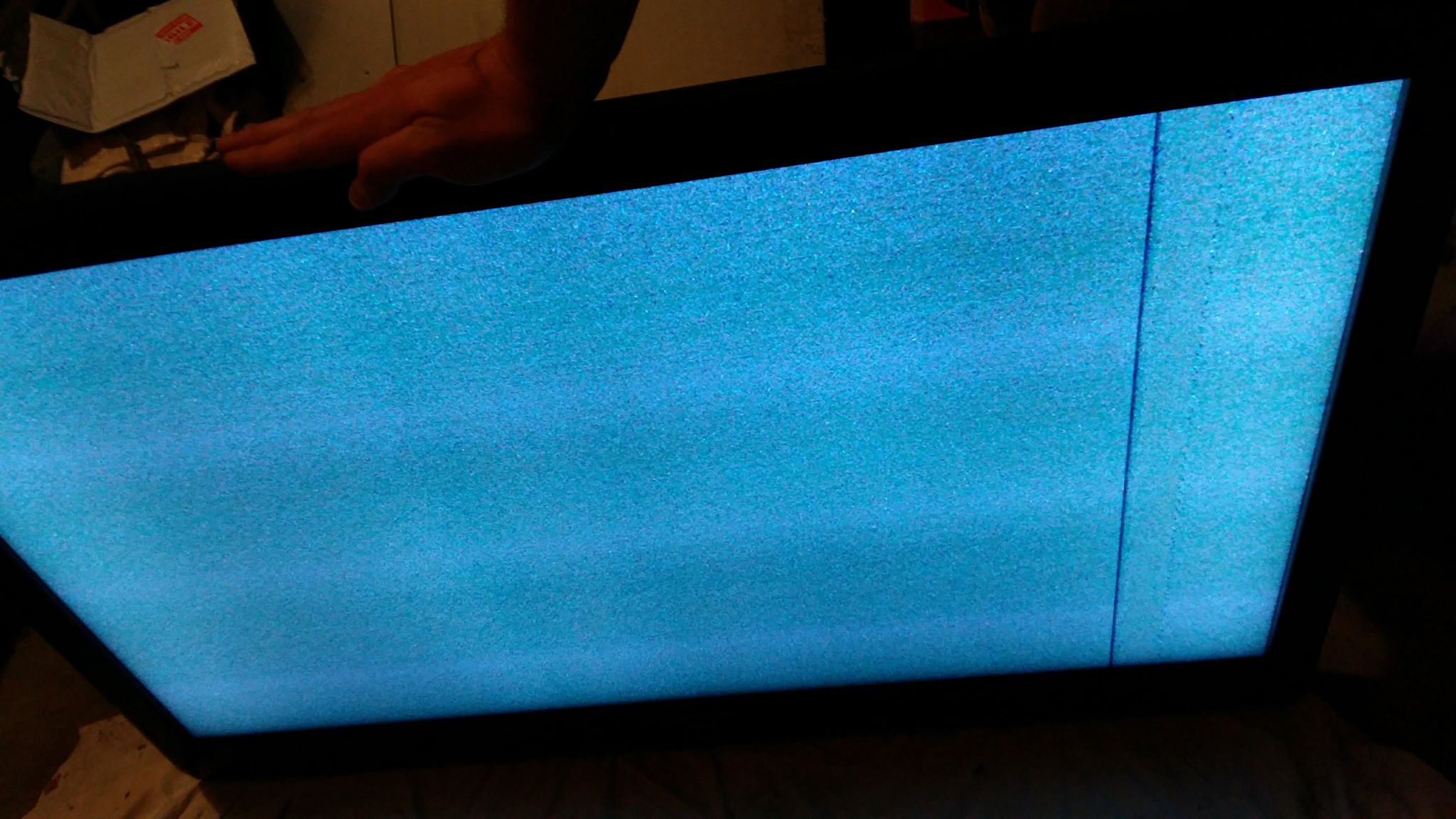

              I went ahead and ordered a new TCON board and have since installed it and it would still seem I have the same issue although now there appears to be a black line through the screen as shown in the attached picture.
              The exact same picture discoloration appears with this board as well as the old one so I am not sure if anyone else has any other thoughts on this. I will not be heavily investing in it at all I just wanted to get some other ideas and perhaps close this out.

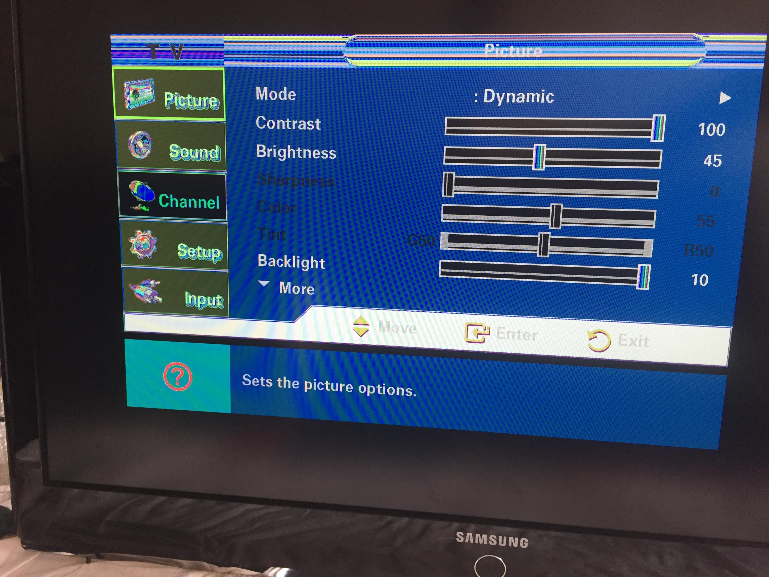

                Can you get a menu up? could be your mainboard.

                  What is the number on the white sticker on your mainboard? it will start with bn94.
                    Hi nomo,
                    Thank you for replying. I can get the menu as shown in the picture below antd he board model is bn97-01835a.
                    This is the board that all my inputs are connecting to. I presume this is the one you wanted correct?

                          Did you try a factory reset? try this: With the TV on, press and hold EXIT on the TV remote for 10 seconds, should bring up the reset option on screen.
                            Hi guys
                            I haven't tried those things yet but I will try tomorrow. As for the board here is a picture of it you can see the white sticker on it. It states the number that I provided.

                                      Ok, post 15 is a mainboard.
                                      • Scoto
                                        • Apr 2018
                                        • 12
                                        Yea thank you I saw that and I did verify the board number with the one you posted and they do match. I was looking at a different sticker on the mainboard.
