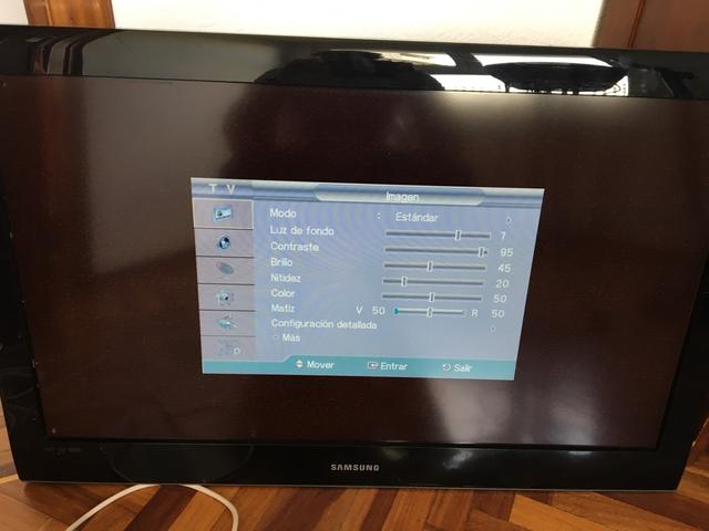

    Hi There!
    A users is posting an ad for a Samsung 37 LE37A558P3F that needs to be repair. Its pretty cheap. He describes the problem as:
    "Wrong colors, all is blue and yellow". Supposedly it's all happening on the whole screen.
    This is the only screenshot he has (see attached).
    Would you expect this to be a LCD panel issue? Or a board issue?
    Thanks in advance!

    Re: Samsung 37 LE37A558P3F wrong colors
    I'd suspect its the gamma ic on the tcon that is the problem. Usually an AS15 sometimes an AS19.
    Either replace the tcon, get it repaired by someone or do it yourself if you have the tools/skill. The ic costs about 50p.
            I'd purchase the TV going on that picture. Panel failure usually shows itself as lines on the screen.
            There are test points on the tcon that you can measure to confirm it is the gamma ic.

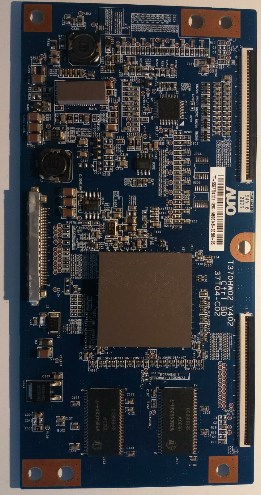

                            Ok some updates here.
                            I didn't find time to bring this TV home til today. I disassembled it. Found the T-Con board.
                            Labeled: t370hw02
                            The chepaest exact (by model number) replacement part I've found online was:
                            https://es.aliexpress.com/item/T370H...830313386.html
                            But the ad states "for LA37A550P1R" and this TV is a LE37A558p3F instead. Does the TV model care? Or it's only the board what has to be identical?
                            I've carefully checked the pictures in the ad and it is absolutelly the same board.
                            Should I get it?
                              Can we actually see the good clear pictures of your T-CON?
                              There are at least two P/N on the board:
                              One for the PCB ( Blank circuit board without parts installed)
                              One for the PCBA (PCB assembly) which the Blank board is stuffed to make PCBA for particular LCD panel, blank board can be stuffed in may ways to make many PCBA.
                                Absolutely, check attachment. So I guess PCBA is the one on the sticker?
                                Thanks for your help!
                                      The two boards may look the same, I.E. R1 may show on both board but R1 in one board may be 100 Ohms, another board may be 200 Ohms.
                                      They make bunches of PCBA numbers for reason.
                                      You can buy it and try to see it is compatible with your LCD panel or not, you now know what the P/N is for your your board, so it is up to you.
                                      If it works, great, if not, return it and get the one that matches your P/N.
                                        So definitely the PCBA is what has to match to make sure it works on my TV?
