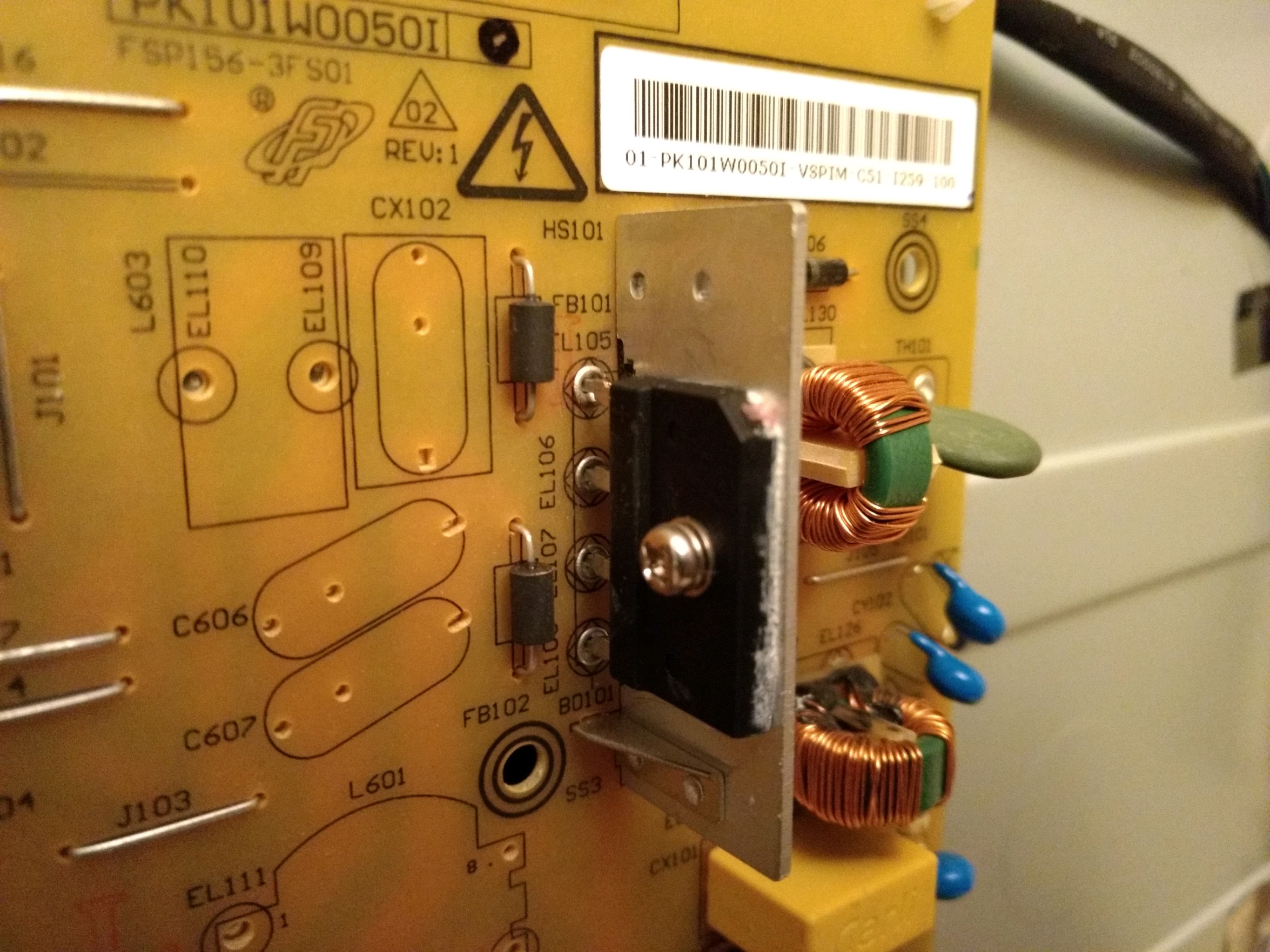

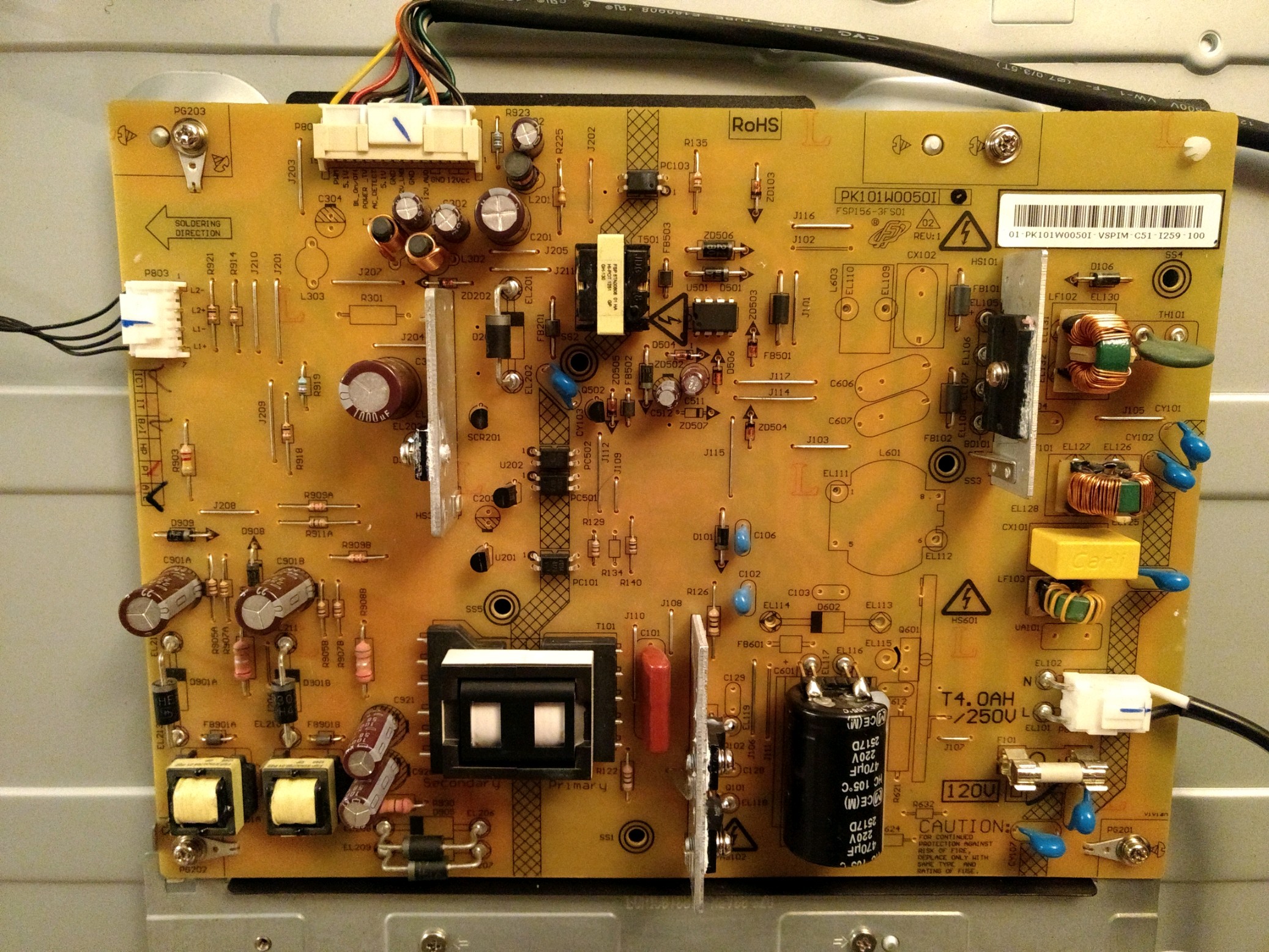

    @budm thank you for providing that write-up for everyone. I'm beginning to see I have a main board issue most likely. Well at least it did.....until I came along!

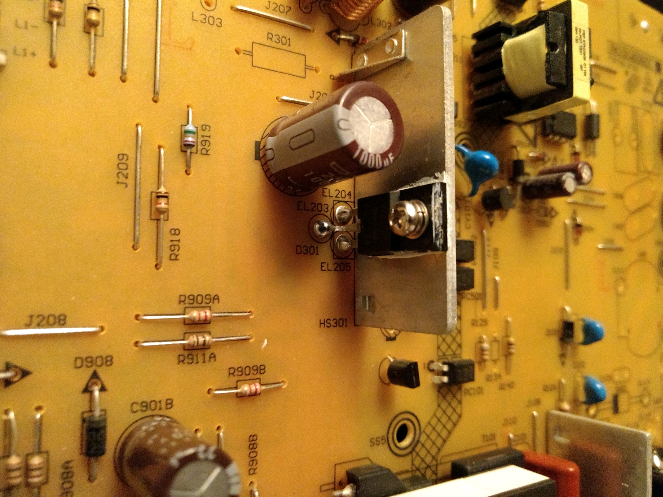

    Let's try to keep this simple....do you think I'll be able to get away with replacing diode D301 or do you think it's worse than that?
    I already planned on replacing those mosfets, including the one I cooked. The board repair kit I found calls for IC U101, fets Q101, Q102 and Q502 to be replaced.
    I'm thinking this kit is available for power supplies with shorted fets....and that's what I did......so I'm wondering with this info do you think these components have a good chance at resolving the damage I did? It would be cool if you could help me track it down, but I don't want this to become a pain in your
    I'm going to place an electronics order soon and would like to see if I can get the power supply back up and running for further diagnosis?

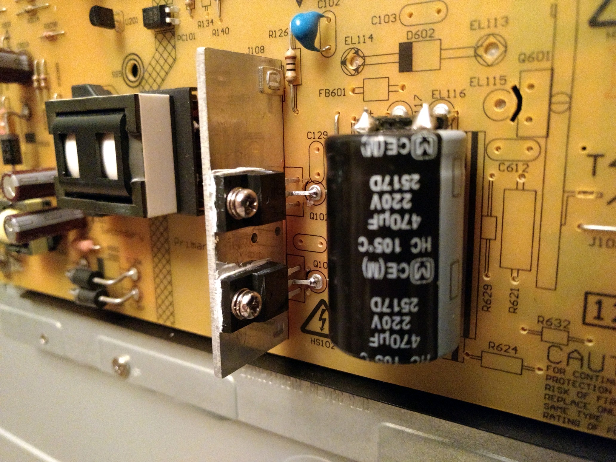

    1) Is diode D301 tested bad? Bad = Replace.
    2) Are Q101, Q102 and Q502 tested bad? Bad = Replace. You can study on line to find out how to test them.
    3) IC U101 no 100% test to verify if it is good or bad, so replace it.
    4) The harder part will be trying to fix the main board which is really complicate so if the main board cannot be repaired by you then you may want to think if it is worth fixing the power supply board or not.
    The whole thing a matter of willingness to spend lots of time to do the research and study or not to become good at anything.

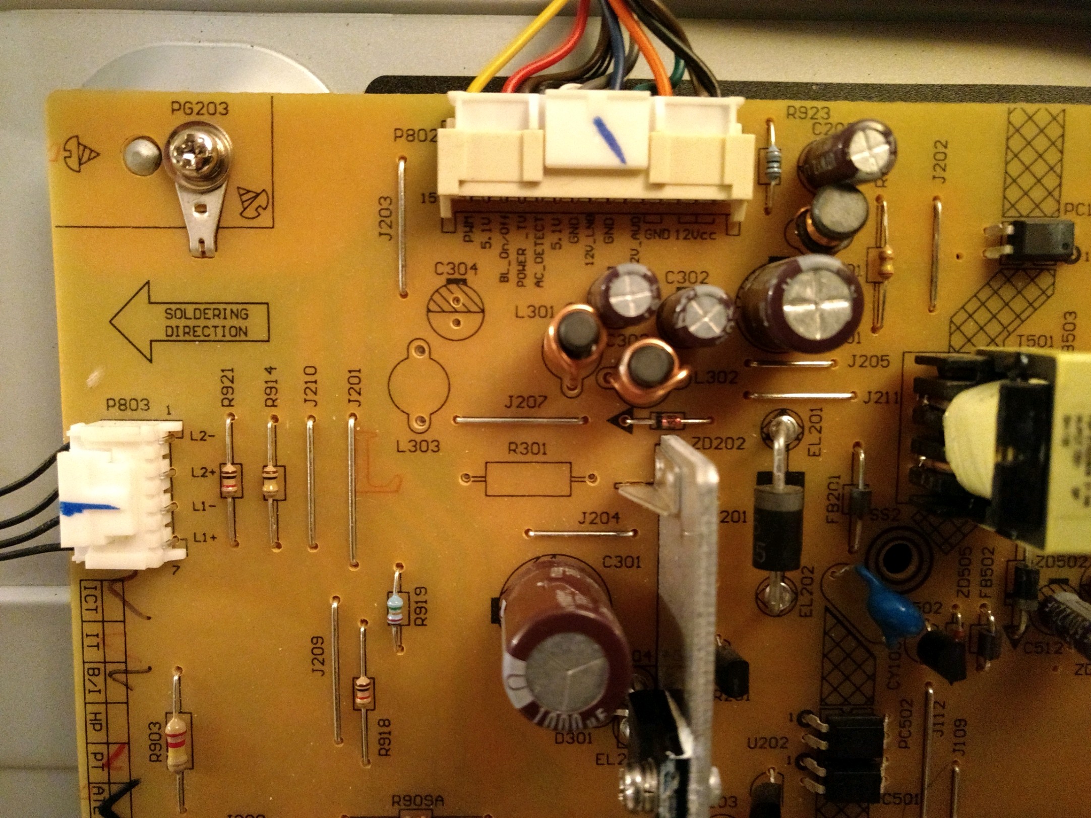

      Last week I placed an electronics order including parts for this TV. They arrived. Tonight I replaced Q101, Q102 and D301, the components I damaged. I plugged in the TV, the fuse didn't blow and nothing went pop.
      The TV would not turn on initially after installing the power supply
      Here is an updated list of voltage readings in stand-by:
      Main cap: 162.4-.5 steady
      Connector P802:
      PWM.........3.24v steady
      5.1V..........NC
      BL on/off.... 0v
      Power TV....Varies 1.2v - 4v
      A/C det.......Varies 0v - 3v
      5.1V...........Varies 1.3 - 5v
      GND...........ok
      12V LNB..... N/C
      GND...........ok
      N/C............ N/C
      12V AUD..... 0v
      GND........... ok
      N/C............ N/C
      12V CC....... 0v
      12V CC....... 12.7 holds, then varies
      Connector P803:
      L2- ............ 5.5-6v varies
      L2+............ 55-65v varies
      L1- ............ 1 -1.5v varies
      L1+............ 50-62v varies
      The remote control and power buttons were unresponsive.
      I unplugged the TV for a bit to have a bite, and when I plugged it back in the green light around the power button illuminated, the screen lit up and the TV actually came on, but the screen was flashing so I re-checked the voltage readings and they were quite different:
      Main cap: ...... 154V with backlights on, 160 without
      Connector P802:
      PWM.......... (point)1v steady
      5.1V.......... NC
      BL on/off.... 3.1v steady
      Power TV.... 3.2v steady
      A/C det....... 3.4v steady
      5.1V........... 5v steady
      GND...........ok
      12V LNB..... N/C
      GND...........ok
      N/C............ N/C
      12V AUD..... 10.9v steady
      GND........... ok
      N/C............ N/C
      12V CC....... 10.9v steady
      Connector P803:
      L2- ............ 10.6v
      L2+............ 74.8 - 75.4v varies
      L1- ............ 7.3 - 7.9v varies
      L1+............ 74.8 - 75.8v varies
      Please remember that at one time I shorted the rectifier diode, pin EL105 to the heat sink as well as shorted the drain pin on Q102 to the heat sink and shorted pins EL203 and EL204 together at diode D301.
      So there must be other damaged components on the power supply in the PFC circuit, or maybe I took out the rectifier (although it appeared to test good) I'm not too sure why the voltage was varying so much then as if by some miracle exerything kinda stabilized after unplugging and re-plugging the power cord.
      The bottom line....I f'ed this board up a good one "testing" it, yet I installed some components....AND I SEE LIFE!
      Truth told I never thought I'd see this TV work....
      So would anyone have any insight or suggestions on what I need to check? I'm feeling pretty good just to get as far as I have!

        Interestingly enough, if I plug the TV in and wait for a bit the TV turns on and off just fine....and appears to have a good picture.....with main cap voltage about 162.
        Along with last night's post, what am I missing here? Is the voltage at the main cap supposed to go up to 390 or not? I find it odd that everything works with such low main cap volts....unless that's how it's supposed to work?

          Re: Toshiba 50L1350U pk101w0050i troubleshooting, help identifying an IC?
          There is not PFC Voltage booster on your PCBA version (you can see that the PFC parts are not installed on your PCBA).

            So this set runs at 160v at the main cap? Should I be concerned about the voltages at Connector P802, a couple of those are under spec?

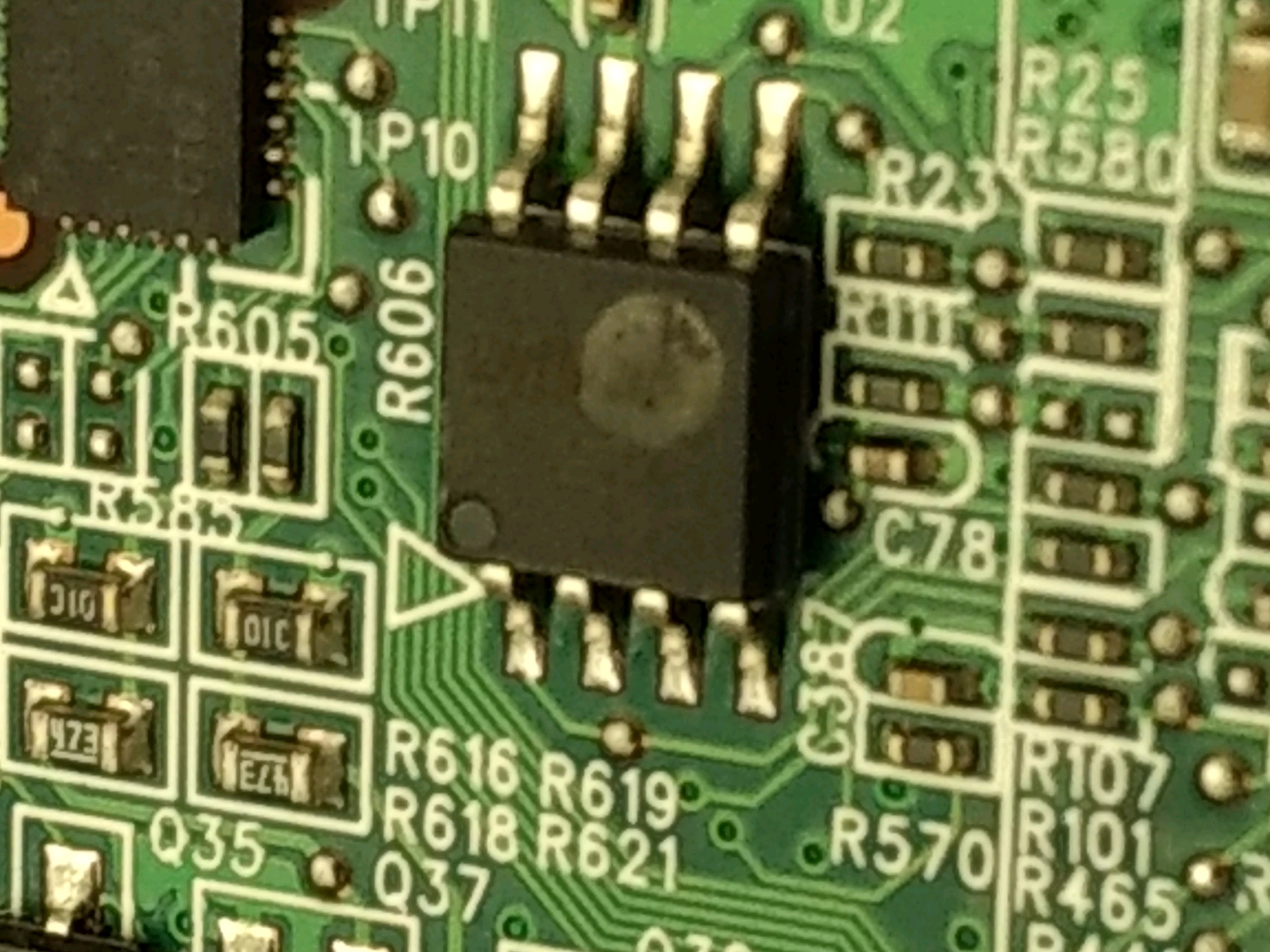

              Ok so as of now the TV's actions are eerily reminiscent of this thread: https://www.badcaps.net/forum/showth...light=50l1350u.
              I have my TV on a power strip with an on/off switch. I have to turn the strip off and on several times, wait 10 seconds and eventually the TV will turn on. Once I turn it off, I cannot get it to turn back on.
              After reading that thread and with some research I learned these symptoms can be indicative of a corrupted EEPROM, main board location U2. I checked mine and found a suspect area on the top of the chip, pictured below.
              Does anyone else think this EEPROM is suspect based on the symptoms I'm seeing and its appearance?

                No, the main EEPROM is usually marked with a dab of paint. It would also be failed if it was the visibly damaged and whilst they control on/off functions it doesn't account for the low voltages.

                  Interestingly enough....voltages are now where they are supposed to be and are steady.
                  This is something I don't have an explanation for, going from wild swings to absolutely solid and stable. Very weird

                    EEPROM ordered today. We'll see if that fixes it.

                      Well I'm pretty sure I cooked the new EEPROM. Going to order another one. I'm glad it was only $6.

                        So the second EEPROM came in today. After installation the TV turns on and off reliably but the TV has no sound. If I do a channel scan, turn the TV off and back on again it will not remember the channels.
                        So does anyone have any ideas?

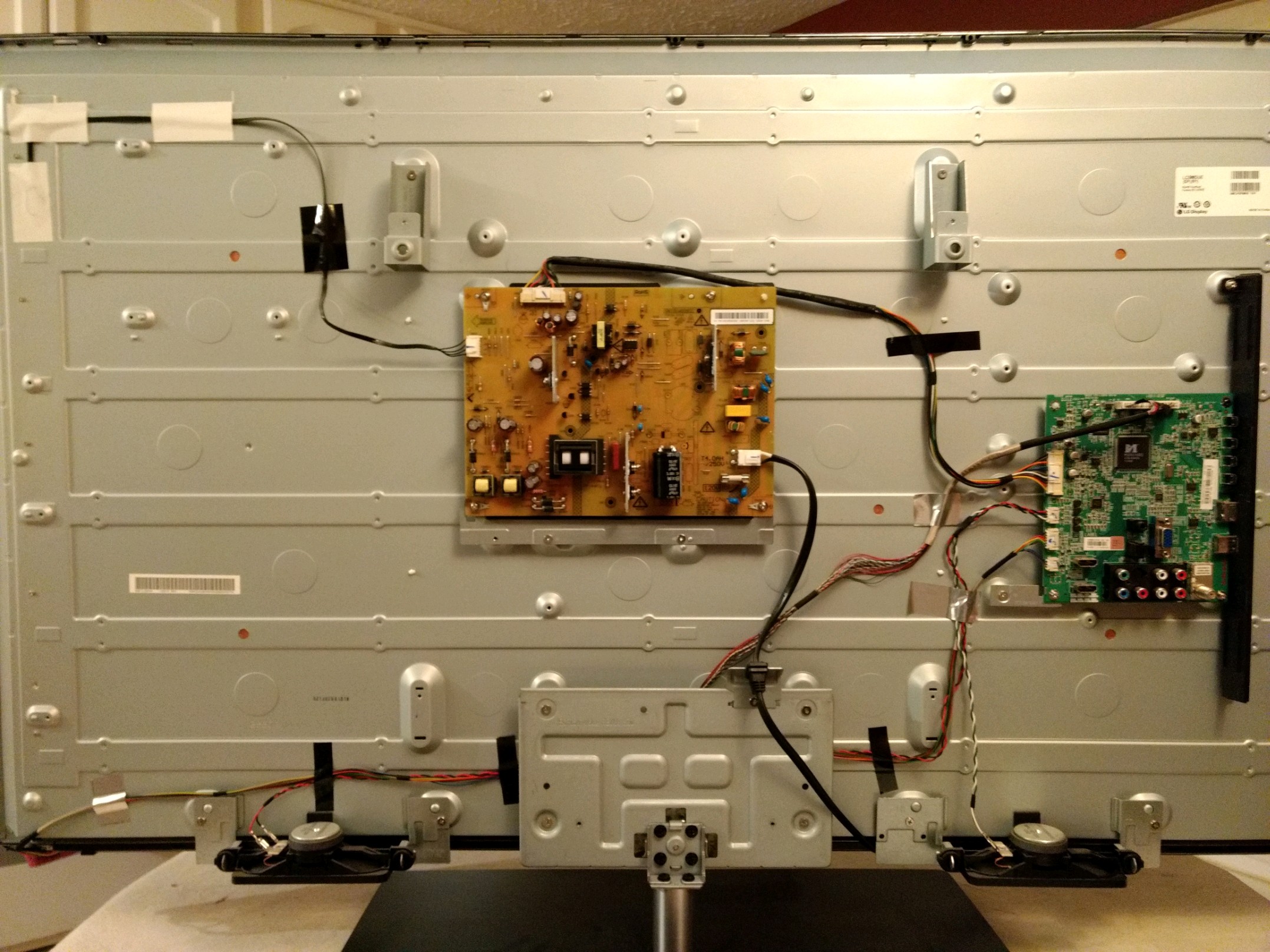

                          Fixed!
                          I replaced the main board and the TV has been working for 4 hours! It has a really good picture for an economy TV. Must be the LG panel......
                          Thanks everyone for all of your help, I appreciate it!
