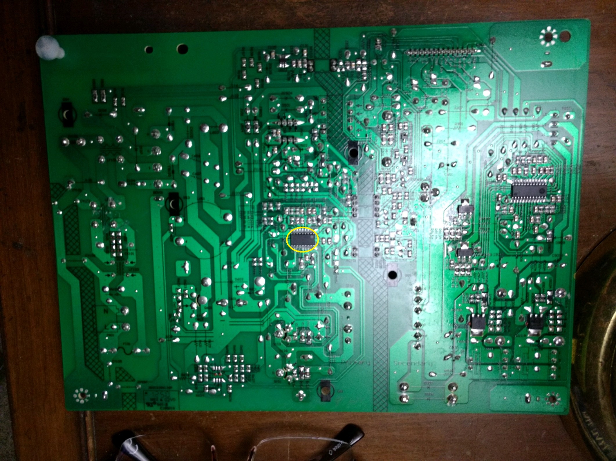

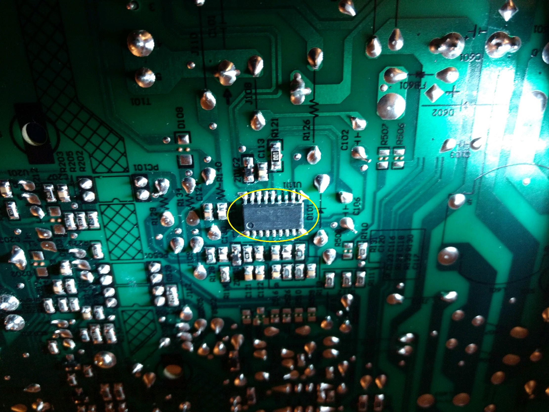

    Hello everyone I was hoping someone might be able to help me identify this IC. Its a Toshiba 50L1350U LCD TV with power supply pk101w0050i. There are numbers on it but they are worn enough I can't read them.

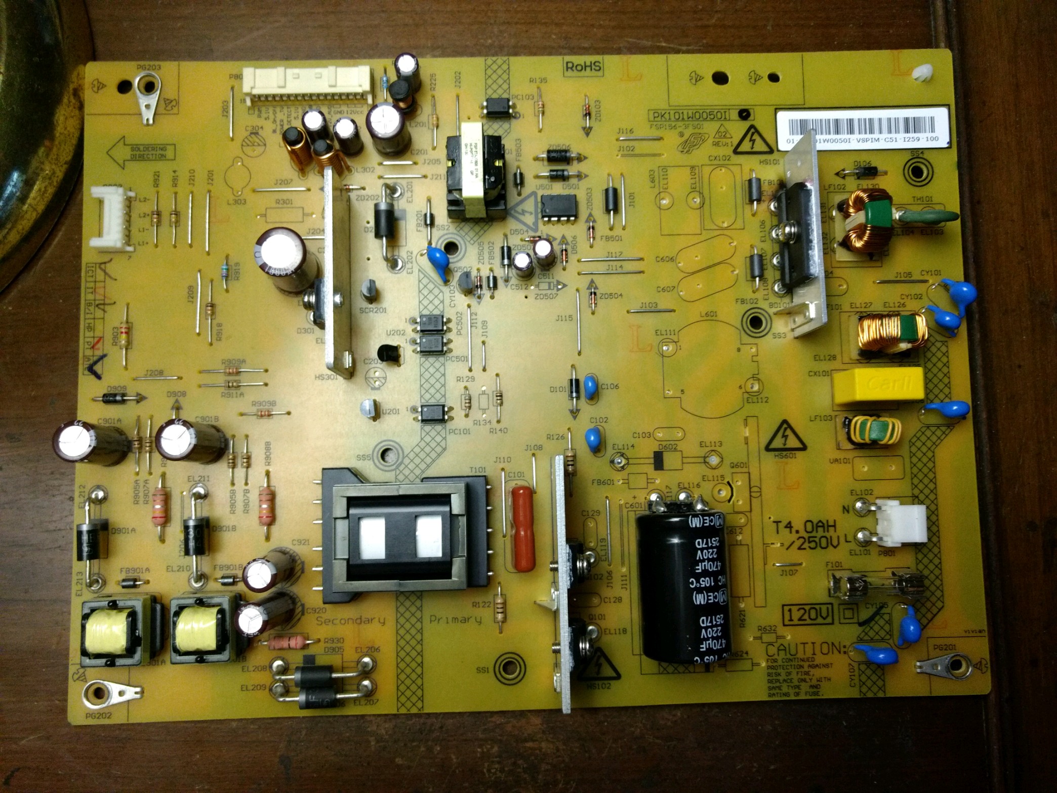

    This set is dead with standby volts and no standby light along with:
    No volts at C601
    questionable MOSFETS Q101 and Q102
    Q502 appears OK
    questionable X2 capacitor CX101 (Carli .33k275V X2 40/110/56, known for failure in coffee makers)
    On the cold side:
    Diode D301 accidentally shorted across pins EL203 and EL204 with power present.
    Voltage of 12.4V present at EL203 after short
    Loss of previously present 12V AUD and 12V_CC voltage of 12.4.
    Resistor R903 appears open.
    Prior to short of EL203 and EL204 the following voltages were present at connector P802
    PWM: 3.1
    BL_ON/off: 0.0 (set will not power on)
    AC_DETECT: 3.1
    5.1V: 5.3V
    12V_LNB: 0
    12V_AUD: 12.4
    12V_CC: 12.4
    So I'm thinking of buying the individual components and soldering them in but just wondering if anyone thinks I missed anything?

    What is that black ARC flash on one of the bridge rectifier BD101?
    There should be PS-ON pin on one of those connector, I cannot read all the pin names in your pictures, you need to list ALL the pin names so we can see what are missing.
    What is the color code of R903?
    BTW, X/Y caps are not needed for the circuit to function and I doubt they are bad.

      Oh... you saw that. I was testing voltage and bridged BD101 to the heat sink. Blew fuse F101, replaced it and voltage was restored. Think I had 165V on the DC side.
      Pins from left to right on P802
      PWM
      5.1
      BL_ON/OFF
      POWER_TV
      AC_DETECT
      5.1V
      GND
      12V_LNB
      GND
      12V_AUD
      GND
      GND
      12V_CC
      12V_CC
      12V_CC
      Resistor: Red, red, yellow, gold. Appears to be 220K, re-tested on proper scale and is 215K
